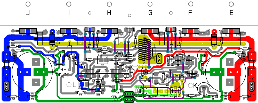

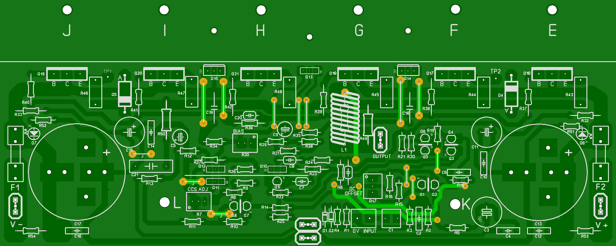

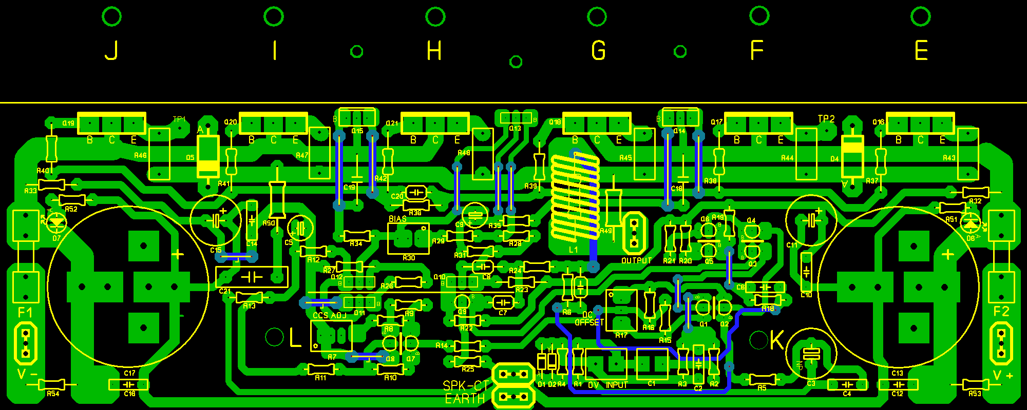

DONE at last !!
Woahhhh ! There actually was a lot to pack in there. 😀
I was extreme in my layout of the circuit traces to what would actually be seen , (signal-wise). I am aiming for the least "cross contamination" between sections. 50mm separated by the rail trace should keep my input stage rather isolated from the bad, bad output inductor.
Below is the labeled PCB (attachment) , the .ZIP file has the BOM , schematic draft , and PCB draft. I have SPLAN , to make a "pretty" schematic , but would like to know whether there are any better cad's out there.
What shall we name it ?? (The amp)

Yes, center NFB takeoff I agree with. The close rail-trace/ wire twisting has been "demystified" - read this , --- Enduring Class B layout mythology ----
I've yet to see an OEM that runs parallel rail traces on a single amp PCB , although some HT amps run parallel copper bus bars to feed the 5-7 channels on one PCB , but adcom , luxman, nikko - just run the rails from each side. I have seen a silicon chip layout with the parallel traces , but no alternating (V+/V-/V+) output scheme. For diya's heatsinks (If I had 2) , I would of designed a flat- opposing OP 3-4 pair layout. BTW , none of those OEM's twist their wires. 🙄
OS
Thanks for the link. I maintain that it is still sensible to keep the supply loop area as small as possible, so that equal amounts of +ve and -ve currents are injected into sensitive areas. In my opinion, this is best achieved by having the psu entry points close together in the middle of the board, so that twisted supply cabling can be used.
Bob's post here - http://www.diyaudio.com/forums/soli...lls-power-amplifier-book-179.html#post2582005 sums up my views and agrees with my pratical experience with a distortion analyser.

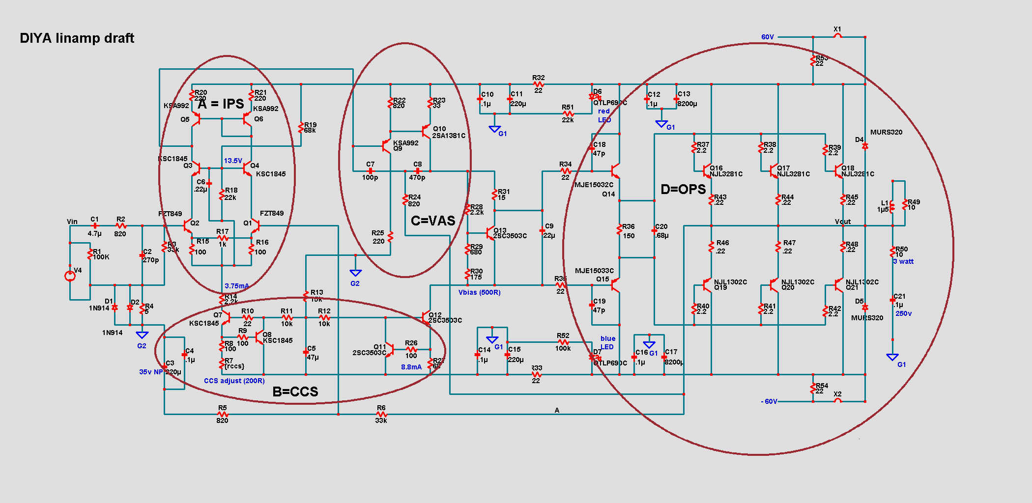

Hi OS,
You may want to think about increasing the value of R25. As it stands, the collector current through Q9 at positive clipping will be rather large!
Ian
I agree , carlos (DX) blew a few beta enhancer's here... 🙁 I only achieved a warm ksa992 with hours of clipping with 45v rails. 470R or more would not affect performance one bit.
I segmented the whole design (below) ....
A=IPS - the "universal" input stage. You could omit/ jumper out the C-E of Q3/4, omit C6/R18-19 for the simple 2 device input pair. you could also not do this and use a low noise {ECB} input pair...
.. most of mouser's low Vceo- low noise to-92's (BC-xxx) are EBC.
(please comment on this !!! )
FET's are more problematic , some are "unobtainium" , have different DGS pinouts ..... it would be best to go the SOT23 way with a micro PCB. In this way, whatever BJT pads are chosen the SOT's can be routed (BF862 X2)
on the "micro PCB" 🙂 .
B=The current sources , tried and true .... this will even minimize turn-on "thump". The real amps will stay 8.82ma VAS from 0C - 40C , no change.
C=VAS Changing R25 , no issue ... mje340/350 for Q10-12 , it will work. Jumper C8 - omit R24 , you have simple miller compensation. I also left capacitor pads on the negative feedback path for a little lead compensation (next to R6 on PCB) , i'll label it "LC".
D= The output stage , use anything 😀 ON NJW/MJL x302/x281, Toshiba 5200/1943 - any 200w+ 200v+ 80Hfe + TO-264/TO-3p output device.
Driver , the same MJE - 2sa/c - to-220.
I'm going to finalize the whole thing , right down to the mil spacing for the component leads , so I need a final comments on input pair or any other component choices. I tried to make it as DIY "friendly" as possible (larger pads , no special parts or form factors). Thanks ...

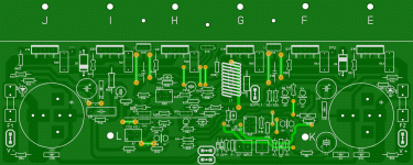

Thank you , Mark ...
But there are those small details to "sweat" now. 😉 The reason for this thread.
Visually , the board will be "pretty" (VERY visually appealing) and exactly 252 X 76 mm , the whole 25mm area above the output "line" (the E - J holes) will be gone , they were just for alignment.
I did this from "mind" ( no auto-routing) , for this is a "artform" (like a painting).

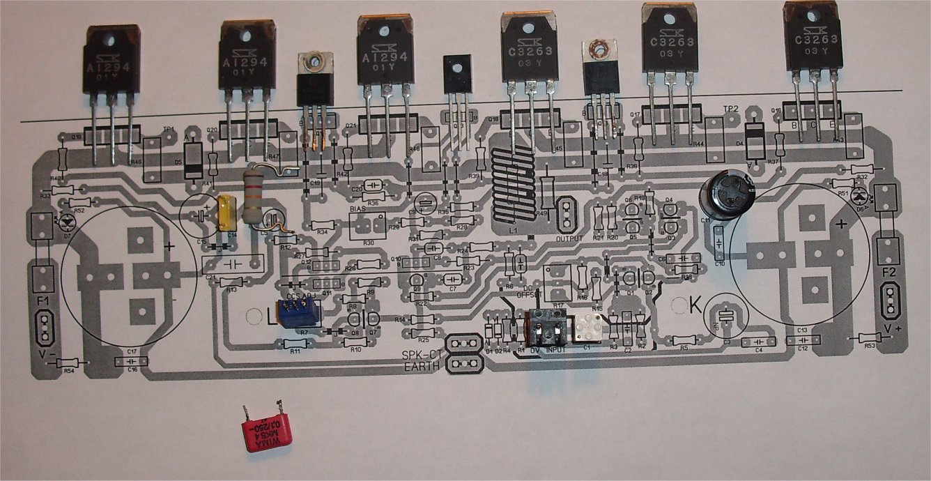

This has 99.999% chance of working the first time as it is , should we prototype it first ?? 😕 , as to not go down the road of the GOLDMUND , with all of it's mod's and shortcomings. BTW , that was not Alex MM's fault , they should of built it first - then went to production ( look at AKSA's latest fetzilla project).
I will edit the BOM text to perfection , and write the "book" too. I have photo's of my AX , which is the first version of this amp ..exact same VAS/OP. Your call as to what format to do this in. PM me.

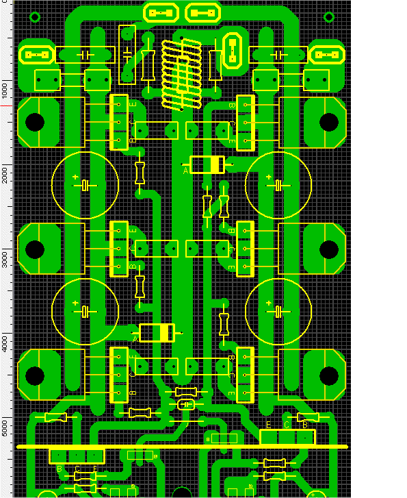

I agree that is slightly more ideal ,
Consider this - this amp has the supply onboard , rectified, unfiltered DC will be entering the fuses , no typical DC lines running from an external PS. The charging pulses will return to the main earth/CT near the edge of the board , the second set of thinner returns (CCS's/VAS/input ground's) will have far less "garbage' on them and shield the small signal area. This amps loop area is just 100mm total (C13/17 to the first outputs- 50mm X 2).
Now... with traces going down the PCB center , you would either have to jumper the circuit across the rails , or place most of the circuit on either side.
One would be a bad choice and one would waste real estate.
On another design (below) , it could be brought out one step further than what you see. Not only put the rails right together down the center , but split the P and N channel return traces to meet dead center at the end of the board.
I had to compromise for this application while still trying to retain the performance. My best guess , is that the amp will stay PPM up till 1/3 - 1/2 power , then slightly degrade to .005-.01%+ at high power levels/load. This is unavoidable with just the fact that we have a EF2. 🙄
This is why MY amp will be triple op / below layout. Not to say this will make a bit of difference in the sonics , but this also would be subjective. Lacking an AP , I did see the effect of loop area / cable inductance on the slew of a heavily loaded square wave on my present version of this amp.

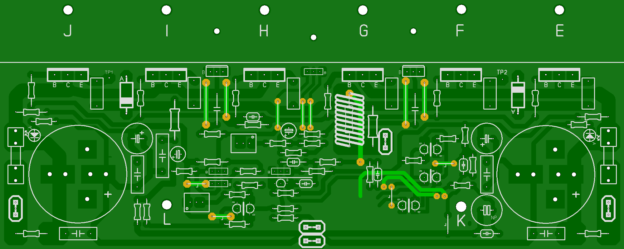

looking for BUGS....
Voltages -( picture 1 ) and a real world layout (picture 2) .. this is the only way to push 99.999% to 100%. ps- red is V+, blue is V-, yellow= signal , greens are ground....
Still waiting for component/general suggestions before I "lock down" the design.
