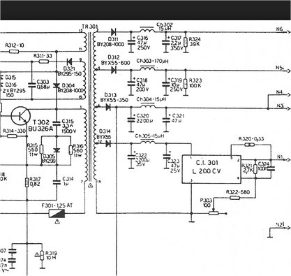

SMPS800RE looks like a typical car stereo dc/dc switch mode converter. It is more similar to your typical PC power supply in that it switches 160Vdc rectified wall AC into the final DC. Try ferrite chokes at the output rails. On the PC supplies there are the to-220 rectifiers , then the chokes , finally - the capacitors.
Really , a linear supply is recommended, but a SMPS could be optimized with proper design 😀 . Connexelectronics modules might not be (fully - {diplomatic} 😀) optimized for audio. (I said it) , the lack of those ferrites leads me to believe so.
Edit - Almost all the google examples of SMPS show CLC output filters (example below)

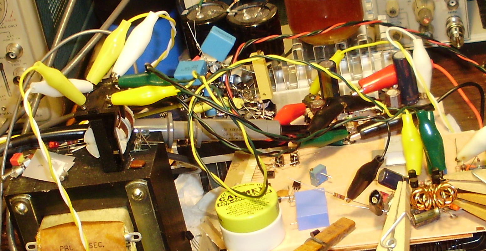

I made a simple device to fix ground noise issues on my bench. It isolates source and amp ground and removes the ground noise from the signal. The result was a big improvement in sound. I measured 25mV of SMPS nastiness between the two grounds (the source is my computer). Even 5mV of ultrasonic noise can affect an amplifier negatively, especially highly compensated amps.

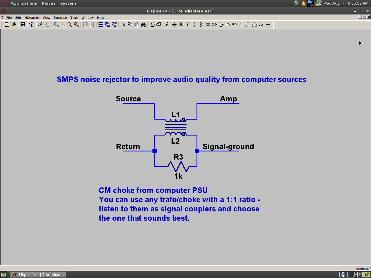

I must warn you, it's very sacrilegious. I didn't want to myself, but my curiosity got the best of me and it was so easy, I couldn't resist. Especially after getting a new pack of alligator clips.
I used a CM choke from a computer PSU. I chose based on how it sounded used as a coupling transformer. This one had the best treble and imaging, as much as I could tell without the bass that is (. It is split bobbin with thick wire so the windings are nearly identical. The better matched the windings are, the more ground noise cancellation you will get. Still, 10% matching gets you 1/10 the original ground noise, which is not true for the groundlift resistor.
Coupling trafos are often suggested for ground noise problems but they have a bad reputation because of distortion. I had the idea of turning the trafo 90 degrees.
Ground noise has many different forms it takes. The electromagnetic form depends on current. As long as current is allowed to flow through the ground connection, there will be EM radiation, and there will also be effects depending on the grounding schemes of the source and amp. If your amp is isolated from ground, you'll still have several nF's leakage through the trafo and this will resonate with the total ground loop inductance, which may actually be worse. Furthermore, as long as any current flows through ground, there will be a corresponding ground noise between source and amp. Evidently isolating ground is not a bad idea. While interconnect ground resistance may be very low, inductance will dominate anyways, so actual ground coupling at frequencies that matter may not be effective.
A ground lift resistor is commonly employed to prevent excessive ground loop currents. The problem is that any voltage difference across this resistor is added to the input signal. So you are just trading one kind of noise for another. Both options don't sound good if you have a ground noise problem.
Using the trafo/choke in this way eliminates trafo distortion because the signal and return field cancel without any action caused on the part of the choke/transformer. I have measured the distortion of my EC buffer through this thing and it must have been well below .001% levels. It is difficult to make a transistor circuit that works this well. But what was really convincing was the increase in soundstage depth and realism. Ground noise is directly subtracted from the input signal.
You can try any trafo/choke with this as long a the winding ratio is 1:1. The choke I used is probably not far from 30mH; it won't block ground faults at 60Hz but even so it improves the sound a lot. Things to try would be:

One interesting thing about this circuit is that it doesn't necessarily replace the groundlift resistor. The trafo does its job regardless of the groundlift resistor. If your amp is isolated, you want to pick a value for this resistor that adequately damps ground leakage resonance. For me this was 1k. You could make this a trimmer. Still, we want ground current as low as possible for reasons I've given above and I've found that a larger resistor sounds better as long as it's not too high. But if your amp is not isolated (mine was), you don't really need the resistor.

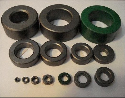

I also have some of these (below - lots of them) and some enameled wire. Could I use these ?

If you get the winding wrong, you may hear a very high-pitched buzz. I turned the clips around and it was gone. If you're winding bifilar with double wire, then your source will be on one end of the wire pair and the amp on the other. The magnetic field of the input current cancels out the field of the return current of the same.
For a 30mH CM choke, rejection extends down to 1KHz or so. You can test this in LTSpice with a simple model. 30mH is around the values for CM chokes that I've looked at.

30mH would be 200 windings + x 2 for common mode on my 20mm toroids .
I used a online calculator ...
Online Calculator .:. Amidon Toroid Calculator (Ferrite)
Better to salvage some pre - made ones from E-waste.
