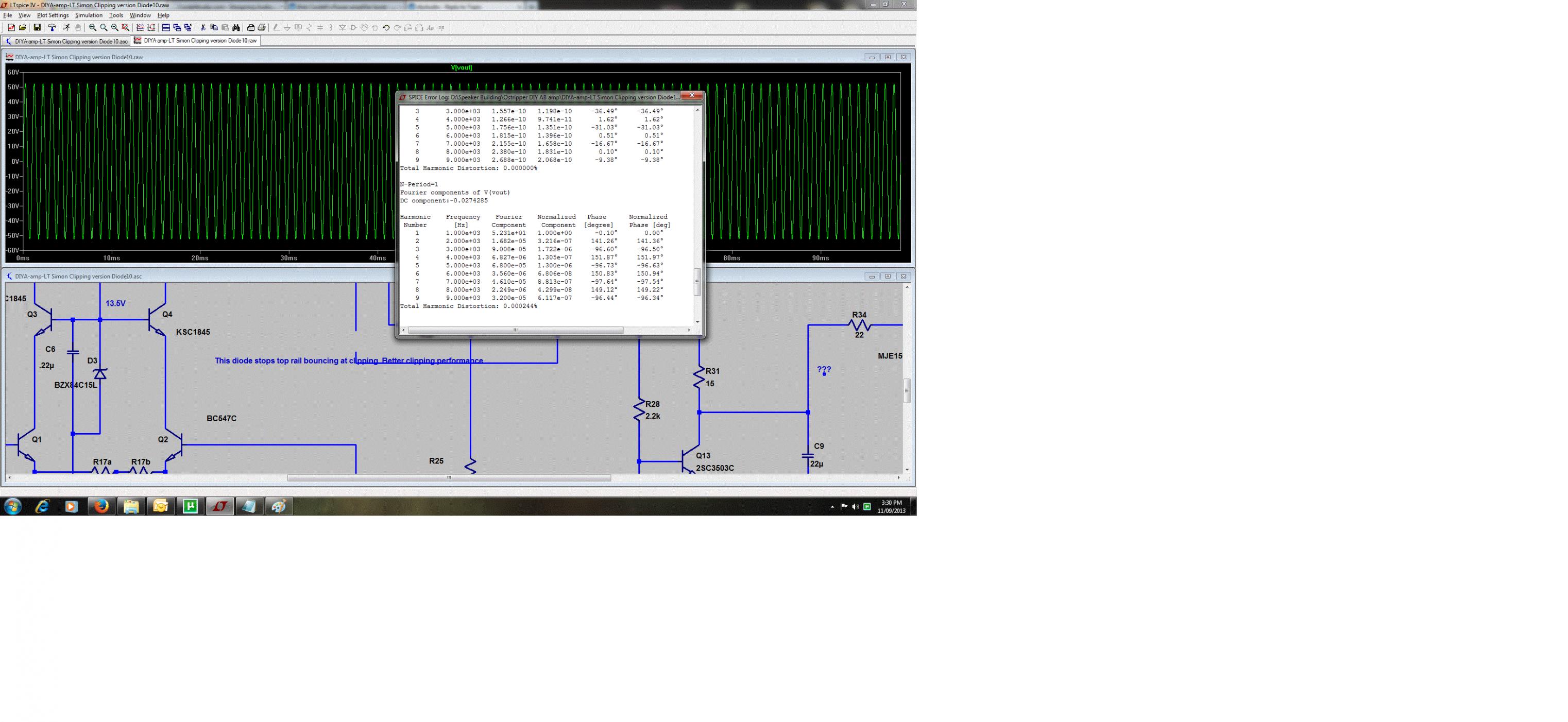

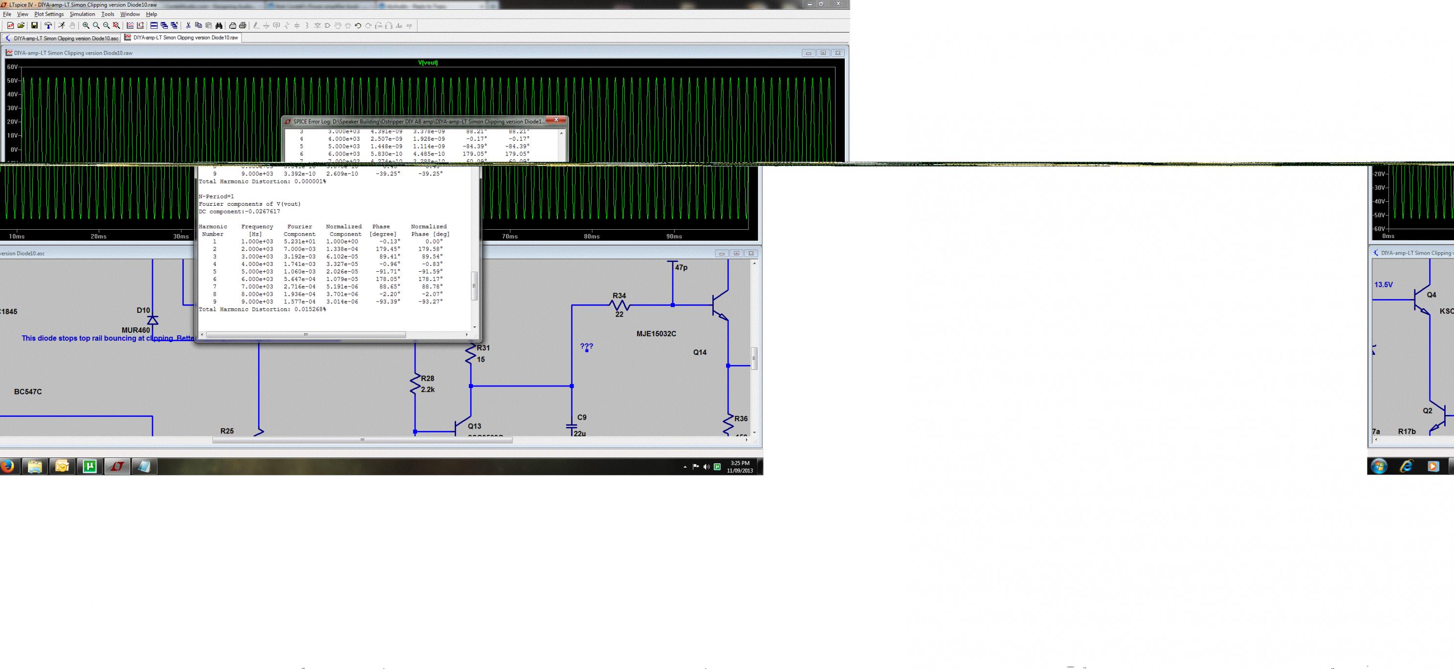

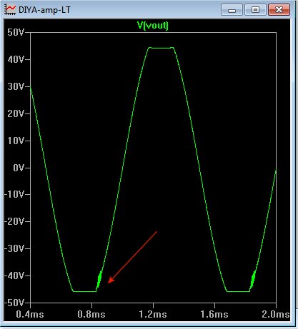

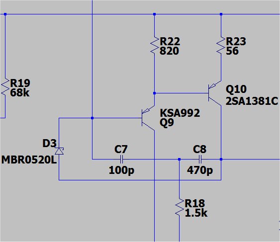

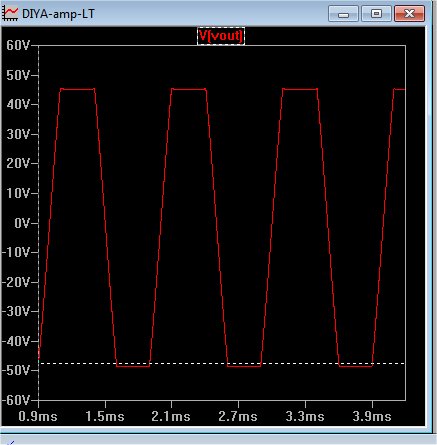

Tamed the clipping !!
Member Still4given hard clipped his Badger ...
The result was a slight sticking of the upper rail waveform (pix 1).
The simulator emulated exactly the result on the actual amp (build thread)
by still4given (so I trust it - the models). You can also see a little burst of oscillation induced by the hard clip (arrows - pix 1).
Member Janutz (thanks!!) recommended a diode from the collector of Q10 to
the base of Q9 - It works (according to the simulation - pix 2).
Still , a little burst of oscillation. 🙁🙁 Some diode models worked with R18=820R,
some showed the little burst. The speed of the diode seems to determine this ??
This little burst does not happen with standard miller compensation. So, it has to be TMC's fault... 😀
I lowered the TMC feedback resistor to R18=1.5k ... burst is gone - even with a slow garbage diode.
The final (pix 3) , shows almost perfect symmetrical clipping (within .5V) AND no
bursts or other errata. I ran this with many rail voltages and with different gains.
Attachment 4 shows the Badger VAS (Q9/10) with the added diode (D3).
This diode should be both fast and have a high reverse breakdown voltage
as it has to see the full "swing" of the VAS verses the relative static voltage
present at the base of Q9.
The effect of raising the value of R18 was just a 5 PPM distortion increase at 20K ! WORTH it!
SO , in conclusion R18 is just a value change and D3 would be very easy
to add either to the top or bottom of the PCB - no major rework.
OS

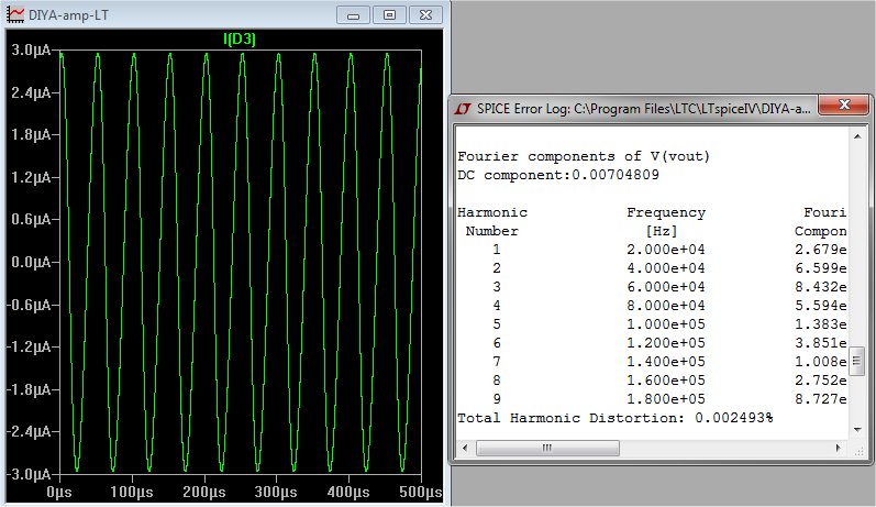

Just simulated distorion with that extra diode from q10- q9. The distortion level increases 100 fold when using the diode.
Regards
Simon

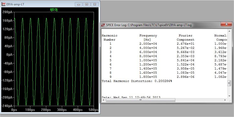

By niss-man -Just simulated distorion with that extra diode from q10- q9. The distortion level increases 100 fold when using the diode.
I wondered (could not see the attachments too well) how he could of reached this conclusion.
Not all diodes (models) are created equal ... In [attachment 1] , we have a 1n5187 schottky. It's model shows 100's of uA reverse leakage equating to
that 100 fold increase in THD. A really bad form of local feedback.
NFB can't hope to compensate for this large of an error being fed back to the base of Q9. 🙁
I actually did my THD assessment using the "garbage" diode [attachment 2-1n4148] .. for a worst case scenario .so I thought... (MY ERROR 😱😱).
Still , we have 3 uA reverse leakage. However the Badger's NFB can compensate , giving .002% THD20 verses .0015% with no diode (8R load).
Now we know the mechanism for Niss's findings.
The Ideal diode SHOULD do absolutely NOTHING (like it is not there),until a saturation (clipping event) needs to be dealt with.
Looking around the web , I see that some diodes are WAY better in the reverse leakage category...
http://www.nxp.com/documents/data_sheet/BAS45A.pdf
Nice ! Only 1 NANO amp leakage. Only 125V reverse breakdown. 🙁
Another .. higher voltage..
http://www.diodes.com/datasheets/ds30371.pdf
100nA leakage , not too bad. That is 1/30th that of the 1n4148.
In conclusion , if the diode you use has ultra low leakage, it essentially
is "not there" under normal operating conditions.
Time to hunt down one of these "super diode" models for spice.
OS

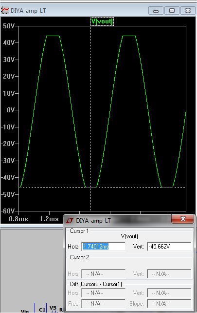

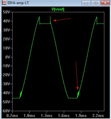

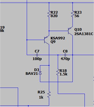

Bring the diode to Q9's collector instead. The diode will turn on shortly before clipping, but until Q9's CB saturates, the increase in distortion will be minimal. Increase Q9's collector resistor too.
I tried it.
Your right about the THD.
But , the amp clips very asymmetrically and even shows a DC offset.
I used the BAV21 model , up to 1K for Q9's collector Resistor.
OS
