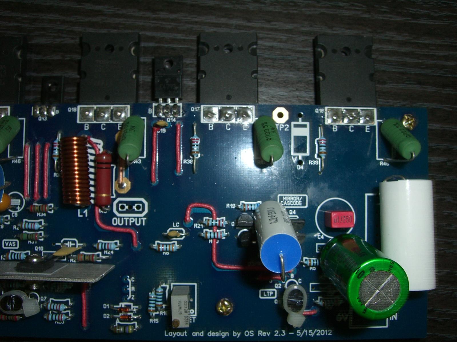

Looking at the above photo - it would help if the lead spacing for the 0.25/ 0.5 Watt resistor is increased.
+1, and also if some holes can be made larger to ease insertion of some parts around power resistors and supply caps..
I did that. Some said the large diodes and some transistors were tight.
I researched all the caps, transistors , diodes and made the hole pitch at least .15mm larger than the largest expected leads.
C5 = I will do it - even make it multi pitch ! (3.5 + 5mm).
I really would like to make 25mm emitter resistor lead spacing for the "cement ones".

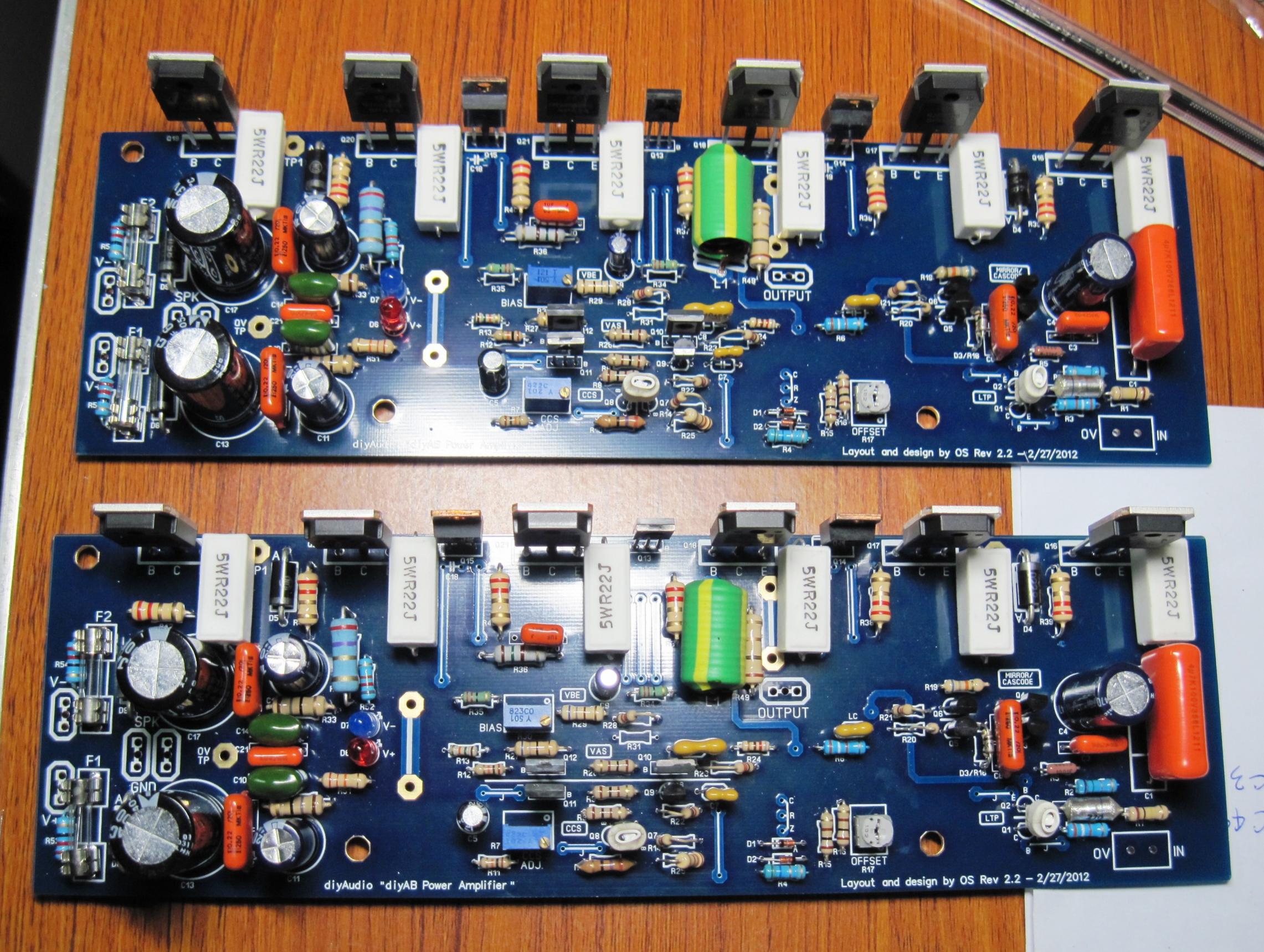

(below) is what I originally designed for ... (attachment 1)NOBLE 0.22/5W Resistor (5 pcs)_NOBLE_Resistor_Analog Metric - DIY Audio Kit
Also... 3W ceramics can fit the badger's 12.5mm LS.
The issue of 25mm spaced devices is that you would need to run the output bus half way (down the middle of the board).
Then you would either have to migrate some of the circuit into the section of the board that has the high current rail traces or the other OPS signal paths.
It's best to keep these small signal /high impedance sections far away from the currents.
The old amps used those 25mm monsters (attachment 2) , as most had separate OPS boards.
New ones use either the single noble's or the dual ones. (below attachment 3+4).

Just noticed AJT's badger's ... I want mine to look that good !! (much envy)😀
They look really good w/ 25mm emitter's ... but those 12.5 zoble resistors would be the cat's meow...

Many thanks for the pitch increase!
As for the 5Watt resistors I'll have to bend the leads and make them fit as in the photo.😱
Ok ...
C5 + R23 + R27
C5 = more room and multi-pitch.
R23/27 = 2mm greater lead spacing.

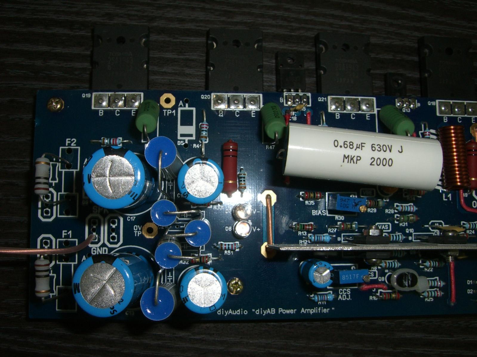

Hi guys ,I finsh a amp today.
I'm test to tp1 and tp2.
Turn on the R30 about 8mV.
And turn on it's about 76mV.
Then R53 and R54 was burn .
what happen is it??

No fuses ? 😕

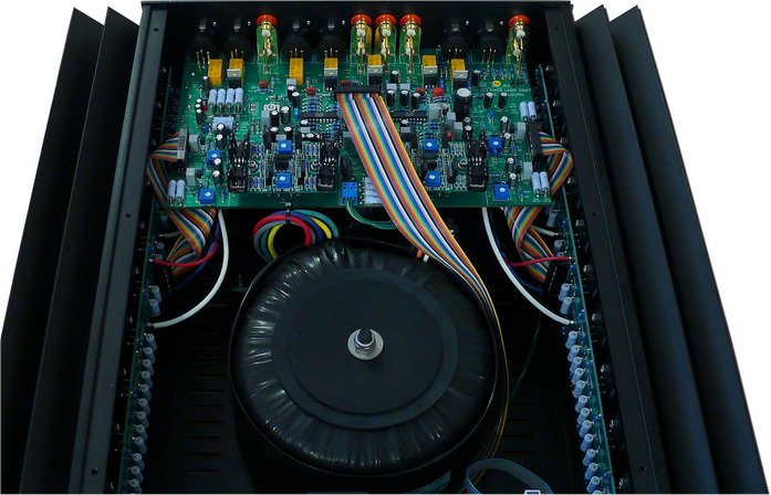

Jojo would you please post up a block diagram of your amp as pictured in post 1050, that is very impressive to say the least.
He did not jumper C-Z/C-R , the cascode reference is "floating". 😱
Jumpering all the small signal traces was not necessary , jumpering the rail traces is optimal.
Sure will do as soon as I'm finished with those in my table right now. That amp build used the Speaker Protector and the Soft Start boards as well as the V2 PSU boards available at the DA Store.
That amp has survived a lot of torture, and in an operational sense, I am sick and tired of trying to destroy it. 😀
