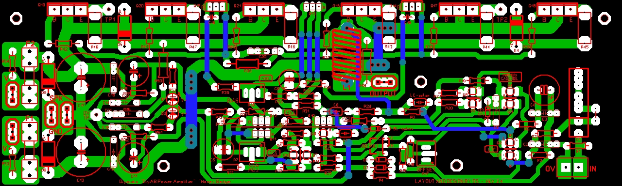

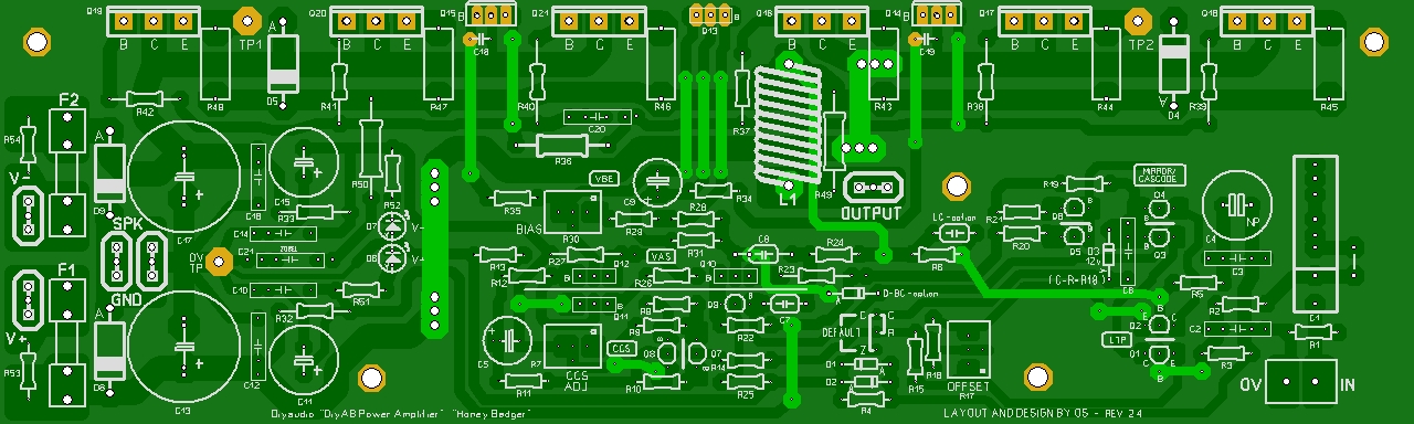

Changed C5/8 , R23/27 , better labeling.
C5/8 (current source cap and Vbe cap) are now 3.5/5mm multi-pitch with
more clearance.
R23/27 (main VAS emitter resistors) are also 12.5/15mm multipitch.
Made [C-Z] the default jumper for the cascode. Also listed R18/22k = C-R as
an option on the silkscreen. The 12V zener is default.
STILL , asking 🙄 if anyone wants more clearance for C4 and C1.
I have noticed some use high grade components here.
(Below 1 and 2) is the present output.

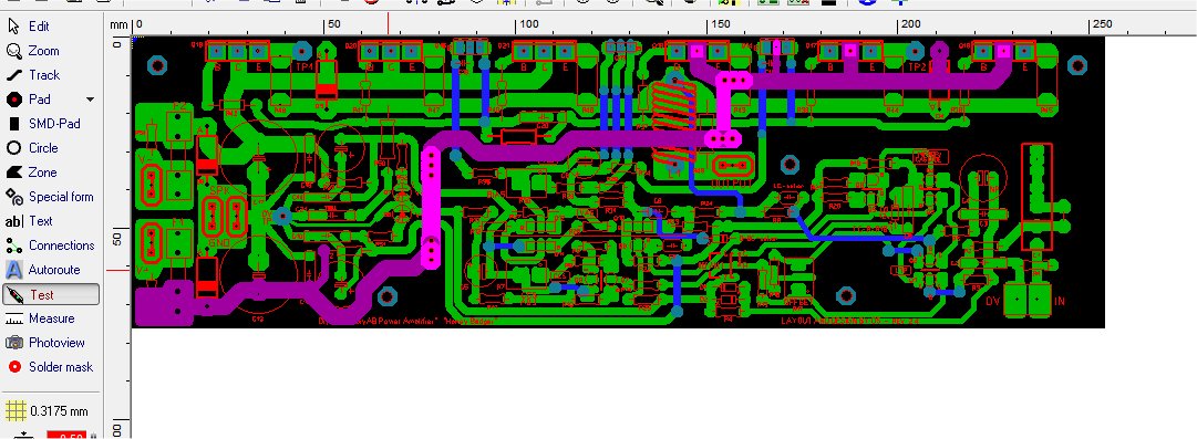

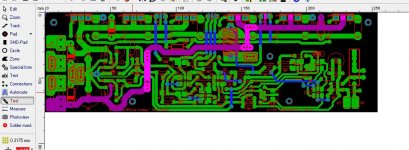

PS - The last attachment is a show of the "test" function on Sprint layout. All
through-hole traces test 100%. (example of the positive rail in pink).
Also , these attachments are 254 X 76 mm - they can be printed out to
see if the holes line up with the DIYA universal layout .
OS

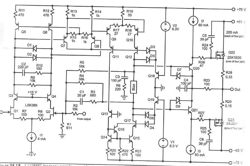

Actually, contrary to some previous comments. I would like to see more options if possible. One of these is preventing saturation of LTP as an option.
Some time ago I attached a diagram of Stochino's amp with anti saturation diodes in LTP and VAS. This time it's taken from Bob Cordell's book. It does not matter that on this diagram Q1 and Q2 are jfets. Apart from what is shown, adding two diodes (both ways) between bases of q1 and q2 Bjts in HB should also prevent these two transistors from saturating although doing that for mirror-cascode is more important.

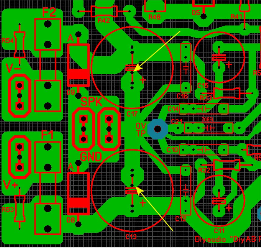

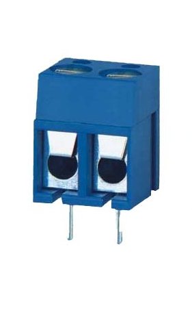

When it comes to the actual board I would shift C13, C12 and C11 by 7-8mm to the right as I prefer using block terminals and C13 prevents that. As I have V2.3 I'll have to place C13 under the board, which is not so convenient.

You mean these ? (below - euroblock terminal).
If you must use these .....
A 5mm lead spaced block terminal should fit between a smaller C13/C17 (12.5-15mm). Drill new holes for 12.5mm caps (below 2). Euroblock should fit.
A smaller C13/17 (220uf) should have little if any affect on performance.
Edit - I will incorperate this extra lead spacing into V2.4...
OS
Yes, that's the one only I didn't know these are called euroblocks in the USA. It fits perfectly well into SPK-GND space so it will go there.
As I like having these caps in so on my v2.3 boards C13 goes under. In really fast amps these caps are needed to cater for these transient peaks. I remember that apart from these Otala liked 680nF fast poly cap plus 1ohm resistor (? if my memory is not failing) between each side of PS where it enters the board and dirty ground to compensate for big caps internal inductance etc.
