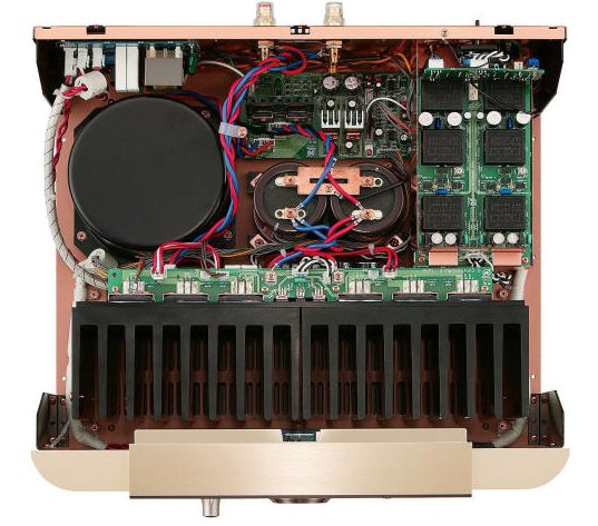

I've been researching, (looking for ideas/design refinements)in some of the "top end" amps.
I came across the marantz ma9s2 (below). At 8000USD , one would expect
something "magical".
-The case is top gun. (unknown $ - DIYA's case is just as functional)
-A shielded 600VA toroid ... AnteK sells these.
-standard 15K -22K X 2 main capacitors (maybe more) , an EF2 with 3 pair Sanken MT-200 OPS.
Most badger builds have more at MUCH less cost.
Nothing "magical" yet...

Not really superior to the Badger -different but not better.
The marantz might (I suspect) have an auxiliary supply for the VAS/LTP as it
also has a separate output stage PCB.
Omit R32/33 on the badger , add 2 wire wrap posts and hook up an independant 50VA /100Vct toroid
with a nice capacitance multiplier/regulator.
We now have the marantz BEAT (it uses
a secondary from the main trafo 😛)
POWER !! The marantz is rated 300/600w (8/4R).
We can boost the badger - MG6330/9410 - with these devices, the Badger would
easily be rated at 200/400w (8/4R).
My point is... spend 600-1000USD and you will have an equivalent (if not superior) power supply ,
an amp that is all on one board and uses easily
sourced components (no marantz "potted" proprietary BS 😀) .
Or spend 8K for a brand name.

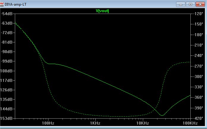

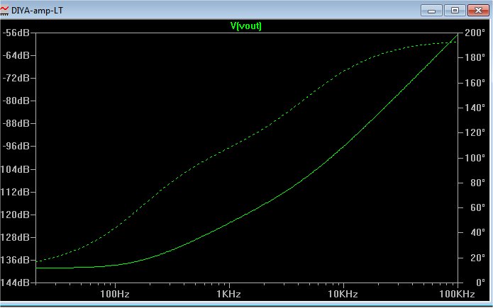

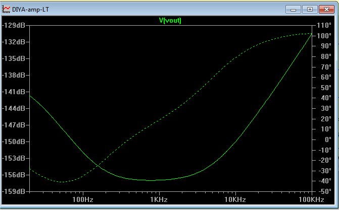

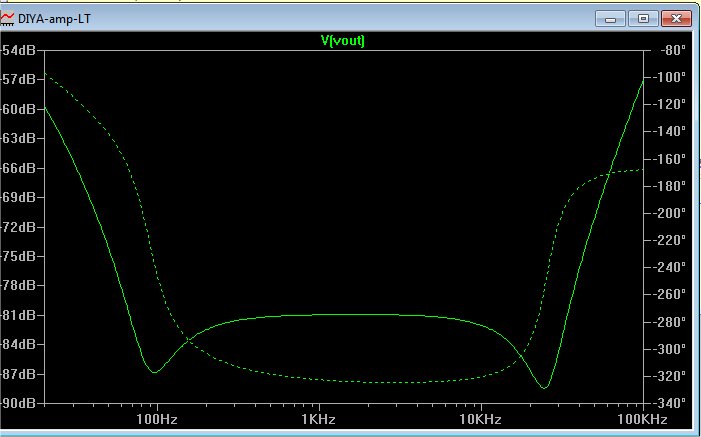

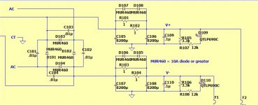

Attachments (PSRR):
#1. = Unregulated plain ol' Badger ....
#2. = Badger with a diode bypassed 8200uF / .47R / 8200uF CRC.
#3. = Badger with separate PS for small signal section.
#4. = The combination of the CRC + separate 65V supplies for LTP/VAS
(OPS runs on 58V). 😀
This was with a single output stage supply (not full dual mono). 1V ripple was simulated.

The CRC is very effective !
And the combination of CRC + separate front end PSU is especially so.
I am slightly surprised that the separation of the Front end supply really only benefits the LF. Is this a quirk of the Honey Badger, or is it something we would see more generally in other amplifiers?

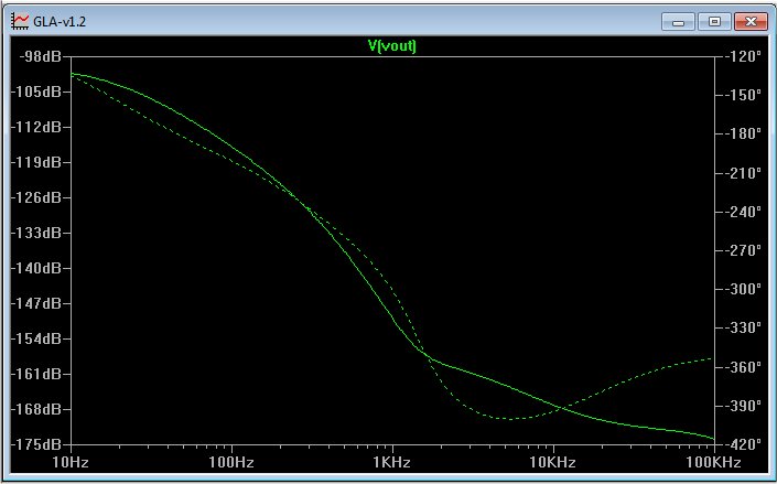

Yes ! "single ended" amps like the Badger seem to behave like this.
Push pull VAS's are natively superior by design (below 1 -push-pull VAS PSRR/ NO CRC).

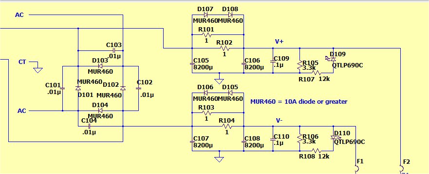

But I thought I would port the advantages of the CRC back to the good 'ol
Badger.
(below 2) is a mod that can be added to the DIYA power supply board.
Add 2 - 10W 1R resistors + 2 10-15A diodes to the DIYA PCB instead of those jumpers
(between the 2 sets of reservoirs -C/R/D/C) .
For the front end supply , just a single 50VA 50-0-50VAC trafo with simple cap multipliers
would be sufficient.
Edit - amps like the leach or the GLA (push pull) already have basic regulation
(raw zener for the leach and zener/emitter follower for the GLA) , this also increases
PSRR.
