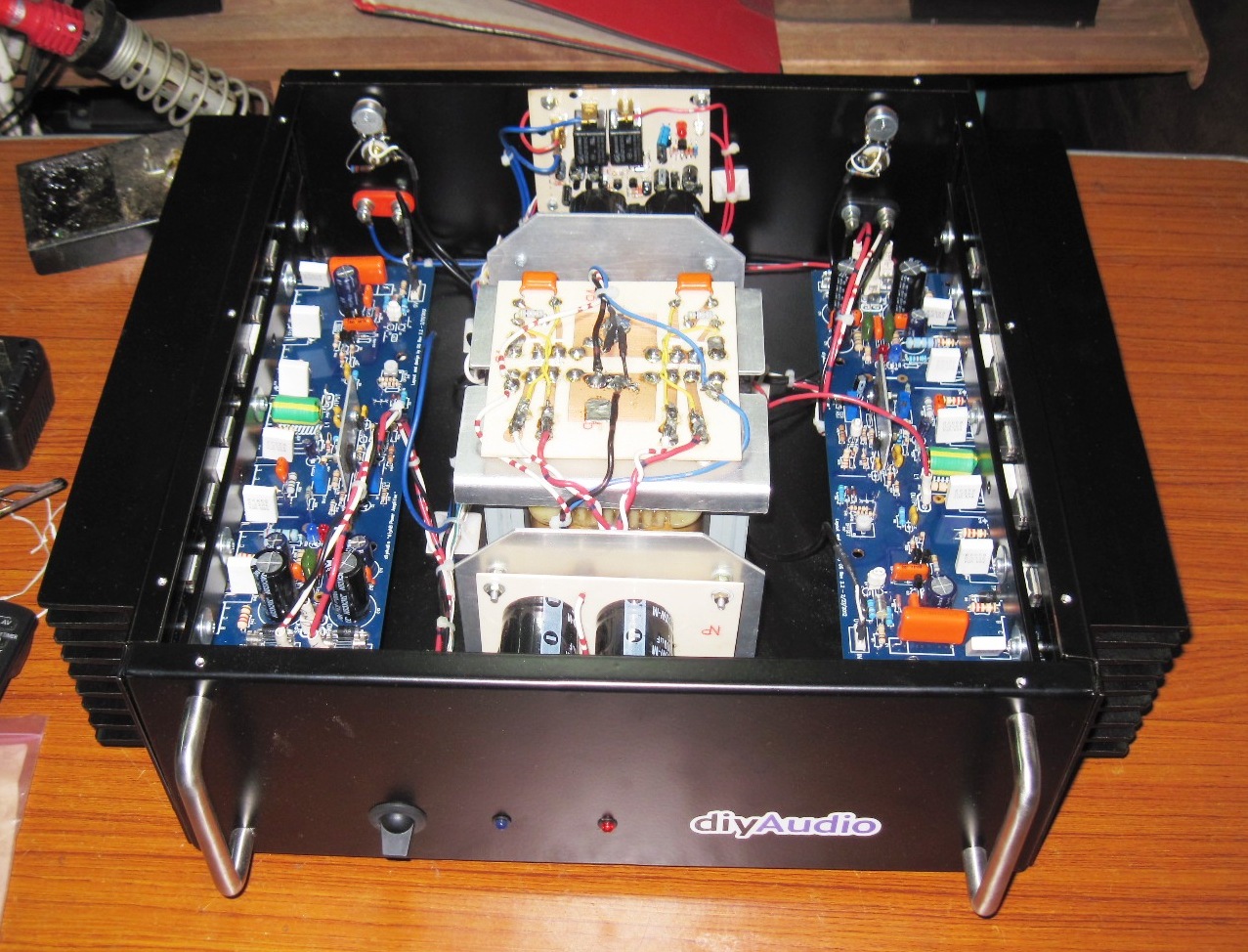

Hi gut,I have some question.
T finish other PCB .
DC offset about 30~50mV,and R14 is 8.25V.
After I try to bias of R30.
I turn on about 270 ohm(measure) .
Bias is 0 mV.Is it normal???

R14 = 8.25V excellent (to spec)
DC offset = can be adjusted with trimmer afterwards.
270R R30 = output stage will start conducting at about 250R , 175-180R
will produce optimum output stage bias.
Also, biasing R14(CCS adj.) to 9V or a lower Value for R27 (56/68R) will bring that
"optimum" range of R30 to the 220-270 ohm range. This is the reason for
a 500R trimmer for R30 - to allow for these choices. 🙂

I did some testing with your models. Q1/2 and 5/6 were the "touchy"
ones. Try to aim for < 500Hfe for both.
Cascode just needs to be a high Vce device, no gain here.
For the VAS and CCS's nothing critical. 2911/1209 pair
worked good for the VAS. Don't use too high of a rail voltage with
this pair (60-65V max).
Using a high gain Q5/6 was where I could get instability.
OS

Thanks ostripper,
for Q1-2 I'm using ss9014d with hfe of 560 perfectly matched but I increased R15-16 to 121ohm and R17 is 2k. Will that do?
I'll replace Q5-6 with low Hfe transistors, bc327 or ksa1015y (max hfe about 240).
For cascode I'll use 2n5551 as it's common base so Hfe as you said does not matter.
I'll be using 2x45V or 2x40V toroids so I should not get more than +/-65V no load.
I also have 2sa1406/c3600 which have better SOA than 2sa1209/c2911.
cheers,

The early badgers were designed with a PILE of F grade KSA992/KSC1845 ...
(300-600Hfe) Anything in this range should work well.
Only one person used 1200-1400Hfe devices , got a little "squirrelly".
Thanks for tipping me on ..http://www.sm0vpo.com/_pdf/2SA/2SA1406.pdf
I am looking for a 3503/1831 replacement (soon to be discontinued). they
even look better than the KSA/C's. SOA does not matter much for the VAS,
6-10mA is not much - using a larger heatsink is helpful - 40 X 80mm of
plain ol' aluminum roof flashing is what I used.
