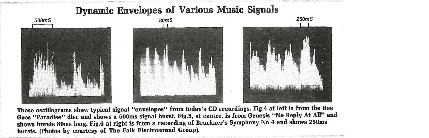

The main reason is that modern music has high signal bursts lasting even 500ms so there is no point in reducing PS voltages too much if the design allows for much higher Vs. If I do not forget I'll scan images of bursts I have in my articles and paste them here. Bob Cordell reports the same thing in his book and a few other authors do the same.
The other issue is slew rates. Actually, electronc instruments have very high slew rates. Research done by Duncan and published in Electronics World shows that a 250W amp requires at least 220V/us to reproduce such signals faithully. I'm quoting these figures from memory so it may not be exactly to the watt or Volt but roughly that's the magnitude. Stochino also noted that and designed an amp with SR over 300V/us. HB has not such high SR anyway.

Attachement shows music signal bursts taken from recorded CD music. These can last even hundreds of ms and their amplitude is many times higher than the average signal, especially the short bursts can have very high amplitude. Not to clip peaks with average listening level of 90-92dB at 2m distance from speakers one needs 200-600W amp into 8 ohm depending on speakers' sensitivity. Most commercial speaker systems have sensitivity about 87-88dB at 1m and usually speakers are 4 ohm to measure better as 2.83V signal is used now in such tests. In old times it was test signal for 8ohm speakers as that was equivalent of 1W delivered. So the other solution is to have high sensitivity speaker system - over 96dB at 1m.
ATJ, if you add 10ms plus peak signal detection circuit and try to listen to music from SACDs and CDs averaging 92dB at 2m you will see how often your amp is clipping short but high amplitude signals. Most people will not hear clipping of short bursts but will hear longer bursts. That is why it's practically better to have less powerful but high voltage transformers than powerful low voltage ones. With ample sized capacitors it will work well for short bursts. Important are caps on the board - these should be low ESR low ESL.
Those diagrams show only the envelope and not the spectral content of the signal. I strongly suspect that the huge majority of the power spikes is in the lower frequencies so for my application (MF and HF amps for a 3-way active system), I don't think there will be any real problem with reduced rails. My LF amps are very badger-like (the Si-Chip ultra-low distortion amp) with 50V rails.
I'm being lazy here of course and I should go run an FFT over some of my favourite tracks but I haven't done that yet. So take my assumptions with a big grain of salt...
Long bursts are power hungry but short bursts may have very high amplitude and can be high frequency. I have a diode based display in my preamp. It covers 60dB range. It shows rms average and peaks 30mS plus. You'd be surprised how often peaks are well above 20dB over the average. Shorter peaks are not detected.
With +/-50V PS and 3 way active one should be pretty safe at even more than average listenning levels and such PS I suggested. HF amp can be OK with lower PS voltages if cut off frequency is a few kHz. My 3 way systems are really 3 way active plus passive between mid and HF. Sub up to 80-100Hz, Low: 80-100Hz to 650-850Hz and mid-high above so I need higher voltages on mid-high amps as well.
I have many amps including less ppowerful ones for mid and high frequencies ran from 300VA 2x30V toroids (dc is about 2x42V) and these amps can be overdriven on ocassions. Party level "noise" is not for them.

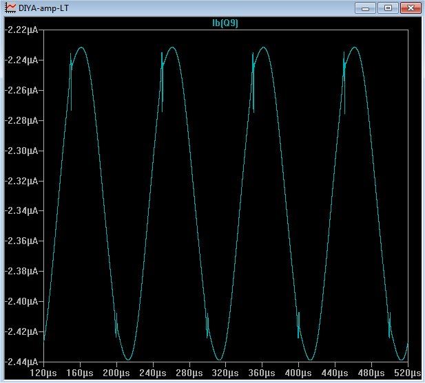

Have the nano and pico been swapped?
Low leakage is the requirement for the Baker clamp.
pico is smaller than nano.
The reason I used nA and Picoamp was because of the simulations.
The bav20's spec states nA , it simulates as pA. That is just one model.
My reason for the 250nA recommendation - simulating my various diode
models... showed 250 was where one could just notice a degradation
at PPM level/20K. Using stock 1Nxxxx diodes is not an option , these
simulate at the uA level and cause a major THD increase.
I have not acquired any pA level diode models , but have seen various SMD
devices rated as such. The SMD's might be good to upgrade a V2.2/2.3 PCB.
My BAV20/21 are good enough for V2.4 , they just add a few PPM. 🙂

Good diode !
The 1n3595 shows 400pA leakage with small signal/no input and
1-2uA at full power(below) .
The BAV is much better , 30pA/500pA .... but this would do in a pinch.
THD is doubled from 15ppm to 32ppm ... but this is not a "gross"
degradation.
PS - glitches in plot is OPS X-over point feedback.
