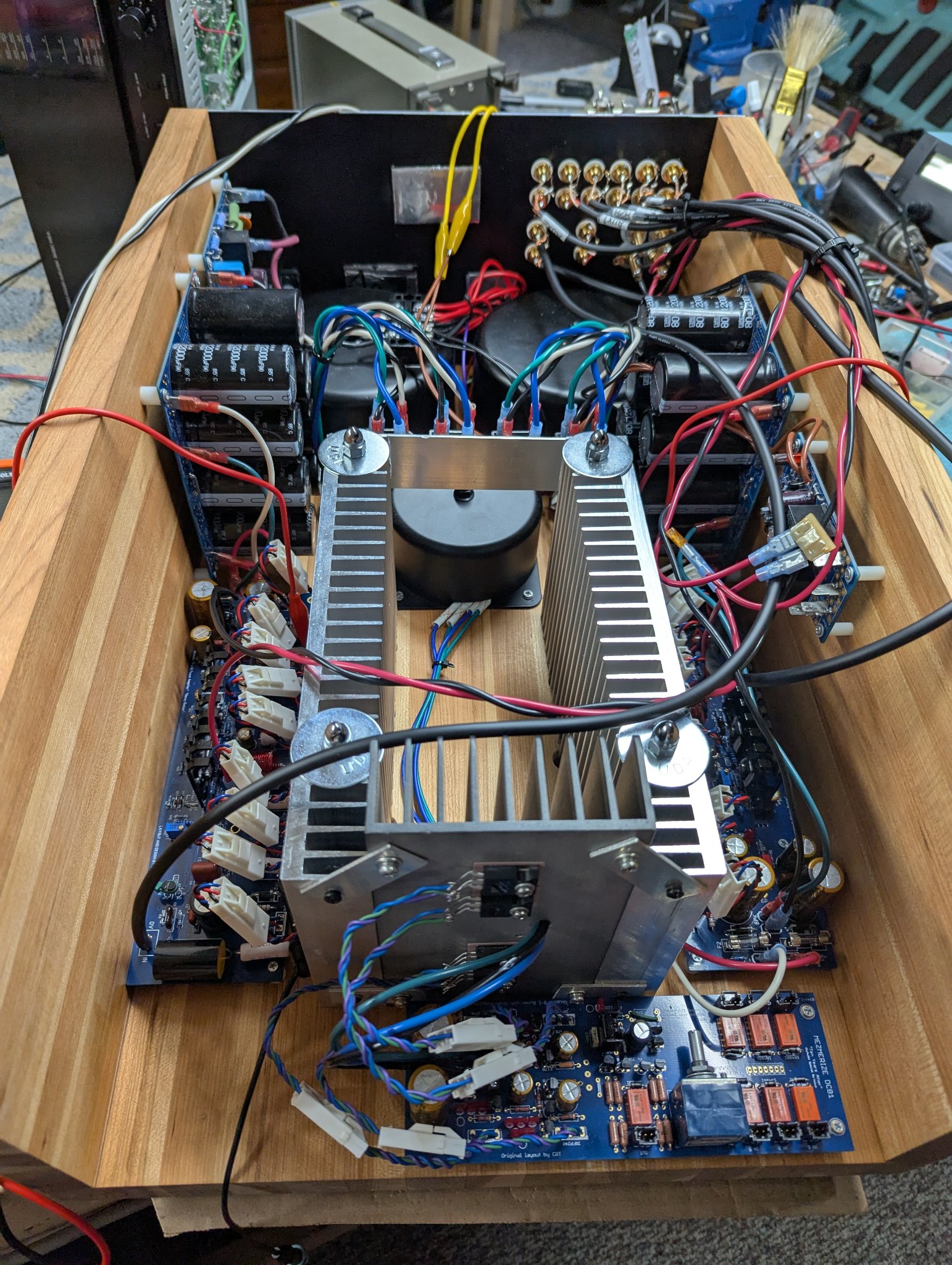

I finally reached the test phase of my Honey Badger build. I have bias set to 30mV between TP1 and TP2. DC offset is 1mV or less. Voltage drop across R14 is 8.25v. Hooking up my signal gen at full blast I'm only getting around 60mV rms on my scope with resistors. I hooked up my tablet and at full volume I can't hear anything through my test speakers. The Main In connections do have the grounds tired together if that matters.
Does this need a voltage gains stage before it? Is something wrong? I also have a Mezmerize buffer that I plan to use but it is not hooked up for these tests. I fully expected the tablet to get quite loud. I have an Amp Camp Amp and it just has a phone without a preamp that gets loud for what it is. Any Ideas where to start looking?

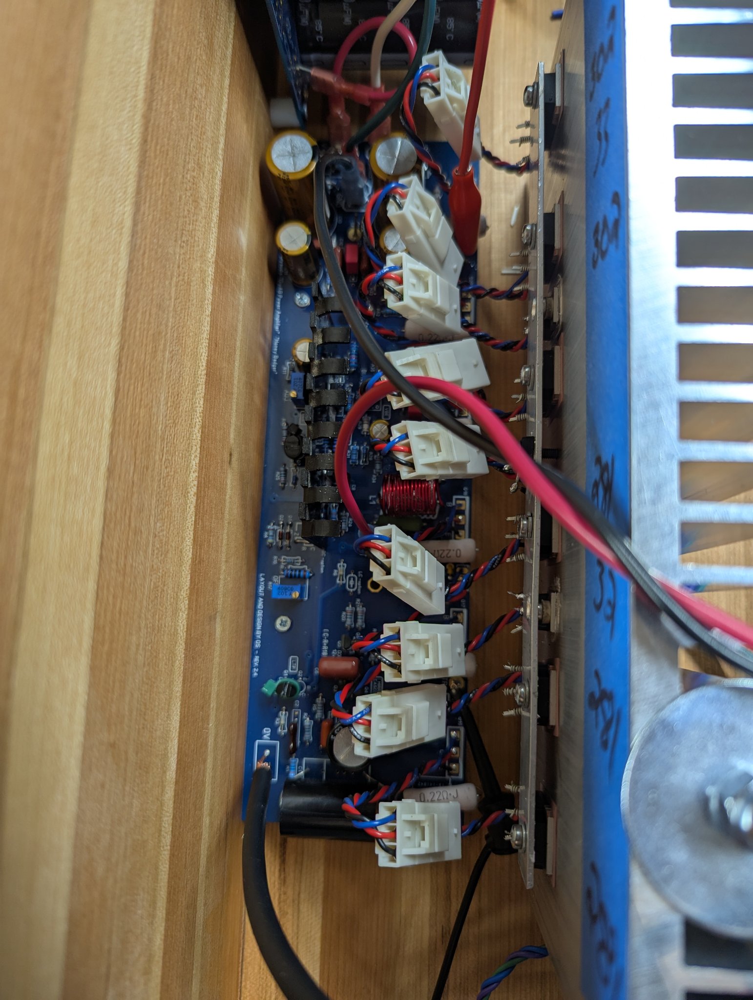

Just observing, in the 2nd photo on post 2784, there is a 0.22 ohm source resistor that looks like it flamed. Hard to tell with the picture angle.

Like others have already mentioned I would be cautious of long leads from the PCB to the output transistors as it can produce an oscillator. I also note that the bus bar appears to be close to the bent leads of the output transistors which in and of themselves have wires twisted on the leads. Hard to see with the viewing angles provided, but a possibility for potential shorts. Your fuses haven't blown, you have bias set, and you have a low DC offset so double check that the input signal is getting to where it needs to go and trace it. You might have a cold solder joint somewhere where the AC signal is passing through. You can use a signal generator set to a low voltage, say 100mV RMS and follow along with your oscilloscope. Alternatively, you can use an AC RMS voltmeter using the schematic as your guide. Post 2160 by member stuartmp I believe has the updated schematic.

I went back and read through many pages and realized my is something wrong question is quite stupid. I initially powered this up on my dbt missing a .68uf cap and a 15ohm resistor. I do not have a 15 so I used a 18ohm. I'll remove connectors and see how I can solder the power transistors as close as possible to the board. Really not trying to buy all new transistors to mount right on the board
I do have signal through the input cap but didn't trace farther than that. At this point I'll rework the transistors before I waste any time signal tracing.
Reactions: poseidonsvoice
Well pick it apart. What don't you like? I knew the flying leads would be controversial but I have Kenwood Basic M2a to repair and it uses flying leads. No connectors but power transistors mounted to heat sinks wired to the board. Mine is in the test phase with the buffer not even connected yet.
