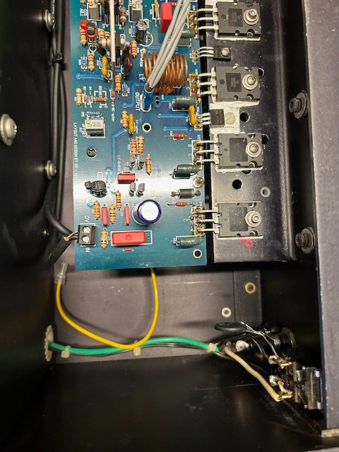

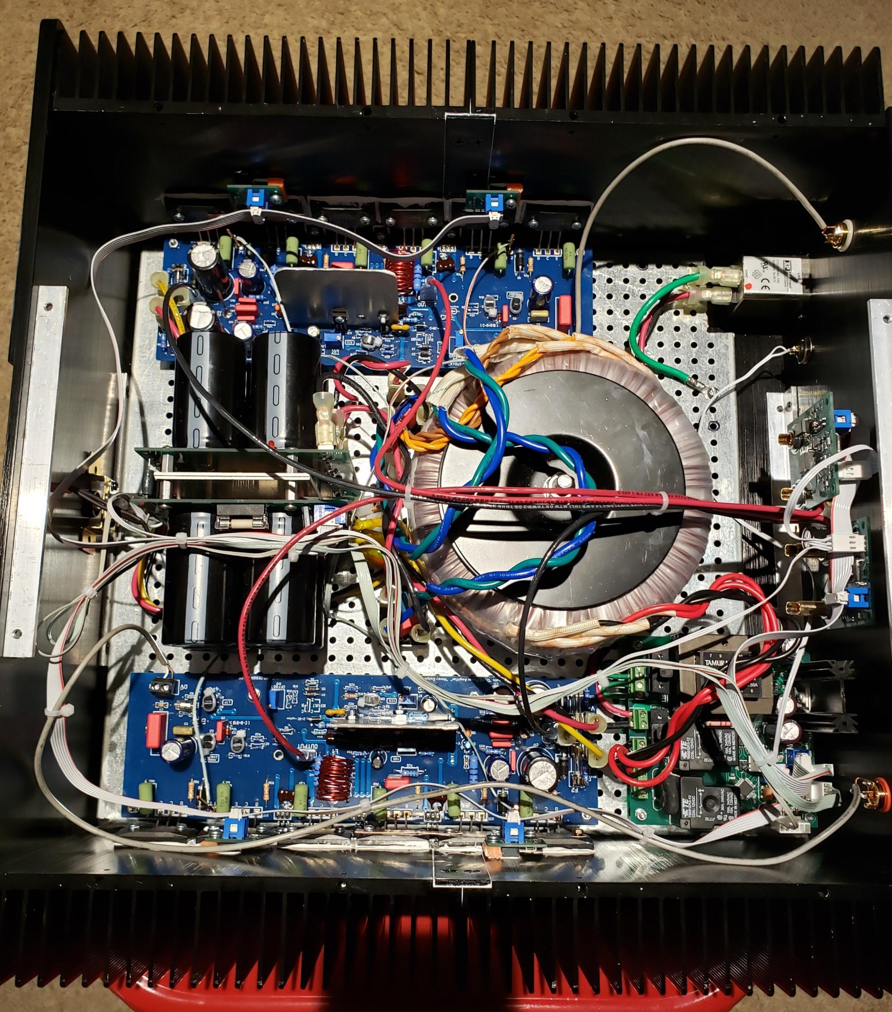

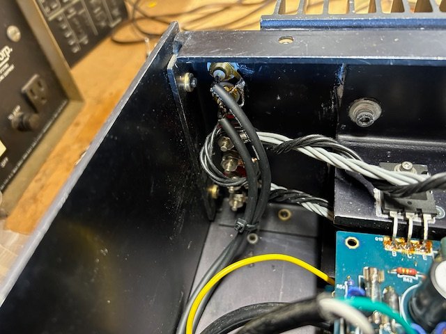

So don't know if right forum for troubleshooting HB?? I have one I built about 5 years ago, still working like I remembered it. But in troubleshooting other amps and learning how to use REW i have noticed that I have 60hz hum. Very low level only hear it with my ear right on speaker. Measures -75dbFS with inputs shorted. Inputs isolated from chassis, mogami coaxial with braided shield, DC power wire to boards is twisted. I do notice though that the speaker output on the board for out and ground is about 5 inches or so apart. So the output wire to speaker connection is not twisted nearly like I would like due to the separation? Not sure if that could cause a problem though. One question does R4, 5ohm function as a hum breaking resister? And if so could I try increasing to 10 ohms or so??

Hard to tell from the pictures. I'm seeing two channels, stacked on top each other. In first picture, powers supply is at bottom of picture out of the picture? Also not 100% certain, but do you have your power supply wiring parallel to your input wiring all way down the left side of the picture?
Well had a short video to show the whole Amp but to big to load. No power and signal cros paths at one point only and about 2 Inch apart. Do you have any noise with your HB at all? Even very quiet? I have separate DC power wiring to each ch all way back to power supply caps. That caused noise in last Amp and I ended up daisy chain. Much quieter. What did you do with power to two boards?
Yeah and I might just be over reacting too. I listened to this for years and never worried about any hum. Couldn't hear any unless ear right on front of speaker. Just have a new measurement tool and looking at levels that technically should be lower compared to industry comparisons. The last amp, which was worse, I was able to improve by 40ish dB. A big difference. So just looking at other amps now.
What about R4, do yoyu understand what that is doing. Looks like HBR to me??
The Honey Badger is my first amp build the wiring is not good, but it is quiet so I'm not changing it. I currently use it for 20-200Hz on a bi-amped system. I made a LOT of mistakes on this build. Not mounting the boards vertically and the wiring is terrible, but like I said, works great.
