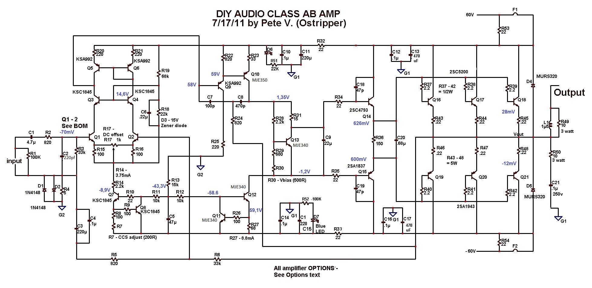

Just finished building the boards , adjusted bias, ccs and offset.
Plays, but very very low sound,
I know i have good enough audio source.
Where to start looking?
Must be something in the input stage that does not amplify enough
Post the schematic with all the operating voltages. badger is a design that "just has to work".Where to start looking?
Typical me to get a fault no one have experienced before me lol. here is a schematic with my measured voltages
Read the voltage across R14 ,R27 , want to establish operating currents.
Oh , BTW are you using a small or large input cap , I think there is a bridge
you have to jumper for cap size. ?
Does this happen on both channels ?

Q15 emitter should be at about -550 to -600mV since its base is at -1.2V, the measured +600mV value is not correct,
indeed there s only 26mV at the ends of R36 wich amount to only 173uA while it should be something like 1.2-1.3V
and about 8-9mA, possibly that this transistor is not functional.
Are you sure that the 600mV at this transistor emitter is not a typo and that it s actualy -600mV ?
Because there s still 54mA flowing through R48 but it s impossible to draw a conclusion since there s
no mention of the output DC offset.

I find it very helpful to measure output stage voltages with respect to the output. So negative of your meter to the output (L1, R39). Measure your voltages from that point. Your readings will be clear and accurate.
Measuring DC offset is normally your first measurement if you aren't drawing high current.
Yes , cool.I found the fault, it was like you said ostripper,
Top 5 Badger issues , that has got to be 2 or 3 ....i use a large cap on c1 so i had to jump the connection on the backside to connect it.

I tested one of the amplifier boards today and it played like a champion. The other one had a accident under previous testing for faults. My own mistake, one of the silpads got damaged after x amount of times taking the board off and on tothe heatsink, so i barbequed some of the output transistors and one of the drivers. But that is a easy fix. I have enough parts in stock to make 20 honey badgers so. So a reminder to myself, check every time if there is connection between the heatsink and the output transistors.

People must take care to the fact that 80-120V is just separated by thin mica or Sil-pads. ALWAYS check continuity betweensilpads got damaged after x amount of times taking the board off and on tothe heatsink,
collectors and HS/ground.
