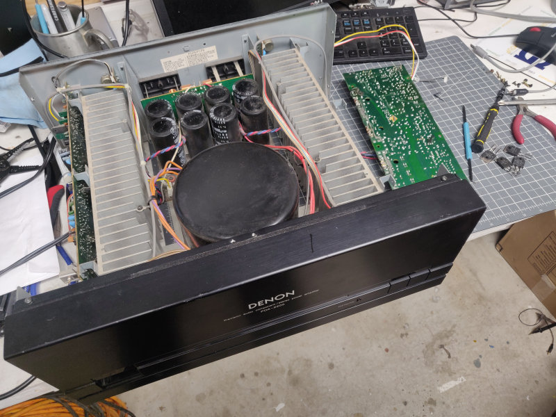

So while the boy solders up the next set of HB boards, I am thinking about a home for them. I have decided to sell my denon poa2200 amp, as the existing honey badger sounds significantly better. I got the Denon used cheap, as it didn't work, but a couple new outputs was all it needed. But I got to thinking, the Denon would make a PERFECT home for some honey badger boards. It has a huge transformer, has huge long heatsinks, and it looks like it would be pretty close to a drop in. Just drill the heatsinks for the HB, and intsall... The rails are +-72V and it has 4x10,000uf filter caps for each channel. Power supply is split into two after the transformer, effectively giving it dual mono construction (shared transfo though). I can't really think of a reason why this wouldn't work...
Here is what the denon looks like with it's clothes off...

Don't underestimate the time and cost of purchasing and machining an enclosure.
Using the Denon will save you money and time but really depends on your goals.
Do you want the satisfaction of building an entire amplifier from scratch including case or are you happy with recycling?
If it were me having built several amps now, I'd be tempted to recycle the Denon and maybe replace the power supply caps depending on age
