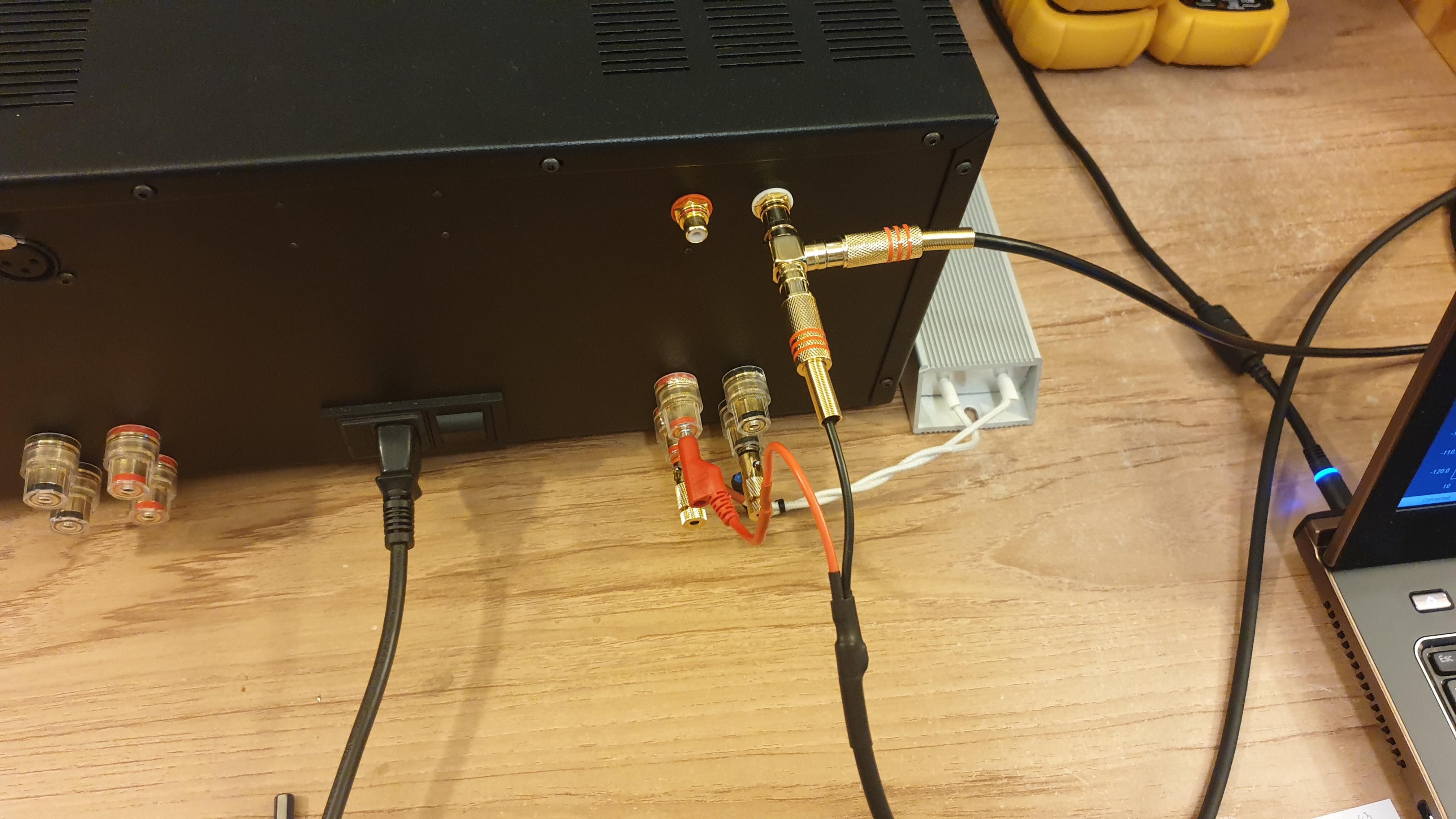

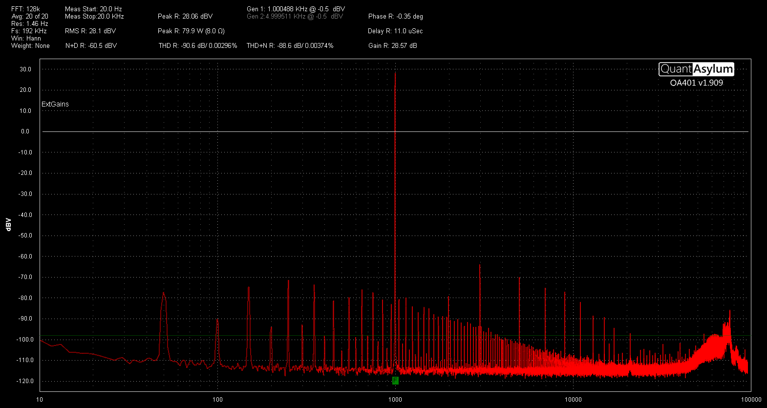

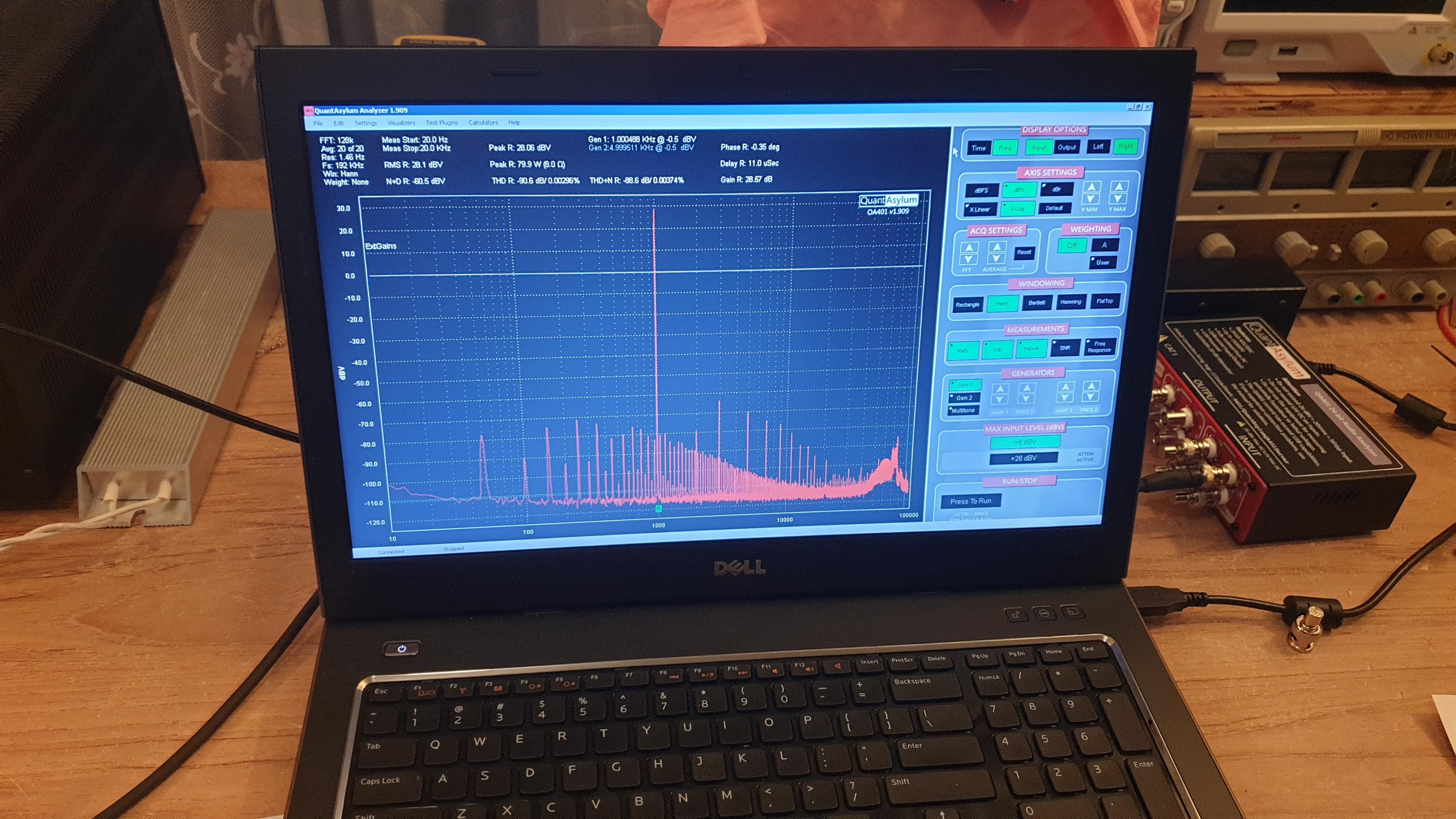

I just thought that I would share some information & photo's showing the distortion measurements of my Honey Badger using the QuantAsylum QA401.
I only received the QA401 last week, and so far, I'm very happy with its performance.
I initially ran some loop back tests and discovered that the lowest THD levels were achieved with a input level of -10dBV and the lowest THD+N levels were achieved with a input level of 0dBV.
I was able to see a loop back THD distortion of 0.00025% at -10dBV input level and a loop back THD+N distortion of 0.00090% at 0dBV input level.
So I decided to try and find a common input level where I could still achieve good loopback results. It turned out that -5dBV was the best choice.
At a input level of -5dBV I was able to achieve 0.00037% THD and 0.00082% THD+N respectively during a loopback test.

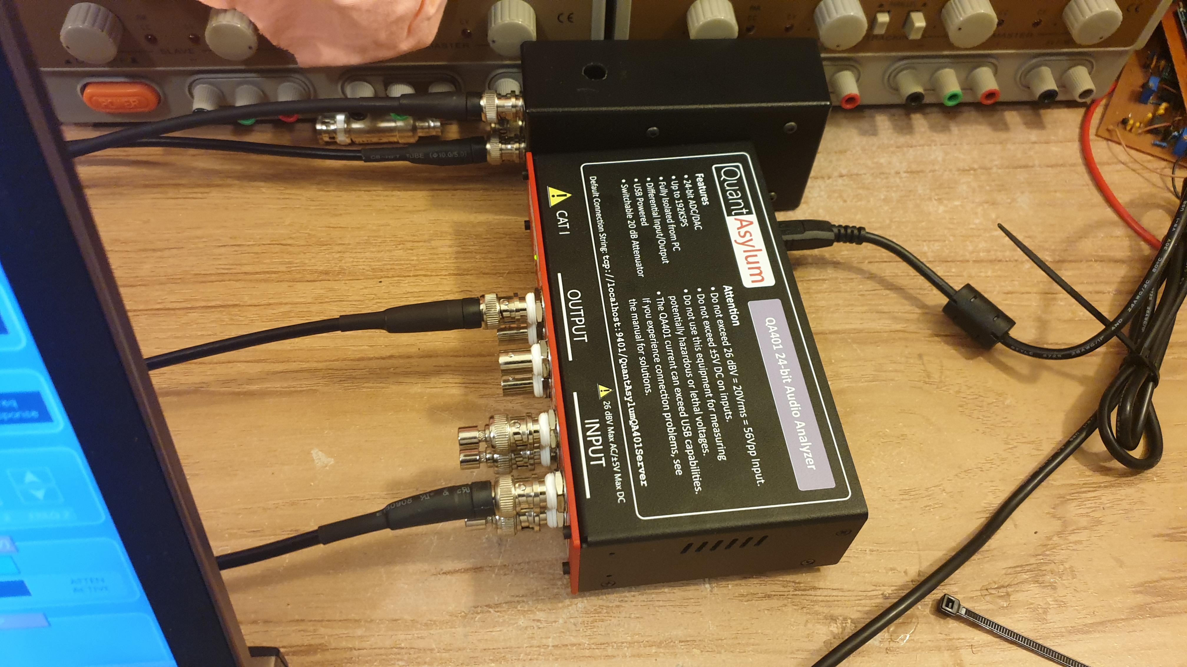

I then accurately measured the gain of the Honey Badger. In my case it was 28.52dB or 26.6667 AV.
I wanted to test the amplifier at a medium power levels to begin with so I decided 80 WRMS into 8 ohms would be a good starting point. This equates to an output level of about 25.29V or about 28dBV. I also needed to make some type of attenuation circuit to drop that output level down to -5dBV so I could optimism the readings for the QA401.
This was done by making a L-Pad attenuation circuit. It's the little black box behind the QA401. I created a spreadsheet to do the calculations for me. See the attached zip file if your interested. In future I will install a 6 position switch with different attenuation levels so I can run a range of output levels and still have -5dBV input into the QA401
I then adjusted the Input gain level of the y-axis dBV scale on the QA401 so I could see the output power level on the display of the QA401.
The math to set the right level in the input box provided was 28.52 dB (from the Honey Badger) + 5.1 dB (which was the input level that I was getting without and input gain level adjustment due to my attenuation circuit) - 0.5dBV (which was the output level of the QA401 that I needed to achieve a output level from the Honey Badger of 28dBv or 80WRMS) this gave me a final value of 33.1dB
The results were very satisfying and a great starting point for further tweaking and measurement. I have attached a few images of my setup and the result plot.
I was able to achieve a reading of 0.00296% THD and 0.00374% THD+N.
To be honest I have no idea how to interpret the rest of the distortion levels and the harmonics caused by the 50Hz on the power supply.
Is this normal or is this an issue?
I would love to hear some feedback on this plot and what you guys think.

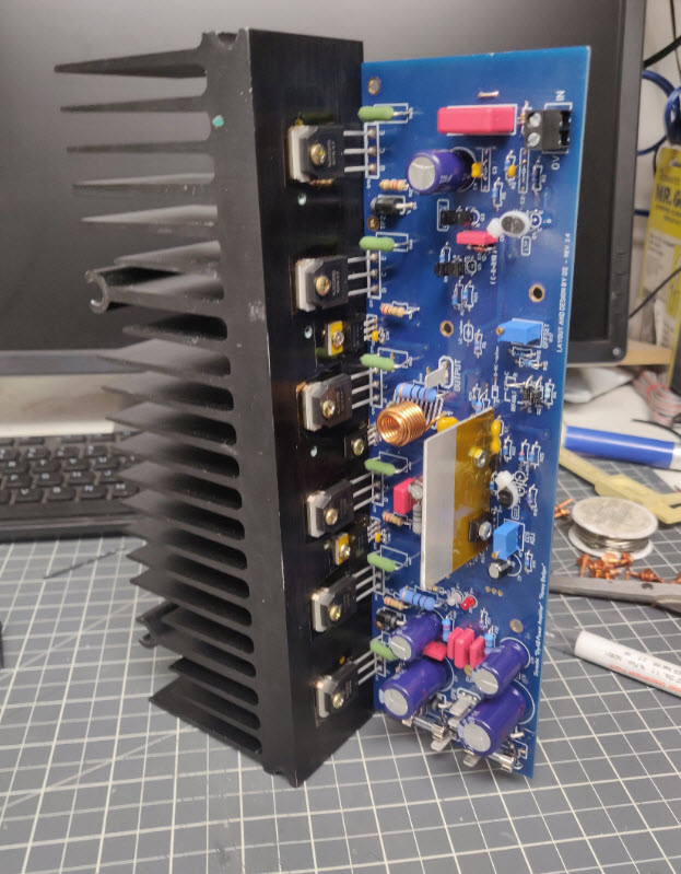

My amp went pop last night. I am assuming in the same manner as the other day, but this time I was around to witness it. It had been playing for hours, first, sound for a hockey game, and then about halfway in the 3rd album in a row it went pop. For the first couple of hours, I checked temperature, and it was slightly warm. Checked again a little while later, same. And it was sounding great.
Now that I think about it, I did hear a little bit of ringing in the higher freq piano not long before it went. I thought that was a little weird, because it definitely was not there earlier in the listening session. But flash pop it did, and one channel died. I powered the amp off, and it was HOT. Why would I have gotten the thermal runaway? All the transistors were firmly attached to the heatsink. So I don't think that was my issue this time, (or last time).
Amp setup and options;
I set bias v to 28mv across TP1 and TP2, and dc offset was between 1 and 2 mv for each channel from spk gnd to output. I was able to set the tail current to 3.75ma, and 8.25v across r14 per the build guide.
I am using transitional miller compensation, and have the cascode and current mirror voltage set using the luxman way with 22k resistor at r18 instead of the zener option. My input transistors are matched mpsa18 (thanks Longspeak). Output transistors are on semi from mouser, njw3281g, and njw1302g. The board that is giving me trouble is using drivers mje15032 and mje15033.
My understanding is that matched output transistors is not a big deal, as the emitter resistors compensate for mismatched hfe.
Could the heatsink be too small? And after 1.5 hours, its fine, but after 3 it's just not enough? Its a big heavy hunk of metal, and there are fans that run underneath pushing the warm air up and out of the chassis.
Does the ringing I noted later in the listening indicate oscillation? I would like to test for oscillation, I have an analog scope. I have googled how to test for oscillation, but most of the posts just say to look for oscillation, or look for fuzziness at the top of the waveform. Is it as simple as that? Feed it a 1000hz signal, and look at the peaks for fuzziness? Tray again at a variety of signal frequencies? Or is it more obvious than that? I don't have a suitable dummy load resistor to throw on the outputs. (will add to next mouser order though). Would love for this to be a learning moment, and really figure this out.
Last thought, I have not cleaned up and properly tied off my wiring yet, could the birds nest effect be creating some capacitance that leads to oscillation?
Thank you for your help.
Looks like your using a zener in the photo that you attached.
I had oscillation due to R19 and the zener diode being to large a power rating.
Check out post 4132 and the follow-up posts by Harry and myself.
this amp did not use any form of SOA protection, this is my main beef with this amp, if i were the designer i would have included a SOA protection scheme....
having said this, it is up to the end user to take precautions, do not drive the amp to clipping where spurious oscillations can happen...
clipping with an actual music signal can happen even if the amp was not producing that many watts as in a sine wave...clipping levels with a sine or music can be the same....
Your heatsink is sufficient for more than typical listening levels. If it was not hot after 1.5hrs then it should not be too hot after 3hrs so most likely you got intermittent oscillation. If your amp did not oscillate from the beginning then instability is often caused by driving amp into clipping but if you have anti-clipping diode it should not be a problem. If amp is oscillating Zoebel resistor gets hot or even burns. Anyway, with good scope you should see even very high frequency oscillation but if it's intermittent then you won't see it straight away.
Anyway, the main question is what caused this problem and if your board and soldering are fine then some of your components are faulty - or just one. So before watching what happens on your scope think which of your HB components are likely to be of poor (EBay?) quality because in the end you will have to replace these.
