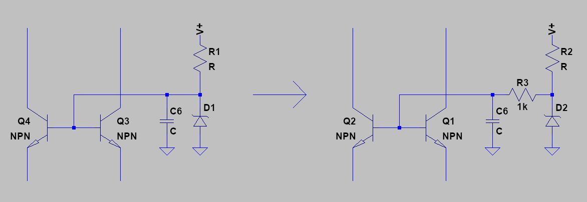

To stop any confusion (Tony) even though I made it clear in my original post that I was discussing the ZENER current - see simplified schematic attached for reference.

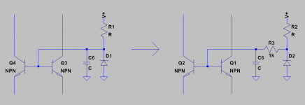

Page 19 here documents the skippy breakdown characteristics of zeners:
https://www.onsemi.com/pub/Collateral/HBD854-D.PDF
We don't know for sure this is causing the oscillation, but it is possible.
Another possibility is that the cascode is oscillating. What we know is that it goes away when removing C6.
So I propose the following modification. If it doesn't work, then move C6 to the other side of R3 and find a working value. If that is the case then it is likely the oscillation is caused by the cascode and not by the zener.

Keantoken I read the Onsemi article that you posted and they too discuss the knee region of the zener that I mentioned in my original post.
I still think that there isn't enough current going through the zener.
However your modified circuit makes sense and thanks.

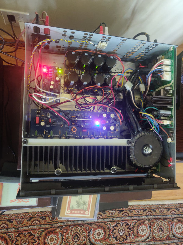

2 functioning channels. My idiocy that led to trouble, with a popped output transistor was due to not having the outputs on a heatsink, and having adjusted the pot for bias incorrectly. I had trouble fault finding, but found the fault last night, I was seeing very high DC offset. I yoinked the zener diode out of there and put r18 in. I didn't trust the drivers after the blown output, so I replaced them with a pair 2SC4793 / 2SA1837 from an old Yamaha. They seem to work fine. Amp fires up and idles. She is adjusted and is stable and produces a clean sine wave on the scope. Tomorrow is more testing, and then work on something else until the speaker protection board stuffings show up.

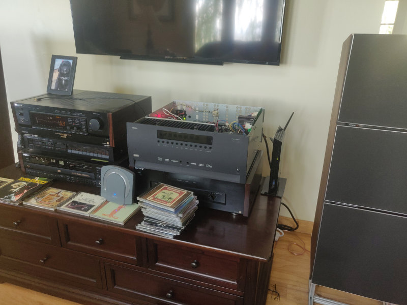

Honey badger cranking out tunes and shaking the house. To be done, add Vu meters, add power indicator led to front panel, add temperature control to fans.
It has lots of power, cranking the big bang and olufsens sounds great! Thanks Os for the design, and everyone for help getting it going. It's sweet!

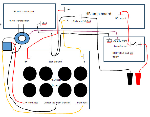

Does anyone know where I can find a diagram on how to wire PS and boards? I see a speaker ground but no other. I am use to building the PS section for the Firstwatt clones.
