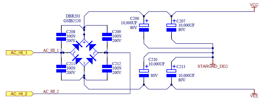

So I hooked up one channel last night, using a dim bulb tester, then with a higher wattage bulb, and then direct ac, and no smoke, so that is good. DC offset about 9mv. But... When I fed a 1000hz signal into the board, and checked the output on a scope, I saw that the output was riding on a large sine wave. I found the same wave to be present if I checked the signal at the case. (no 1000hz wave). I then disconnected the power supply from the transformer, and sine wave still present. Reading about 1.1vac. Rail voltages are steady and even at about 64V.
Gotta be a psu grounding issue right? I am using a monolithic bridge rectifier mounted directly on an aluminum chassis that is bolted to the case. The center tap wires (2) from the transformer are going to the PSU ground same side as +- from rectifier. Does this need to be isolated with an insulator? Other question is, does the ground from the capacitor board need to be connected to the chassis? Clean or dirty side? Doesn't matter because they are one ground...? The iec plug at the rear of the unit only has two prongs. The ac is present at lower voltages when connected directly to the wall. Maybe the huge transformer doesn't like being connected to a power strip that is connected to another power strip with like 10 other things on it.... lol.
Yeah, it stands still. present with amplifier board removed. Also present with rectifier and power supply caps removed. I have two additional toroidal transformer installed, one is the standby, and is required to power up the relays to connect the main transformer, and the accessories transformer (+-15v, etc... not currently used for anything). all three transformers have a ground line that goes to a common chassis point near the main transformer.

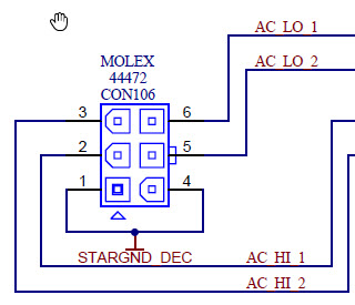

Maybe because there are two secondaries on the main transformer, I should only be running one of the center tap wires to the PSU ground. It would make sense that one center tap wire is for the high voltage secondaries, and the other for the lower voltage secondaries. So should I just be using the one for the High volt? Looking at the schematic for the arcam, I should probably be running the center tap wire to straight to the star ground side of the PSU cap board.
I have attached a schematic of the main psu diagram. I am not using c208, 209, 211, and 212.

The center tap is not two separate center taps. They both tie into the high volt. Guess one center tap is needed for multiple secondaries. Makes sense. Sorry for multiple posts. Tried to edit, but option disappeared. I bet I need to run a ground wire from the soft start board to the star ground.
Postmaster. Here is a pic of the wave I see at the case, or pretty much anywhere I else I poke around with the probe. I grounded the power supply soft start control board per the star ground in the arcam schematic I posted earlier. But a big high voltage sine wave like this isn't acceptable. Scope was on the highest voltage setting with the probe on x1. 5 volt scale on the scope. My noobness may be showing. I'm going to search psu issue threads. It's coming from the standby transformer, as with everything else unplugged, I still see the voltage. Thanks for bearing with me.

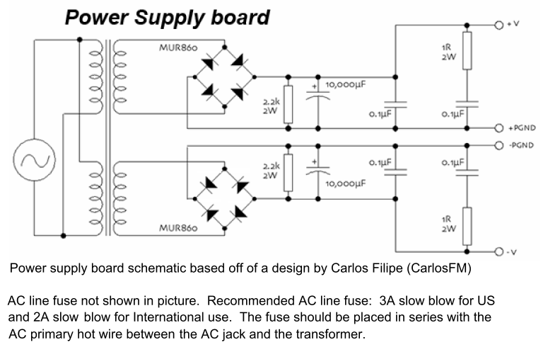

Why don't you use two bridges - one for each secondary wiring? It has more merits than the single one. The only price is about 1V drop.
