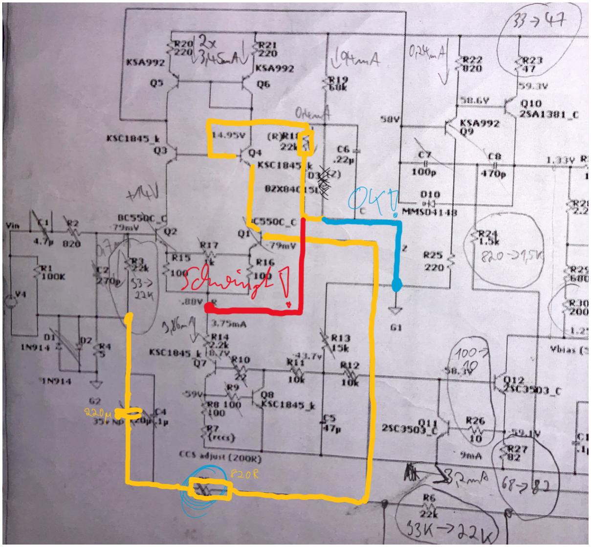

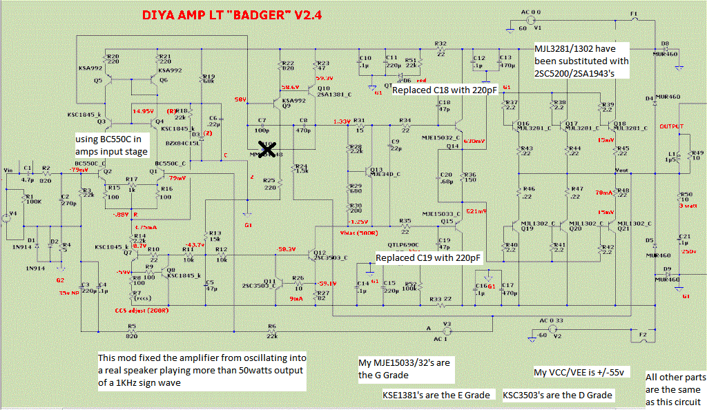

I have attached diagram with DC voltages and mods to remove oscillations one of our builders here had. This diagram was published some time ago. Measure DC voltages at these points as well as AC voltages (should be zero) on both boards and write them down. Problem is caused by some part/s behaving badly under DC so knowing where's the difference in DCs or AC apeares hopefully faulty parts can be roughly identified. AC can be very HF so good AC voltmeter or oscilloscope are needed but try with what you have.

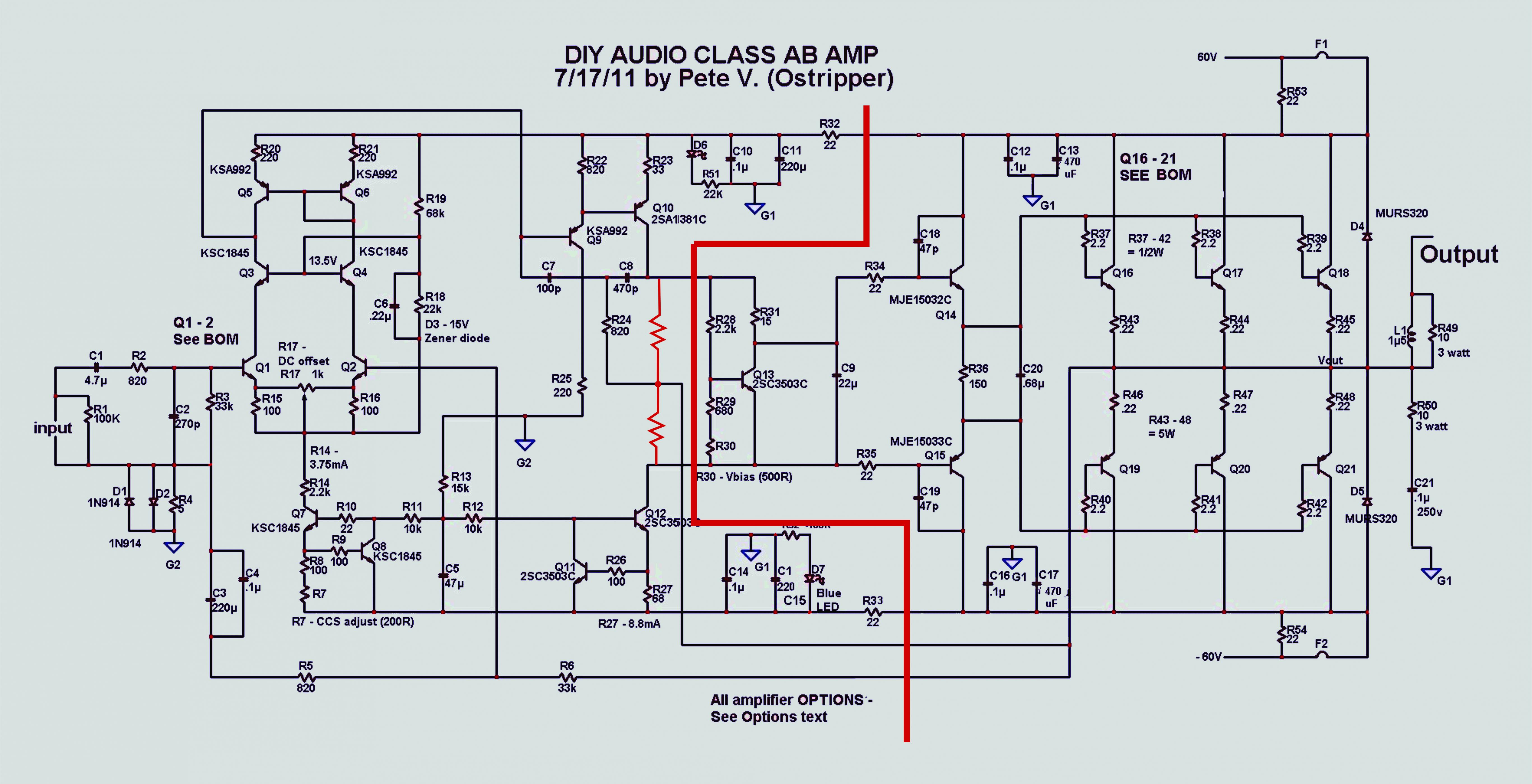

You got voltage mismatch on q1-q2 bases. It's source is either in ltp circuit (do you have resistor or zener there? are these grounded as in the first attachment?) or there's something wrong with your output like great hfe mismatch or oscillating driver. You may try to remove C6 (ideally should be non-inductive polypropylene).
Look at the second attachment and do this: desolder R31-32 (22ohm) on the power side. Remove q13 (bias) circuit and desolder R34-35 on one side just in case to disconnect drivers. Solder 1k resistors as shown in the attachment, apply voltage to ltp-VAS through R31-32 22 ohm resistors. If voltage on bases q1-q2 gets balanced then the problem is in the output, if not then the problem is in the ltp circuit. Source voltages look good to me, mirror voltages as well, similarly VAS. There are no miracles, one or more components are faulty somewhere.
cheers,
