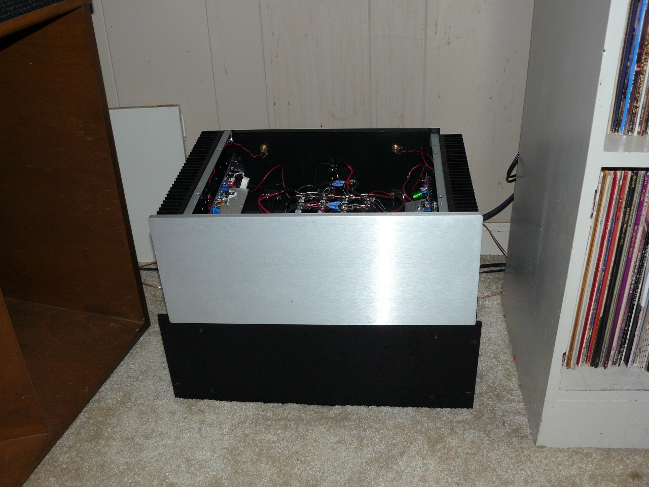

On second though to at least to prove it is real a long range shot. The big white resistor on the left side is one of my oops with a 10 ohm 3 watt resistor that smoked. Stuck a 10 wattone I had in stock in until the correct one comes in. Still a work in progress but it is alive and playing nicely. Sitting atop a FW clone.
The one fault I had with this build was it had entirely too much gain for my 103db speakers. Using the FW B1 buffer with no gain I had practically no control of the volume. Just a touch open and it was almost too loud. A linestage with gain would be out of the question. This morning I decided to add some resistance to the input and first put a 10K resistor and it helped some but not enough. Right now I have 60K ohms and it is manageable. An added benefit is now the amplifier is for all intense and purposes dead quite. With all that gain I figure it must have been picking up noise from the source or buffer. Possible even the cables attaching everything. Much better now and I think I could go to 100K without any problem. For now I am going to leave it alone and try some of my tube and SS linestages. Sounds fantastic now and I general favor class A. Probably more to do with what my mind knows about class A rather than what I am hearing. But then the amplifier is probably not getting out of class A with my speakers. More to do with BJT sound vs mosfets vs tubes. There is a difference in the sound between them. Happy camper now.

And the sound. I am really getting into the sound of this amplifier. Quick, dynamic with great soundstage and centralized vocals. Nothing harsh sounding at all and my horns are notorious for hearing anything harsh. I am really liking the sound and only wanting to hear more from it.
I got around this morning to checking my amp some more with scope and Arta. Everything looked good on scope. Did not check when clips being that I only have 100W resistors. Noise and distortion on Arta was pretty much at the limit of my signal generator 80db from signal. I put the cover on this morning and am calling it good. Time to do more listening.

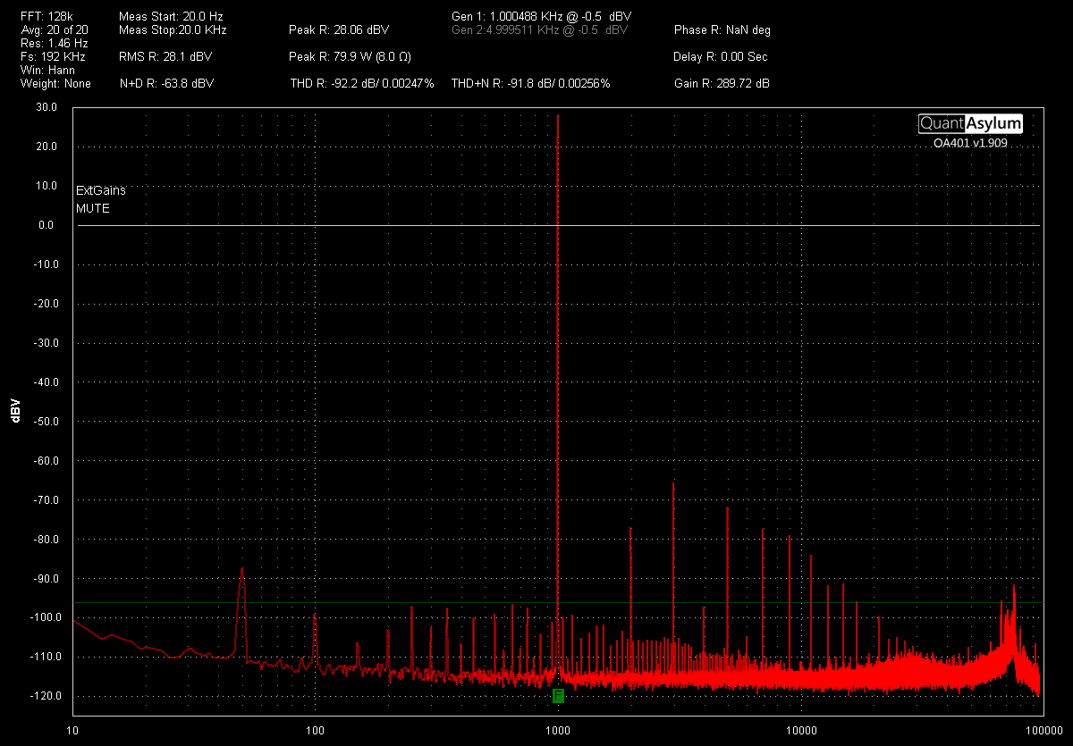

Updated Distortion Measurments
Hi Guy's
Just thought you all may like to see what this amplifier is capable of.
I just upgraded the snubber networking in my power supply using the
Quasimodo Measurement Jig to set CX, CS and RS correctly.
I'm very happy with the results so far and have a few other mods planned over the next few weeks. So I'm hopeful that I can reduce the THD and THD+N even further.
