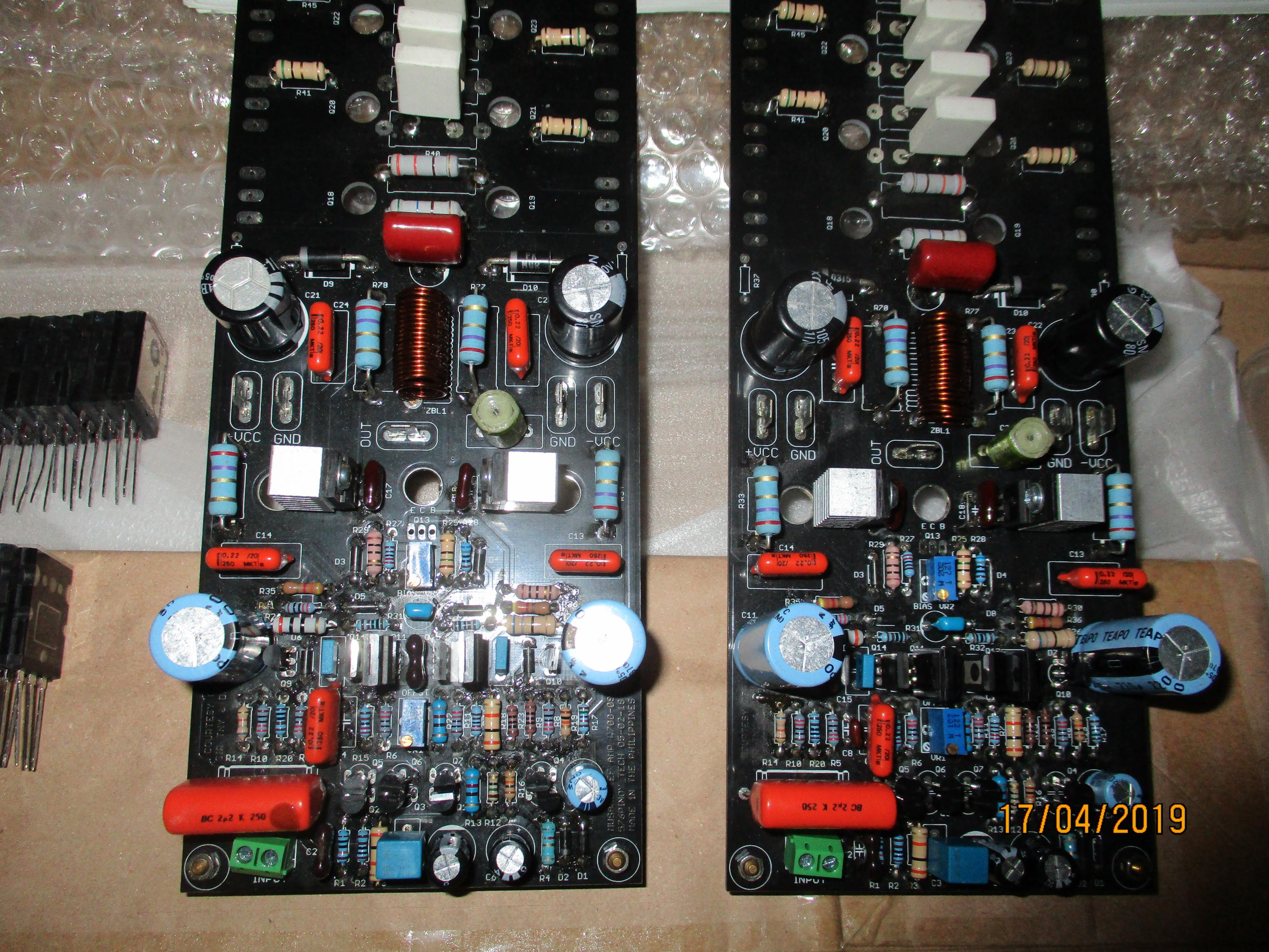

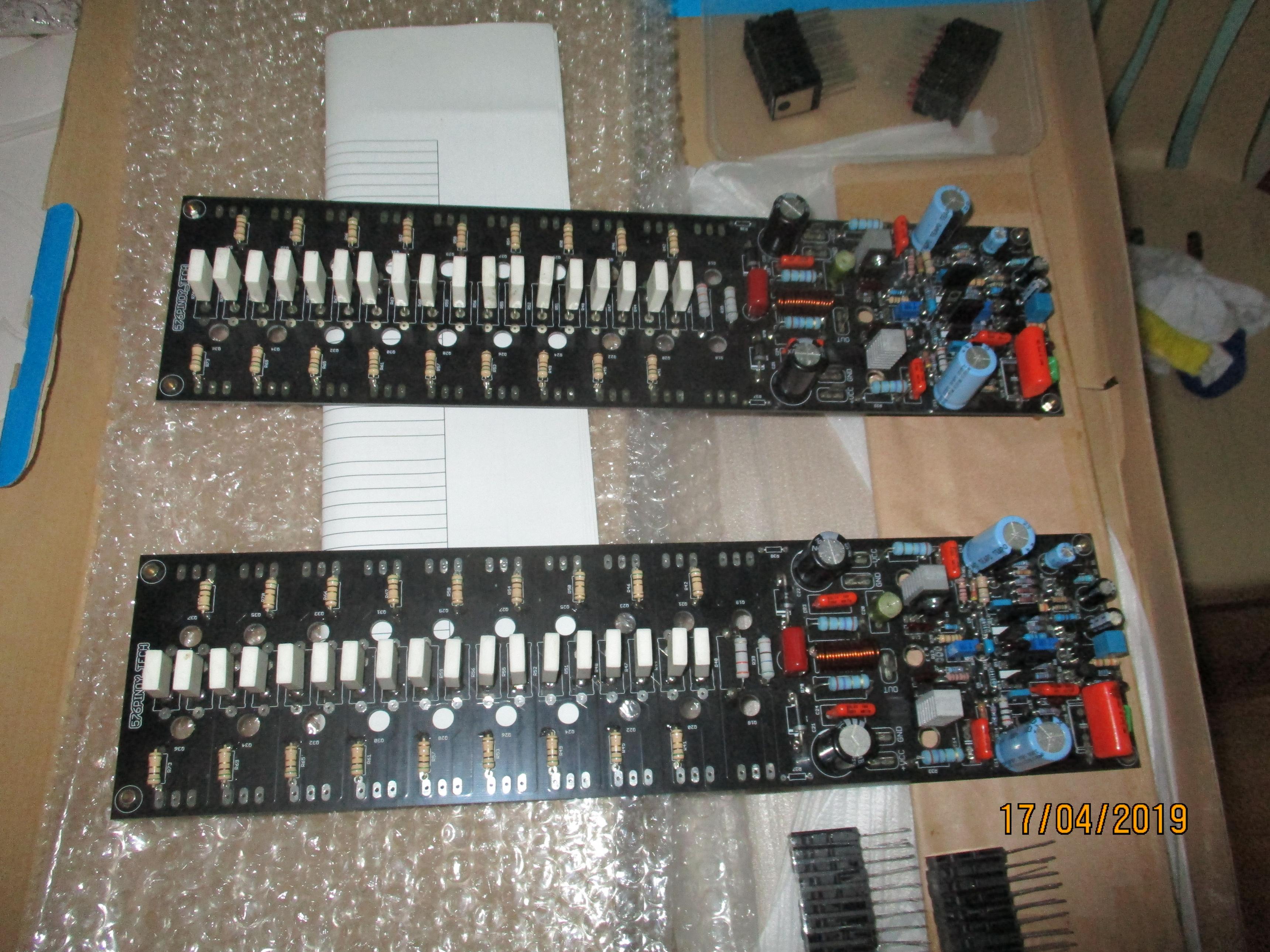

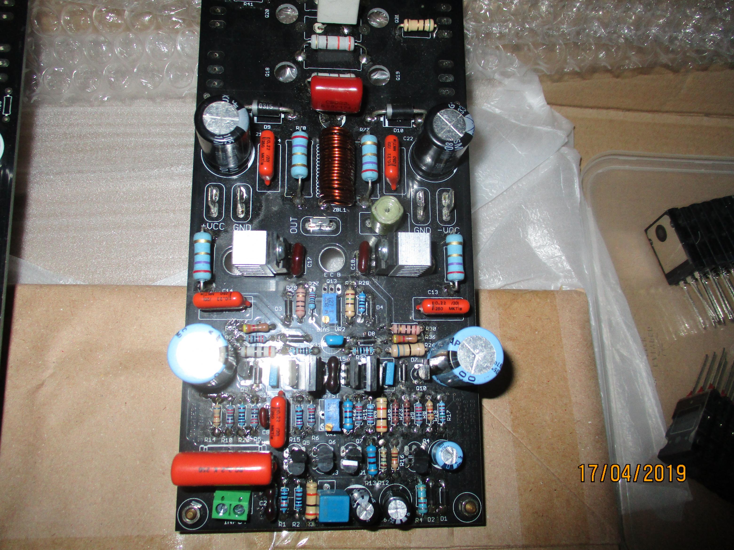

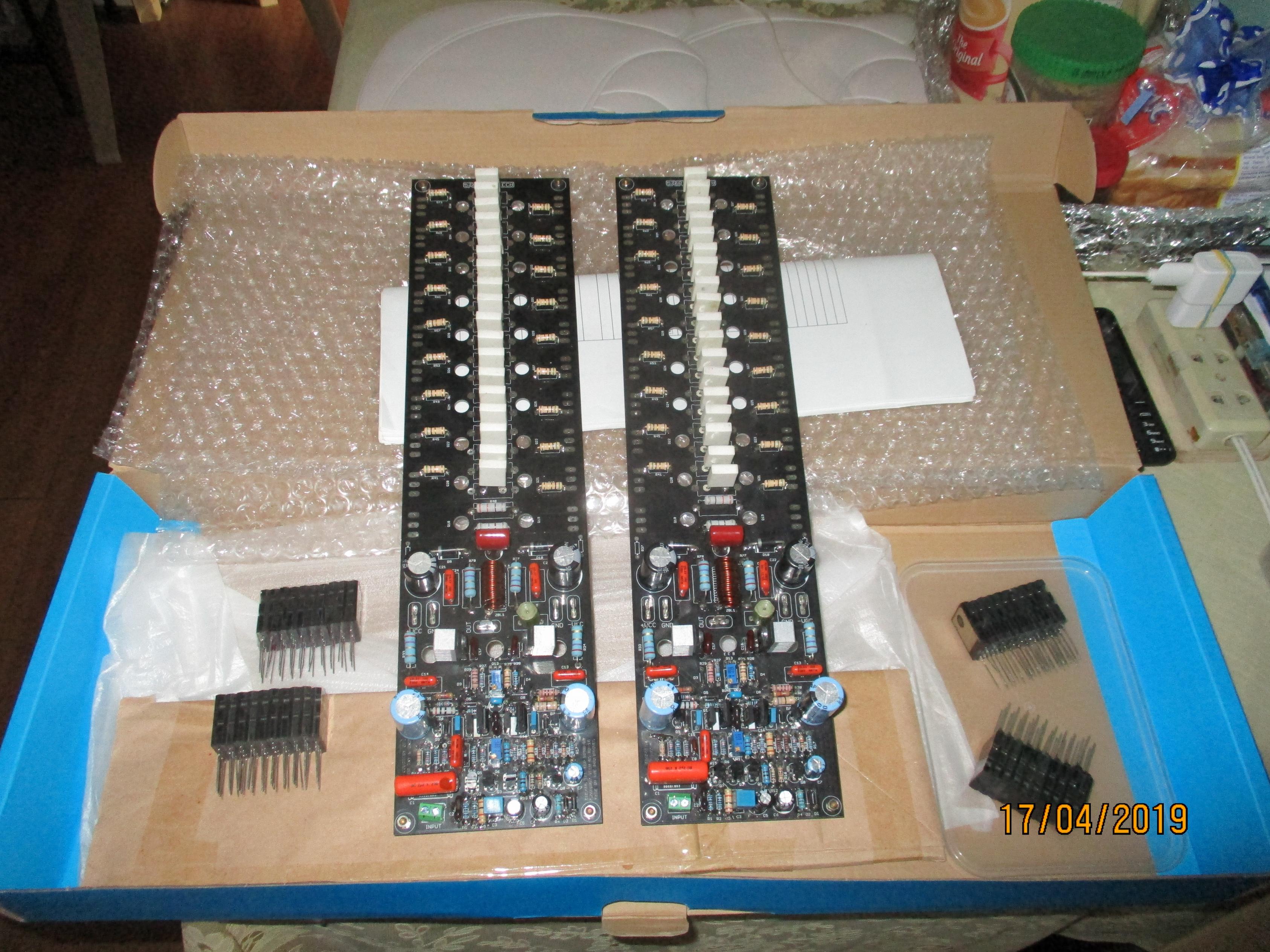

i built a multi pair version with SOA limiting circuit...
