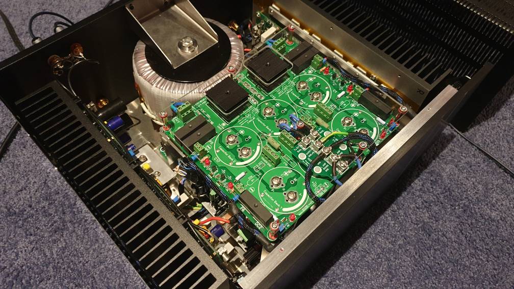

My current setup. To my knowledge it follows exactly what Bonsai recommends.
But I'm very interested in investigating Harry's setup. Screenshot_20200427-212926.jpg20200427_190044.jpg20200428_194507.jpg

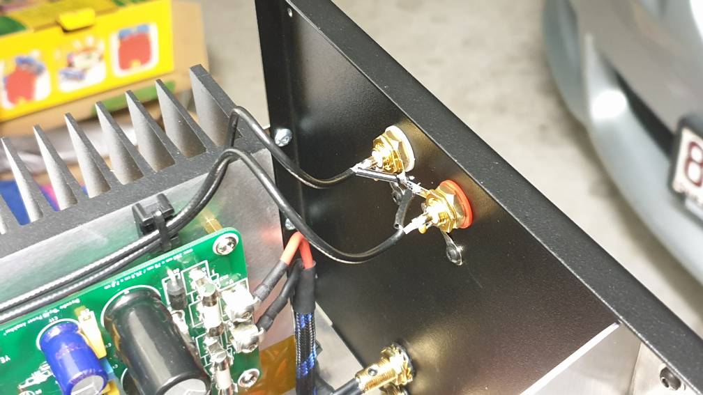

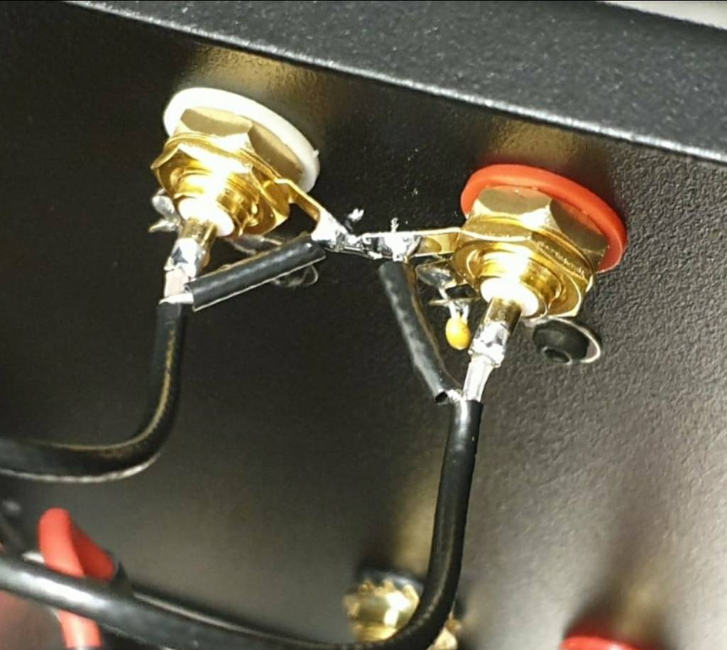

The cap from the bonded shields to the chassis just ensures that at RF the cable screens are effectively shorted to the chassis. Without doing this you can run the risk of RF entering the amplifier housing and radiating inside. With the cap, the cable screen and the source and receive equipment are a single enclosure to RF. Without the cap, this is not necessarily true.

This input ground should not be connected to the chassis.
Ok. I guess that I read this as the input ground should not be connected to the chassis at all.
But from your own schematic I see that what you where saying is that the input ground should not be DC connected to the chassis and using the capacitor as Bonsai recommends to AC connect the signal grounds to the chassis through a capacitor is necessary for the reasons Bonsai gives in his document and his posts above.

Yes the cap that goes from the RCA to chassis stops
RF and other high frequency noise etc. In a very rare case that I saw, about 15 years ago this cap was needed to "stablise" the input in an all FET amp as no other solution could fix the problem.
That is why I recommended it to you Stuart. However none of my amp builds have this issue.

PS I forgot to mention that I have not had the need to connect a capacitor on the RCA connector, for my amp builds.
However each DIY amp is slightly different and different solutions are needed.

I've looked at your photos and your build is excellent. Congratulations as this is your first amp.
I assume that you're wiring diagram has changed and that the ground wire from the RCA socket goes to the amp pcb. Otherwise you have a loop.
I noticed that your shielded wires, are long. Those caps on the RCA socket that I recommended must stay.

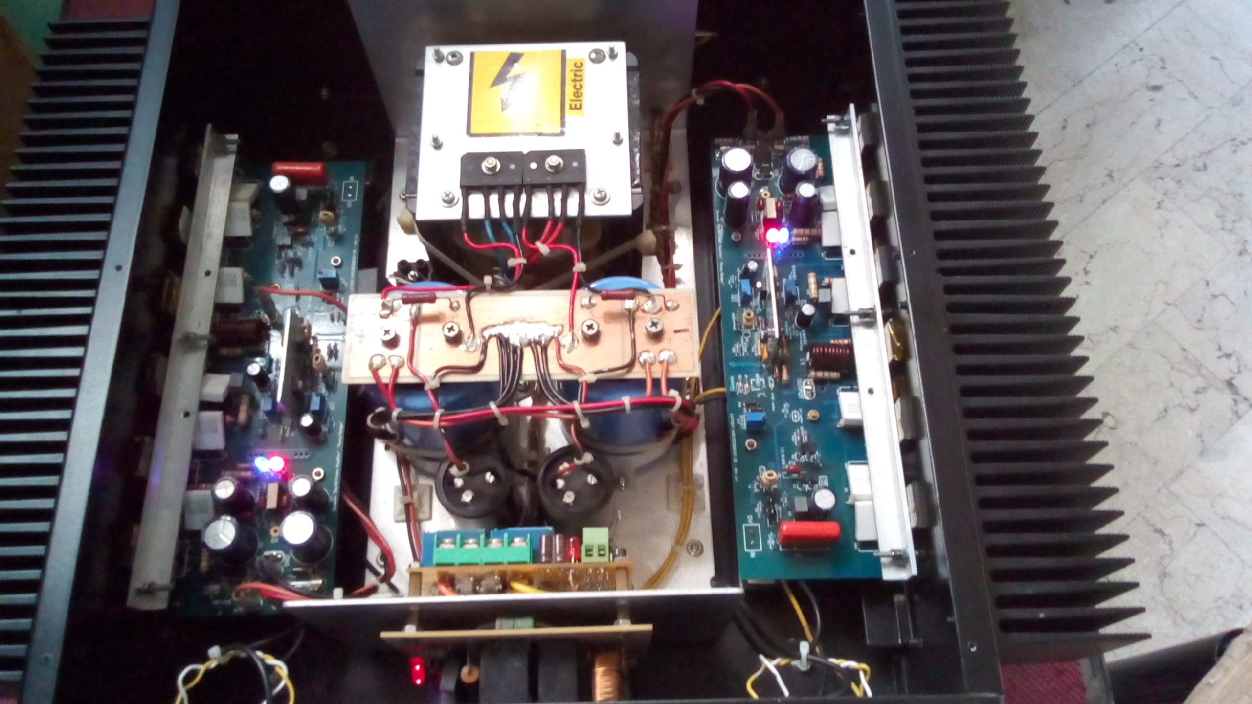

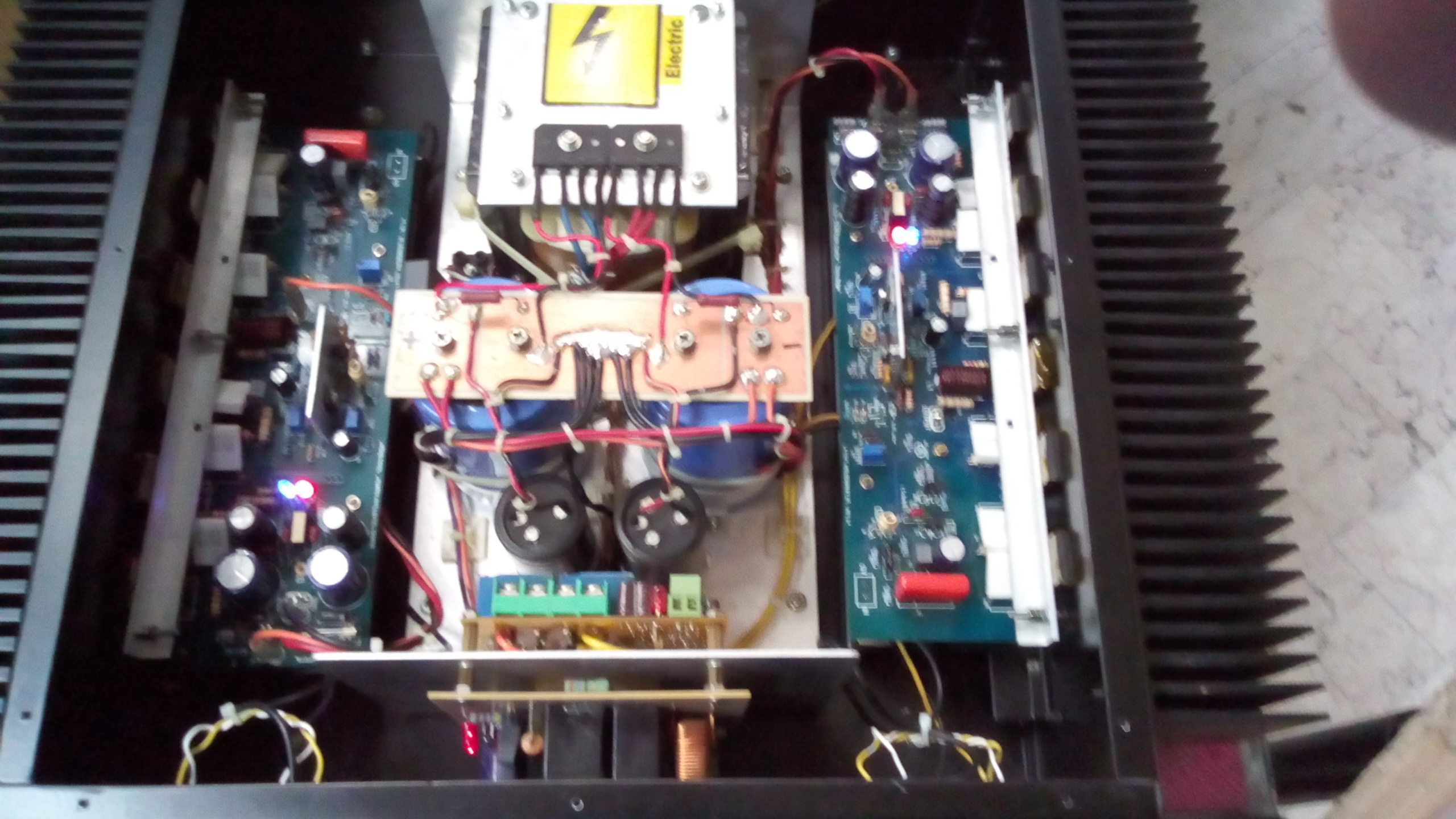

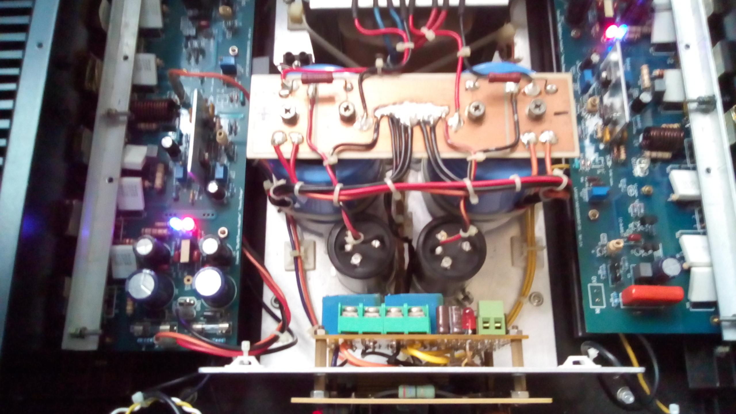

these are the grounding rules i live by:
1. each power supply lead have its own ground return wire to the central ground point..
2. signal wires used as return wires go to central ground point and must never be used to carry current..
3. the speaker ground return wire to zero is never routed thru the pcb grounds the pc board ground goes to the central ground point.
4. the junctions of the main psu filter caps form the ground zero voltage point.
5. this is new, but i have stopped using transformers with center taps, i use a dual bridge configuration...
6. i twist psu cables where practical...

Hi Tony,
I basically agree with your comments however I do have a question.
1. Agree
2. Just one question- OS designed the PCB so the ground wire from the RCA goes to the input of the amp board. You elected to take that wire to the star earth point. Did you have issues as this might help Stuart?
3. Agree but with some amps the speaker return goes to the amp PCB without issues.
4. Agree and from there if you want or it's necessary you can go to a ground lift.
5. Agree - two separate windings on a transformer is much preferred.
6. Agree
Edit - did you short the input grounds at the RCA sockets? In my view this would cause a loop.
Hi Tony,
in this case the ground signal wire went to the board...
but you can also try removing the resistor for ground on the board and connect the rca to central ground point...
the reason i never connected the speaker return wire to the board is because i felt it violated my first rule...
