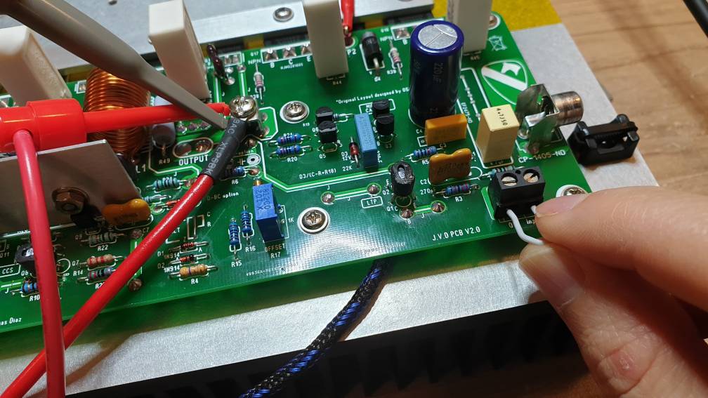

I just had a wiring or component problem / question that I hope someone can help me with.

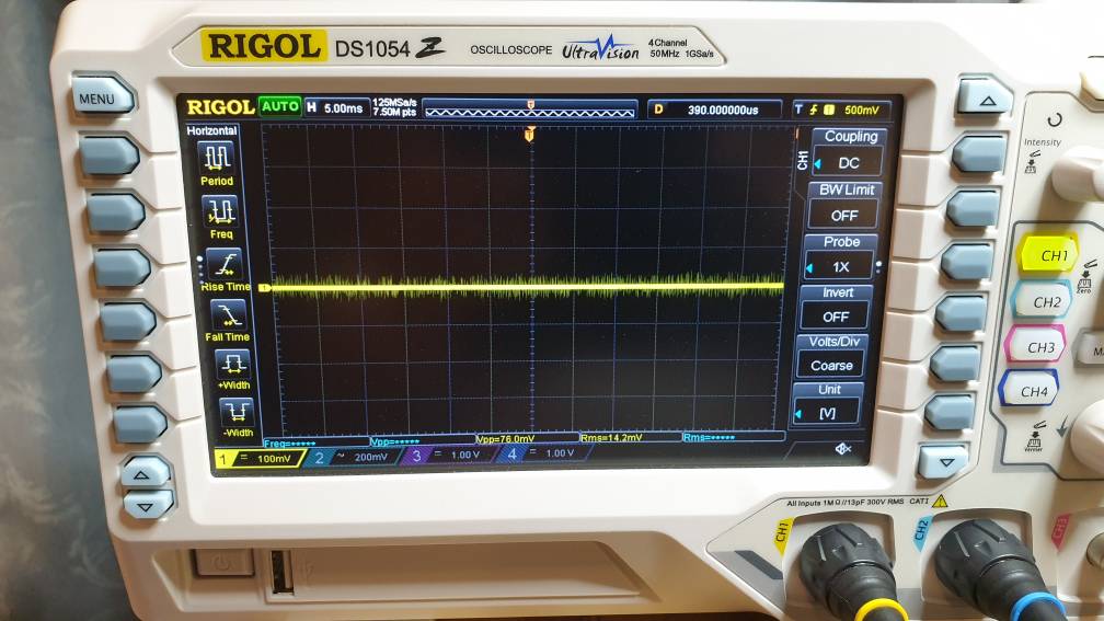

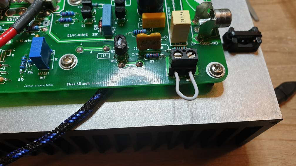

My Amplifier is finished but I was encountering some hiss in my tweeters for a few seconds after turn on. So I put the amplifier modules back on the test bench so I can try and problem solve with my scope and lab power supply. I'm testing it with 61v rails and bias set to 44mv tp1 to tp2
with approximately 0v DC offset and CCS set to 3.75mA.

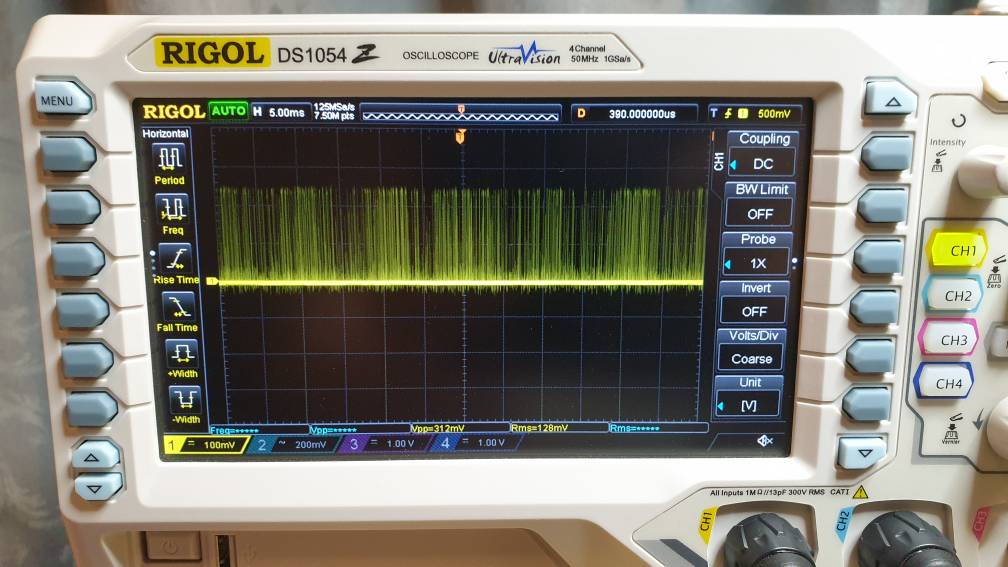

The first thing that I noticed was that when I turn on with a 8 ohm dummy load connected and nothing connected to the input I get a lot of high frequency noise approx 400mv peak to peak it ramps up steadily to that and then slowly returns to basically 0mv. It does not seam to have any DC component.

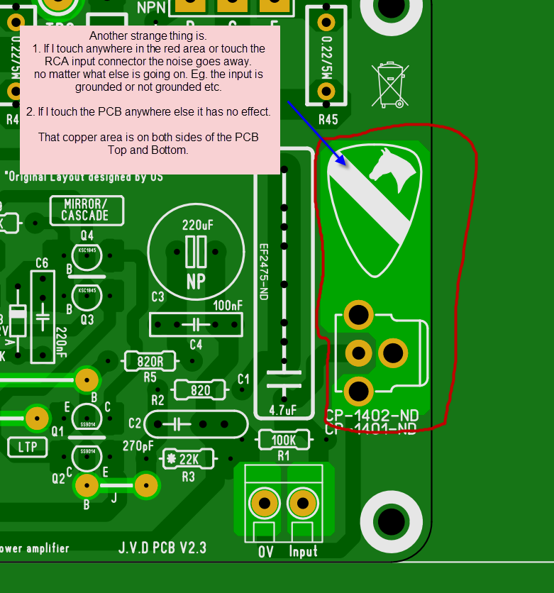

If I short out the input I get the same behavior, but if I touch even the shield of the bridging wire it stops. If I ground the input ground to the speaker ground the high frequency noise is still present.
The real strange part is if I leave it for a few minutes and things warm up or settle the problem goes away just as if I was touching the shielding on the input bridging wire.
Once the problem goes away and I turn off and turn on the power supply the problem is back so I'm not convinced that components warming up has anything to do with it.
I followed the wiring guide by Bonsai and had him check my wiring layout but I'm having this problem and was hoping that someone could help me find a solution or give me some things to check.

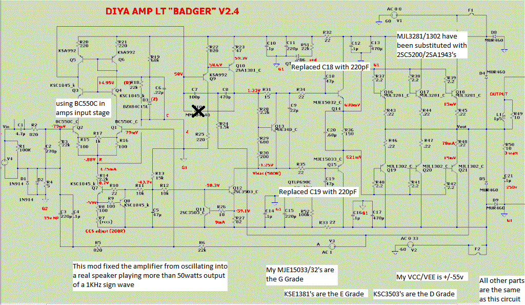

I was having problems with random noises and oscillation at higher powers doing these modifications to the circuit have fixed the problem I think it was because i'm using higher hfe transistors than whats in the original circuit. Maybe this could help with your oscillation.

My working theory (which could be wrong) is that it has to do with charging the input cap. Here is an experiment for that. Repeat what you have done, but short as shown in the attached diagram.

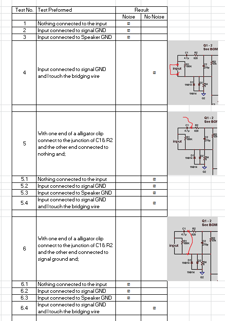

Hi Sandro,
I have preformed some more tests and have put the results into the attached table.
When then noise disappears and I turn off the amplifier, I have been turning it on again with in 5-10 seconds.

By bridging the both grounds (left and right channels) you MIGHT get an earth loop and or crosstalk etc.
Run seperate wires (or the sheild) from the RCA ground to the input ground. R4 will stop potential earth loops with the power amp ground.
This input ground should not be connected to the chassis.

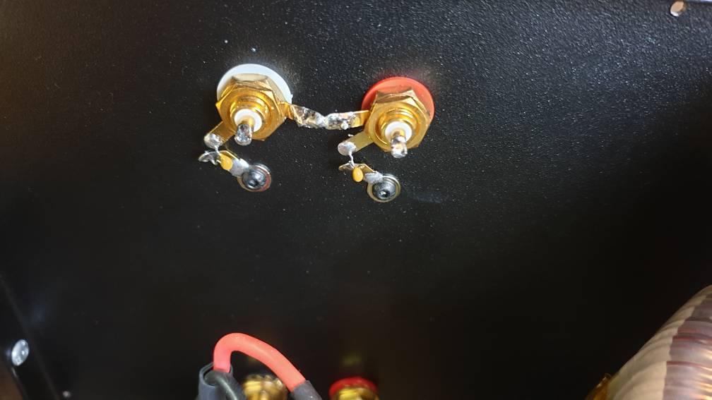

Question I have my signal grounds bridged. Do I have on or two of these caps. I currently have two. I am thinking that I only need one.
Can you confirm Bonsai?View attachment 852646View attachment 852647
Stuart, one cap will do because the grounds are tied together. Typical value 2-5 nF.

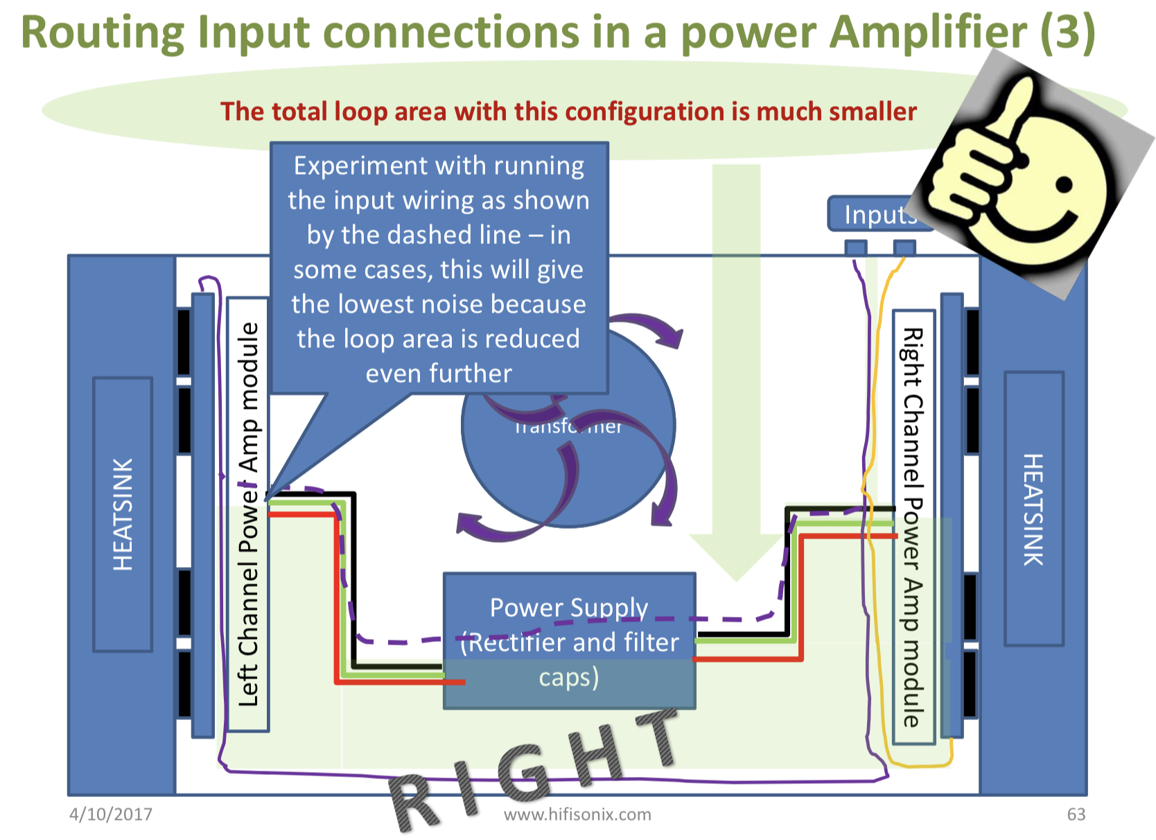

Re the earth loop, remember to run the internal wires to the PCB’s together to reduce the loop area. The reason why you bond the grounds at the input connectors is to trap cross channel loop currents inside the amplifier. If they flow out ( because you have not bonded them) you are likely to cause volt drops across the cabling signal returns That are then in series with the signal.

Ok, wow... it seams like we have two different thoughts on whats best.
Either keep the DC short between the signal grounds and use a single 2-5nf capacitor connected to the chassis. Which I know I need to stop this noise.
Or
Follow Harry's advice.
I'll wait to see his schematic.
I do know that based on his advice a capacitor across R4 did remove the noise as well.
