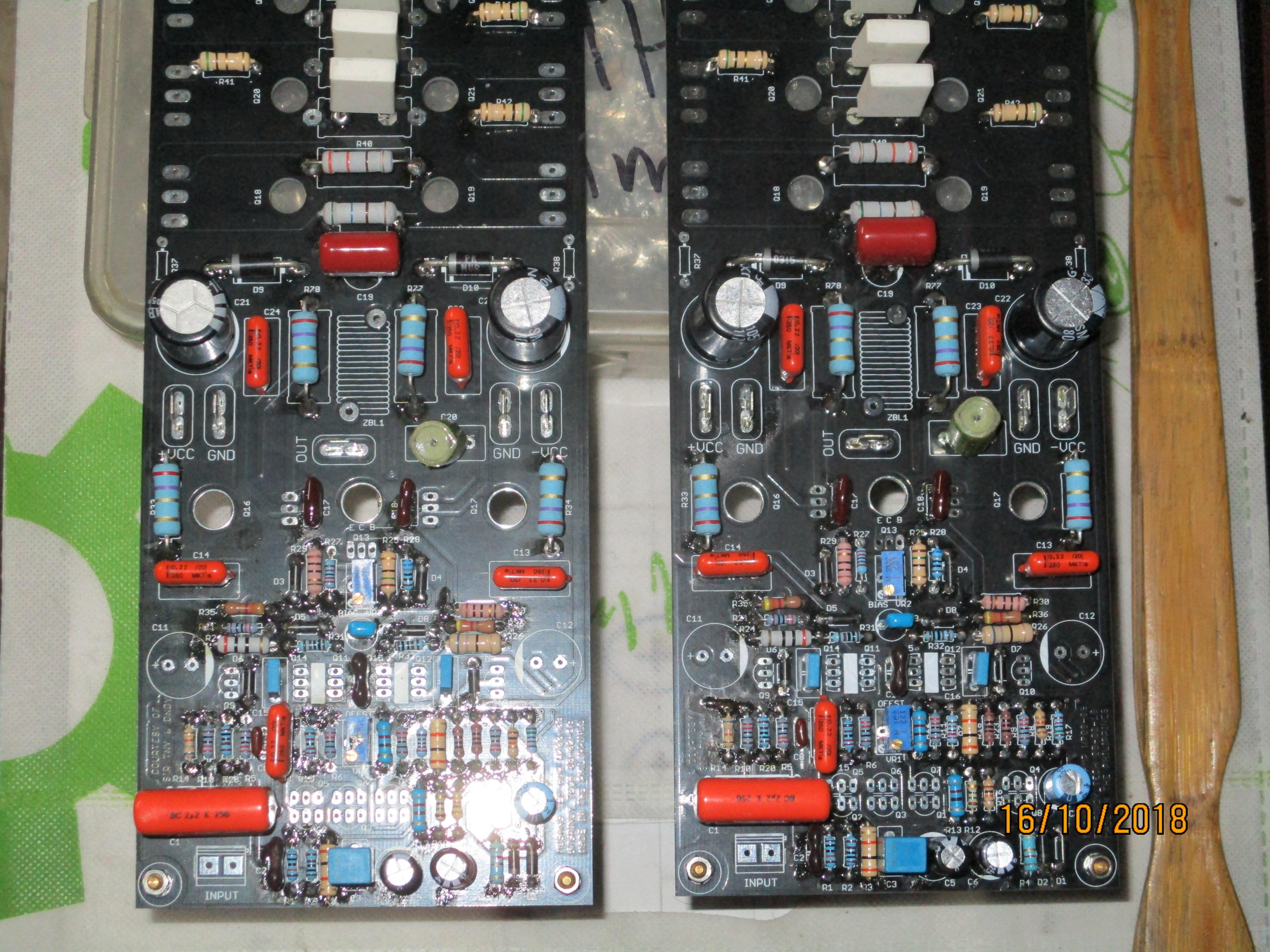

I have another question to those who built the amp: where you able to use electrolytics of bigger diameter and lead spacing than the ones stated in the BOM, and vishay dale rn60 resistors?
Cant't use rn60, I use rn55 and there are 0.6w that can fit, for example vishay mrs25 , te lr1 series. You can buy from mouser rs etc. For electrolytic, I user the one that fit pcb, panasonic fc are small enough.

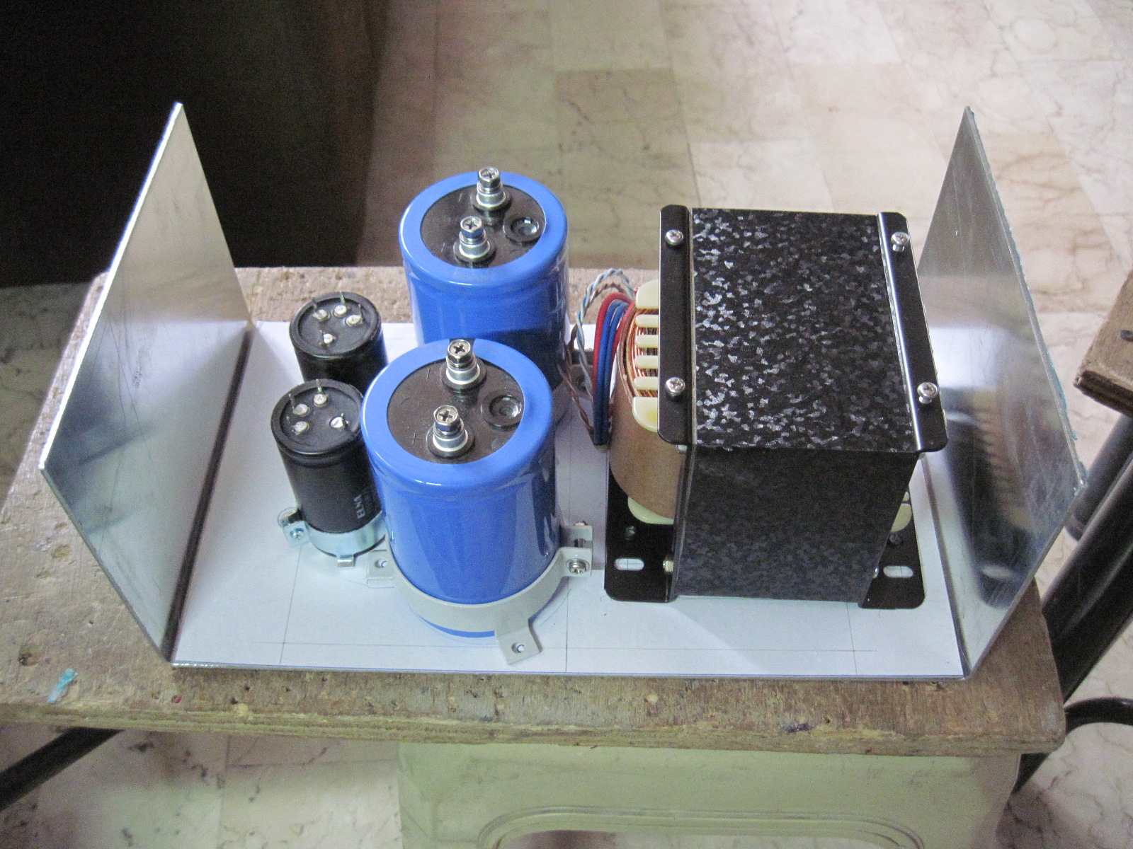

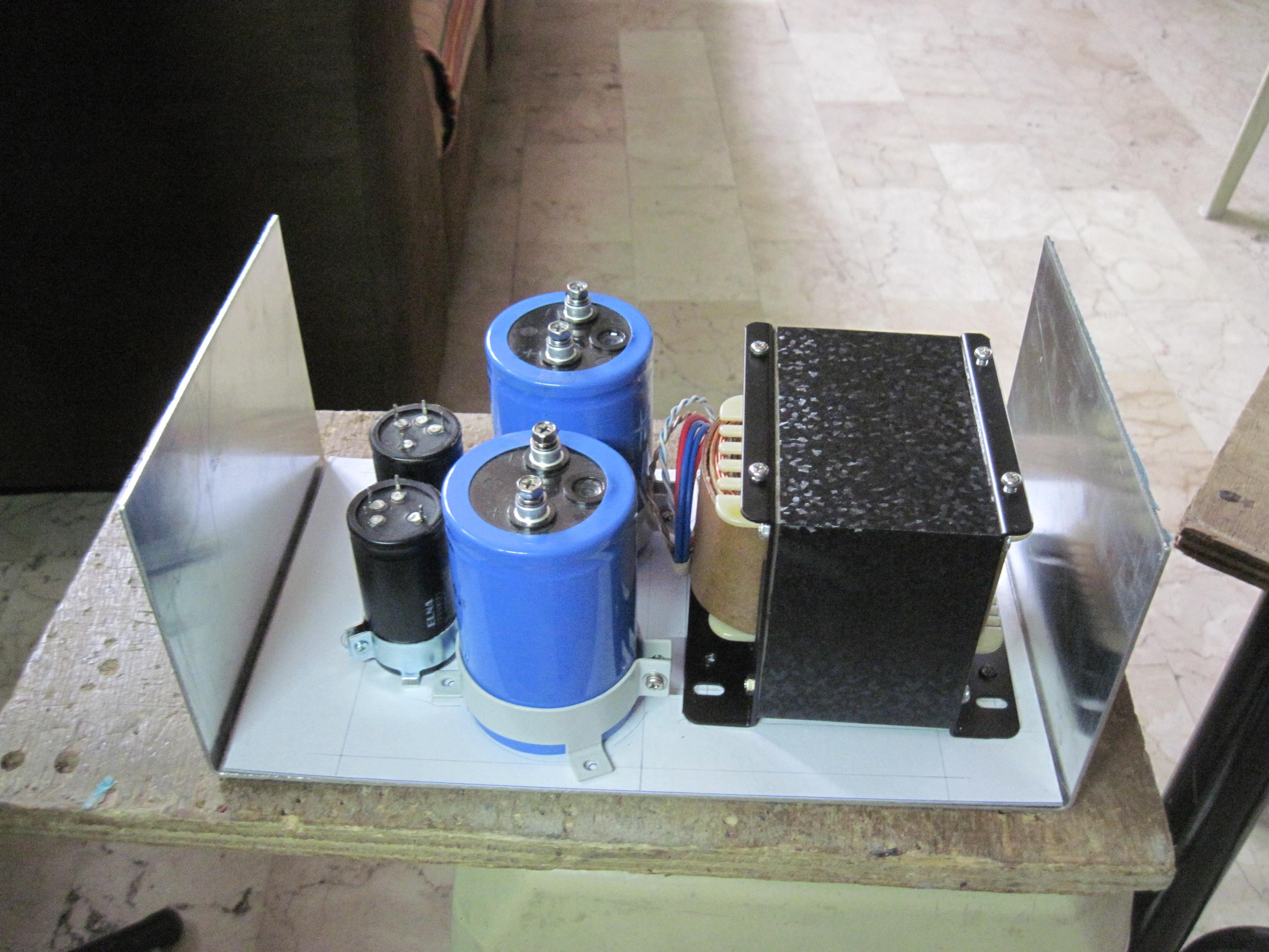

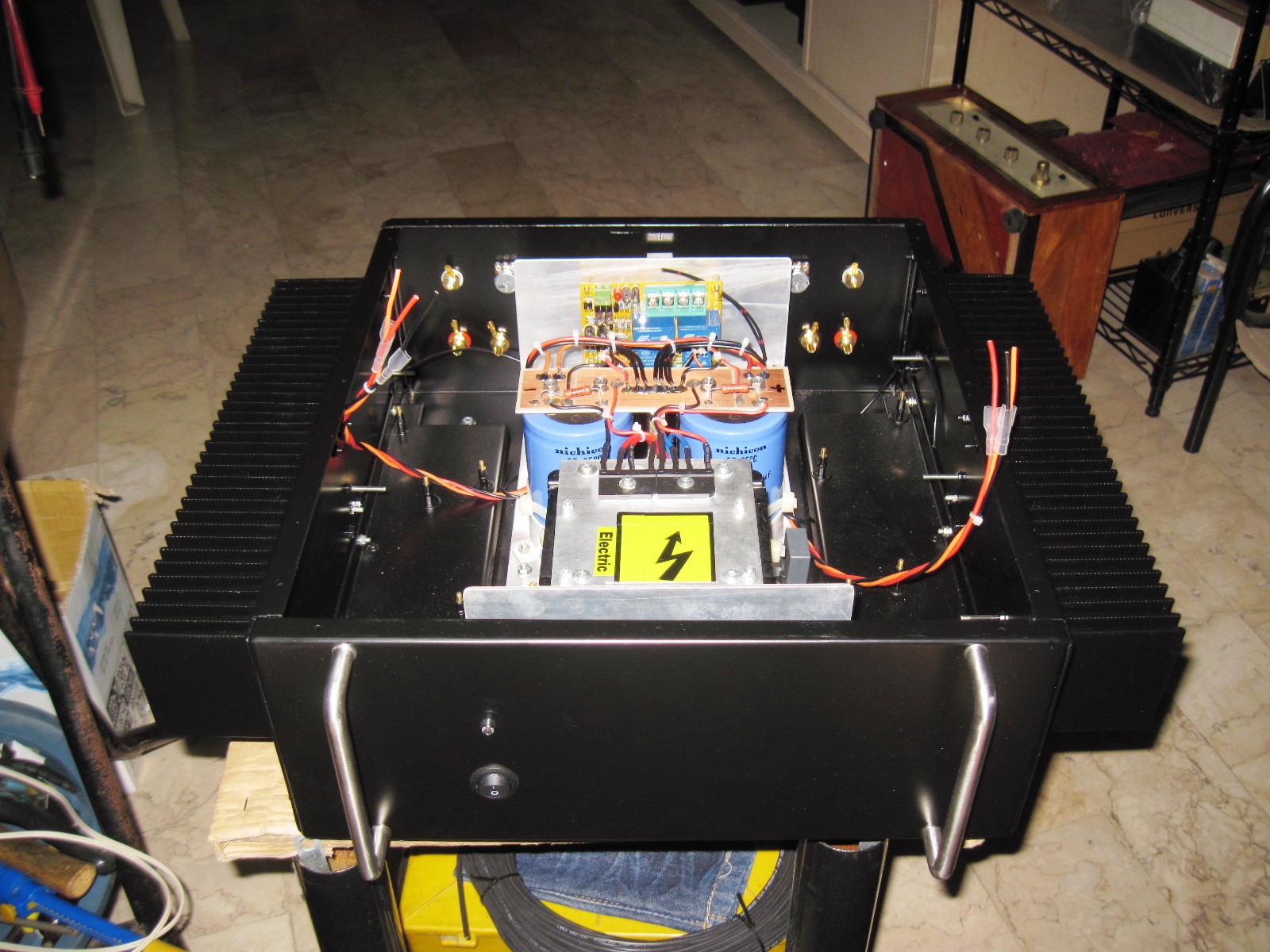

this is my completed HB amp..

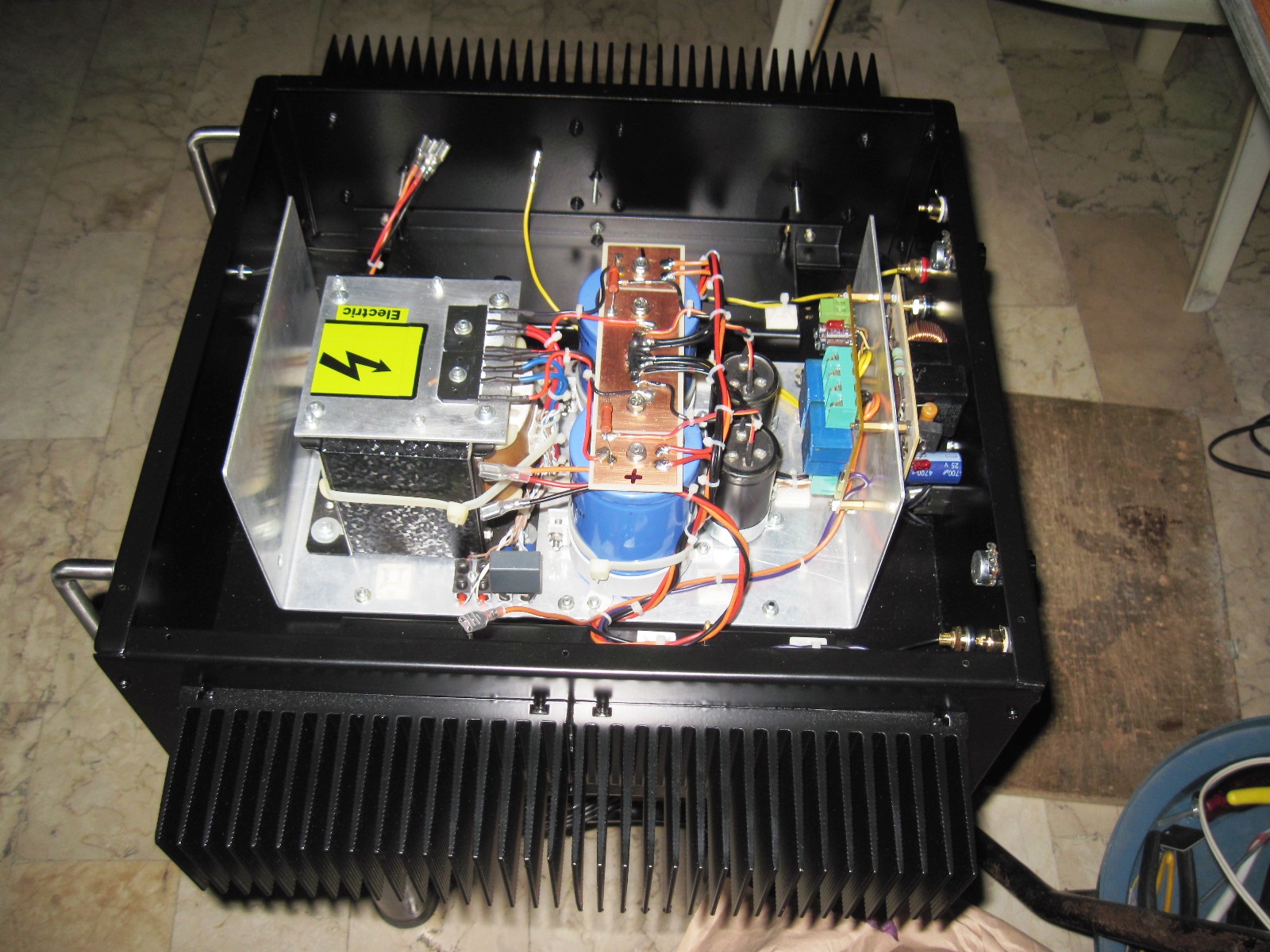

Cool build Tony!
Are the knobs on the aft panel for source selection?
What did you use for rectifiers( I think that's what I see on top of the xfmr)?

Very clean construction! What value are the filter capacitors?

You used rn55s for 1/4w resistors? But they are rated for 1/8w. And for 1/2w you used mrs25s? What did you use for 1w?
Very fine! What do those smaller electrolytics do?this is my completed HB amp..

it is supposed to help in the ESR department.
carbon film resistors were used....i have tons of them in stock...china stuff mostly..
big cap is 56000ufd/63vdc; small cap is 10000ufd/63vdc..
Cool build Tony!
the pots control volume level so i can connect the cd player directly..
i used inline sanken 50A 1000 volt rectifiers, i did not use a center tap that is why two rectifiers were used..

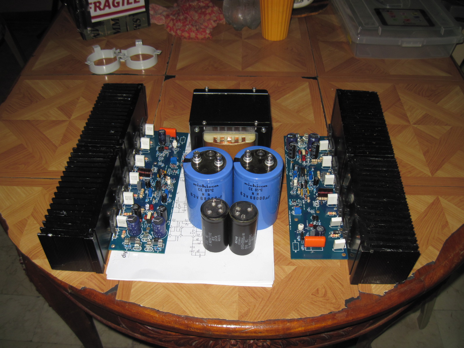

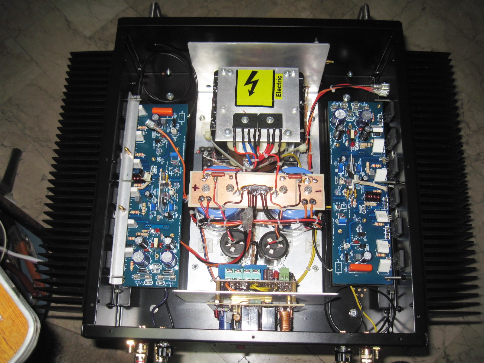

Tony, looking good !! I like the clamping method that you use to fasten the transistors, much easier then have to drill a hole for each transistor.
my consideration was ease of servicing....as you can take out the board easily in case you want to replace parts...

Did you use anything between the "mounting bar" and the transistors to help disperse torque? I'm curious because I was going to do something similar to this idea. I'm still undecided on that for now.

as you can see i used an angle bar 10mm x 10mm x 2.5 mm so that torque should be evenly dispersed,
