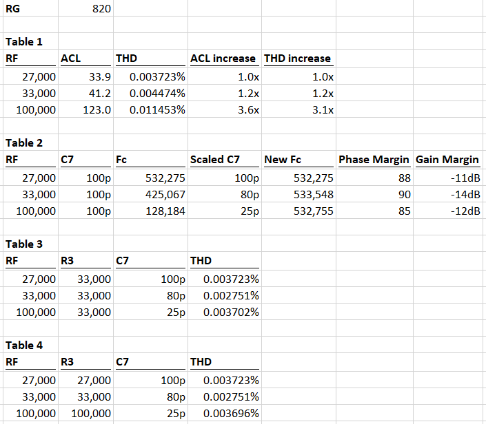

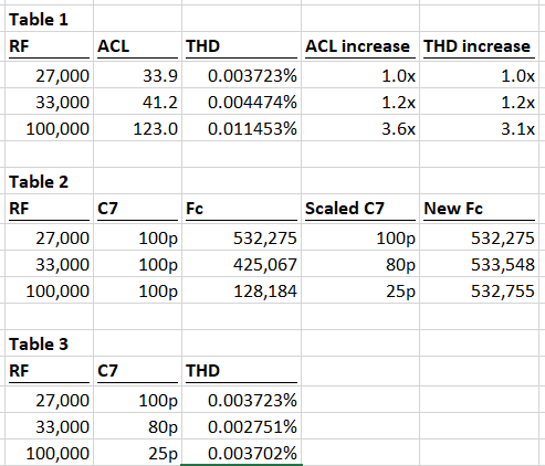

Well, I just run a experiment and I am correct, this skyrocketing is not true. Here are the details of the experiment.
Parameters are kept constant:
- Pout = 150W_RMS into 8ohms, Vout = 49Vp or 34.5VRMS (Scaled Vin to do this)
- Freq = 20k
- RG = 820
Now running THD for 3 RF's: 27k, 33k, 100k we get the results in table 1.
As you can see, the distortion increases proportionately (well almost) to closed loop gain as predicted by the mechanism described in my previous post.
Now, following negative feedback amplifier theory, you can get around the loss of loop gain by scaling C7 to keep the cross-over frequency Fc constant (and thus the loop gain over frequency). See table 2.
Re-running the experiment, THD can be kept the same at ~ 0.003-4% for all 3 gains by scaling C7 which keeps the loop gain constant. See table 3.
Bottom line, theory works. By understanding the mechanism that causes the distortion, you can make modifications to the amplifier to get the same results; in this case get the same level of distortion regardless of closed loop gain.

Added Phase Margin and Gain Margin to table 2. Phase Margin is 85 - 90 degrees and GM > 10dB in all 3 cases, so stability is not compromised by the changes in C7 shown in table 2.
Finally, I am using v2.4 of the schematic which I believe is the latest.
Also, I used RF=27k as the nominal case, and scaled from there.
What I did not do, and should have done, is to change R3 to match RF (R6) in each run. Did not do it since I wanted to just change 1 parameter between runs. Table 4 shows the results of also changing R3. As you can see, minimal changes in THD. This should not be a surprise since at 20KHz, R3 is shorted out by C1 and R2, so the effect is minimal.
Enjoy!
- Sandro

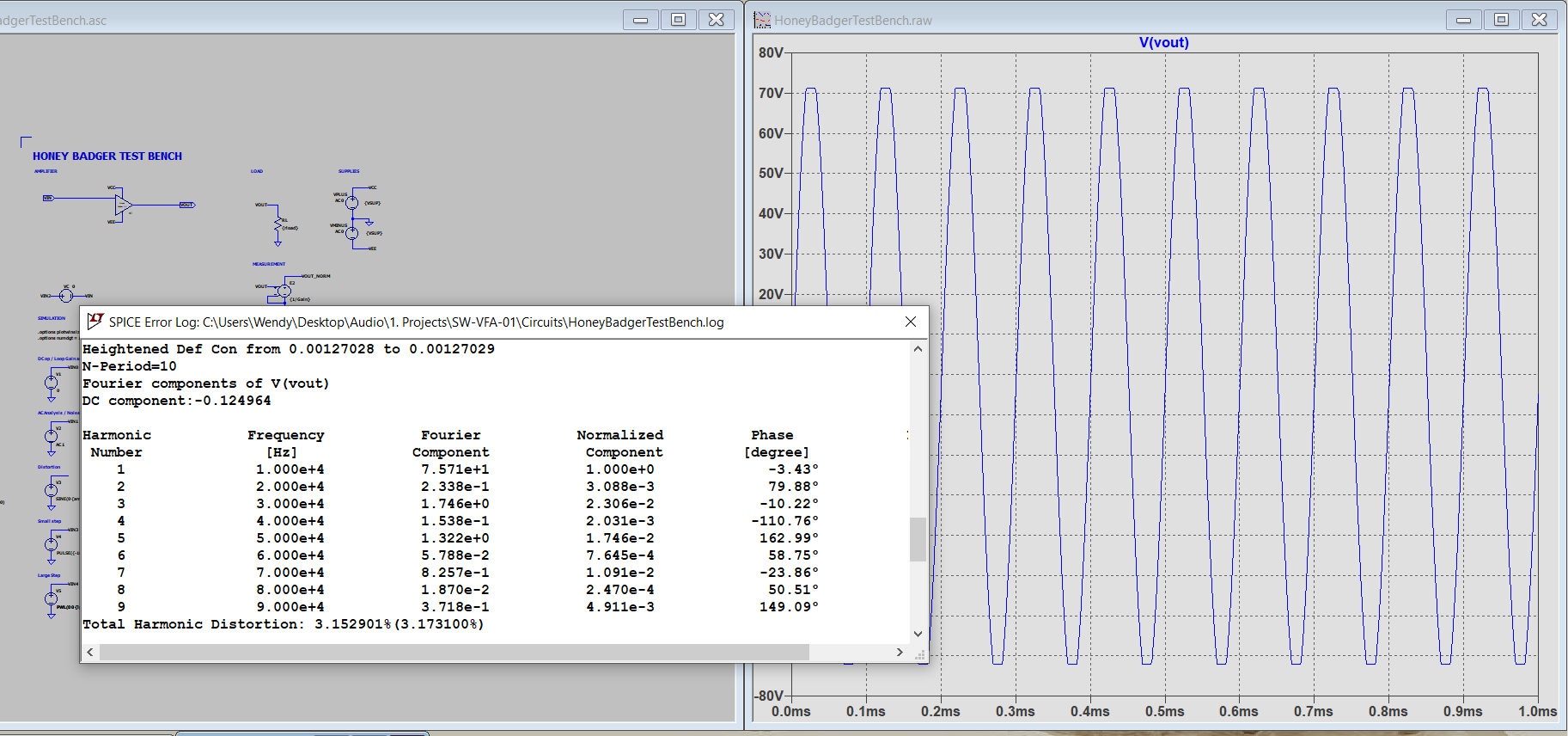

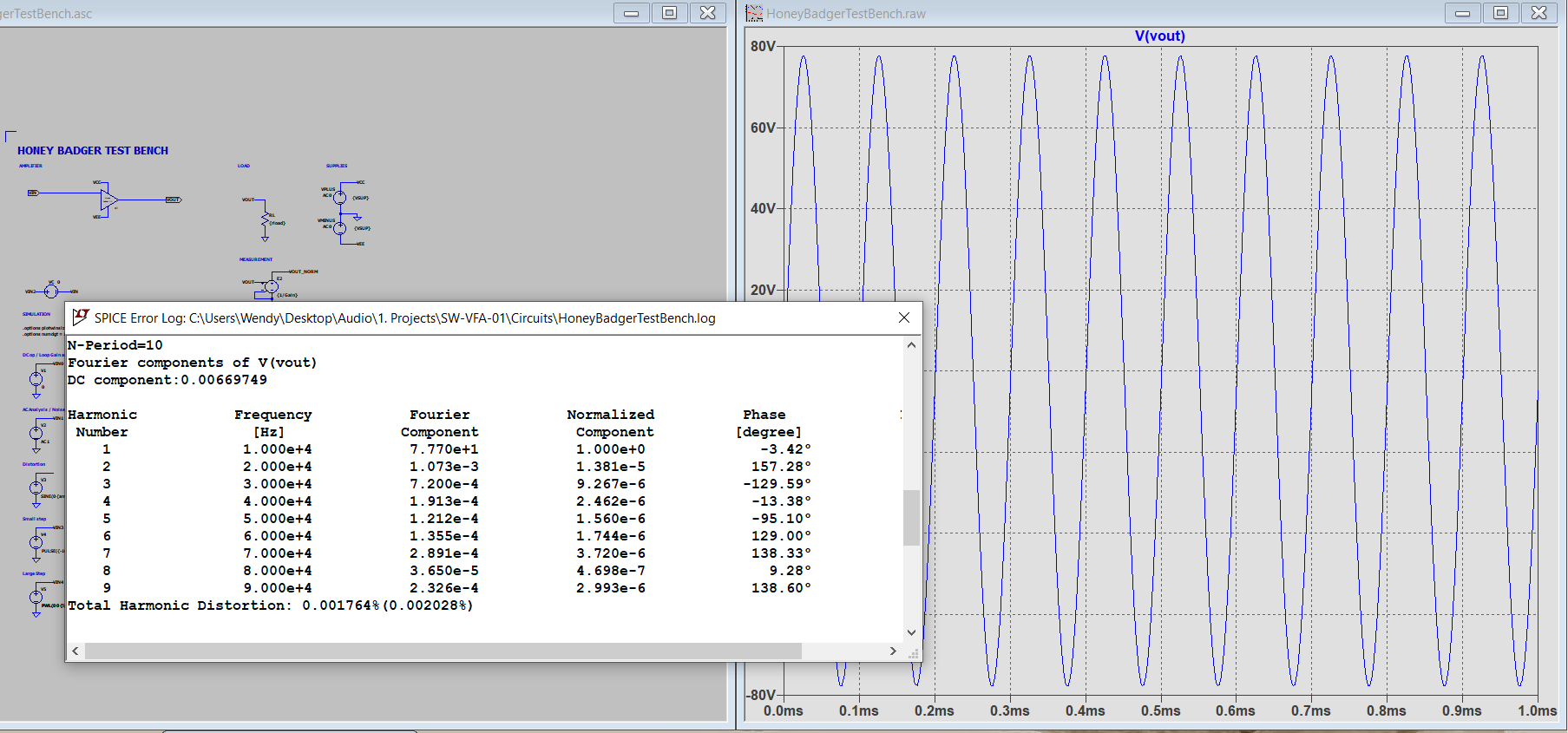

Hi Janusz, I tried to run your setup, but it is telling me that it is missing all the XXX_CORDELL models. I think that is the old nomenclature for Bob's models since the newest set are XXXC. But I honestly don't know.
I managed to get the following conditions from your setup
- Vin=1.5Vp
- Fin=10KHz
- VSUP = +/-75V
- RF=43k
and was able to replicate the results in mine. I got about the same level of distortion 3.152901%. See screenshot 1 for results.
Looking at the output waveform, you can tell what is going on, you are clipping the output. Let's do a bit of analysis:
RF=43k => G=~52 (includes filter attenuation of 27k/27.82k)
Vin=1.5Vp => Vout = 78Vp
You cannot do a 78Vp output with 75V supplies.
If we bump the supplies to 85V, with the same conditions, distortion drops to 0.001764%.
Now, to be ultra cool, let's scale C7 to recover BW. With C7=27k/43k*100p = ~60p, we get a new distortion level of 0.001434%. Not a huge reduction, but something.
Anyway, mystery solved.
Best, Sandro
