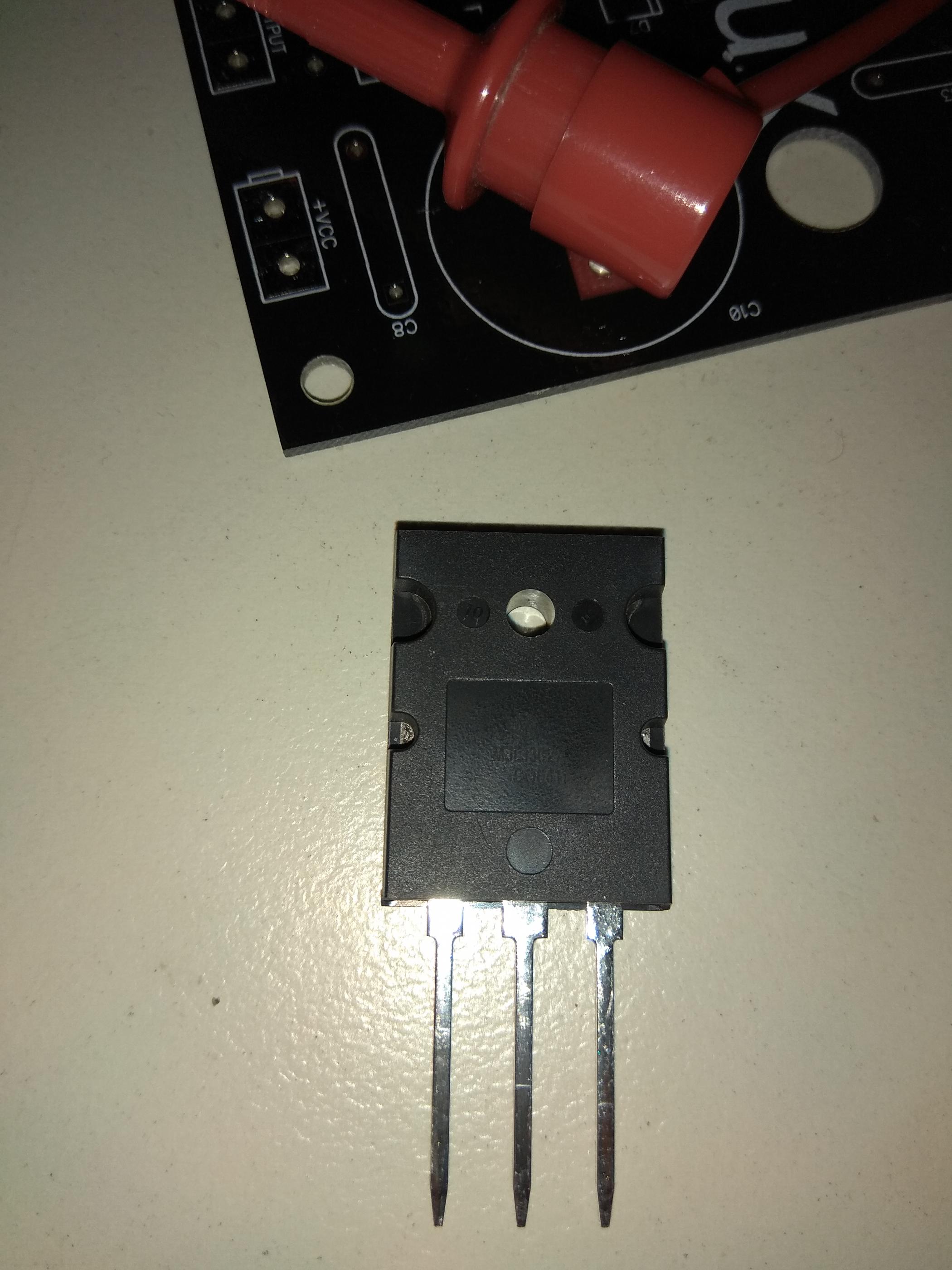

Hello all, after a couple of weeks having fun building the badger it is now time for testing.
Building a nice chassis will follow after some time when I have listened to my whole collection .
As a tube guy it is some getting used to the tightness of the sound, but I am impressed. Thanks to OS and the community for developing and supporting this nice amp!
Some pics
Some pics

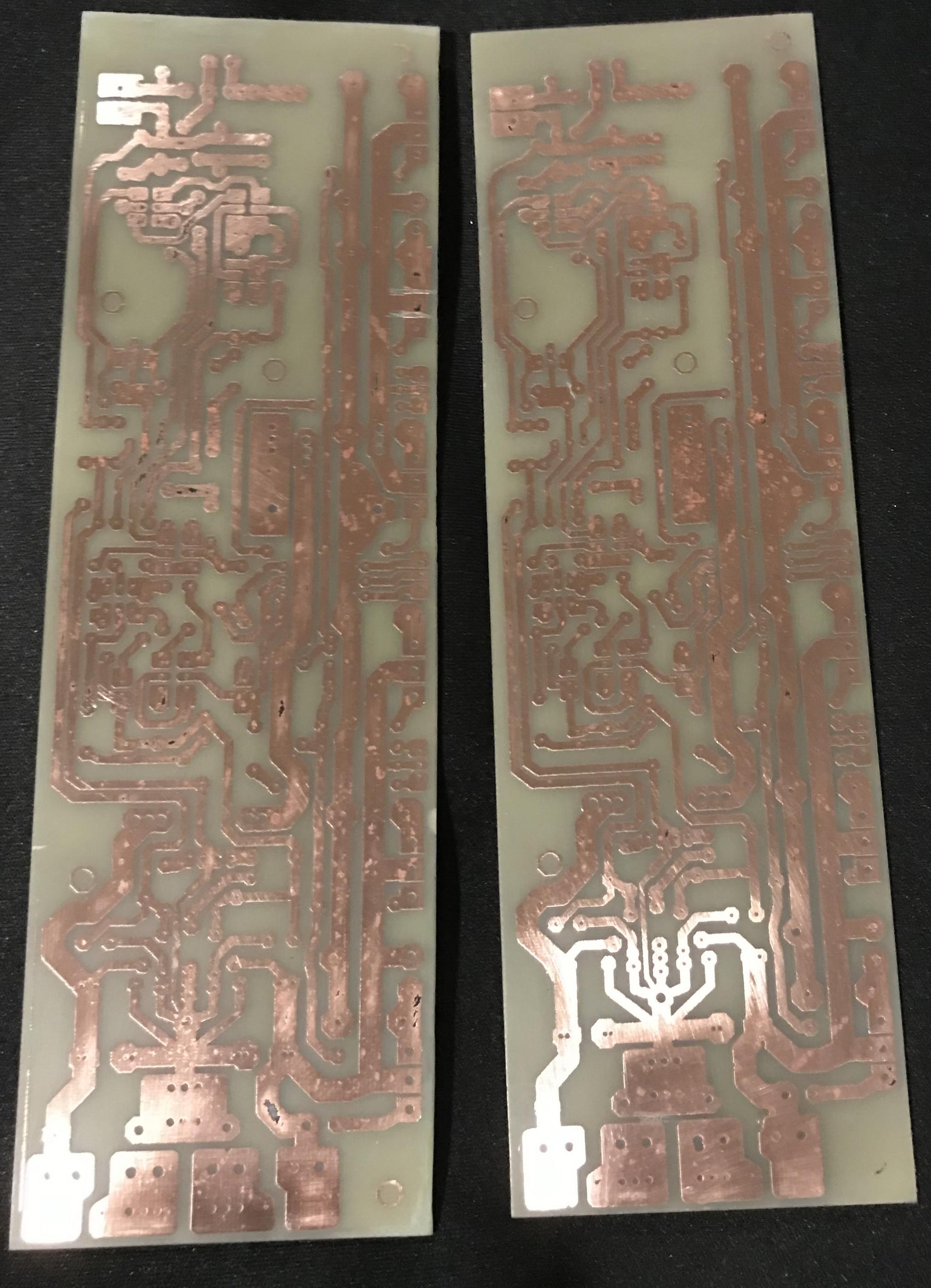

Well... with everything going to pot with this covid-19 thing, I decided to start the Honey Badger build and stay out of harms way. So far I've etched the boards with the v2.4 foil posted in this link. Hope everyone stays safe.

Nice work!
What is the output transistors?
Nice work!
Thanks!
The output transistors are MJW3281A / MJW1302A.
Thimios,
according to the build guide you can use a considerable bunch of different power devices, beginning with 2SA1943/2SC5200's for lower rail voltages and 8 ohms load, up to those beefy, double die MJL4281A/4302A's for higher votages and/or 4 ohms load.
Ostripper's design really excels in being very versatile in chosing suitable devices .
Best regards!
Best regards!
I think that you will add a protection system!
I see expensive speakers,don't trust semiconductors...
You are very right.
For test I installed very fast fuses (500mA) between the amp and speakers. Currently building the protection circuit.
