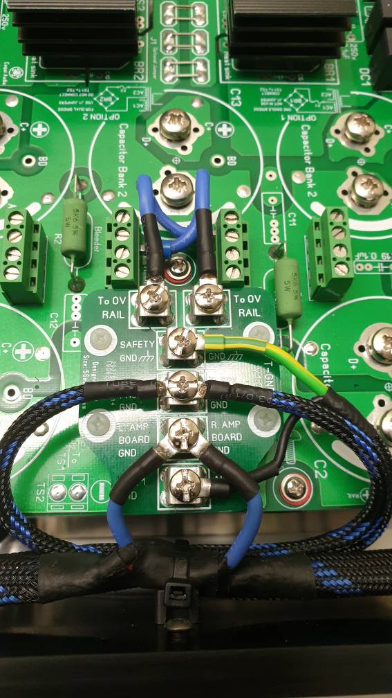

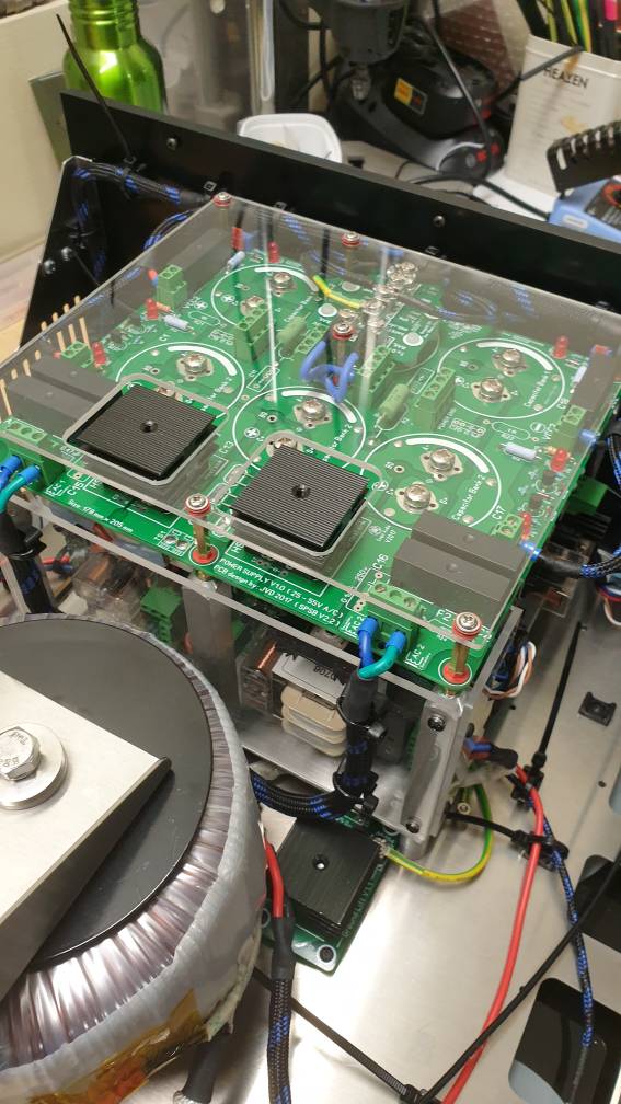

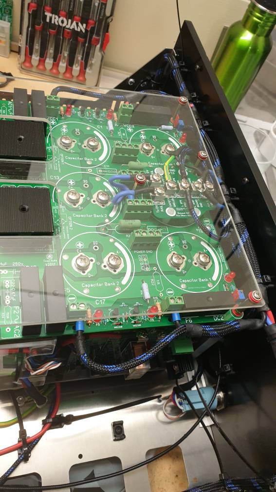

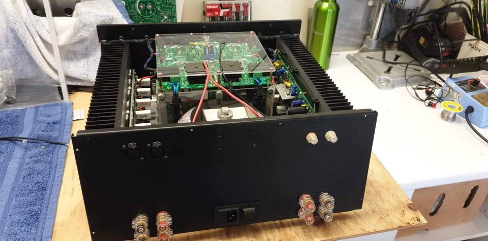

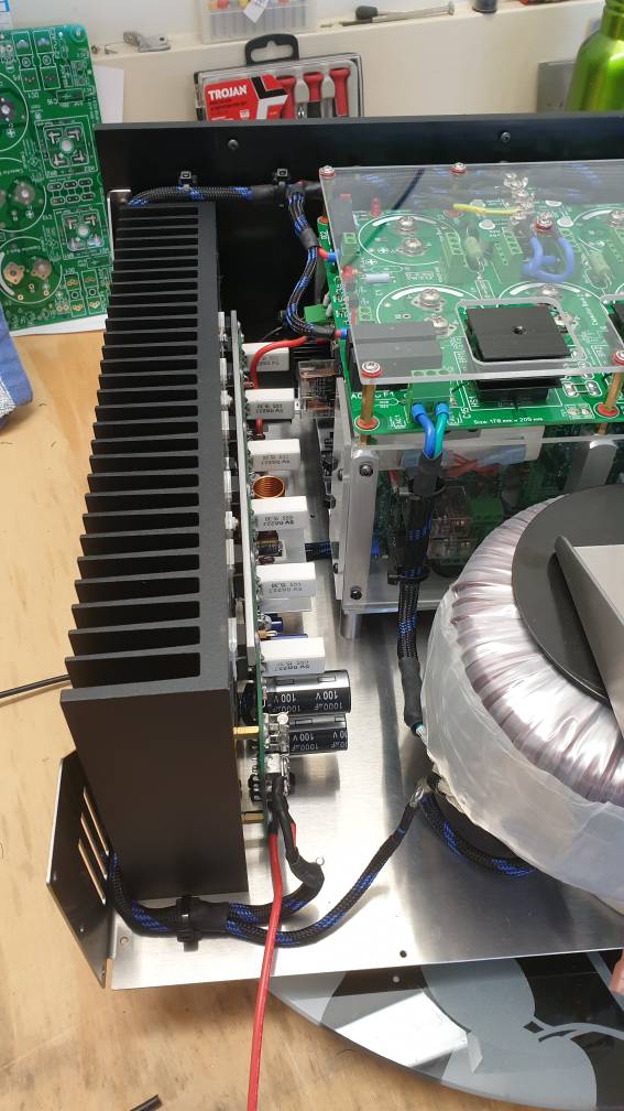

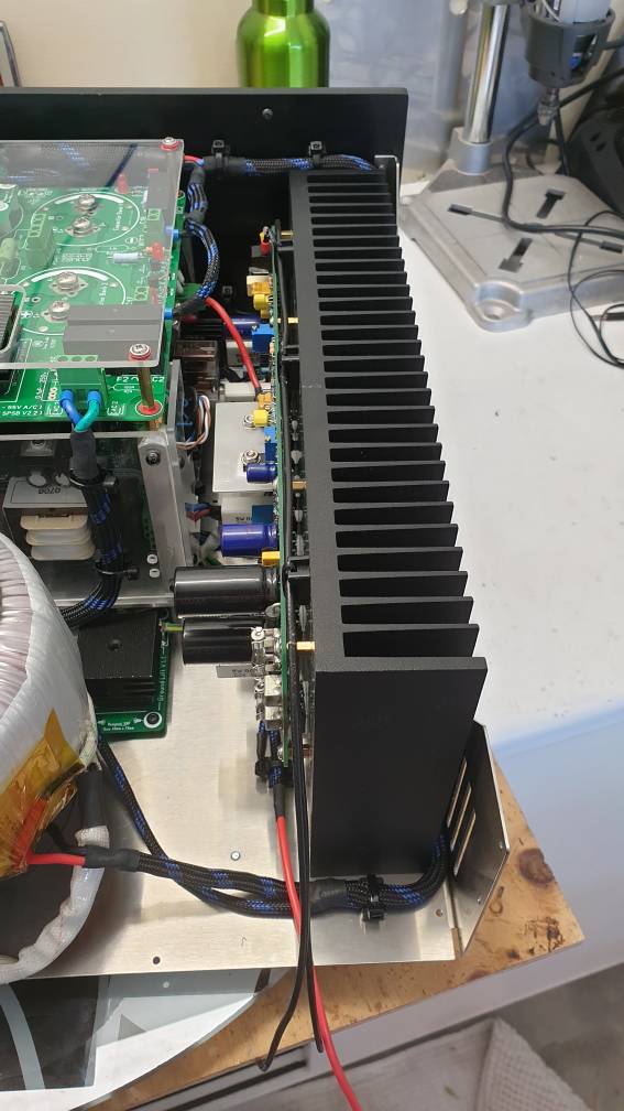

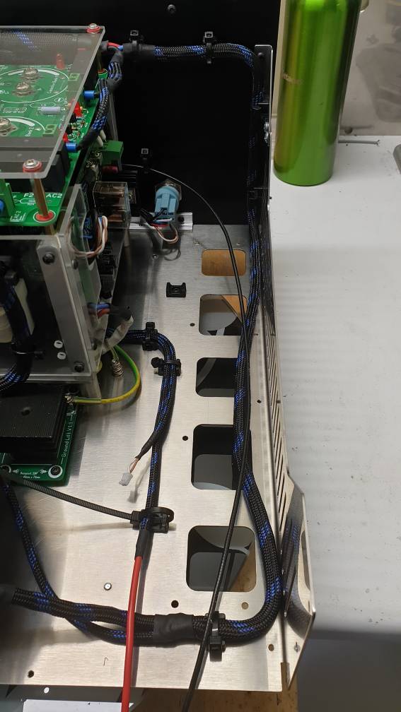

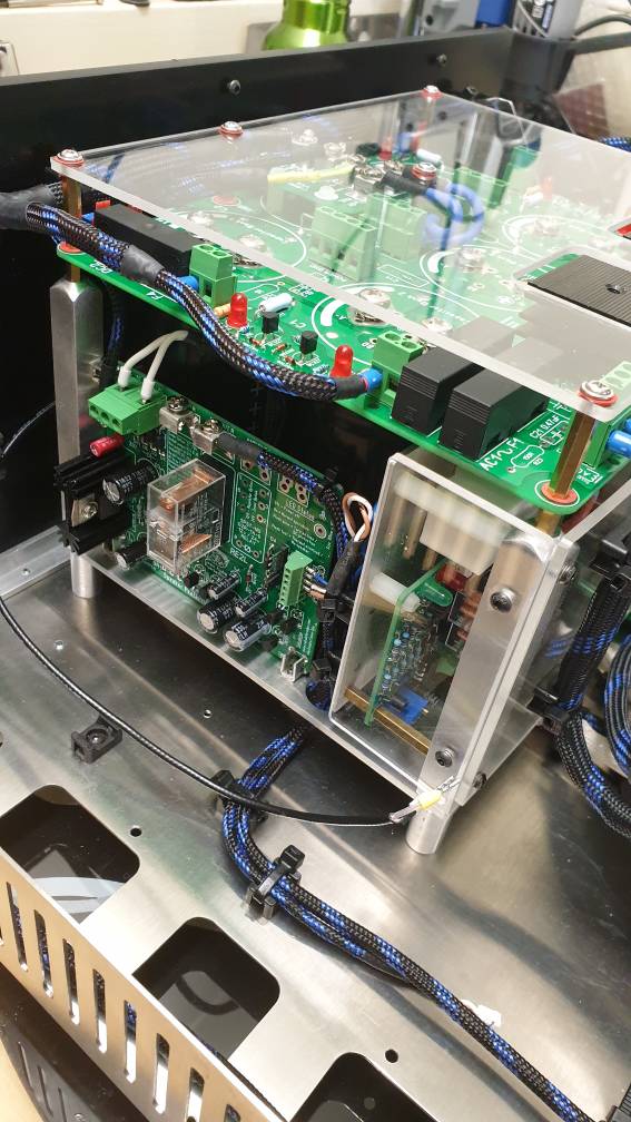

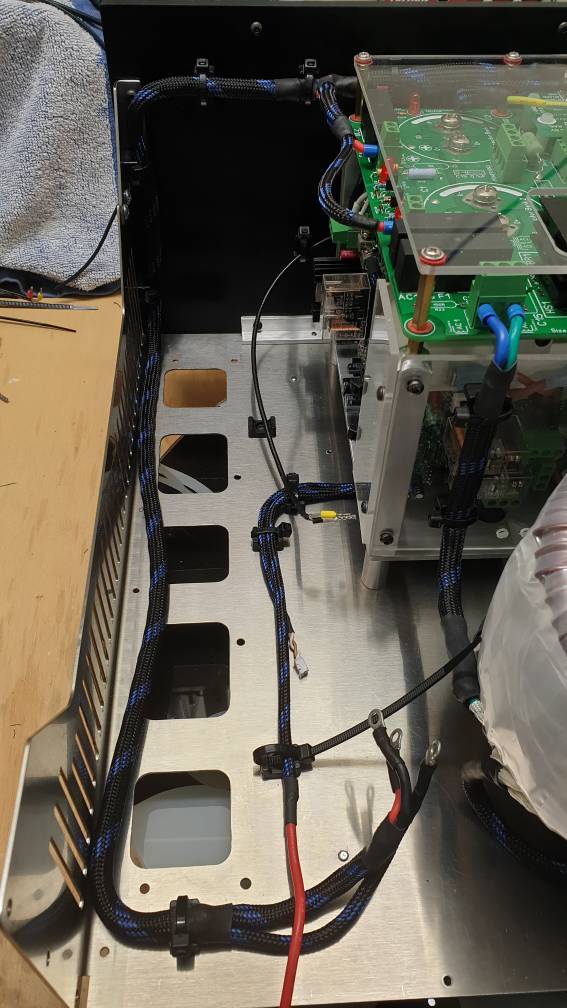

More progress photos. The rear plate so not bolted on yet. I need to get some more screws. Then just need to wire up the speaker outputs and the RCA inputs.
received_226893875085707.jpg 20200415_092757.jpg 20200415_092751.jpg 20200415_080826.jpg 20200415_080820.jpg 20200415_080816.jpg 20200415_080813.jpg 20200414_211743.jpg 20200414_211739.jpg 20200414_210256.jpg
