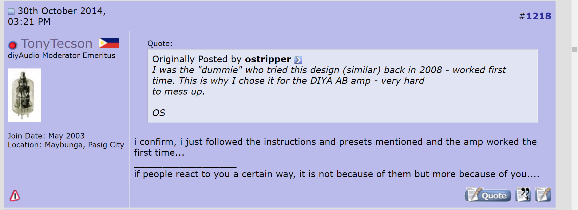

I did some work around protection circuit ...... see post 1218 and also see later comments ...
you link brought me back to my own post? why is that?

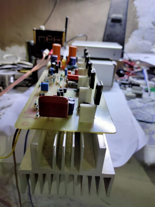

Hello
greetings i have made 2 channels of the Honey Badger tried it out
at low volume low voltage sound is very clean is 40 0 40 AC
transformer ok for 4 ohms load i dont need much power/ch its for
indoor home use and please best method of biasing the honey badger
warm regards
Andrew😉
