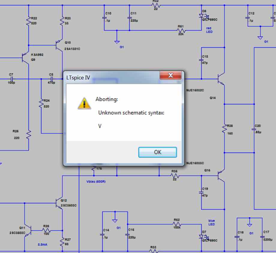

One can open your asc file from within the old and the new spice (XVII) but resistors are missing and it says it cannot read European resistors.
Ok. Try browsing to the LTSPICE sub directory folder called lib located in your my documents directory and then make a sub directory called direct and then place the Europeanresistor file in there.

No, there's something wrong with the file or more likely with compressing it. One can open your asc file from within the old and the new spice (XVII) but resistors are missing and it says it cannot read European resistors.

For me this simulation fails to run due to the dot include statement - it gives a mongrelmodels.txt file not being found error.
