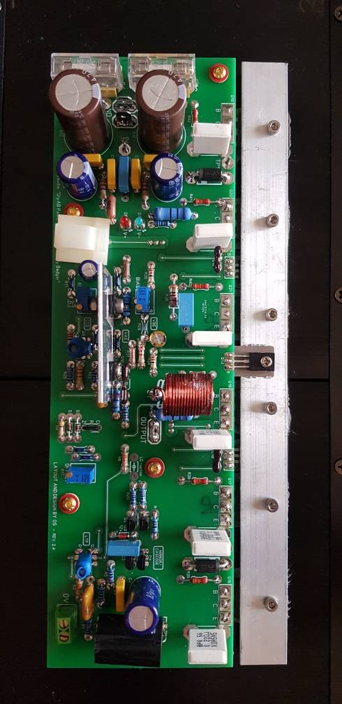

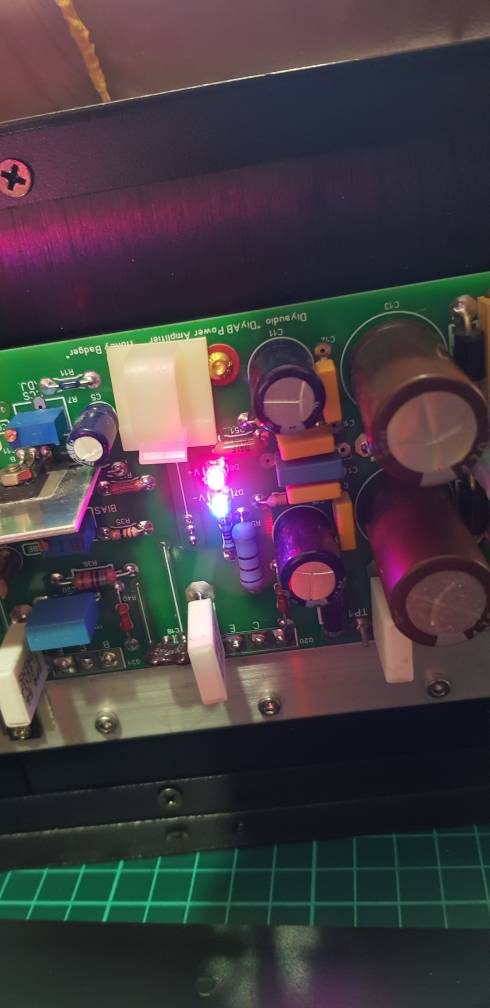

Hi, I've build the Honey Badger amp for about 6 months. Enjoyed every moment of it. Only today, when I tried powering on the amp, the fuse blew. The fuse that blew was the fuse to the input of my Transformer.
I tried isolating the problem. Seems like the right channel board has some problems. The red LED seems to be flickering and not bright red. The blue LED has no issues. I can hear some cracking sound on the board. I did the test thru a light bulb in series to the input of the transformer. The bias is set to 40mA. I have a pretty large heat sink, hence heat dissipation shd not be a problem.
Now the thing is what component is spoiled. What causes the cracking sound and what causes the Red LED to act this way. Anyone had this problem before. Kindly advice.

Both channels uses isolated PSU. Yes something is wrong with the positive rail, but will need to troubleshoot it. Need to check all solders also n D8.Sounds like a problem somwhere on the posive rail. Is D8 okei? Or it might be a bad solderjoint somwhere.

Here is the board removed. Seems like no burnt components.
Also I am using 4A fuses for the board. Weird thing the fuse on the PCB didn't burnt, but the one at the input stage of transformer burnt.

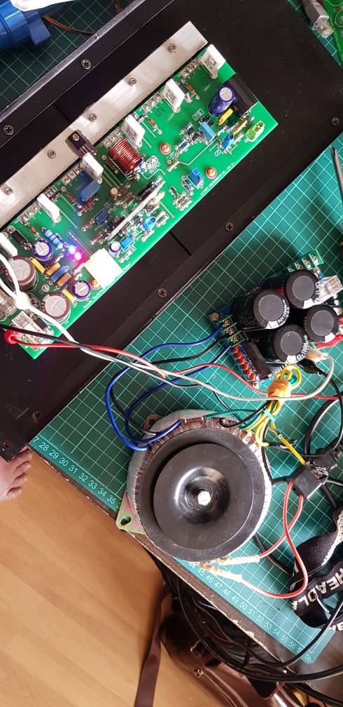

How I know this channel is faulty. When I disconnect this board, the amp works with the other channel.

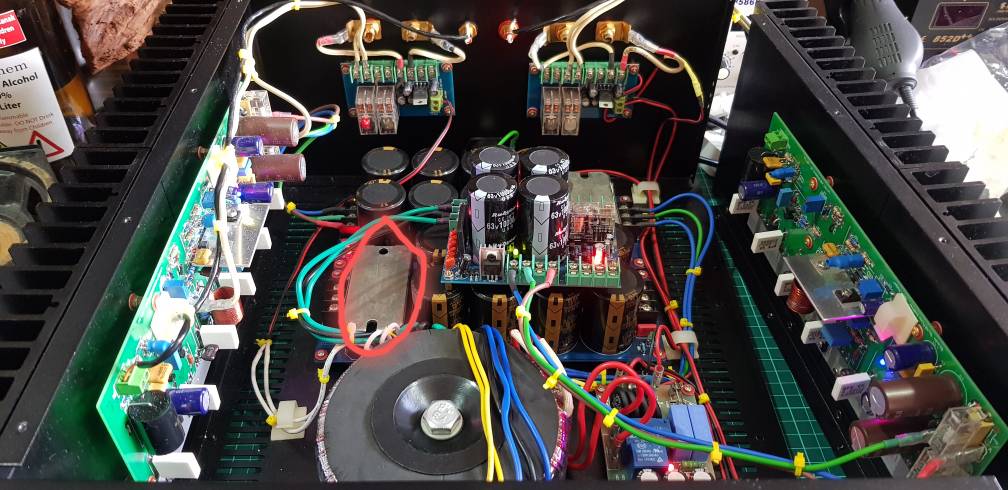

then you need to check transformer rectifier and PSU also.Both channels uses isolated PSU. Yes something is wrong with the positive rail, but will need to troubleshoot it. Need to check all solders also n D8.
You are right. Seems like the bridge rectifier is no good anymore. Geez. I used a spare PSU n the amp for both channels seems ok now. See the spare PSU with 4 caps and both LEDs are lighted brightly. Fuse does not blow anymore and the heatsinks starts heating up as per normal as I biased the amp at 40mA.then you need to check transformer rectifier and PSU also.

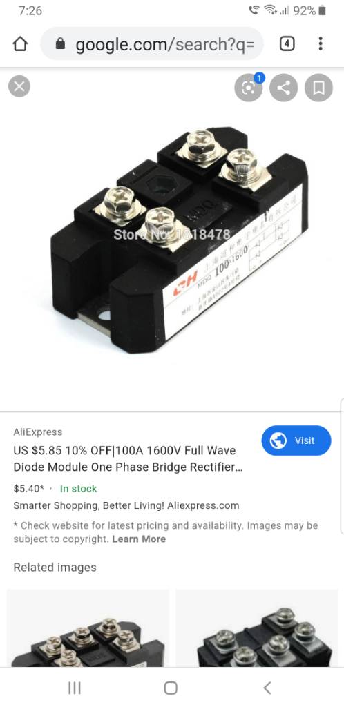

Geez I need to order another bridge rectifier. This lousy recitifer was rated at 20amps at 250volts. As you can see from the first pic, I have 2 of this PSU, one for each channel of the amp.
Any recommended Bridge rectifier which I shd purchase? I thinking of changing both recitiers for left n right PSU filter circuit.

I bought this rectifier off some Chinese website MDQ 100A rated at 1600v. It came with the PCB. Seems like some cheapo bridge if you ask me.
Try something like this. GBPC3506-E4/51 Vishay Semiconductors | Mouser Canada
San, do u have a schematic for the PSU which uses the MUR3020?I don't know how much you gain by using fast recovery diodes. I have not messured. Most of my builds are klass A amps. And there i allways use brick bridge.
i would not trust any chepo chinese rectifiers.
50A 1000 volts.....very cheap, a little over U$1....
