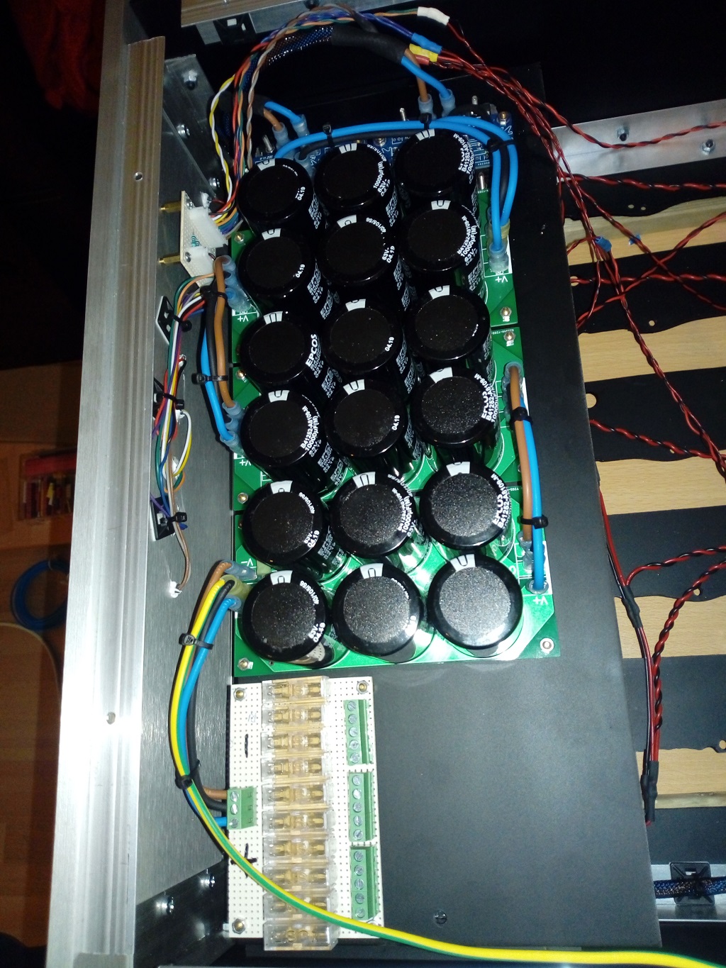

Finnished the PSU tonight. But i had to change out the transformer. The first one had a lot of hum. But i had 2 of them. Now it's silent. PSU outputs +/-56.7Vdc with 224V mains.

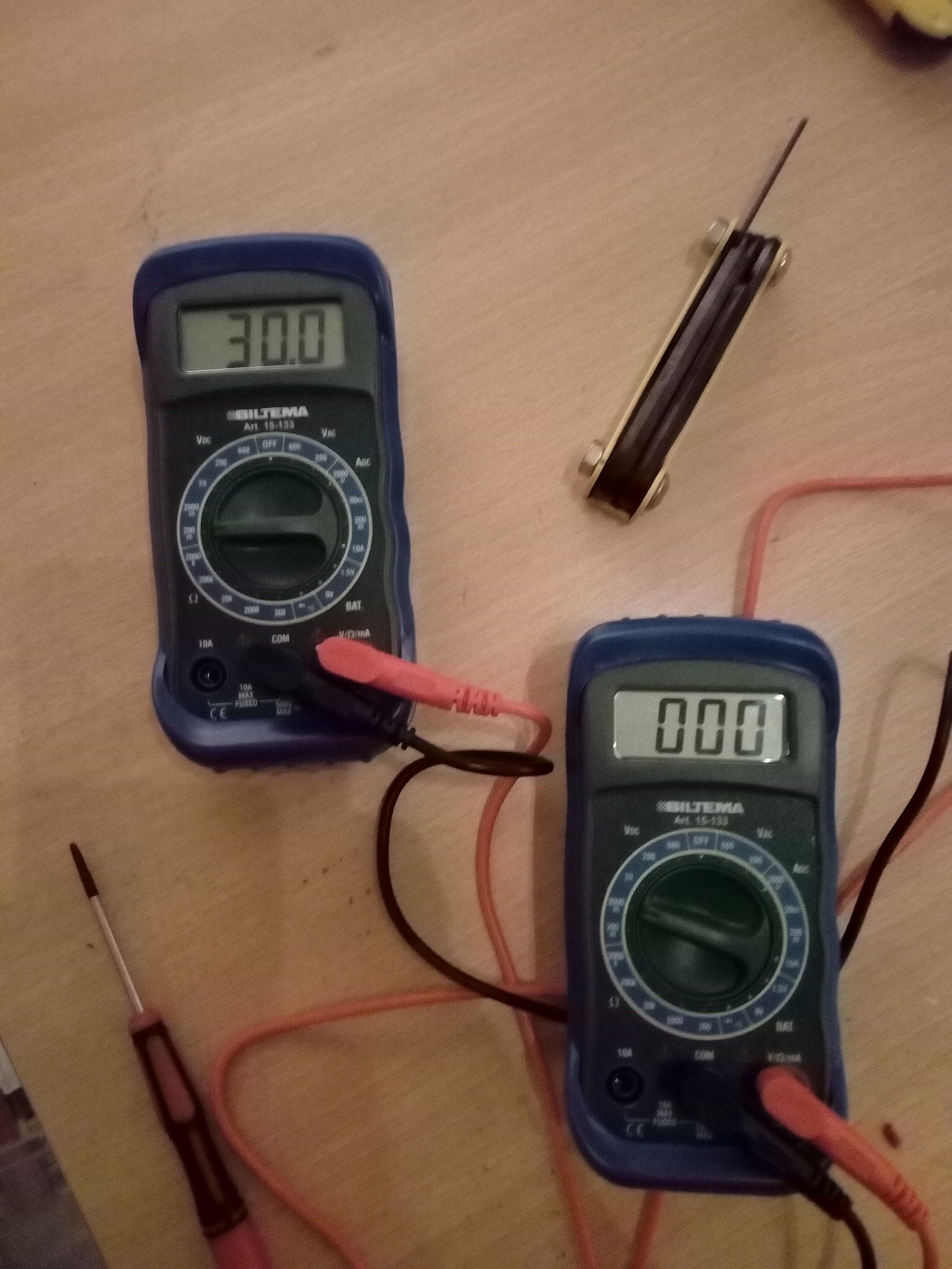

A tiny bitty hickup. Powered up the first ch to night to get some music playing.
and i noticed it was a lot of noise. Thinking it might be my source, i powered it back down and the negative rail puse blew. i reconnected my source and changed the fuse. Powered it back up, and both positive and negative rail fuses blew.
i do have continuity between positive and negative connection. Between output and positive AND negative. And between E and C on all output devices. Also on cross of positive and negative devices. No cuntinuity between sink and any outputlegs, or gnd to positive, negative or output. But output impedance is around 75 Ohm. Also ofcourse 75 Ohm between posite and gnd, and negative and ground.
any idè??
any idè??
EDIT: Conductivity. not continuity.A tiny bitty hickup. Powered up the first ch to night to get some music playing.
any idè??
Tonight it happend again. 2 other ch went boom. this time they blew the positive rail fuse. both at the same time. while playing music at low volume. the only component i could think of that is able to couse this is, D4 and D5. So i cut one leg of each and the problem is gone. All output seams fine. but why would this happend? they are soldered the correct way. So i checked my shoppinglist. The diodes are 40V pieces *banging my head agains the wall*

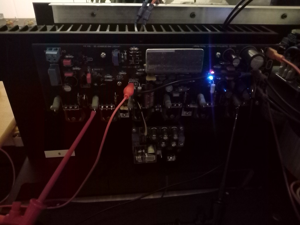

i used a series lamp dim bulb tester so that in case of mistakes, you do not let the magic smoke out..you will need this to confirm output offset voltage is much much lower than +-100mV, and that bias is adjustable, once confirmed these two criteria, you can remove that and fine tweak the bias, adjust the bias when heatsinks have warmed up, occasionally backing it down to target bias...notice that bias tends to go up as the heatsink gets warmer, so back it down a notch...
those bulbs are unobtanium over here. esyer to get genuine SJ74 J-fets 😀 but the offset and bias is correct. It was all in place. But i will readjust on all amps once more.
the bias actualy went down as the sinks got warmer. about 2-4c above ambient. failure of D4 and D5 vil not alter the bias or offset. it was just that it was to much voltage for that device. so it past it's voltage to the next rail and blew the fuses.
the right bias should be that reading when the heatsinks are warmed up, you will notice that when cold the bias is very low, that is not the deal, the deal is what the bias is at when heatsinks are warmed up and will not get any hotter...
that would be after playing for full volume for a a hole bunch of hours. somthing that would never happend. You can not set the bias for a temperatur that demands å full volume playing for 3-4 hours. i bet the sinks can get up to 50 C at a loud volume for some hours🙂
I did have the bias stable for around an hour or so for each ch.
Besides. i did tune it "cool" at just 70mA. so i have a lot to og on.
