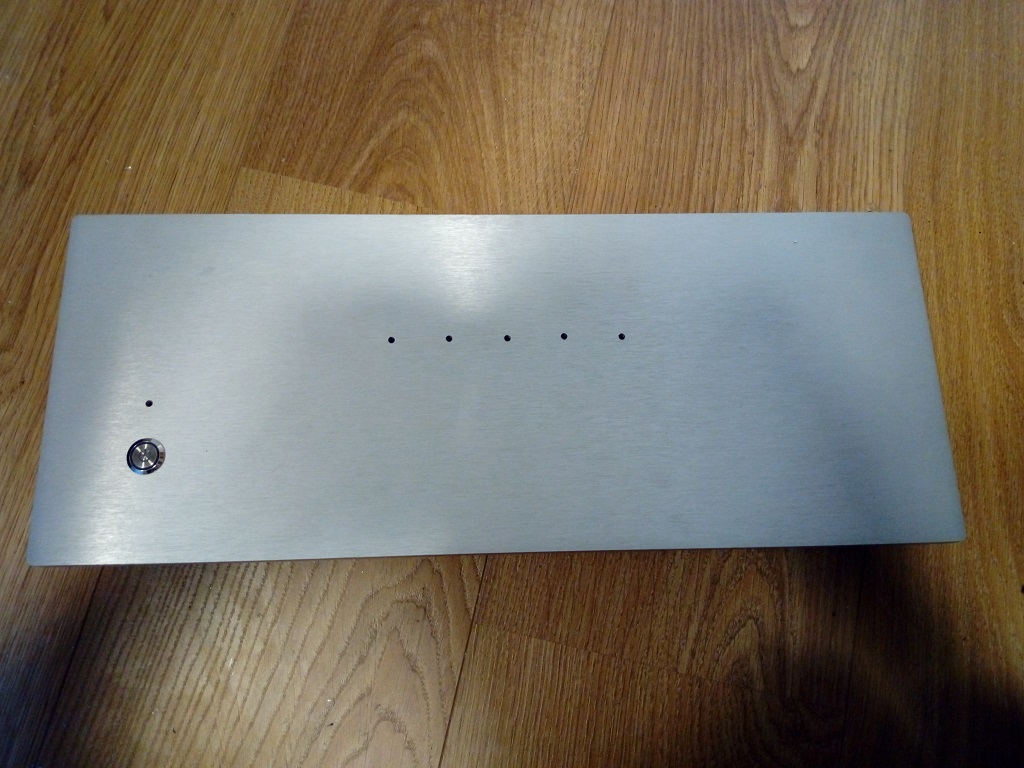

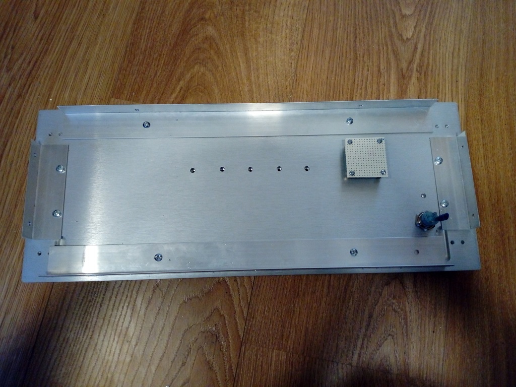

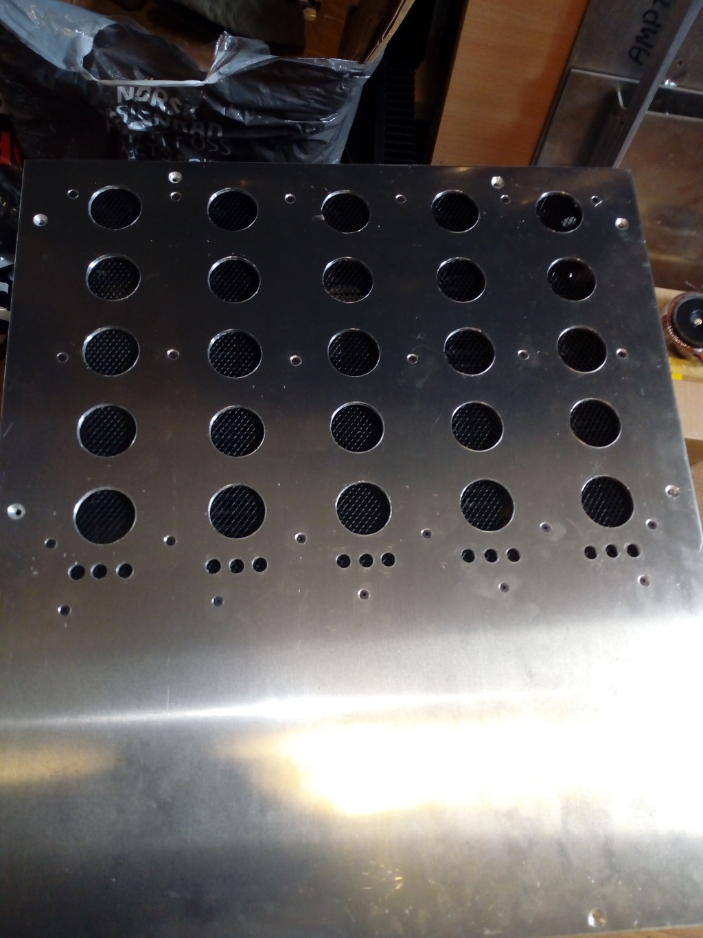

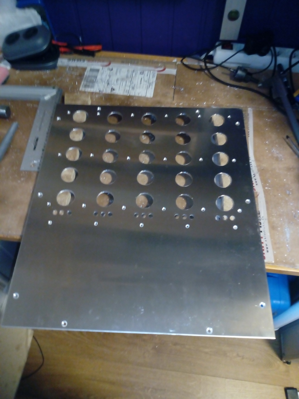

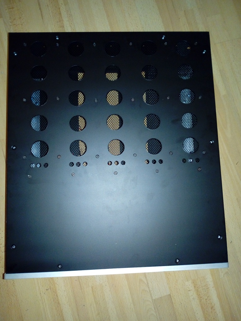

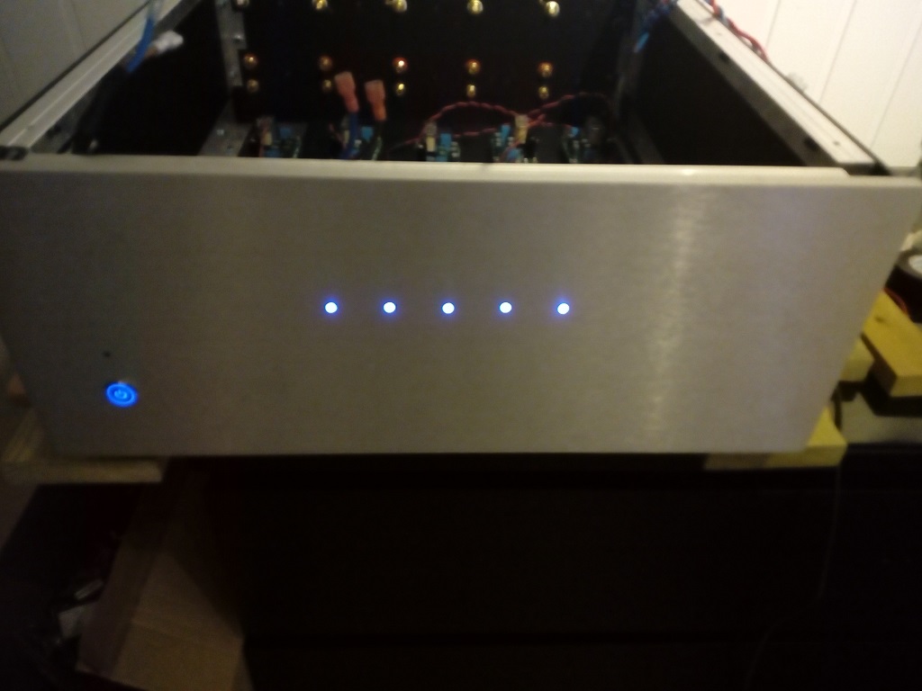

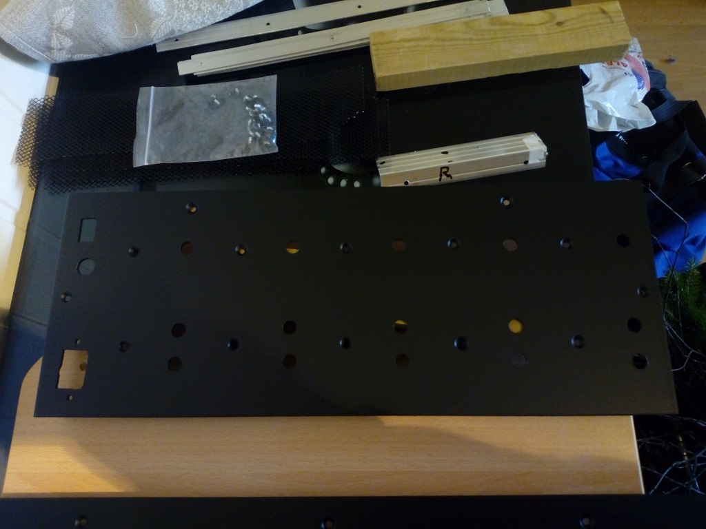

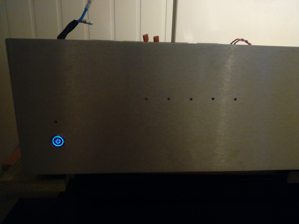

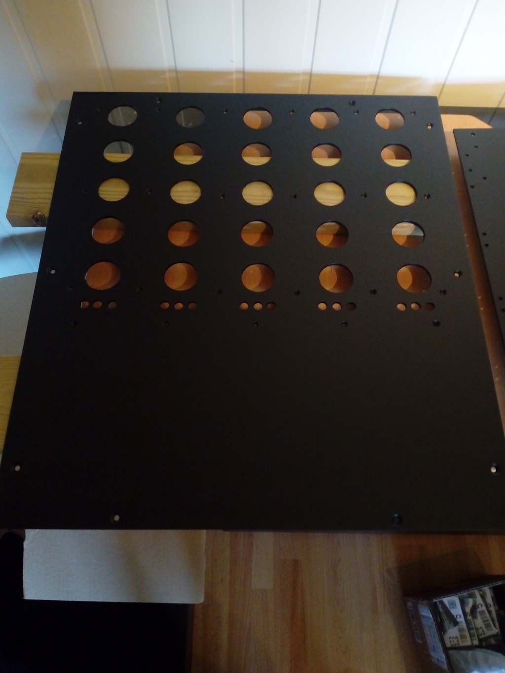

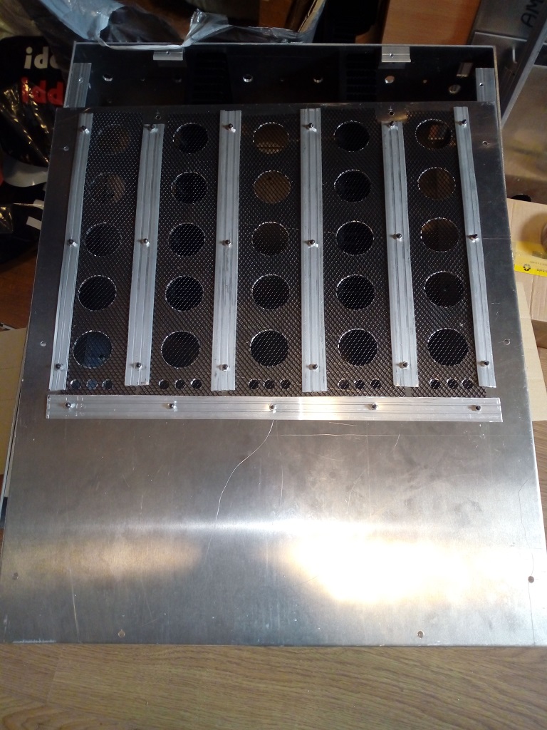

Finnised the top lid to day. 5x35mm + 3x9mm vents pr heatsink.
The wiremesh came from a paper trashbin 🙂

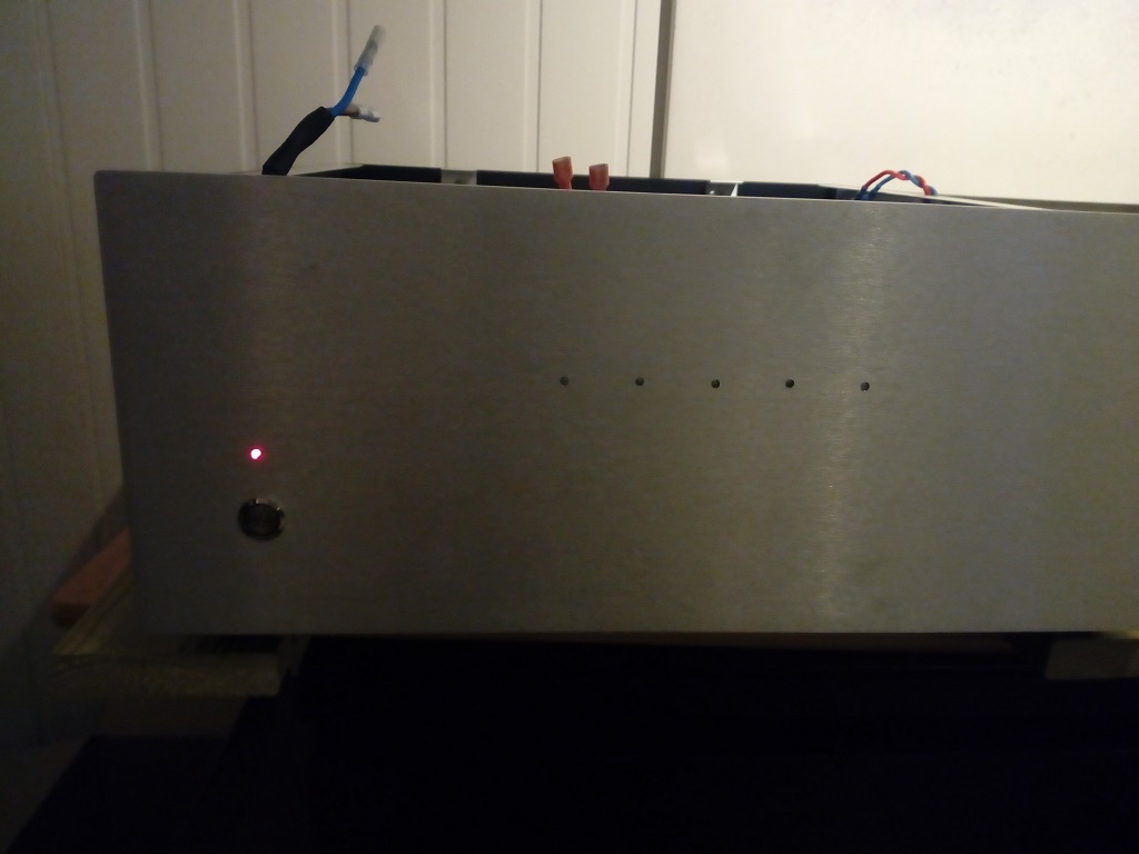

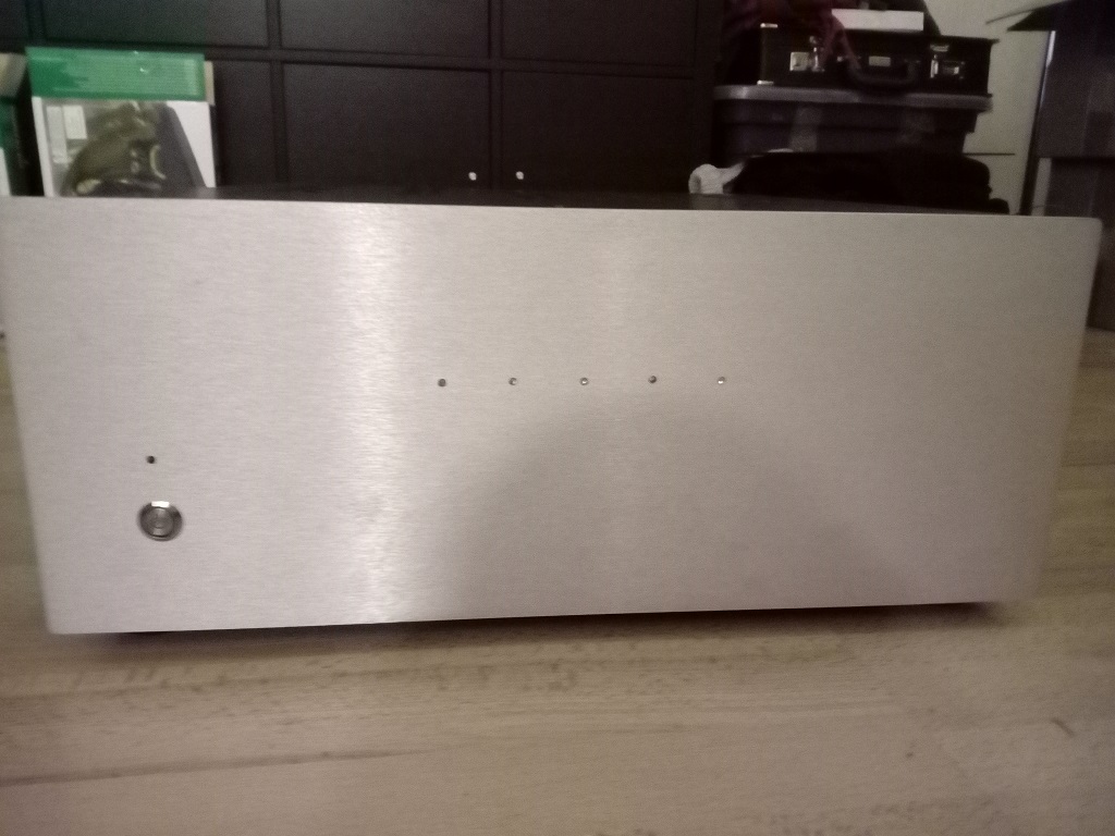

I also got around to finnish the front panel. Just missing the LED's.

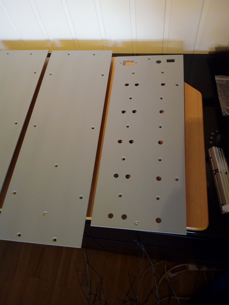

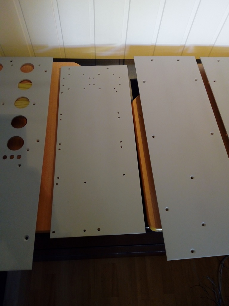

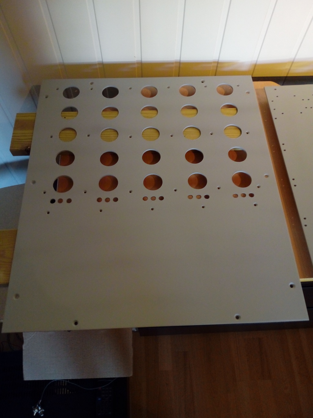

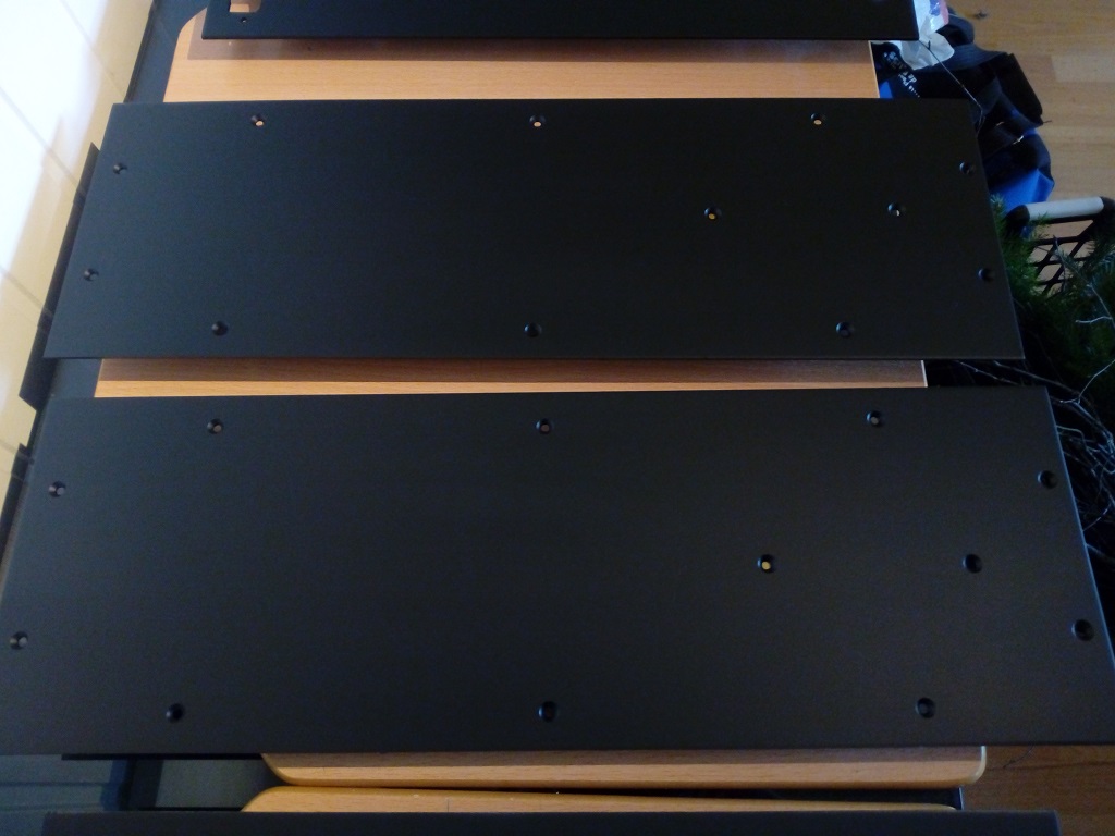

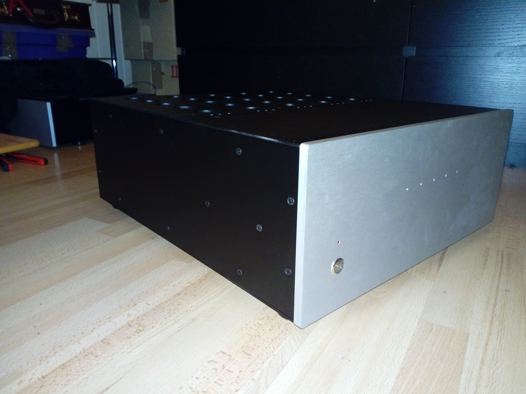

Got some painting done. 1 layer of primer on both sides. And 1 layer of paint on the inside, and 2 layers of paint on the outside. Just missing the bottom panel and brackets.

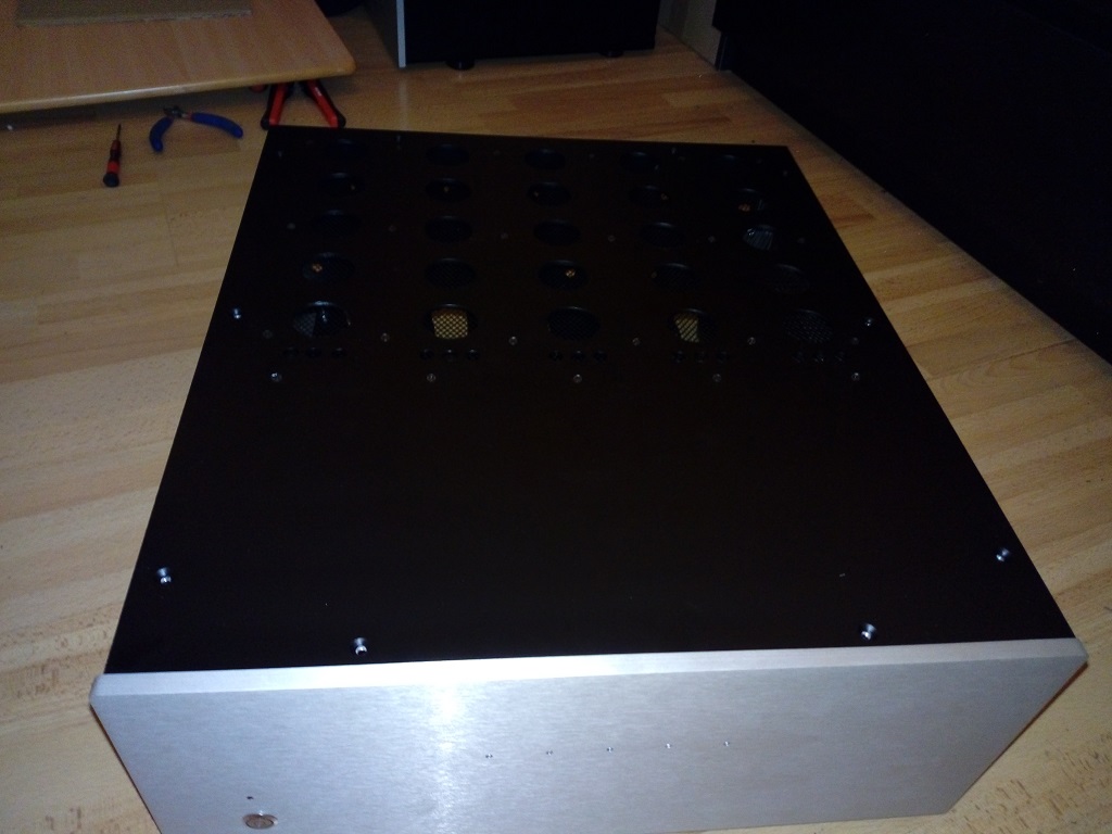

The chassis is comming together. Don't mind the glitch on the backpanel. That will be gone as sone as the heatsinks are in place.
