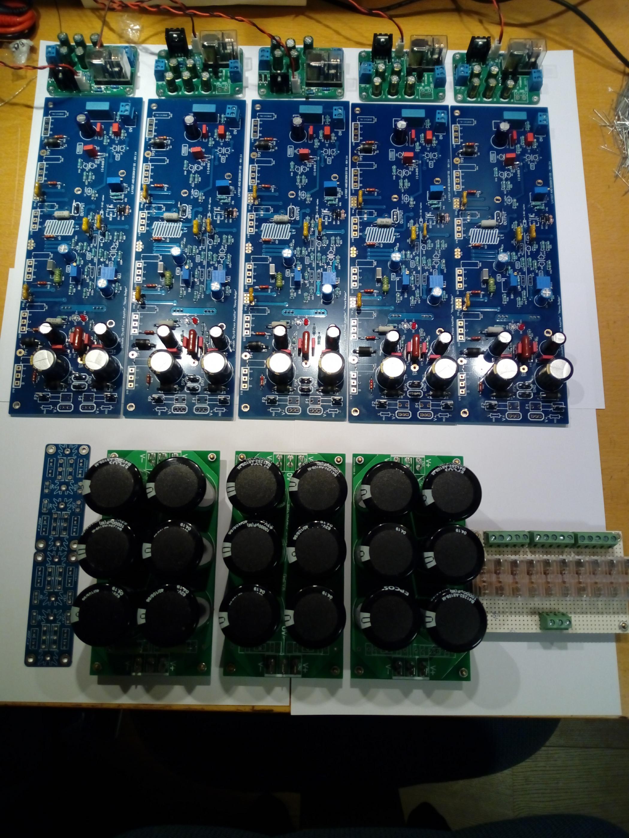

So. ater about 2 months of partsgadering and soldering it's getting close.
I did move the fuses of the boards so that they can be changed. It's going to be tight.
I hope to get startet with the chassis build next week.

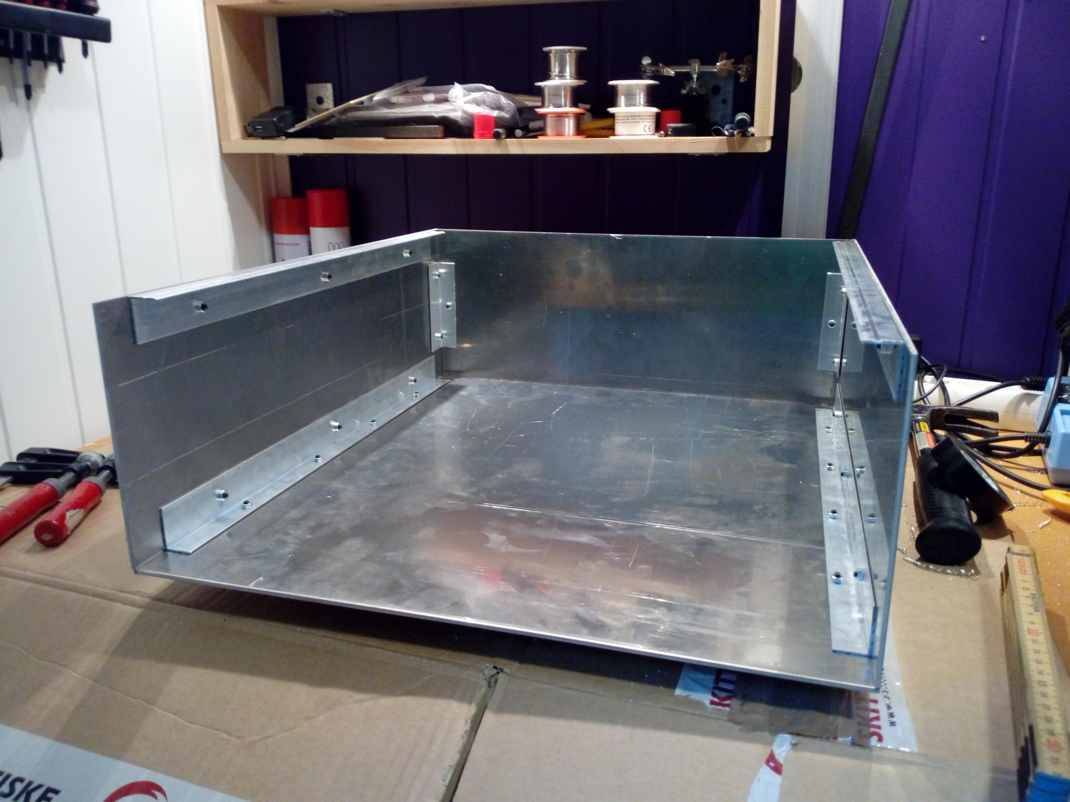

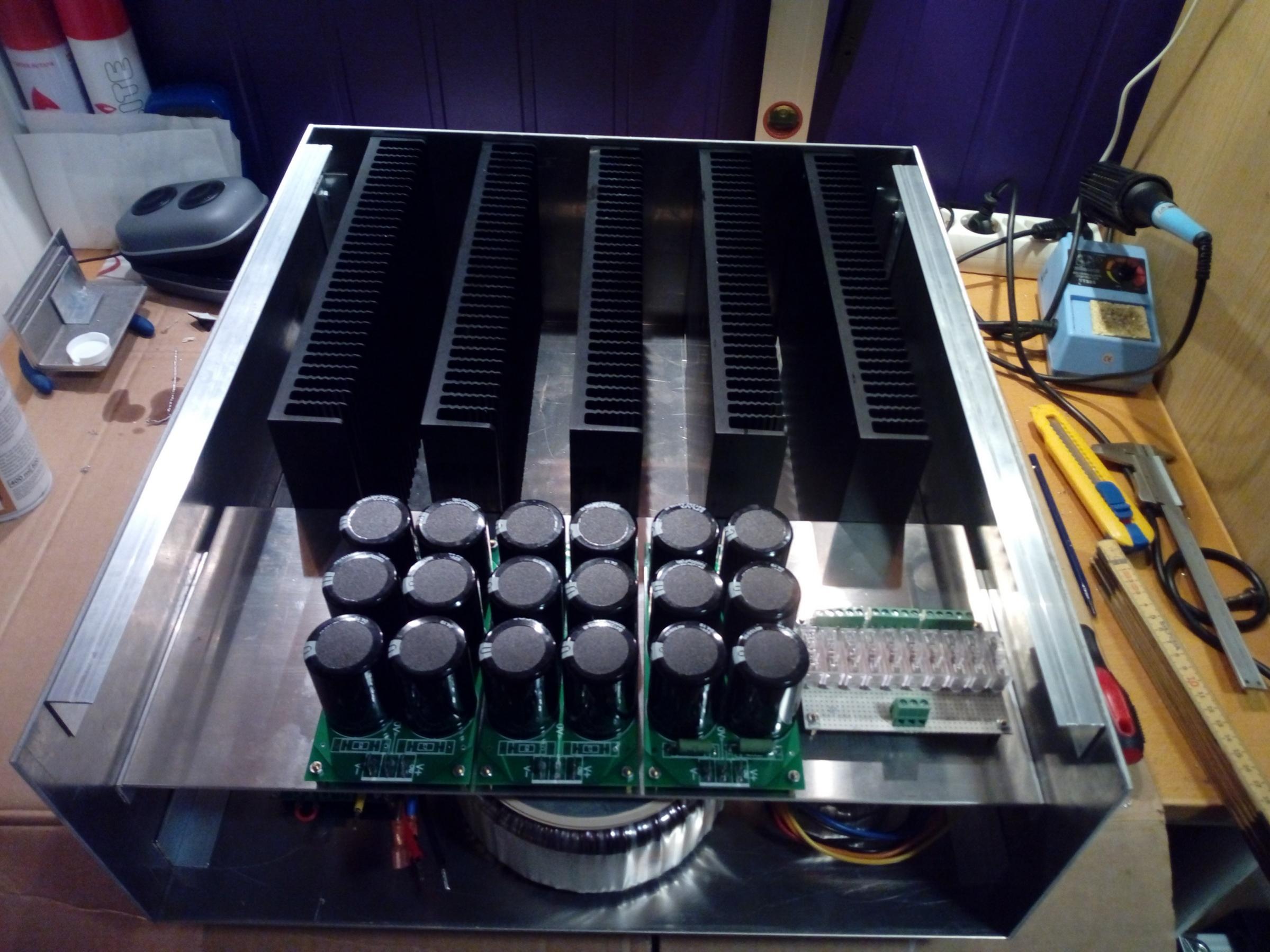

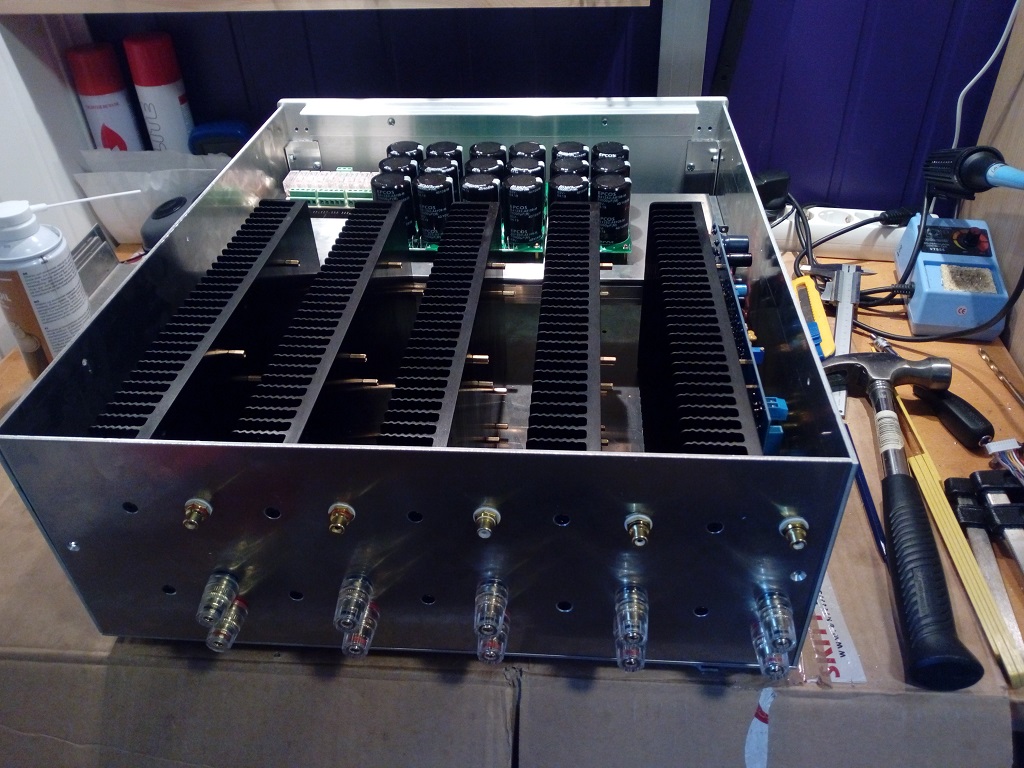

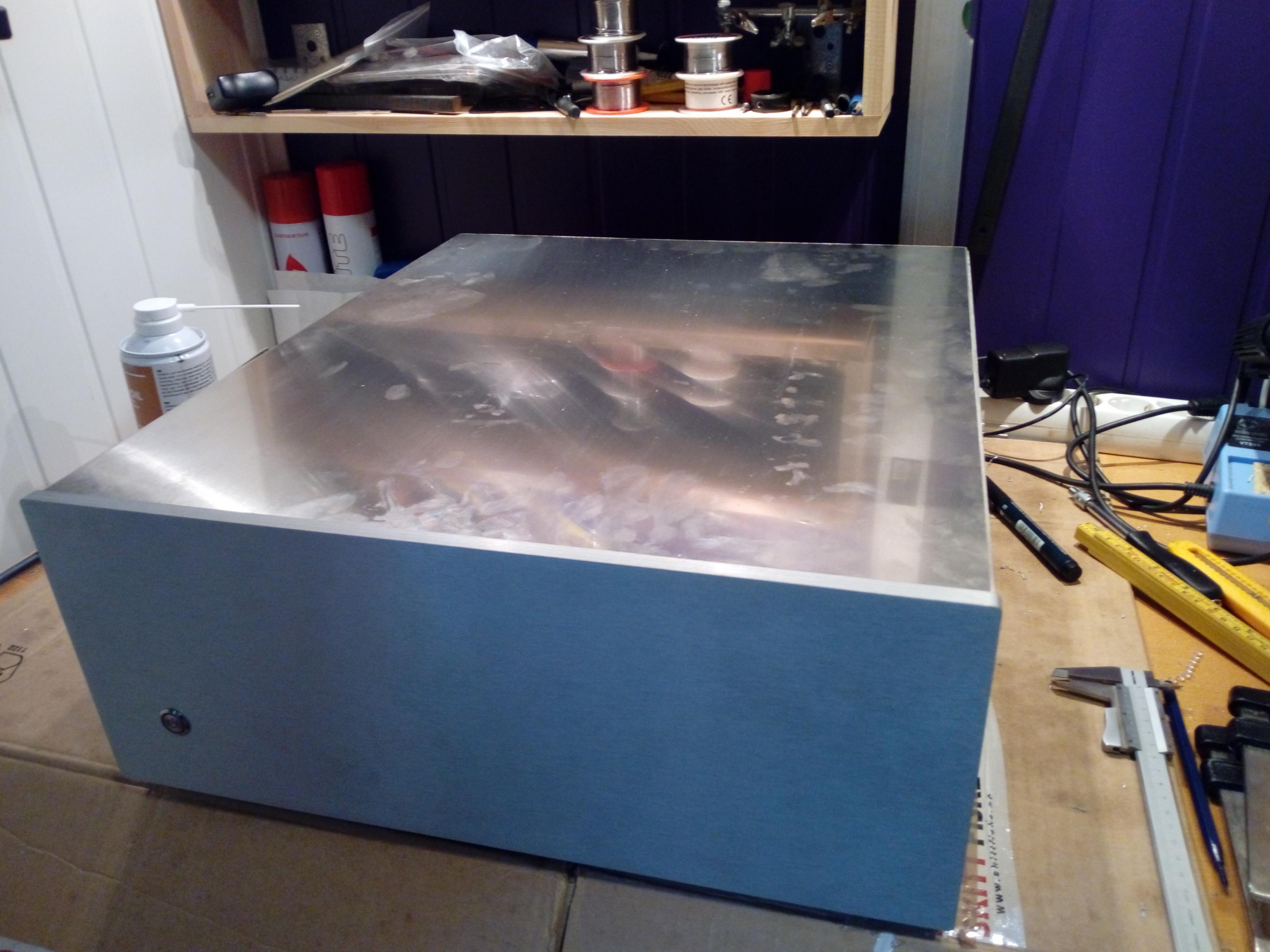

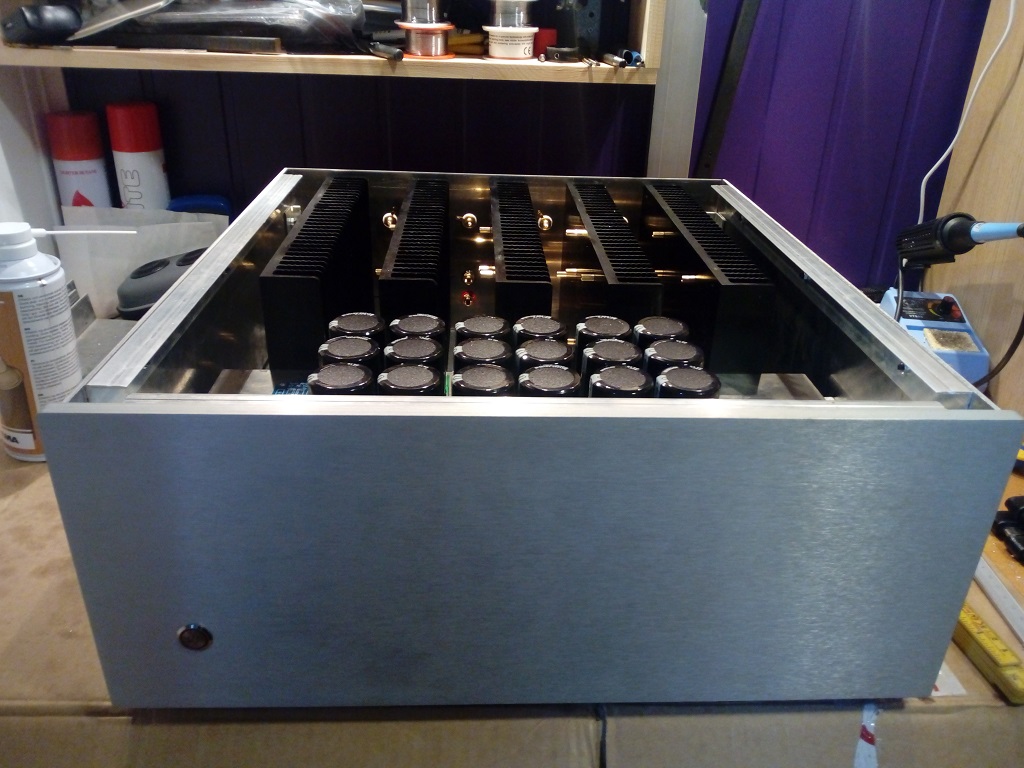

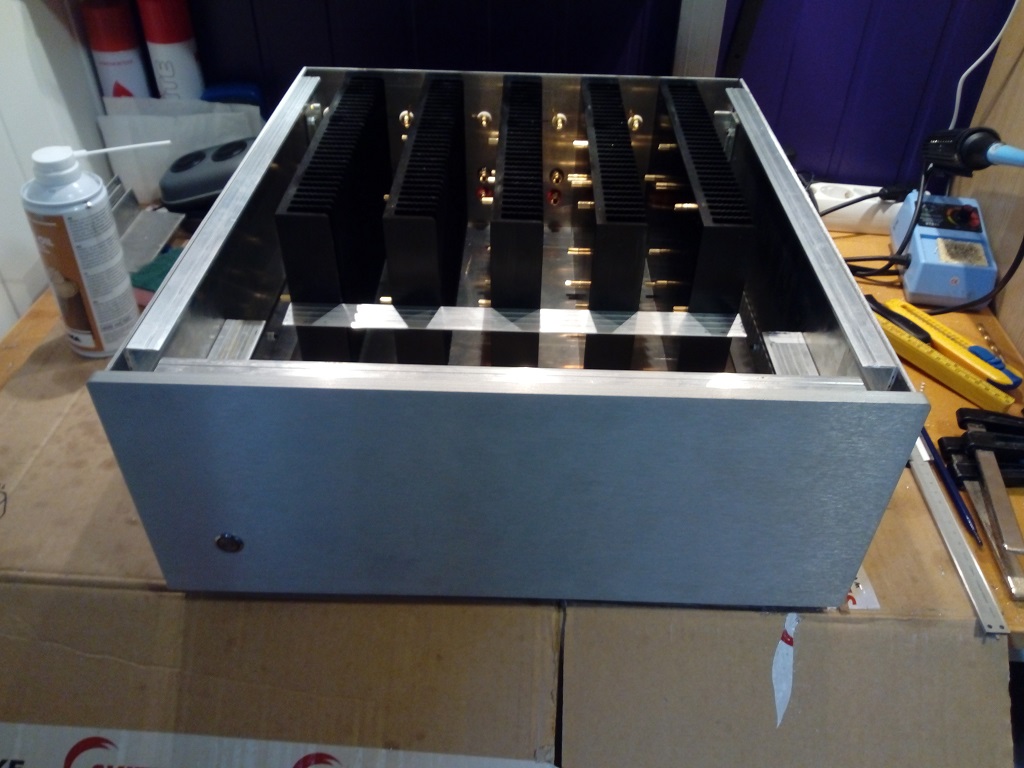

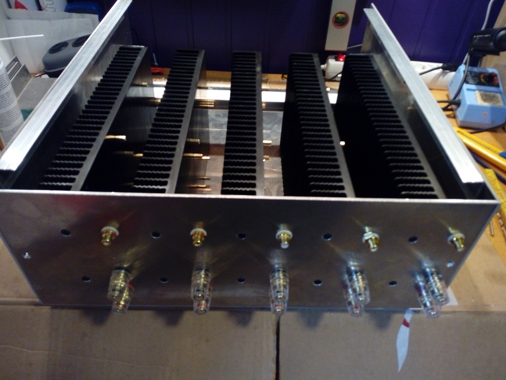

It's slow and steady, but it's getting there 🙂
Still missing 1 red LED and 5 blue LED in the front. and to get som vents on the top and bottom and some paint 🙂
drilled out for IEC on/off switch and fuse holder on the back panel to night.
