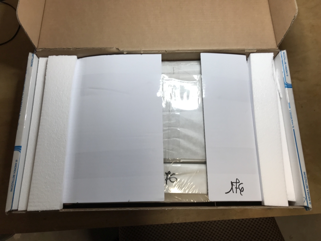

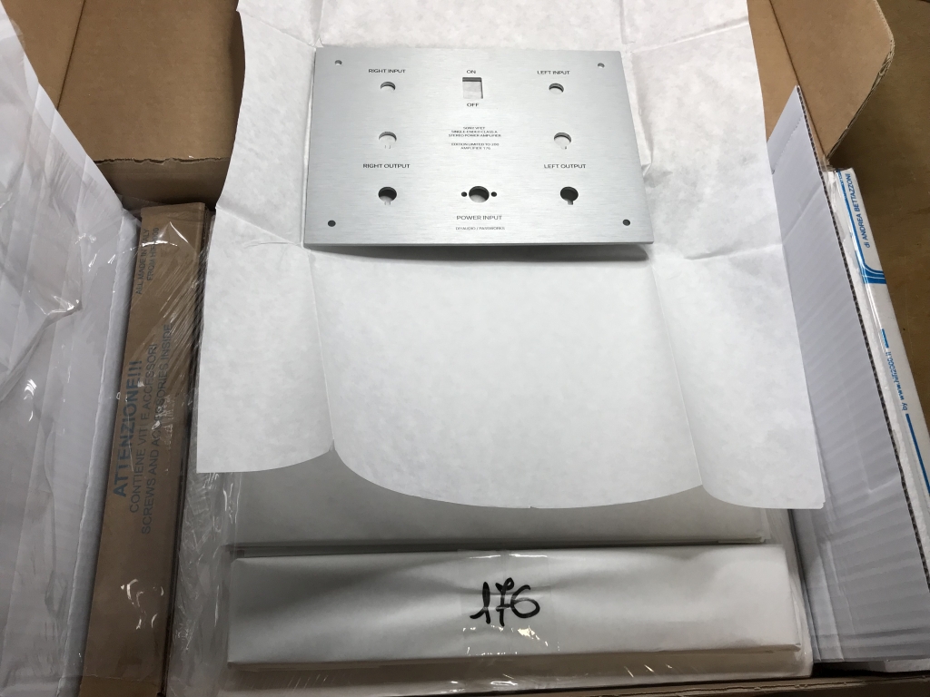

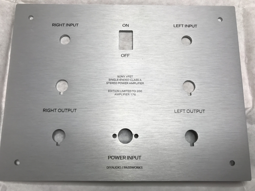

Chassis No. 176 arrived here this morning
Nice, cool, new, packaging !
Parts kit is scheduled for tomorrow. It seems to be already in Cologne at Customs.
Regards, Claas

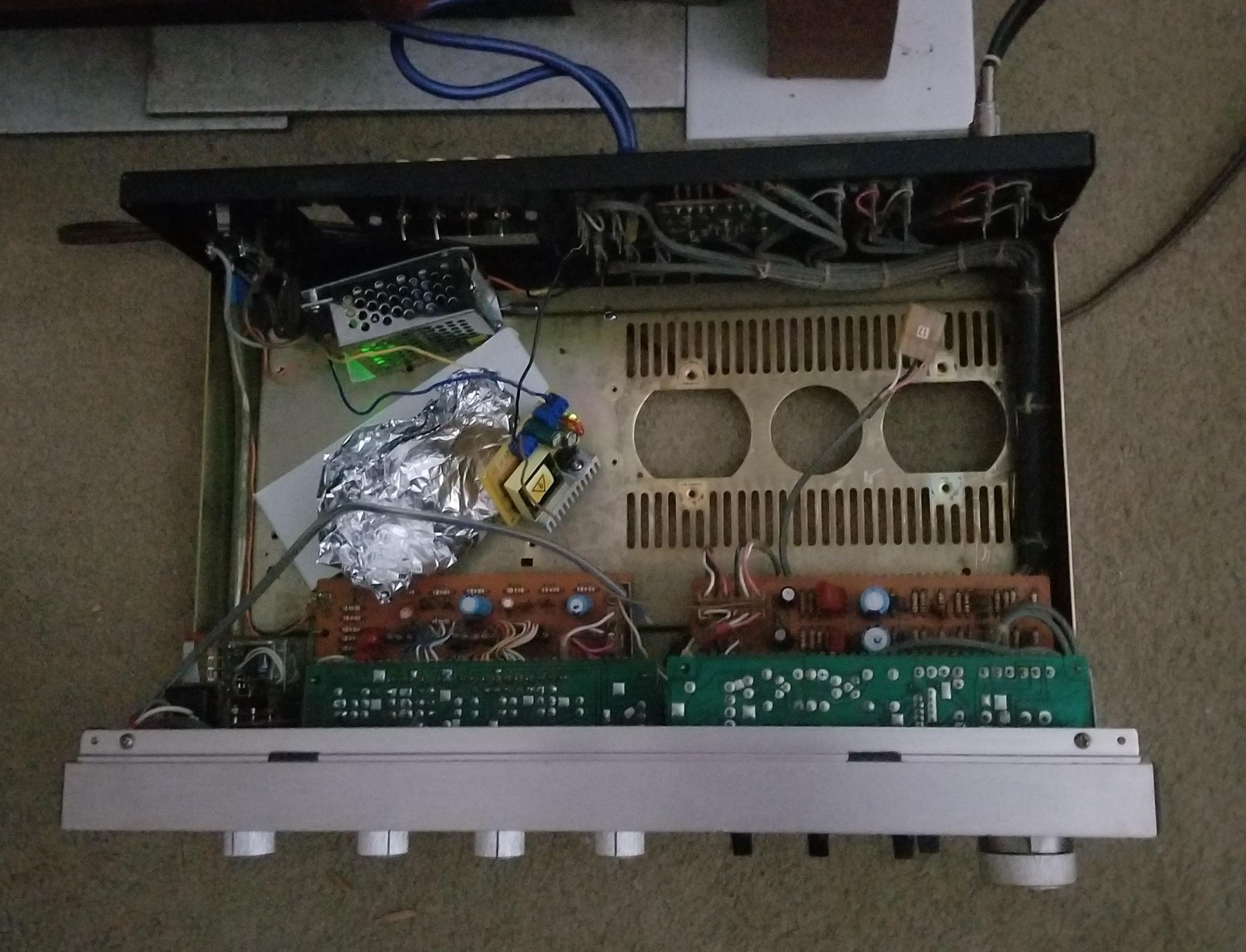

Hi, jonboylaw. Yes. As soon as I win either another board lottery, or NP and the store release the boards for 2SK60 (or SKJ18), I will be using the 4650 chassis for the build. The small 1 amp 20V SMPS powers the preamp fine and sounds great, no discernible noise. I have a small voltage booster attached to it, and that so far also powers the 100v phono stage. It needs shielding, however, it hums, and I am figuring that out now. So far aluminum foil shields it.
I will include pix as I go along. I will have a second 36v (??) SMPS that will fit internally for the amp stages.
The second SMPS should fit fine inside the chassis @75w/channel for the 10 (??) watts class A or so per channel.
This is only my second DIY after the Korg preamp, so it is a learning process as proceeding.
I have noticed that the phono-stage will pick up stray mains noise without the lid on. Try putting the top on and see if that helps.
Any links to the SMPS and voltage doubler would be gratefully appreciated.

The encasing for amplifier No 006 of 200 arrived in Nuremberg, tomorow the set will follow, hopefully.
I am really looking forward to build the amplifier and hear it, with shlight modification, I will use 2 SMPs. I hope, that will not reduce the value, I only do it, because I always use separate supplies for each amplifier and because I already have them

Hi, Jon. I picked the 18v 1 amp model for preamp section. Screw adjustment allows up to 20v output. Attach power leads to switched outlet rail and positive 20v output lead to positive SMPS output to preamp board wire, run ground to ground rail.
The Amazon item is a voltage booster, attach it to the 20v SMPS output in tandem with preamp outputs. The voltage booster also has a screw, use volt meter to determine output when turning screw. Run it up to 100v for phono. Place 100v postive lead to phono board lead wire/ ground to ground rail. Voltage booster needs shielding.
Both items are pretty small and fit into the chassis and leave lots of extra room for amp cards. When both placed, full inputs, front controls, phono etc are functional.
Here it is in main system source>4650 preamp>First Watt M2>full range panels. Sounds great. Also, those baby 63 VFETS in the phono sound outstanding as well.I have noticed that the phono-stage will pick up stray mains noise without the lid on. Try putting the top on and see if that helps.

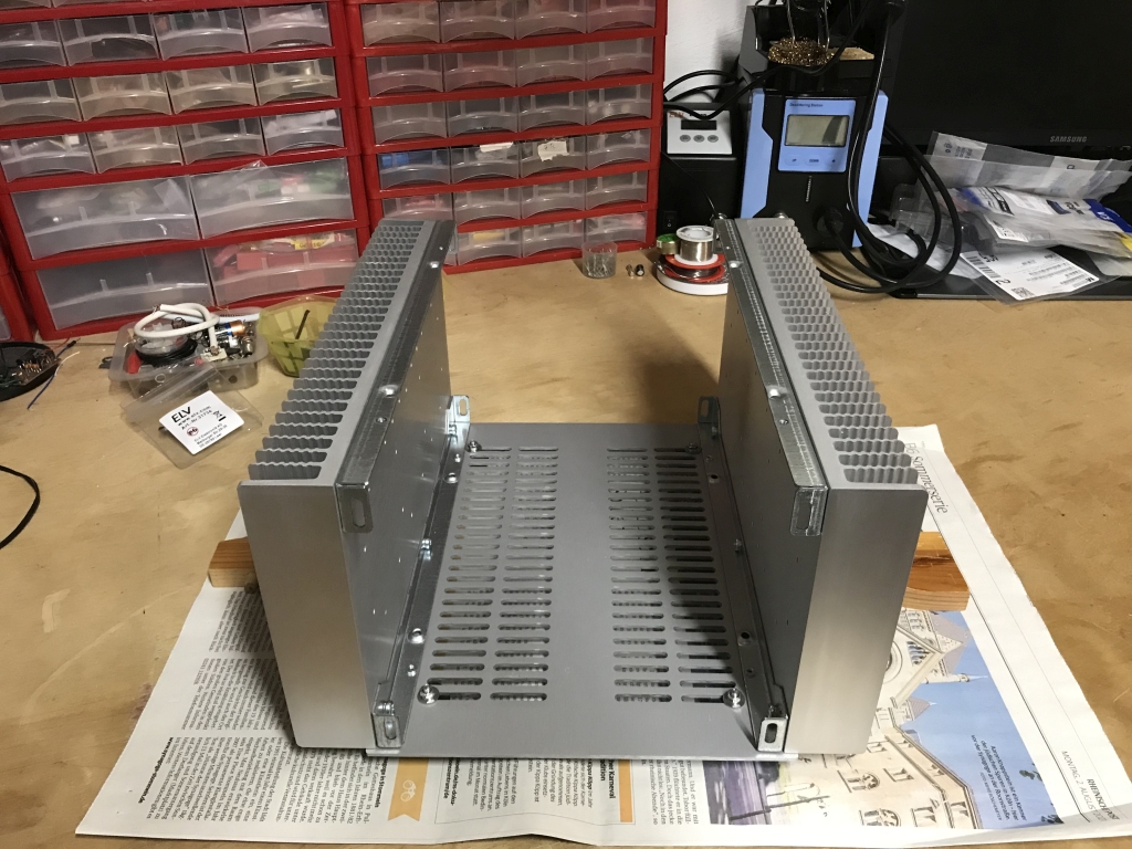

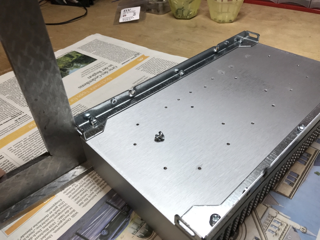

Because in the meantime, I couldn't do much ...
Smoothed a bit the part of the heatsinks where the T-brackets go to get optimal heat transfer ... mounted rails and rubber feet ...
Regards, Claas
