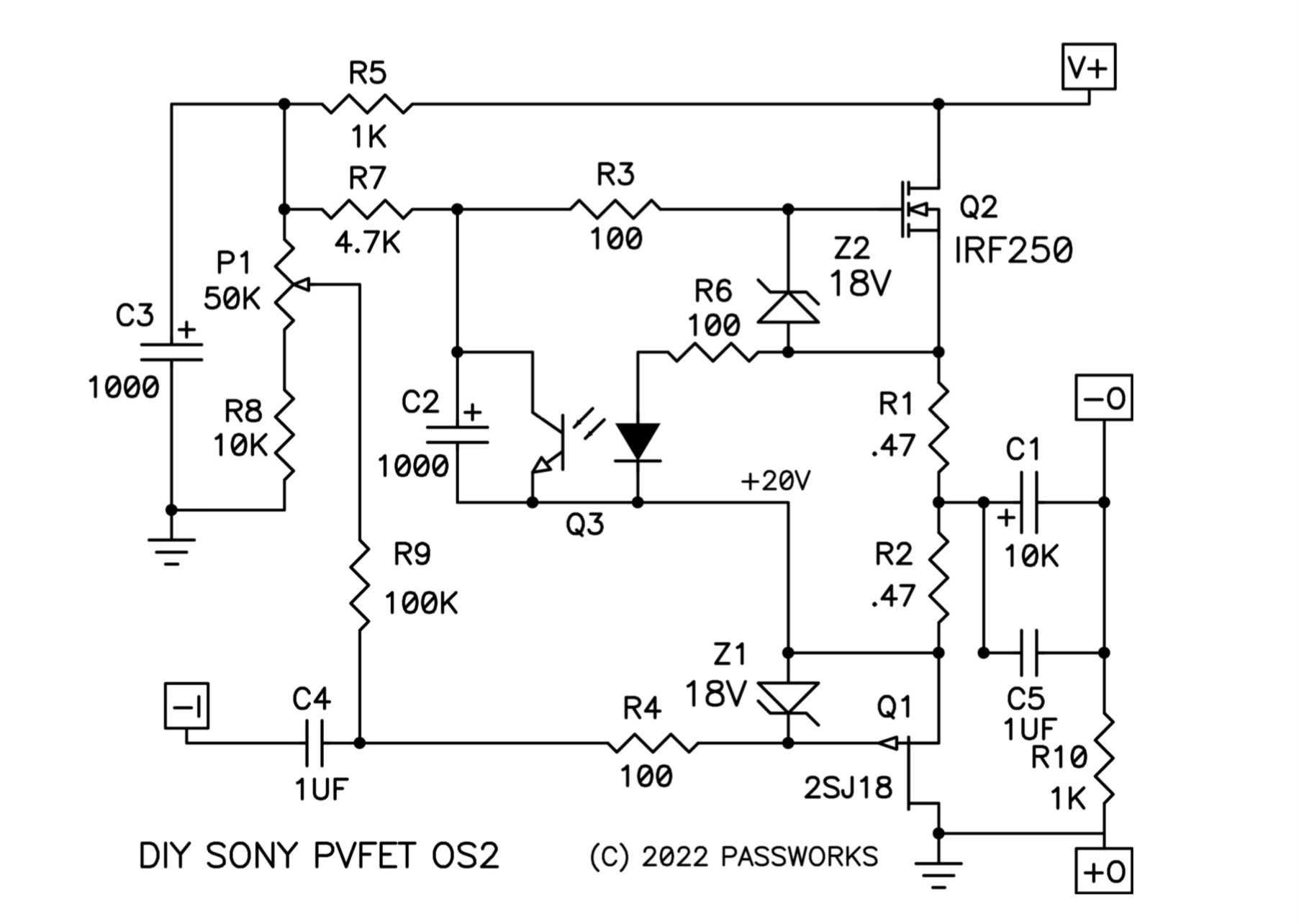

I have the the Sony PVFET OS 2 boards almost done, I do have 'another' question. On the schematic OS 2 R 1and R 2 are .47 ohms. The kit supplies .84 ohms resistors. Do they have to be .47 ohms? thanks in advance.
Depends on the transistor. With 2SJ18, take 2x.47; else with 2SJ28 take 1x .84. And a short in the second position of R2.
(I have .82 because that was in my box (the kit i got assumes 2SJ18) and I complemented it with .12 to get the original total of 2x .47 value; but I know I deviated from practice.)

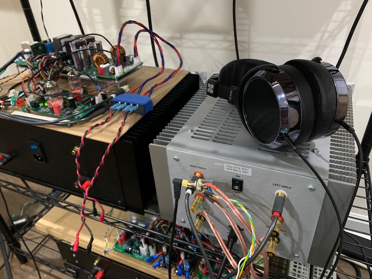

I'd ask a few things in addition...
1) Is the amplifier in the picture the p-channel VFET offered as a kit mentioned in post #1 of the thread?
2) If so, did the extraordinarily-skilled builder of the amplifier choose to wire their speaker binding posts differently than the build guide for their own reasons?
3) If I have a P-channel VFET amplifier built per the guide... should I connect my adapter in the manner shown in the picture?

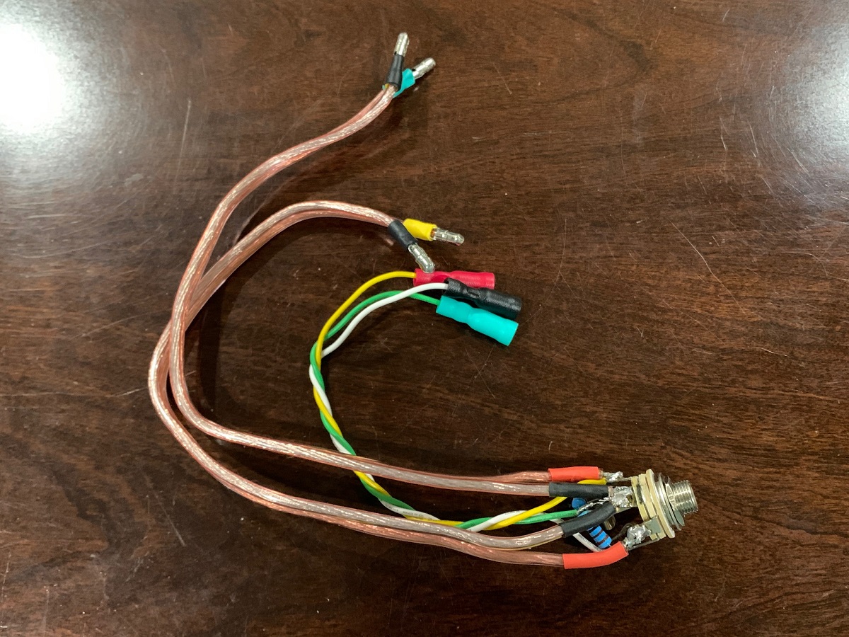

Hello,
How did you wire TRS phone jack to speaker cable adapter ? I can see some resistors.
I have two 220ohm 1W resistors wired from Ring and Tip to Sleeve (GND) to provide a small high impedance load for the amp - this is mainly to drain the DC offset from capacitor coupled outputs so I don’t get a big pop when I plug in the headphones for the first time. Other than that, the TRS jack is wired Ring to right and Tip to left and Sleeve to GND (per usual convention for TRS stereo).
Some people like to use 22 ohm or 47ohm or similar resistor in series to reduce the signal getting to the headphone. I don’t have that.
Be careful with DC coupled outputs as a single turn on thump or pop can destroy a sensitive headphone or earbud just like that.
