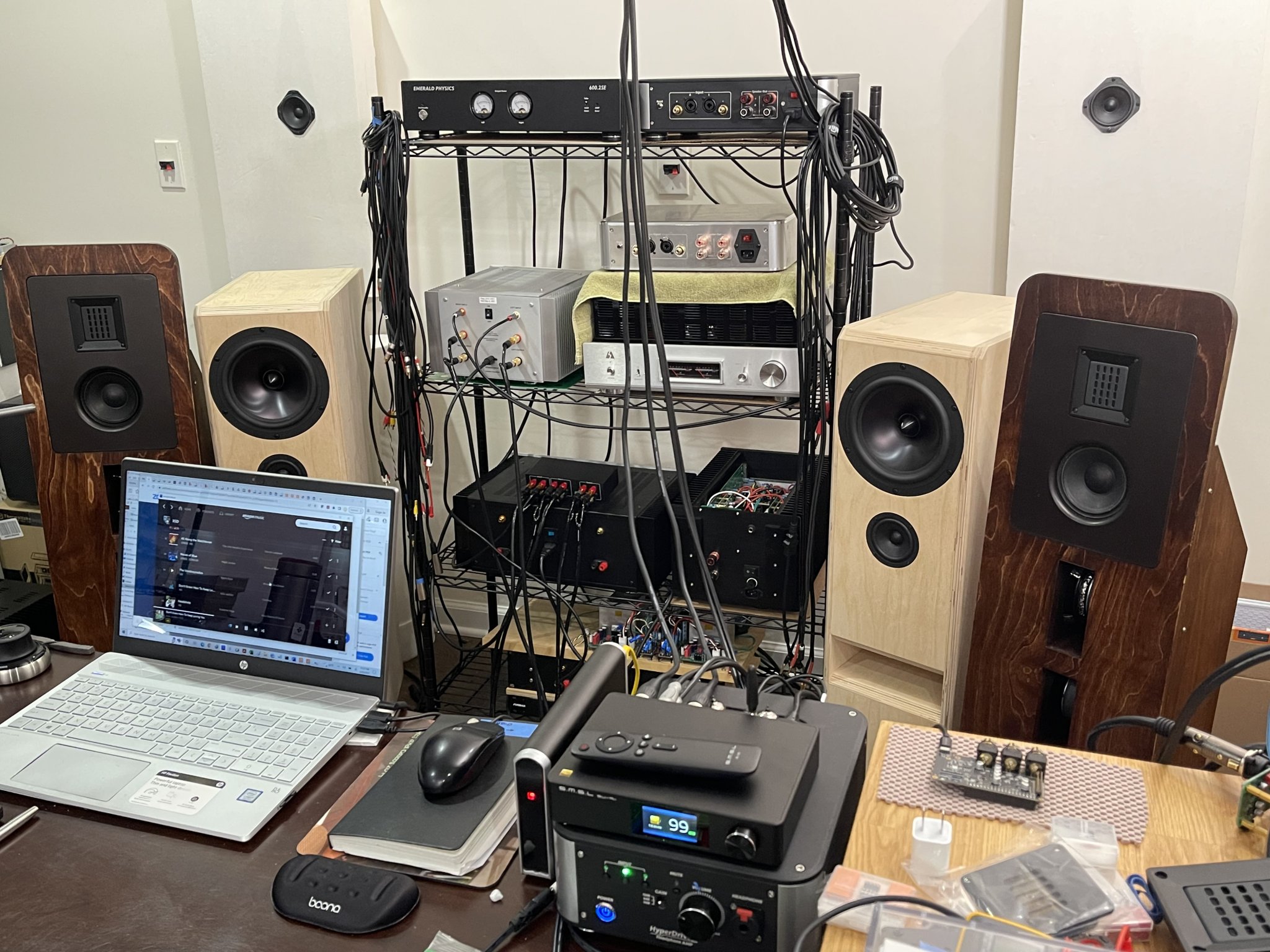

I just brought my VFET back into rotation. This time with my current SLOB dipole speaker project originally inspired by Mr Pass’ creation. The speaker is 4ohms nominal passive crossover (waveguide planar tweeter, 5in PA paper cone mid, 8x 6.5in woofers in slot loaded open baffle array and a U-baffle) but 91.5dB sensitive. I am driving with SMSL SU-9n DAC and my own hybrid preamp with 12dB gain. I had some doubts that it could drive 4 ohms but is handling it marvelously. I have never heard such SPLs or bass from the VFET before. The soundstage is airy and floats above the speakers. There is a delicacy in the vocals that the Class D amps could not match. I’m enjoying it a lot.
Coincidentally I brought my SLOBS out of storage yesterday. These are the ones that will be at Speaker Camp next month.

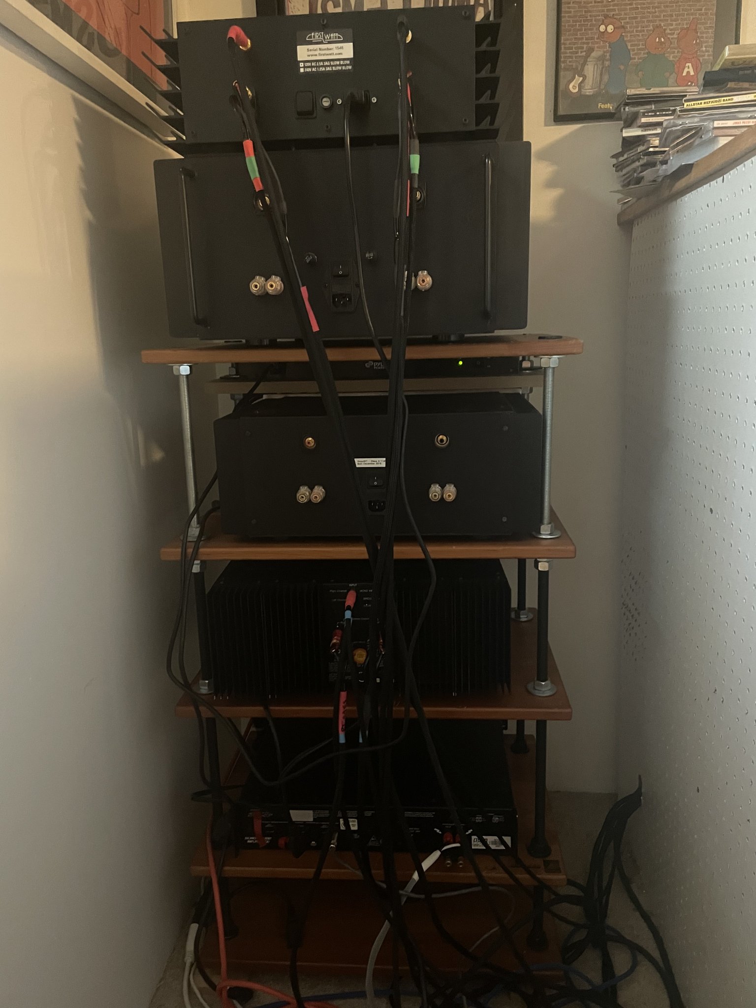

Yep, for us guys who like to swap amps often, it is the only way to go. I also have an amp A/B switcher box so that lets me choose between at least two amps on active duty pretty easily. On amps with a front panel VU meter it is a harder decision.
Years ago, I remember reading about how Google desgined their own server farm rack mount computer chassis. They simply put the business end facing out so cable access was easy. I think they maintained RAID drive hot swap on this same end as well. Only the power cord was on the "back". Nowadays, i think many server racks follow this trend.
Nice Rack!Xrk,
I’m happy to see I’m not the only one with the amps on the rack with the business side facing out.

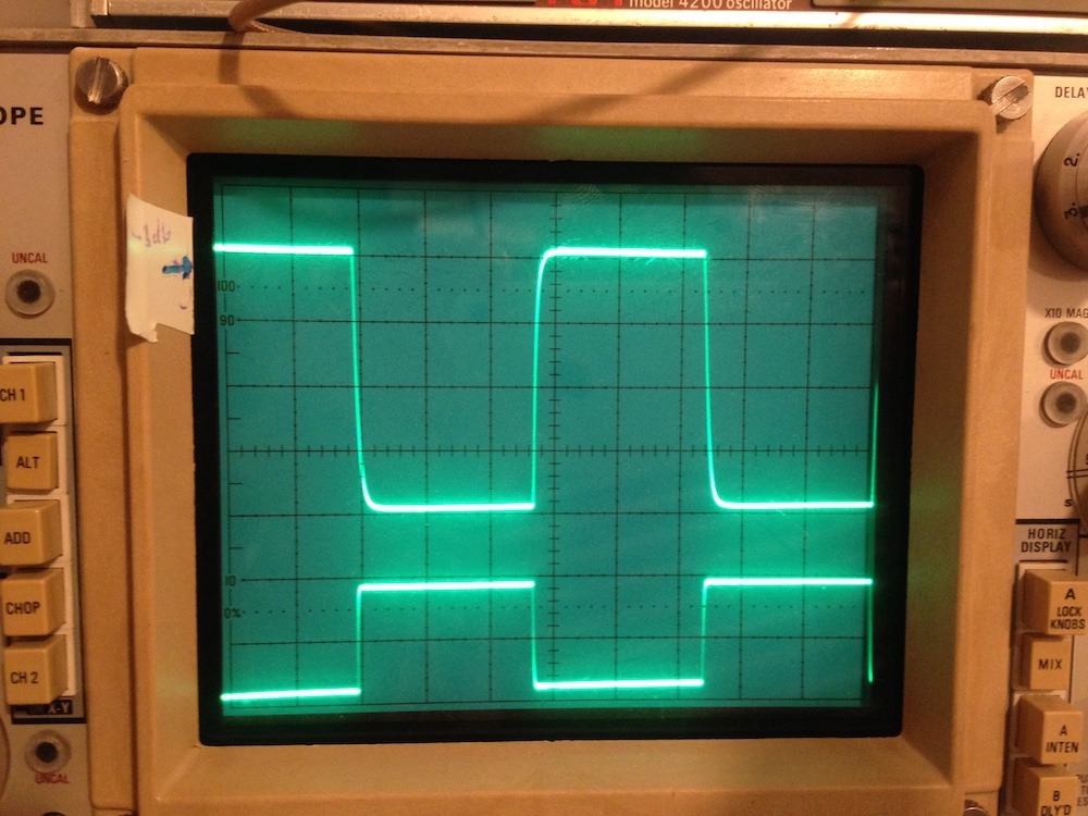

Does anyone have experience with driving the V-FET 2SJ28 follower using a triode front end? Pushing a bit like < 5 V RMS, I never go above a watt or two.
I just made a new ECC82 preamp and I could not be happier. It is based on an EAR circuit by Tim de Paravicini that I modded a bit using positive feedback to suit my purpose, based on ECC82/12AU7 (in fact, I used 5814 and 12BH7).
Simulation shows Low distortion. Fine square wave at 10K/9V RMS. Low output able to drive even the full gate capacitance of > 1 nF (as a follower, gate cap of the 2SJ28 is reduced to hopefully < 20% of the value)
So I thought to make another one, now using 6SN7 for dring the SIT. And put that in the V-FET box . .

That's why I put the power switch on the back. 😉Xrk,

2SJ28 is easy to drive, but you want to check the high frequency rolloff for the VFET input capacitance. For the approx. 150 pf, it will rolloff at about 100 KHz with 2500 ohm source impedance (I am using the data book figure). I expect that you can scale this with whatever the plate value of the Triode is.
More than 100kHz is not practical. So I’d add a gate resitor anyway. A 6SN7 as cathode follower might even have an output impedance of below 400 ohms …
Or drive it from a big triode from the anode directly, say 10Y. Choke loaded for instance. 800 ohms. Lots of ideas. It should be possible. 😎 Some of these tubes have a warm sound. That should not be pronounced.
