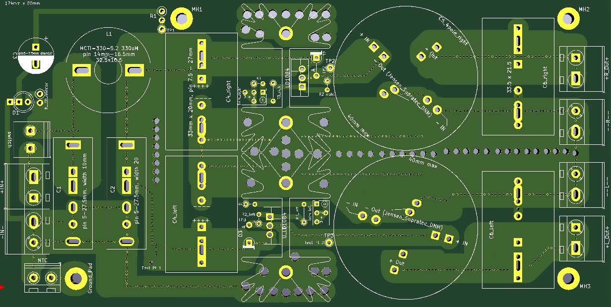

I took up Mark’s challenge to ruin his Tuba-Filter with unnecessary and superfluous parts.
Notes:
Terminal block footprint for either 6.35 or the usual 5mm
4-pole cap on output
Heatsink part of the ground
Kemet R75G14100 1uF cap ESR 4.8mO
Potentially can use Wima DCLink 40uF at C4 and output
Bourns 3266W trimpot either 1K solo or 5K in parallel with 1.5K resister. I noticed this footprint is different than the one on Marks Tuba PCB
