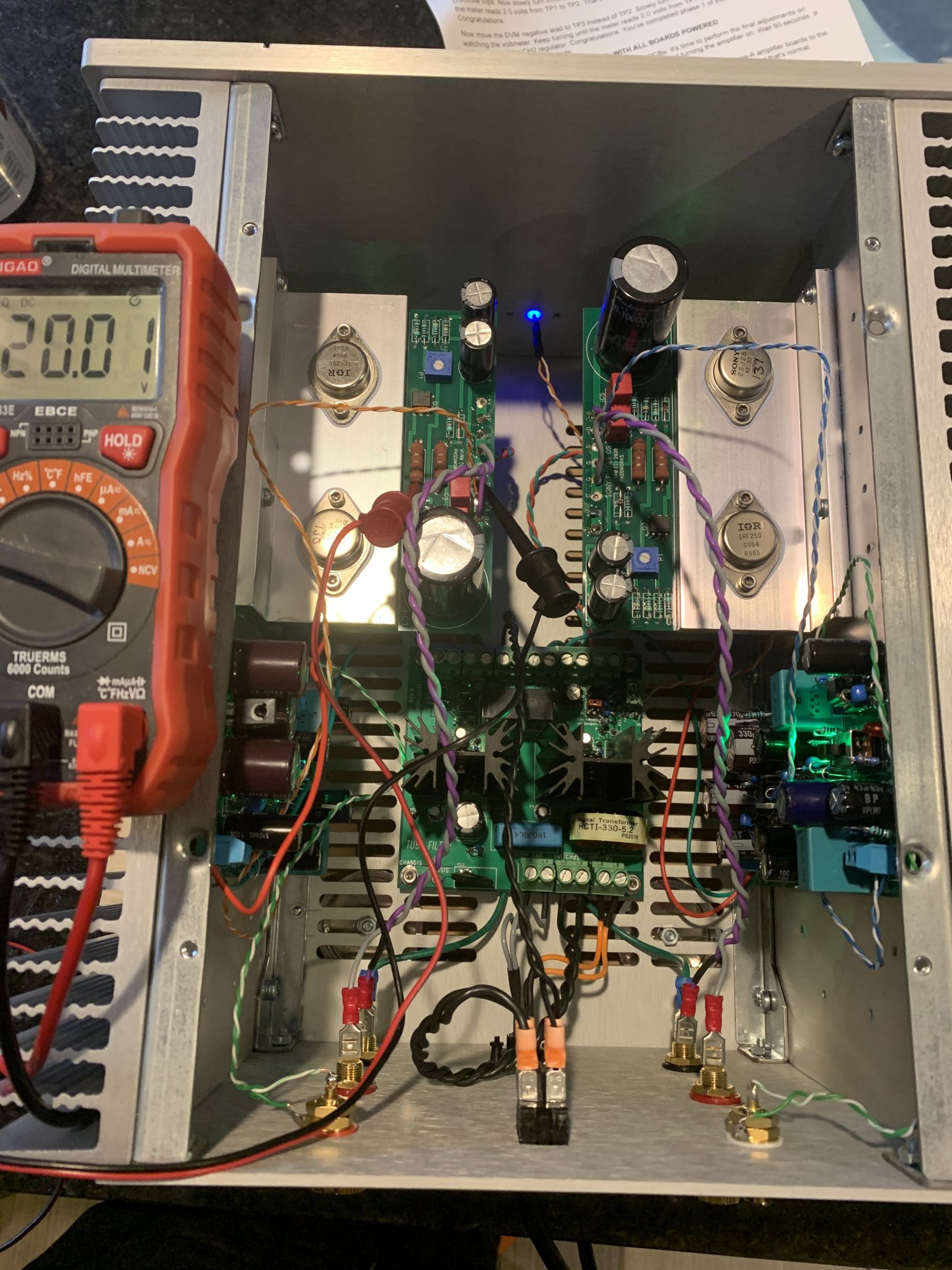

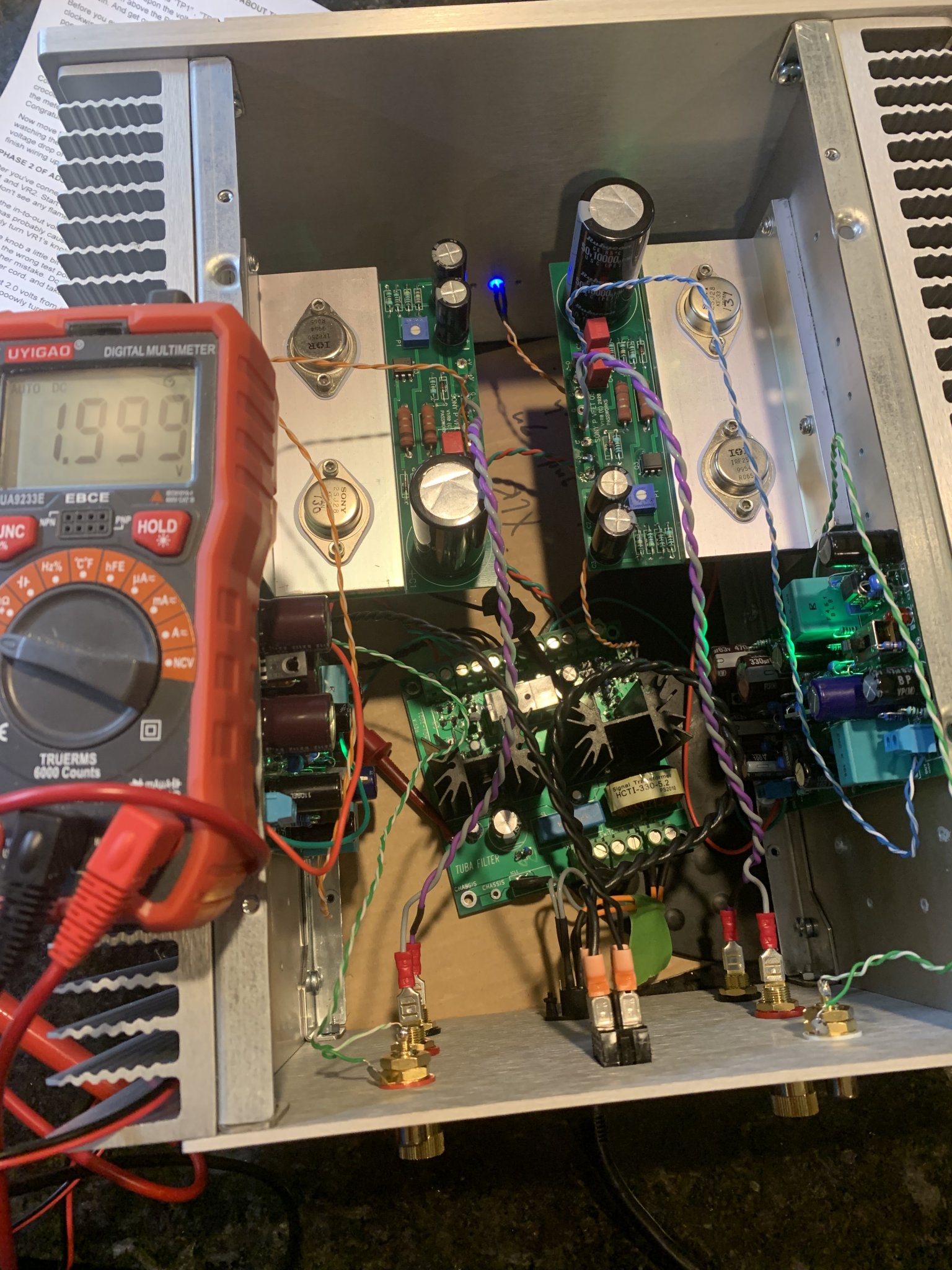

Tuba filter installed and tuned. Pots on main boards readjusted to 20v. I’ll give the Tuba & Marauder combo a run later tonight. Thanks for all the great work Mark!!!!
Fantastic job, Randy! VFET amp owners, especially those with N-channel output stages, will be eager for your listening evaluations about (a) audible hum reduction, (b) turn-off thump elimination, and of course (c) changes to the sonics.
Oh and the "PLEASE remove the 100 Hz spikes from my FFT" gang might possibly have a couple of breathless inquiries too. They're intrigued by the dual independent voltage regulators @ 2.2 amperes apiece.
True Mark, that sums it up nicely,😀. "C" is especially important as my VFET amp is very quiet already.

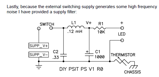

Please could you post or link to the schematic for the VFET kit is a 2nd order filter with Fc = 460Hz?
Is the attached pic?
TIA
Felipe
The above attached pic is the schematic of the SMPS filter used with the first set of VFET amps issued by N. Pass and the diyAudio store. It is a second order filter (even with the leading 0.33 film cap) by virtue of the small inductor feeding the 1000 uF output cap. I used this filter board for a while in my VFET amp before building a separate linear supply. It works well enough for the P-channel VFET, but may need to be augmented for the N-channel version.
