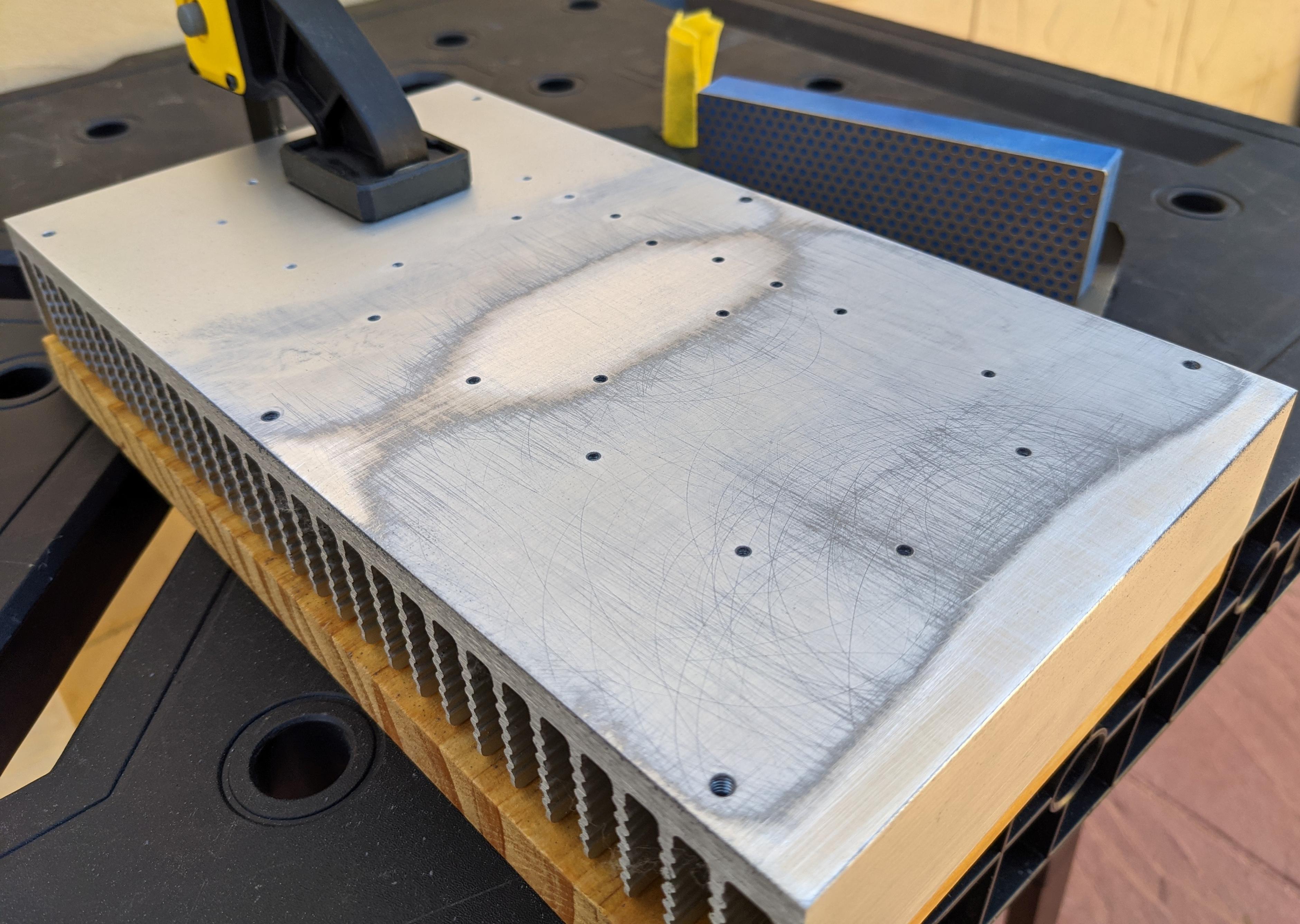

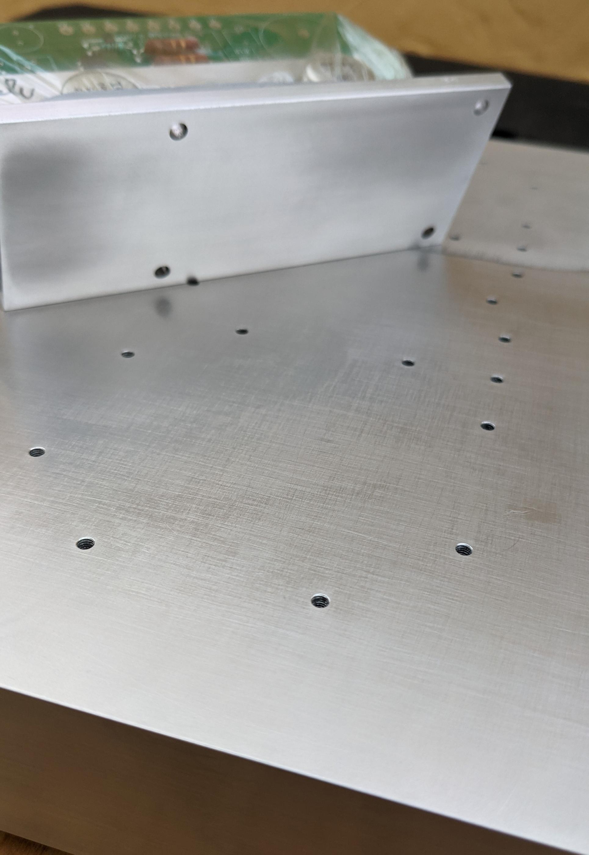

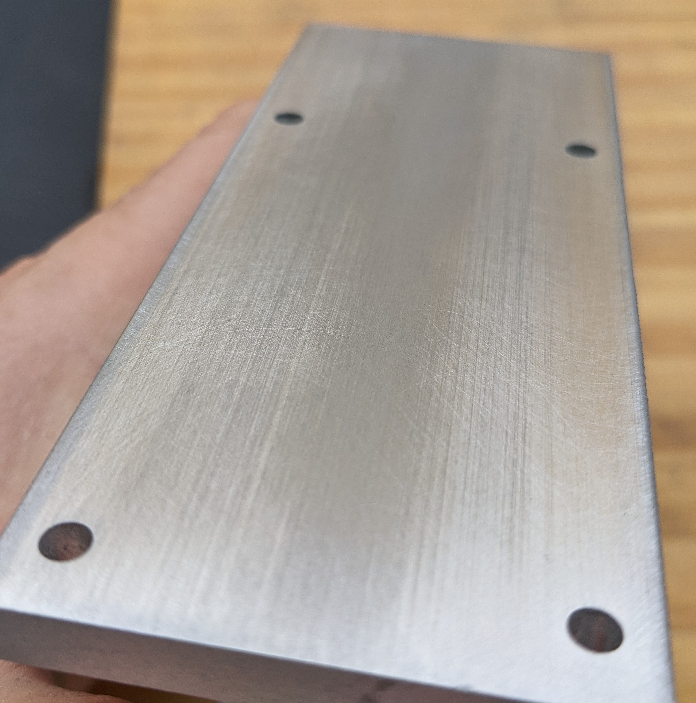

Upon inspecting the heatsink I realized that some sanding was required. This is definately a keeper, so I want the best possible heat transfer between the bracket and heat sink. I've finished one side and now waiting for some more elbow grease so I can do the other.
See pictures of before and after.

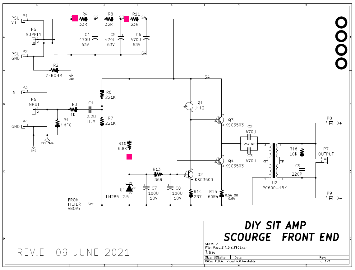

My Scourge FE cards are running in nicely so far. I built them close to stock; after all the full kit came from the store. I do reserve the creative license to do a bit of capacitor substitution. Mainly a polycarbonate 1.0 uF for input coupling C1, and a blend of Nichicon ES + Wima polypropylene at C2 + C3. Just for entertainment purposes.
At this point the boards are just starting to sound lively, but haven't quite reached the level of full transparency that I've heard from my Bulwark variations. Soundstage presentation is more laid back, but still nicely 3D. Foot-tapping quality is already there, so I am optimistic that these will continue to improve.

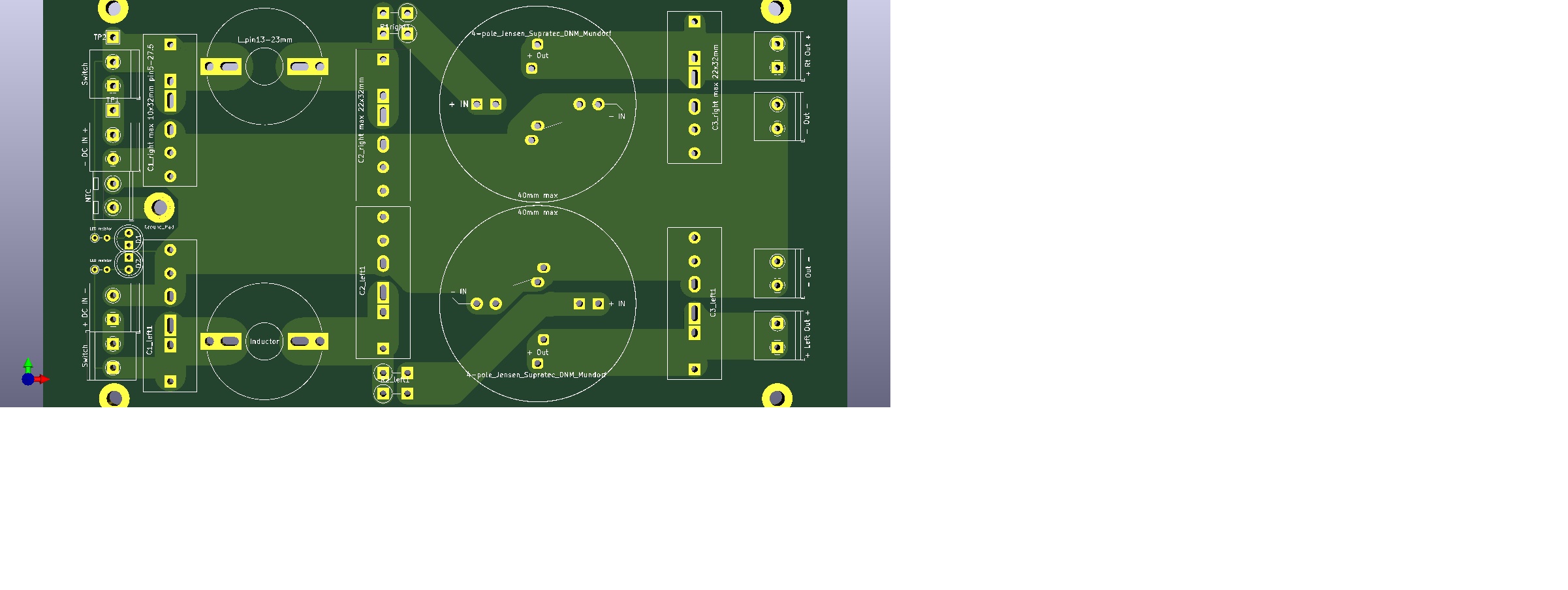

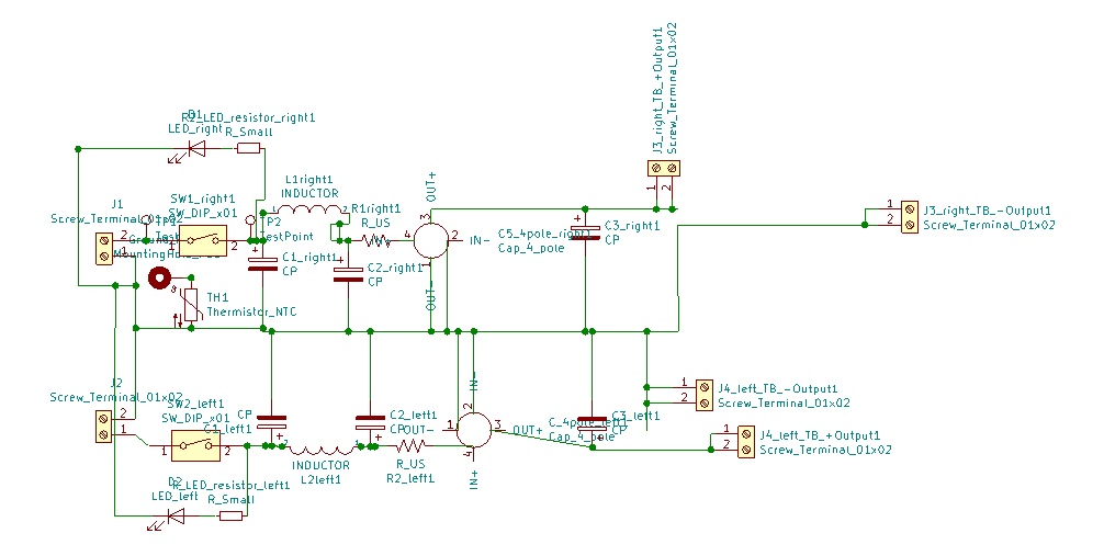

I have experimented adding an additional 2x4700uF (jensen 4-pole) after the stock PS filter in both separate Left & Right Caps and a C-0.1Ω-C config. No issues with the SMPS. To make a cleaner version from my perf-board trials I sketched out the following in Ki-Cad.
Separate channel CLCRCC. Can be configured single or dual SMPS. Could also be configured as CLCRCC-CC by taking the output from right channel and inputing it to the left channel (removing the left side R)
I was wondering if the first C (0.33uF) was optimized for this SMPS or was chosen for convenience. Same with the L value (120uH)

It's necessary to include the parasitic resistance and inductance of the capacitors {where they go by the names "ESR" and "ESL" respectively}, and also the parasitic resistance and capacitance of the inductors. Otherwise you're asking the simulator the wrong question and of course it happily replies with the wrong answer.

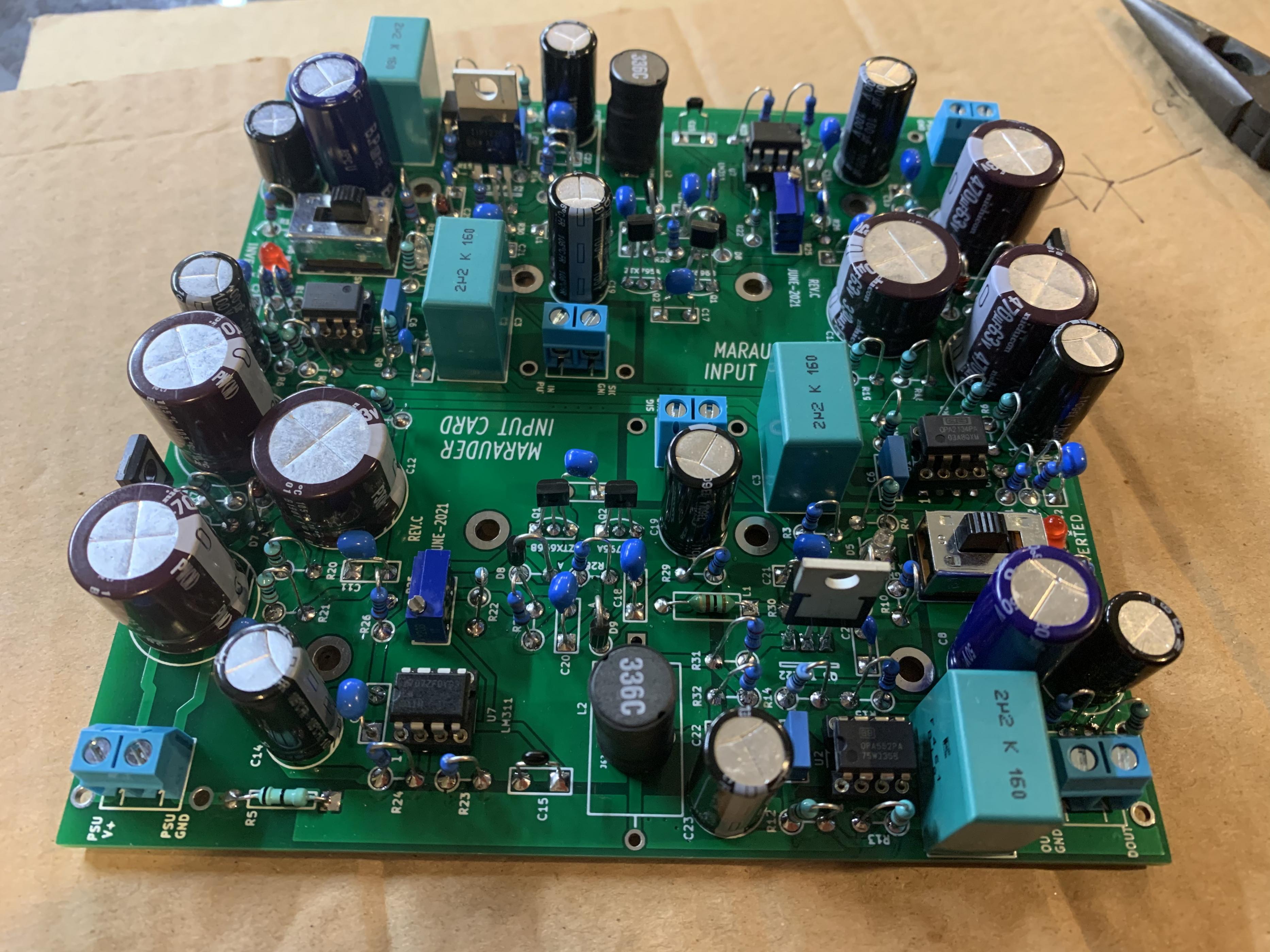

I have been listening to the Marauder FE cards for a couple days already. After some modest capacitor rolling, these have been built very close to the stock kit form. I still prefer Wima polypropylene for the small pF caps (47p & 68p). The 2.2 uF polypropylene caps in the main signal path also seem to be a good synergistic mix with the opamp architecture.
I would describe the sound as fast and detailed. Bass extension and articulation is excellent as well. This is the first opamp based FE that I’ve been able spend more time with. I briefly tried the Tucson FE in my M2x, but quickly replaced it with the Mountain View, which I preferred. TI has done a great job with the opa552. I can recommend the Marauder cards to those who want to hear what a VFET amp sounds like without the Edcor iron in the signal path.
Back to the Marauder cards..
One of the things I like about this design is how readily it sounds really good. Unless one enjoys capacitor rolling and other tweaks (as I do), it just sounds really great after a fairly short run-in period. I have left the gain at its stock setting of 6.1. There is another high voltage opamp that I will try later on, just to hear if there may be a difference.
