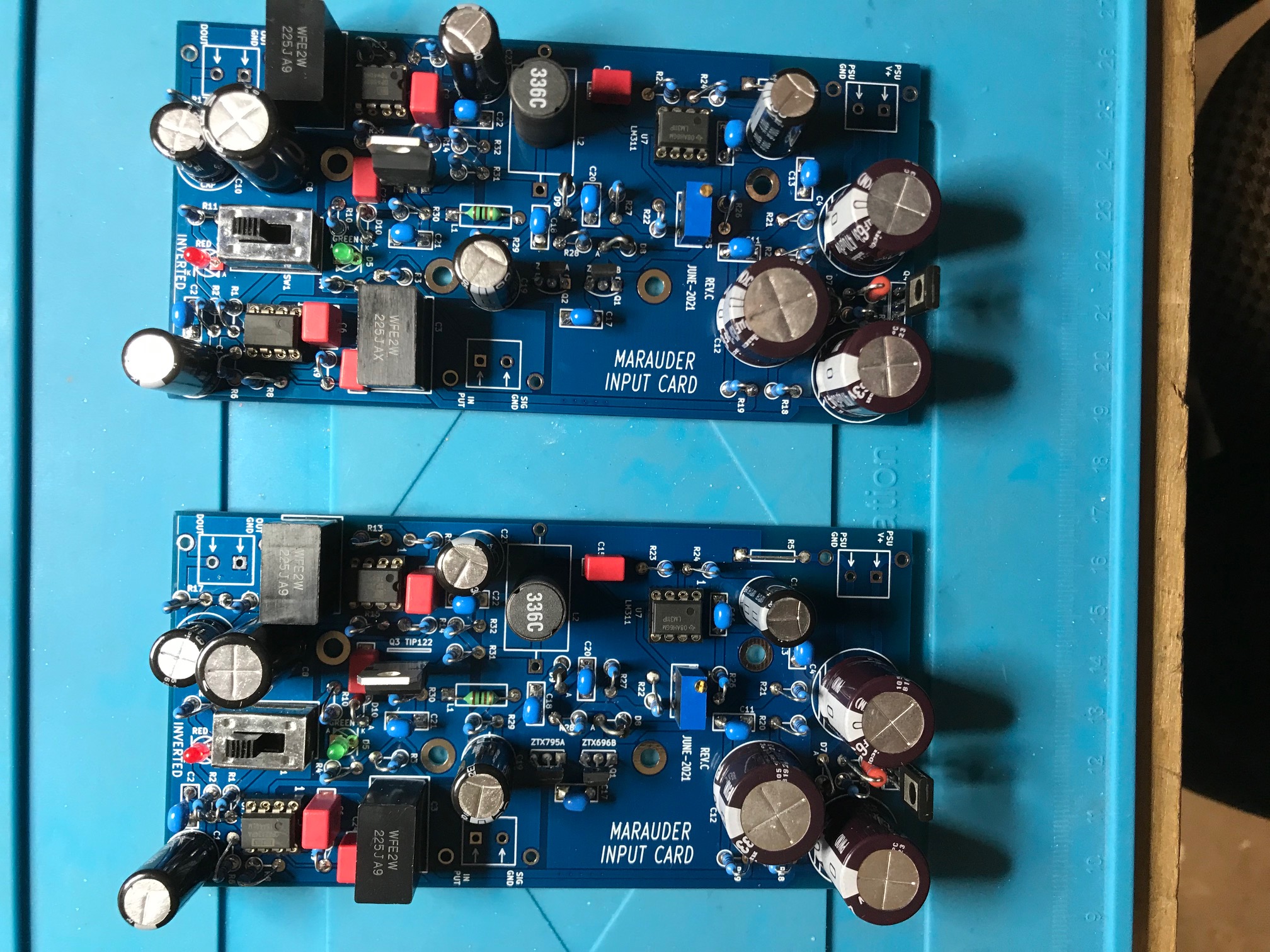

I have built my Marauder boards as well, they dialed in perfectly and look very good on the scope, in isolation. Perfect square waves, with just the tiniest bit of 50kHz barely discernable in the rising flank at high temporal resolution. Bandwidth approx. 2.7 Hz to 1 MHz.
Plan to install them tonight or tomorrow night - really excited to hear them !
I have also used WIMA FKP2 for the pF caps, and so far the black Panasonic for the 2.2 uF film caps. Let's see how the boards sound; maybe trying some 2.2 uF MKC caps instead later on. How critical is the 2.2 uF figure - would, say, 1.5 uF work well as well ?
Regards, Claas

That is a good looking pair of boards.
A value of 1.5 uF should be fine at C3. I would not recommend going any lower.
If you want to reduce the minor 50 kHz PS ripple, try substituting a small 10 uF, 100V electrolytic at C21. That’s how I have mine set up now.
Hi TungstenAudio,
thanks for your reply ! As a follow-on question: did you bypass the non-polar caps C8 and C10 in your build ?
I really like Nichicon's UES (un-bypassed), but they are too large here, resp. not available in the necessary voltage rating, so I used the recommended Nichicon VP / EP, so far un-bypassed.
Regards, Claas
Regards, Claas
Yes, I bypassed both C8 and C10 with Wima 0.47 uF, 63V MKS caps on the underside of the board. For C10 I used Nichicon 47 uF, 35V ES series. This is a sufficient voltage rating for that location. The Boosted voltage rail does not exceed 58V, and the OPA552 will never output more than half of that. For C8 I used the Nichicon 220 uF, 50V EP series that came with the kit.
As a side note, a value of 47 uF is far more than necessary for C10. If you wanted, you could try using one of your 1.5 uF film capacitors at that location. If you prefer to stay with a larger value bi-polar electrolytic, then values as small as 4.7 uF or 10 uF will be quite sufficient, and easier to find in a 50V rating.

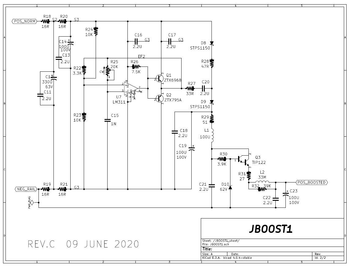

I recommend doing a little bit of pencil and paper exploration first.
Start by analyzing the (R29 - L1 - C21) attenuator. (a) What's the LPF corner frequency of (R29 , C21) only -- assuming L1 isn't even there; assuming L1 is replaced by a short?
(b) What's the LPF corner frequency of (L1 , C21) only -- assuming R29 isn't even there, assuming R29 is replaced by a short?
(c) What do you get when you assume all three components (R29 - L1 - C21) are in place? How many dBs of attenuation do these three components provide, at 50 kHz and the harmonics of 50 kHz? { perhaps use circuit simulation to double check your arithmetic }
(d) What's the LPF corner frequency of (R27 , C19)? { assuming D9 is an ideal diode }
(e) Now repeat actions (a), (b), and (c) for the (R31 - L2 - C23) lowpass filter.
(f) What's the total attenuation at 50 kHz, from Q1 emitter to POS_BOOSTED ?

Yes, I already did part (b). It suggests a significant reduction in Fc and a corresponding reduction of the 50 kHz switching frequency and its odd order harmonics. After that, I let my ears tell me what sounds best. I'm weird that way.

After using my Dreadnought cards as testbeds for understanding and tweaking the JBOOST sub circuit, I finally installed them back into the amp for some extended run-in and listening. The JBOOST tweaks were left with the switching frequency set to 78 kHz, and L1 changed to 220 uH. I also replaced the film output capacitor with an Elna Silmic 100 uF, 50V electrolytic, bypassed with a 0.47uF PET film cap. This combo has worked well on some of my other cards, so I decided to give it a try here as well.
