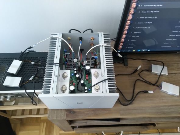

First things first, listening impressions. As you can see we went for a very rough test equipment. Inded, my last try to find a potential weakness, bypassing entirely the FE boards, ended with a failure as I couldn't hear any improvement. Master Papa had done it right again, as ever. And he had already make provision for a SMPS filter, so I had rather cold feet on that possibly last mod. Therefore, I decided to fit everything off board of the amp, so that direct comparisons were easy (just a matter of a few seconds to undo a connection externaly), while also enabling the possibility to add more than 2 of Mark's SMPS filters in an eye wink. I have 12, so not a problem.
That how it looks like - horrible, with very long cables and even a potential ground loops when you consider the way we rerouted the grounds...
Oh, the small gaffer tape is just an extra insulation in case of, of course there is more than that...

All I can say is... WHAOU!
This is by far the best mod I did so far to the VFET. Let's face it, my FE bypass was a failure (no audible difference), the caps bypasses brought some marginal improvement - kind of thing you have to listen to very carefully. The additional PS caps on the contrary brought an immediate plus on many accounts and could be directly assessed. Well, the additional filters are even greater in magnitude! Of course they bring different things than the PS caps, in fact welcome things that are complementary to the additional PS caps.
We could switch from direct, to 1 additional SMPS filter per OS board, to 2 additional SMPS filters per OS board. The good news is the Meanwell started several times without any problem despite the increased capacity. OK, Mark's filters include some R, my long cable saswell, and the coils help somewhat probably, but at the end with 4 filters and additional PS caps we are talking of a total of nearly 8000uF...
"Direct" was our baseline. TBH nothing to complain with, since I fitted the additional PS caps the sound is fascinating. With a total of 2 filters, the sound became... from another planet! With 4 filters, we had something between direct and 2 filters, a bit too soft, loss of dynamic & Co and we clearly found 1 filter per OS board was the golden number.
Gilles and I assessed the gains, and without consulting each other we consolidated them. That wasn't difficult: this tweak has the greatest sonic magnitude change, difficult to miss it, and we converged on all findings and magnitudes of the changes. With a total of 2 filters we found no negative and only positive, despite trying hard:

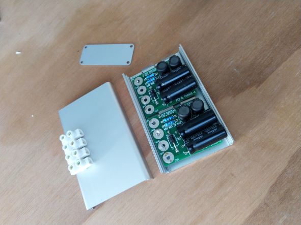

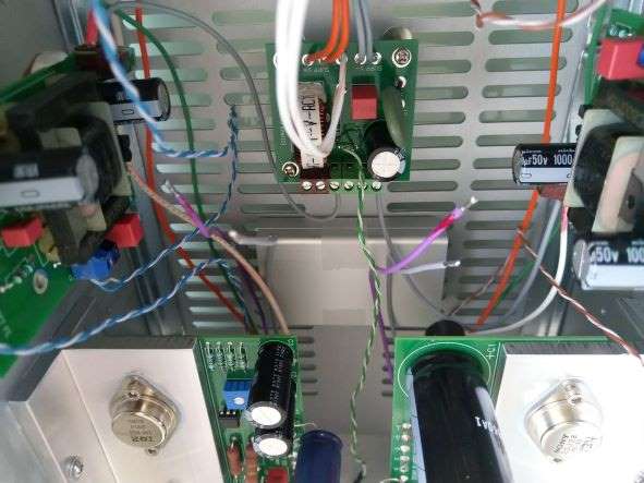

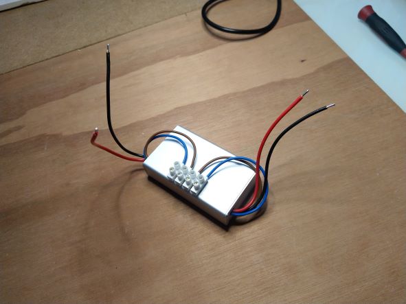

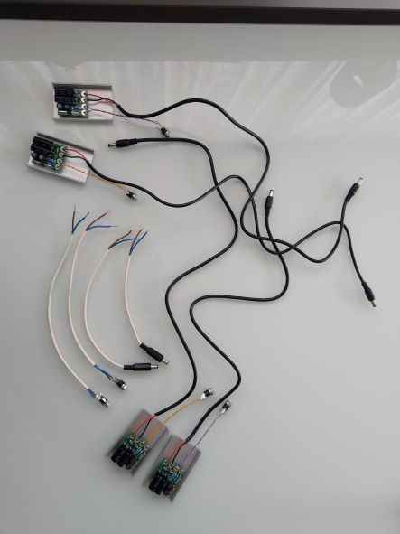

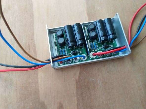

For those who might be interested in trying that tweak, that's how we did it (again, a final pix wouldn't show much, hence step by step hints). First of all, 2 SMPS filters were integrated side by side into a very small metal housing. Connectors were used to exit the existing entry filter in direction of the 2 SMPS filters. Wiring has been reduced to the minimum, but I must confess I couldn't hear a difference between long and short cables or grounds loops running wide.
Each SMPS filter exits then the small housing to lead to another connector. That's the white one we bolted carefully (read Gilles did it LOL) on top of the small casing. That connector feeds then the usual OS PS cables. In fact, you get 1 SMPS filter per OS board, which can possiblyu be a plus for channel separation. These cables enter as usualy the OS boards, in my specific case at the additional PS caps level.
To make it all nice, the additional very small casing fits underneath the OS boards, right after the original entry / filter board. The casing is somewhat elevated to enable air to circulate under it, but TBH it is so small and centered in the plain floor that its impact on air flow must be very low anyway. There are other places and other ways to do it, many many others once you split the filters or stack them etc. We looked deeply into them but found this was the most logical way leading to the fewest "cable salad" with low signal wires not mixing with PS wires etc., something we deemed essentiel.
Mark's SMPS filters that we used cost a tenner or so at the DIYA shop, the chinese casing a few bucks... you will be very surprised by the VFM ratio of this mod, especialy if like me you thought the VFET couln't really improve any further.

Note: discard the tape and empty casing on some pix, these were just intermediate dry fits to show YOU what we did!

You installed the output of the original PSU filter into A SINGLE SMPS filter
=> NO. It looks like a single from the outside because at the end, to save space, we used only one casing... but that very casing encloses 2 FILTERS, see pix.
Each filter feeds one channel. So one filter goes to the regular PS feed of the OS right channel, and another does the same for the OS left channel.
and then into the OS board... repeat for the other side? Or did you "daisy chained" the SMPS filters in series?
=> I didn't daisy chain the filters in series in my final build.
I did so though during my experiments, when we thought one filter per channel is great, what about daisy chaining (always per channel, to keep the 1.7A I described for you in the filter thread)? In that very particular experiment, we ended up using 4 filters, in fact 2 daisy chained per channel. That's what you see on some pix. This experiment didn't turn out to be satisfactory, too much of a good thing, so we reversed to 2 filters in total. SO WE DISCARTED DAISY CHAINING ON THAT BUILD.
As said with more details in the other thread, the key point here is that each filter is passed through with roughly 1.7A, so well within specs.

Now, my PS chain is:
1) External SMPS
2) Original small filter board inside (the one by Papa that feeds the blue LED)... YES, I kept it, refer to the old post
3) Split PS for each channel... what follows is for one channel only, same happens to the other one!
4) Mark's filter
5) Additional PS cap at OS PS entry
6) regular OS (which feeds also positive FE board as ever). Read: these mods also help the FE power feed...
I would really keep it that way, that is filters in that order and additional PS caps last at OS level. That is what makes most sense in my mind, please refer to my post 3 months ago where I explained why this sequence would make the most sense (to me!).
No clue if I am wright, no clue if that can be bettered, but all I can say is: GO FOR IT, it works great as it is and IME once a tweak works that great, your are close if not at the limit of the potential gain around its topic, so probably more worth investigating elsewhere now. Read: quite mature that way IMO, topic PS closed. I bet there isn't much into that PS now and a regulated linear (good) one.
Of course I could be wrong, it is just me after all 🙂
Plus there are obviously some guesswork... BUT the result stands, and that means the sound has increased a lot!

Wow that sounds great. I have the filter boards ready to go. May I ask what cap was used on the FE and where? On the PS input of the FE is my assumption. Sorry if it's here somewhere already.
Yep, it is there already with pix so you can see how to implement them best, saving you some thinking we had LOL.
However, since you asked so nicely and my posts are very exhaustive in all senses 🙂, here we go again in a hopefully clearer format...
Please note this is just what "I did", not necessarly what "must be done" or "what others would do"...
POWER SUPPLY TWEAKS
IMHO MUST DO and both tweaks complement each other very well...
1- PS FILTERS
Addition of two PO89ZB filters, one for each channel, electricaly "between" the existing little filter board (feeding also the LED) and the OS boards.
2- PS CAPS
At the OS PS feed, where the PS cables come in, addition per board of one low ESR Panasonic FC 1500uF/50V cap
Easily done on top of the boards.
BYPASS CAPS IN THE SIGNAL PATH
This is really fine tuning and not a must do, but always good to have...
3) On the OS boards
Bypass the huge 10 000uF output cap with a Nichicon KZ 220uF/50V
Easily done under the board
4) On the original FE boards
Bypass the original 1000uF cap (C2) with a Panasonic ECW 1uF PP cap
I fitted them under the board and used taller stand offs
I ranked all these tweaks more or less in what is likely to be your perceived order of importance regarding sonic impact.
I hope this helps
Claude
