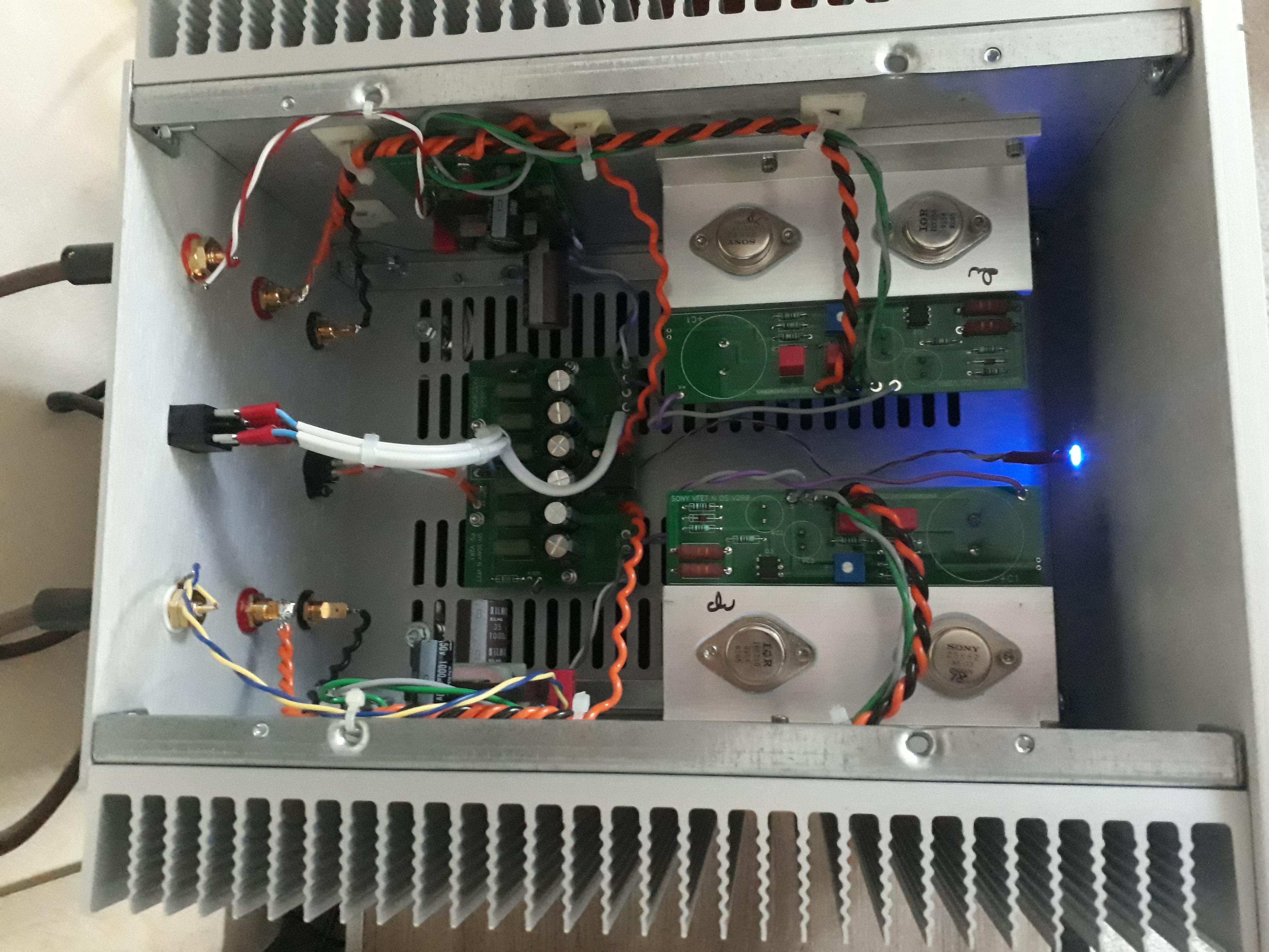

I wouldn't expect a big device such as the THF-51 or the 2SK182ES to be installed on a separate bracket. They are probably best bolted directly onto the main heatsinks.
The 2SK180 devices could use separate heatsinks, but I don't expect the store to supply these. Builders will probably want to gain access to a bench top drill press.

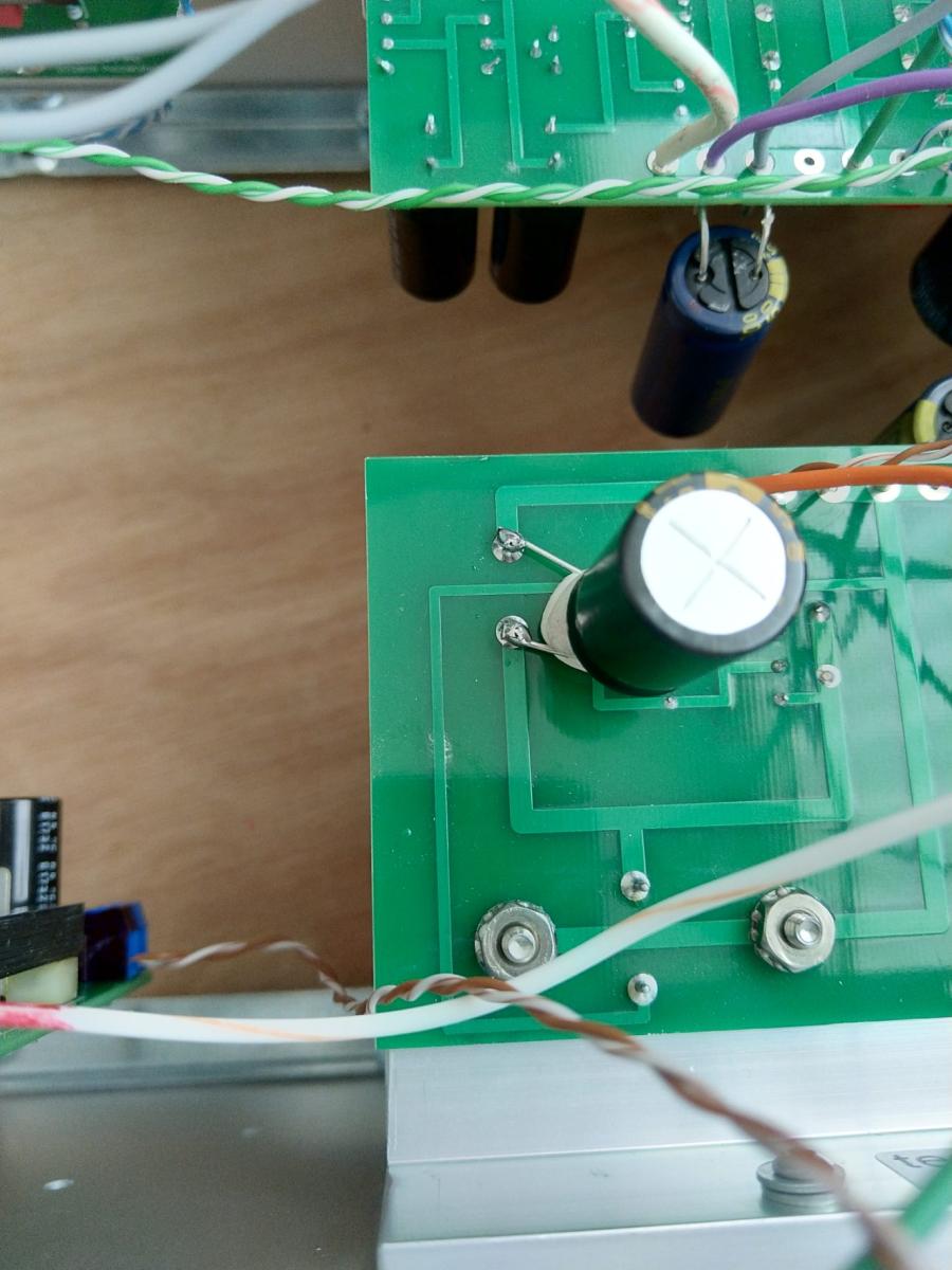

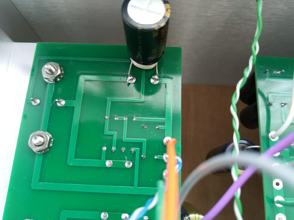

Forelast mod ongoing: additional bypass of the 10 000uF output caps with 220uF quality caps (see past posts).
Yes, the caps are positioned in an odd way, that is on purpose. I may need space under the boards if the last mod (additional SMPS filter) turns out to be benefical, hence the position of these bypass caps.
As for the sonic impact, we will have to wait for next week. It appears that the sound changed over the inital hours, so we better wait until it is settled. The caps do need some burn-in.
As it is not easy to evaluate the changes of this particular mod (long time period due to burn-in, hence not an easy quick before/after comparo this time), it is Gilles who will assess them. Gilles is using the amp since a few months now and all the mods we carried out where performed at his. He knows the amp by heart and has the benefit of comparing it (quick amp switch, all is ready for that) each time to his very own amp that I built with him. The latter is a stable amp reference re sound over time (no more tweaks on this one), enabling the evaluation of the mod regardless the elapsed time. Of course I will give it a listen aswell but then I will rely on auditive memory with far more limitations...
Stay tuned for the verdict

The caps are Nichicon KZ 220uF/50V...

I had bypassed the Rubycon output capacitors on my VFET (N version) with 1000 uF / 50 V Nichicon KZ.
I quite like the change, but in my case it needed almost a week to settle in ... 😛

Yep, that's why I won't comment before a week.
TBH, I even thought about burning them in, but I quickly realised that to do it properly I would need a, ahem... power amp! That's due to their (unusual location at the output, they do see quite some voltage and amperes...)
Anyway, let's see how that 10000 + 220 + 0.33 combo sounds... baring in mind I don't expect a huge change though, whatever the positive or negative.

I guess cap bypass is a widely debated topic. Some say it makes no audible difference (or can't make any), some claim it does, some say (with correct tech background to back it off) you get extra resonance... but omit the word CAN.
What follows is very personal, based on my own experience (bypassing since a few decades):
1) There is no straight rule re bypass, as long as you don't get a silly resonance, take / do...what suits you/your ears best!
2) Caps have evolved, what was true 30y ago isn't necessarly anymore, as I recently found out. ESR on lytics can be very different from what it used to be in the 80s or 90s
3) I tend to apply personnaly a kind of rule of the thumb. As all guessworks, it is based on experience and some tech considerations re resonnance etc.
That rule starts with (for caps in amp's signal path, "digital" is another matter (!), amp's PS aswell nowadays, and what follows applies mostly for lytics) to bypass big caps with another one that is around 500 times smaller. That is what worked best FOR ME. However, ther can be other considerations, as here, so that I may alter the corresponding value range. But I would (HERE) not chose bigger than say 40x smaller and not smaller than 2000x smaller. It can get more complicated when different cap tech are involved, but let's not dig into that.
This value range should with quality caps avoid resonnances / response in most cases, things that can be measured on a scope that are, depending on lytic caps of course, rather of the mentioned magnitude.
Long story short: to help damping, I wouldn't HERE bypass the 10000uF lytic with a 2200uF one. I would either replace the 10000uF with a quality one (if it isn't already), or (some might even say AND, but I found OR worked nearly aswell) bypass it with anything quality between 220uF and 5uF.
