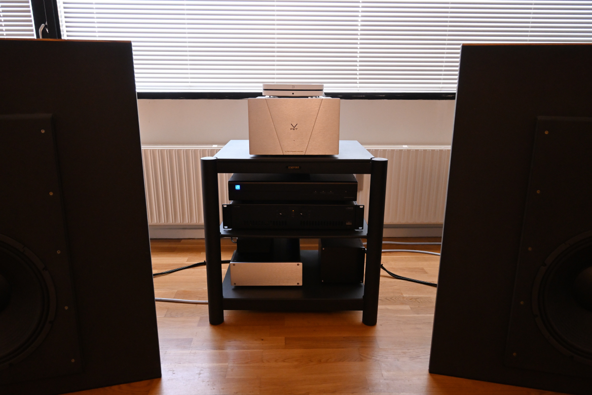

VFET no. 33 up and running again with new KE-33 and so far no "flicker noise".
I adjusted voltage to 36 VDC on VFET amp board.
It is very quiet.
Less "harsh" than ACA and more 3D I would say.
S-sounds on voice less pronounced.
I have never heard "pops" from heat expansion.
Chassis with white alu-front at the bottom shelf is PSU for VFET.
I organized wires so 230 VAC wires a away from signal and speaker wires.
I have no hum etc. with ear close to speakes.
The VFET setup is more silent than with ACA but both very silent.

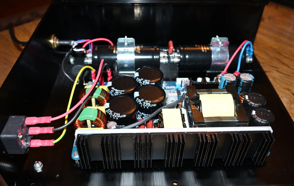

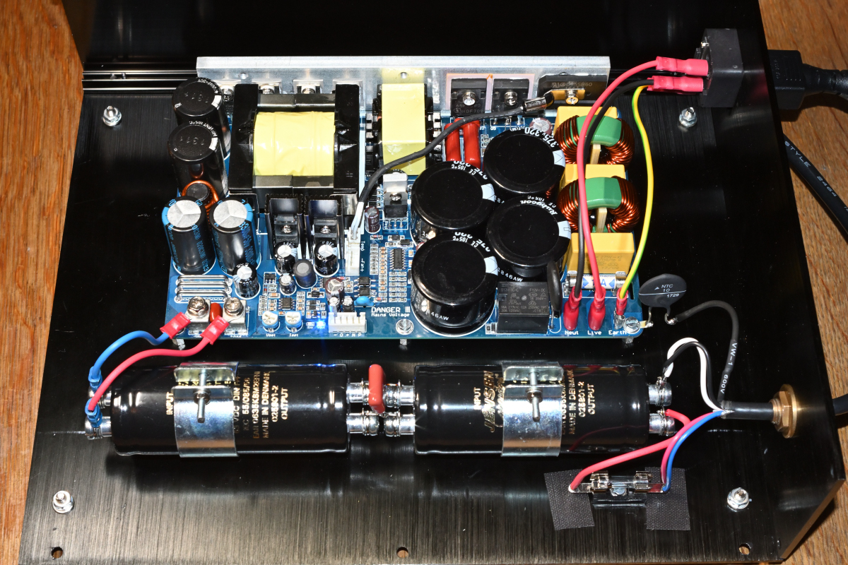

PSU is based on a Connex 2kW SMPS (audio-grade) which has nice specs. Low noise etc.
PDF attached. Depending on configuration the module can look different. In my case it is a single 36 VDC PSU. It had to be pre-ordered from factory. I then added filter caps at the output and an output fuse. The chassis is just one I found on ebay. The onboard primary fuse is 15A (230 VAC) so I put a 1A T fuse at the IEC inlet to protect a bit. Output fuse is a 4A F fuse.
The filter caps I used was some I had (4-pole Jensen). 2 x 8200 uF / 63V as I remember. No problem at all starting up with this cap load.
I think it would work fine without caps (as indicated in spec) but I measure a bit lower noise after caps than at direct SMPS output. I think it was 9 mV at direct SMPS output and 6 mV after caps. It is just with a DMM (not a scope). Now with closed chassis etc. it might be less.
I just cut the wire from SMPS brick so I saved time playing with these connectors as there are really many parts and wires. It is a screened cable (double screened). It has some alu-foil inside and a normal "mesh" screen.
VFET is a very light load for the SMPS so I just glued some small heatsinks to it. Normally it should be attached to a large heatsink. Heatsink gets around 55 C or so. Some components inside are around 65 C.

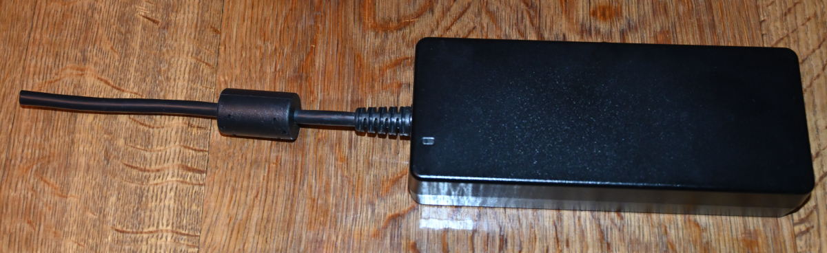

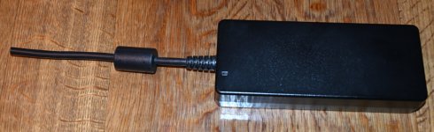

Thanks for that!
It is good to have other options for power supplies. My experience indicates that the right amount of external bulk capacitance is beneficial to both SMPS and capacitance multiplier PSU. The Jensen 4-pole caps that you used look good for this application. I wanted to keep the kit SMPS intact for testing purposes, so I built a new cable for my external PSU. There are certainly a lot of parts to that external cable connector, and nimble fingers are needed to keep them all in place.
Edited to add:
I didn't use any shielding for my umbilical. I just twisted two channels worth of 18ga stranded wire together (dual-mono PSU). No issues with noise either.
I would also just have made a cable without screen if I should make my own.
Screen is also connected to V- if my memory is correct so I connected screen to chassis / PE via a NTC in PSU unit.
I just raised the IEC inlet fuse to 2A T as the 1A T broke 10 min. ago during power on. Prototypes needs some final "adjusting". SMPS has softstart but seems not "soft enough" for the 1A T fuse. Probably 1.5 A T could have done it.

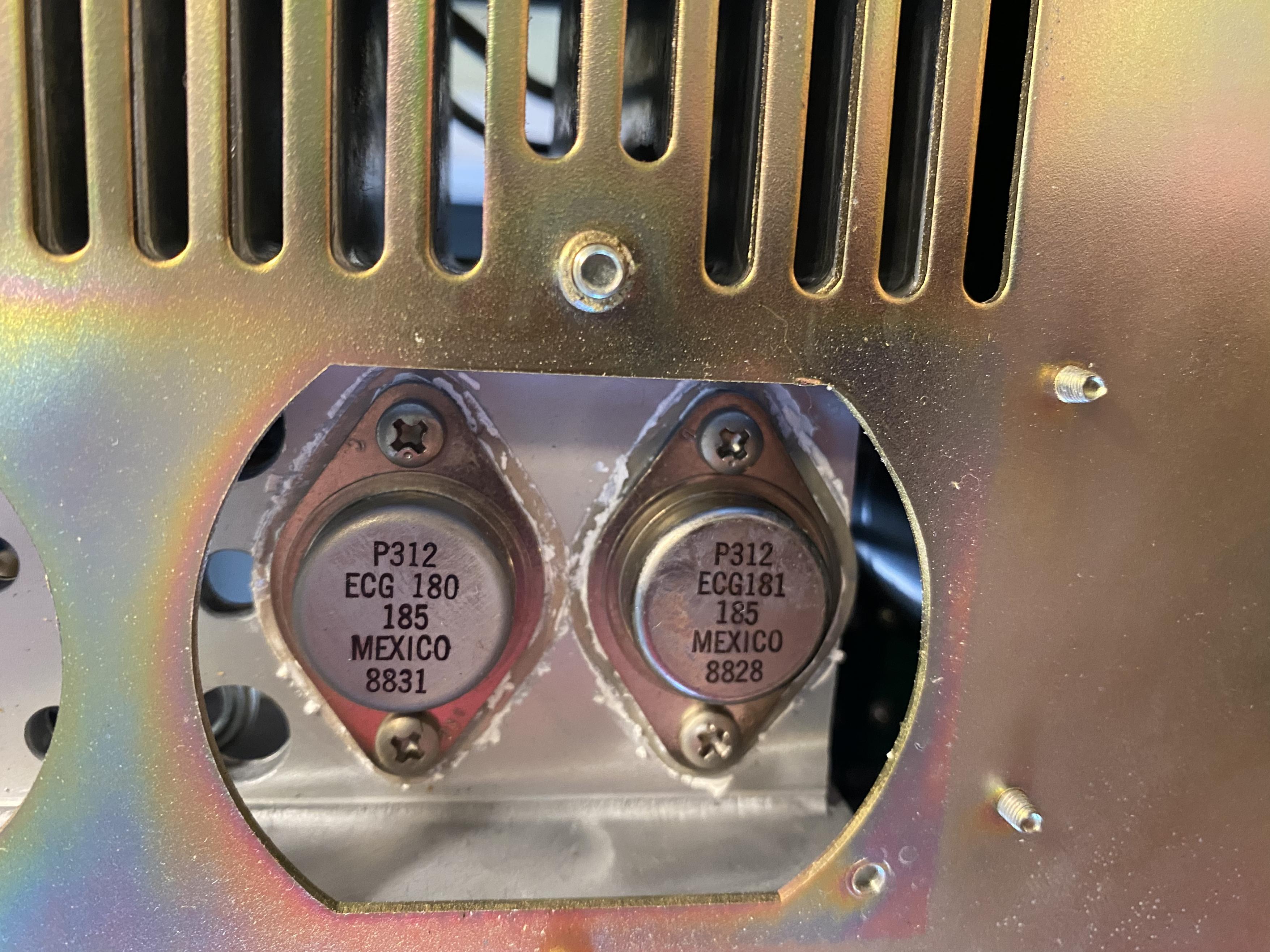

OMG I’m not gonna lie I got a little teary when I saw your post.
Thank you so much for thinking of me. Today has been a horrible day with the retailer that I’m dealing with. He pretty much told me no get lost.
This is the exchange today between he and me.
(Me)Good morning Ron,
I’m sorry to hear that we won’t meet today when I show up to the store and bring the amplifier in.
I think the right thing for me is a refund and we can partner ways on this particular amplifier. Here’s why.
1. I asked about this amplifier before I purchased it, if it was original and it’s condition. You replied back in an email stating that it was unaltered and in working condition. That is not the case. You also allude as it was also unmodified which led me to think that you were very well informed about this amp.
2. The amplifier does not function properly after start-up. There's no output for a bit and I’m not talking about the speaker relay delay, maybe the relay is bad. You can hear the click of the relay and there is still no sound for a bit.
3. The speaker selector switch is inoperative and only works on one position.
4. With source audio there is some kind of motorboating popping sound coming from the left channel. It leads me to think that there are some kind of capacitor problems, mostly in the Preamp section.
5. And the main problem of them all is that it is not original. I took off the bottom plate (the two small screws) of the amp to look at the V-Fets. Only to see that someone had replaced them with a non sony v-fet chip. This is the whole reason I purchased your Sony Ta-4650. These chips are unobtainable and therefore it will not be able to be repaired. This is why I'm requesting a full refund.
(Store)You voided your guarantee by removing the cover. You were told not to do that. All you had to do was ask to see it and we would have done that for you.
(Store)I was surprised to see that you had dropped this off an hour and 20 minutes after I told you that you had voided your guarantee by removing the cover. I am not going to touch this unit. You have 30 days to come pick it up.
********* i’m crafting an email right now to send to him. It was right at 52 minute drive for me to get to his location and drop it off one way He never said not to bring it it’s almost like he knows that this was a fraudulent sale I’m just trying anyway and every way to get out of it. Prior to purchase I asked him if it was altered or upgraded anyway and he says it’s not been altered or upgraded and he’s telling me I can’t remove a cover and take a look to see if he’s being honest*******>
Wow, what a crook. At least give him a Yelp bomb.
And those subs are BIPOLAR output transistors, not V-FETs.
