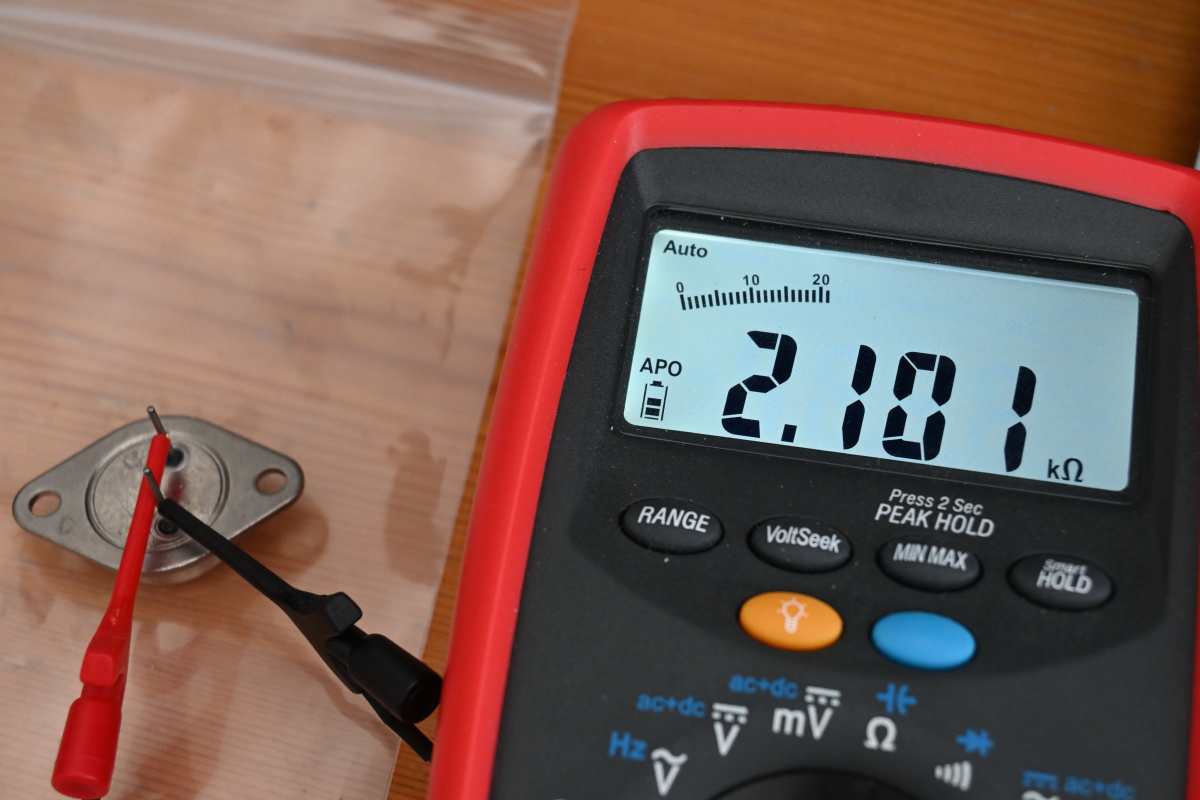

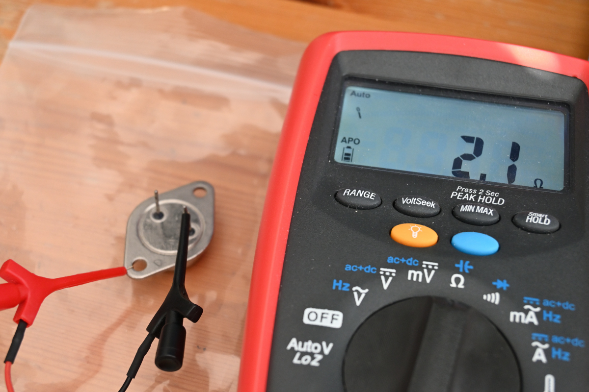

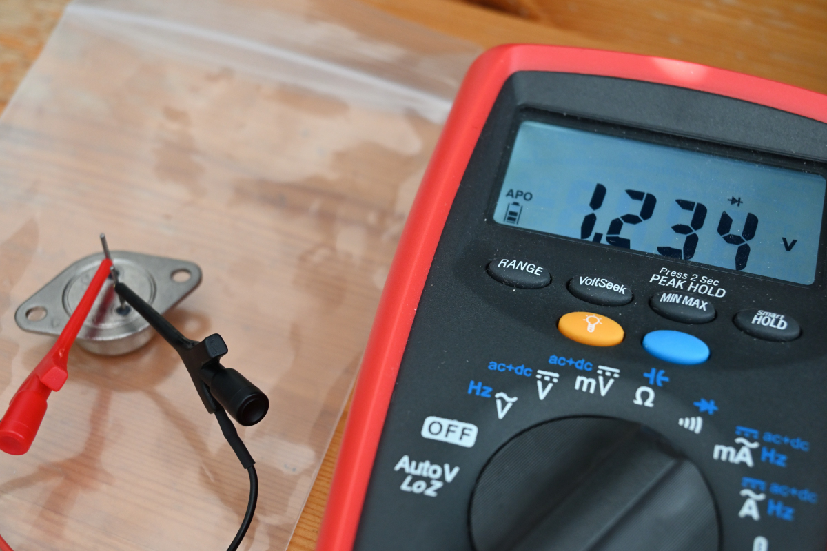

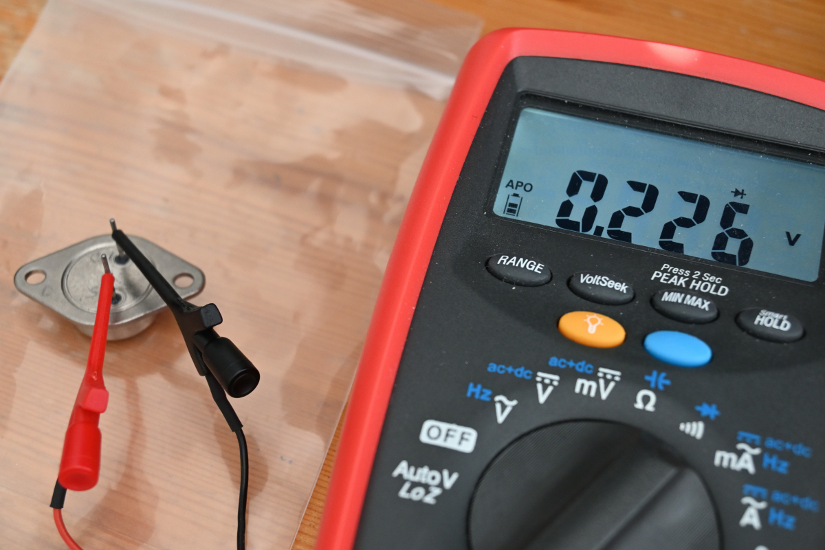

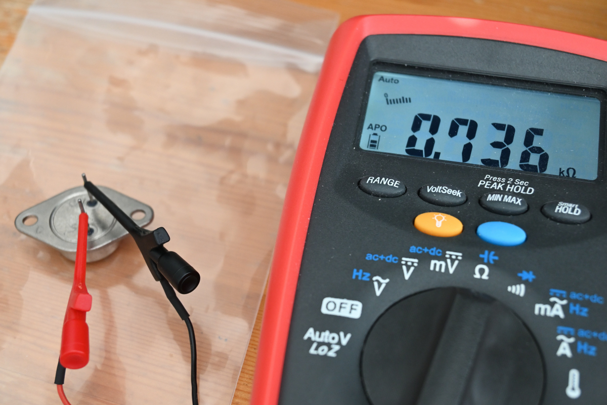

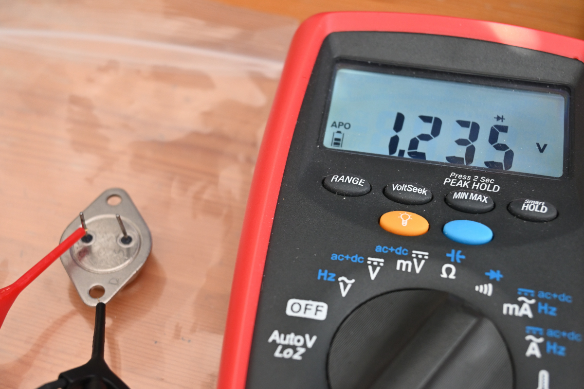

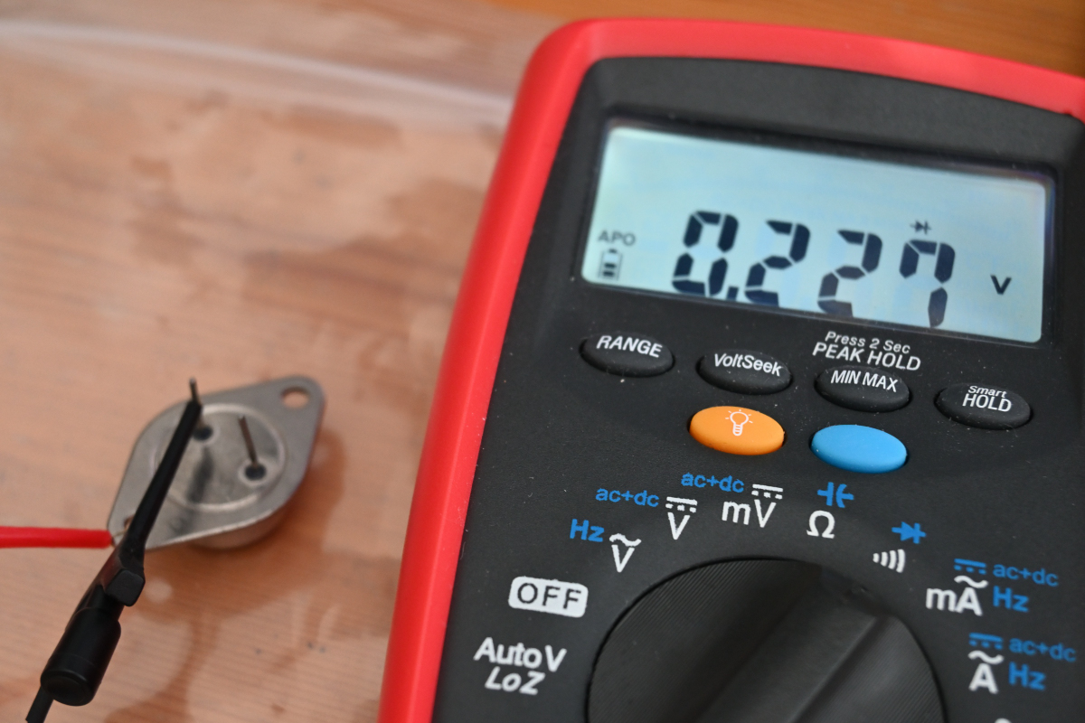

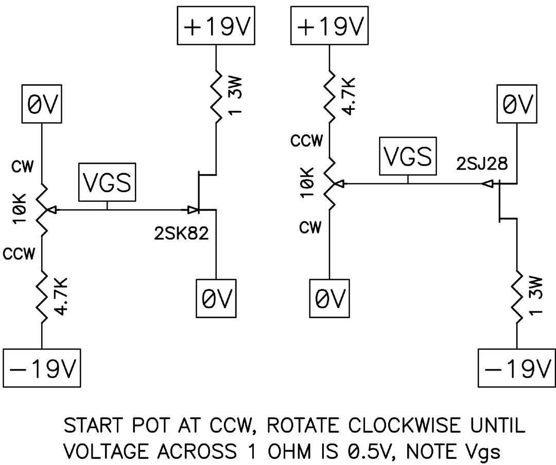

I have now found 3 x 2SJ28 VFETs. A KF-33 (which I will try using to replace the one that has "flicker noise"). A KE-33 and a JA-33.
Both KF-33 and KE-33 validates as a JFET when I test it using a PEAK DCA75 tester but JA-33 shows up as "shorted".
Using another tester the two working JFETs shows up as two diodes while the JA-33 shows up as two resistors.

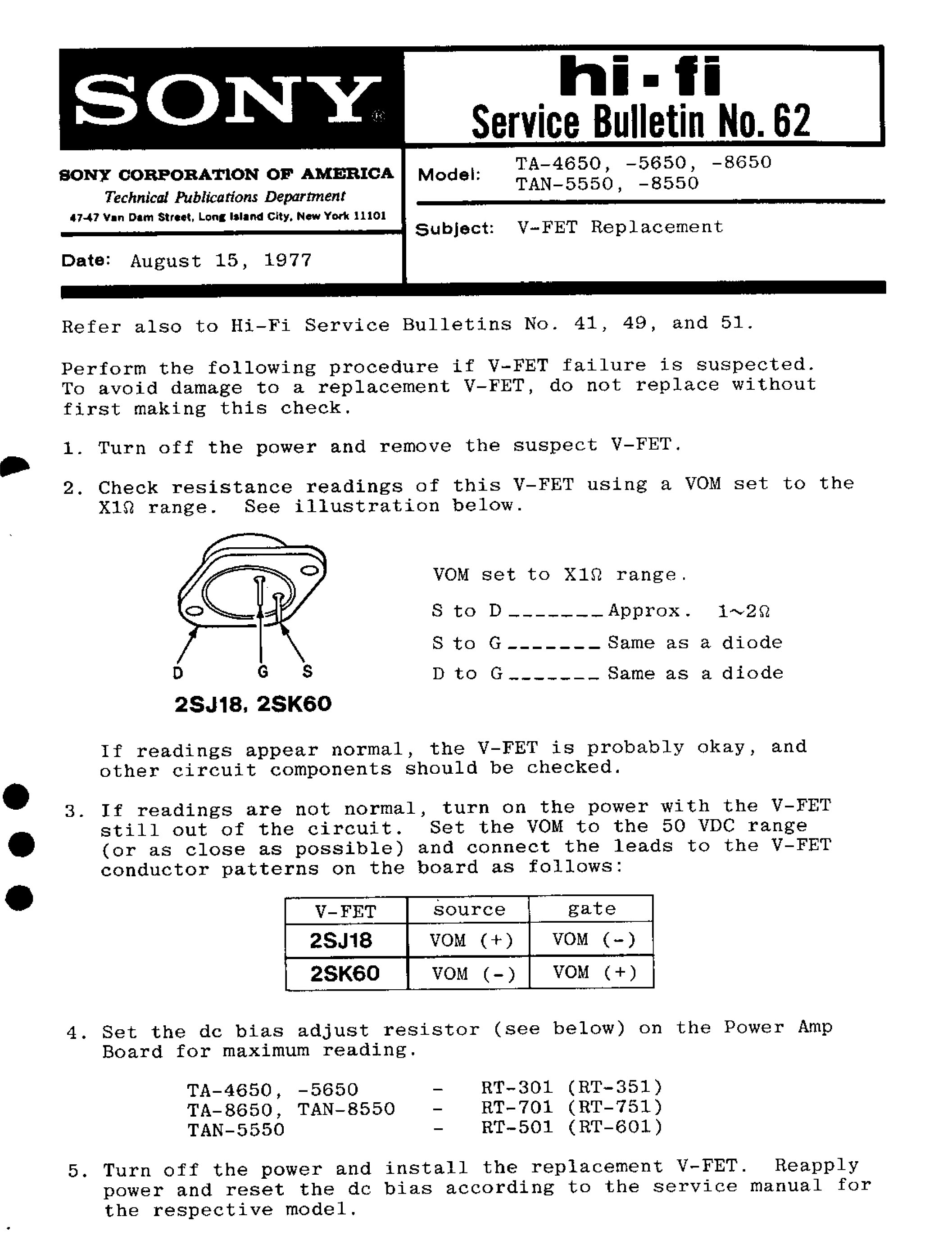

I made a few more measurements on JA-33 using DMM using method written by Sony (attached).
Also my measurements are attached where filename indicates which measurement. Ohm measurements and diode measurement in both directions.
The measurements shows diode function in both directions for e.g. the G-S junction. Should a G-S junction on a JA-33 beak down if more than 2V is applied in "reverse direction"?
Or would you also judge this JA-33 as not working based on the measurements?

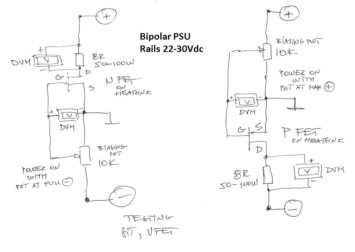

This will require that I find a large heat sink for TO-3?
How would such a "test-schematic" look like for a P-channel?
Is there a significant electrical difference between KF, KE and JA-33 so a simple tester could be "fouled"?
I have tried to find out what the exact electrical difference is between the XX-33 versions but I have not succeeded to find a datasheet that specifies this.
Testing depletion parts
its already told that these are rankings simply by biasing voltage
Thank you!
I can see I only miss the TO-3 heatsink.
I probably don't need the isolator when testing as "standalone". Then heatsink will be Drain.
When adjusting 10k pot the voltage over 8R can be controlled "nicely" if VFET works.

Happened also to me a 2SJ28(KF) in shorted with the PEAK DCA75. With the circuit shown by ZM it was good.

Official schematic made by Mr. Pass

Give them nice 15 minutes of warm up time on the large heatsink.. then mesure Vgs 🙂
Edit : If possible use thermal TO-3 pads or mica with goop, transistor heat transfer condition are the same like in the real amplifier
I have some mica TO-3 isolators and also the white "grease".
