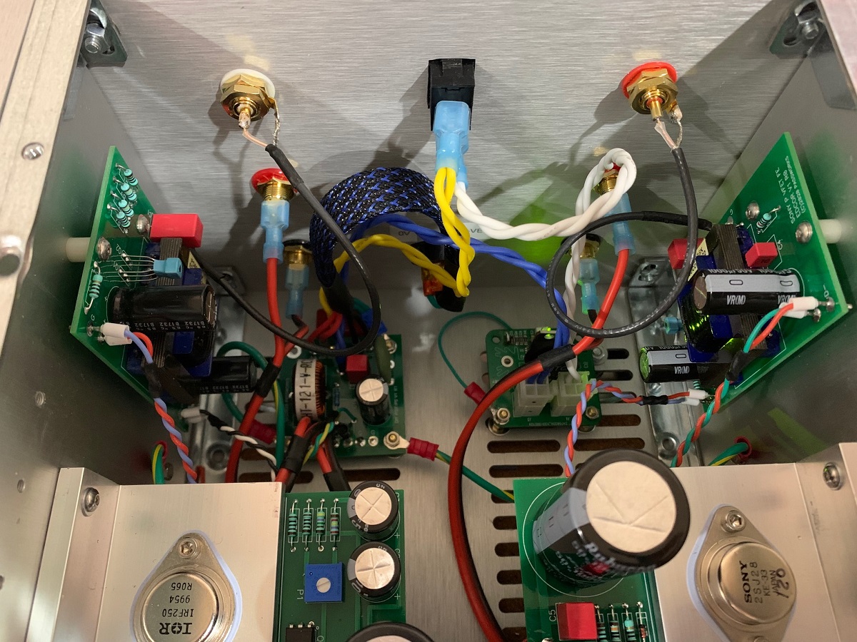

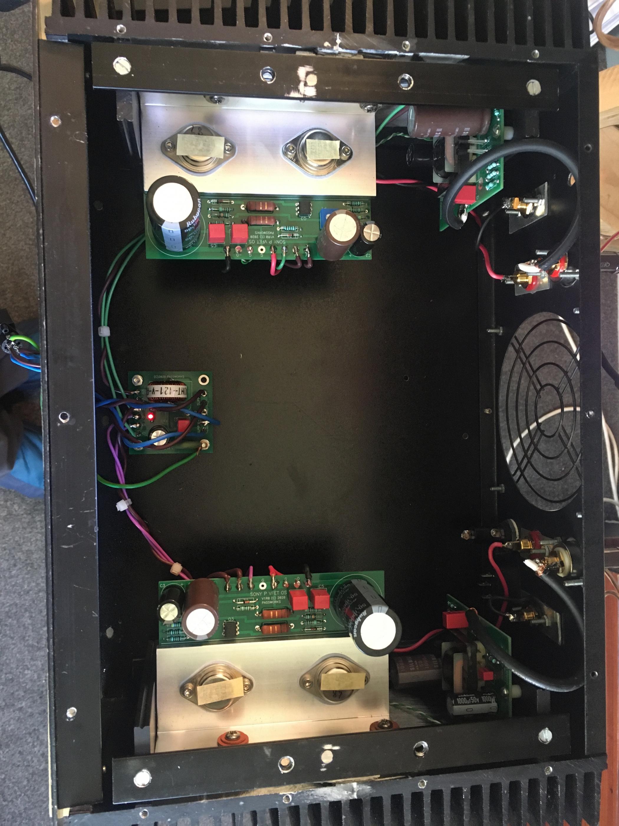

I would recommend placing the new filter board toward the rear of the amp so it doesn’t interfere with airflow and cooling of the output stage.

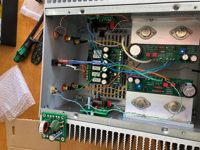

New filter board
I mounted the new filter board as far back as I could -- Thanks for the reminder --- Install was pretty straightforward. Only one (ground) wire from the right front end board was a tad short -- but still worked ok. I'll live with the way it is vice having to pull the FE board, unsolder the ground lead, and then make the new GND wire about 2" longer -- just for appearance sake...
Amp is up and running and cooking in. So far, WOW!!
...Runs cooler, sounds better and scary quiet --- no thump ever!!
More later after the amp runs a while and I listen a bit more.

Test install: Theseus-PSFilter Board for Sony P-Channel VFET Amp, continued
I wanted to finish my thoughts on this filter board install and test.
First, a little background on me: I retired from the Research and Engineering department of a US Government facility in Eastern North Carolina 11years ago. That facility performs repair, rework, and maintenance engineering on Navy and Marine Corps aircraft. In my last job before retirement, I was director of a group of Requirements Engineers who developed new software and enhanced existing Operational software used for Time and Attendance, Supply Support, Logistics, and Just In Time manufacturing.
In my early career, I was a Navigation Electronics Technician for 7 years aboard a missile-carrying nuclear powered submarine (radar, Countermeasures, Navigation systems). After that, I taught electronics at Advanced Submarine School in New London, CT. Then came computer field service at a flight test facility in New York and then work in Pensacola FL with automated testing of avionics systems used aboard Navy aircraft and helicopters. So I am far from an Audio Engineering expert and I sure don't consider myself an audiophile either. But I sure enjoy having a system that can faithfully reproduce recorded music!!
So on that note, here are my observations on this filter board swap out:
1. Easy Peasy install -- provided one does not want to change up all of the wiring (folks may want to revisit post 300, 309, and 312 of this thread for a discussion about the pros and cons of using tinned leads, un-tinned stranded wire and ferrules when using the type of screw terminal used o this board)
2. I got a real scare when I first powered up the amp with the new board installed. I had very few operational notes so I was not sure exactly what to expect from the de-thump circuitry. On power up, I got the treacherous blinking blue front panel LED. It continued to blink for at least 45 seconds while I worried that something was terribly wrong. But once the totally discharged capacitors charged up, the light turned steady and I went on to adjust the biases to 20 volts (the voltage read about 17 volts per side when I started with the new board -- but I did not check the bias voltage while the old board was installed so -- not sure if the new filter board caused the change or if the voltage was low beforehand) BTW, the DC voltage at the output of the filter board is 34.1 volts... Naturally, I forgot to check it before the board swap out. Also, the amp seems to be running cooler (around 125 degrees F vs: 138 Degrees F before the swap)
3. Bundling the wiring -- I opted to leave the leads from the filter board unbundled -- not knowing if bundling would cause any crosstalk -- so I left them au natural and spread out.
4. Thumps -- none. Though the thumps had been annoying, I was able to live with them. But now the only noise I hear from the amp is the audible mechanical click of the power on switch -- otherwise perfectly noise free...a nice plus
5. Sound quality...Remember, I'm a pragmatist, not an expert in sound -- but to my ears there was a very noticeable improvement in the sound out of this amp with the new board installed. In my opinion, that is the reason to do this swap out -- and you get rid of any thump as a bonus. I am feeding the Vfet amp with an ACP+ headphone/line preamp. I am feeding the ACP+ with an audio signal from either my iPad, my iPhone, or the Zone 2 preamp out from my home theatre amp (Thanks Tungsten Audio for the verbal kick in the tail to find a better way than using a speaker-to-line-out converter). The home theatre amp is fed optically from the bluRay/CD player, optically from my Apple TV box, via Airplay, or Pandora via internet from the Home Theatre player. So I do have a good variety of decent audio input sources.
6. I started out listening to some Jazz via Pandora (Dave Brubeck) as well as some classical via the BluRay player. With either source, the music reproduction was unbelievably exceptional. Keep in mind, I am playing this setup through a set of mediocre-at-best POLK 2-way 20-year-old speakers. The music out of this amp with this new filter board is well balanced, with attention-grabbing clarity of the highs (percussion, tenor sax, vocals), good strong mid range, and exceptional bass, especially considering the lackluster speakers. It may be me, but I really feel that the Vfet amp went from Great to Un-F****ing believable sound quality with the swap out of this board... forgive me for repeating myself as I say again that I'm not an Audiophile, just like to listen to good music well reproduced.
7. Keep in mind that your milage may vary and my 72-year-old ears may not be as critical as most of yours on the forum.

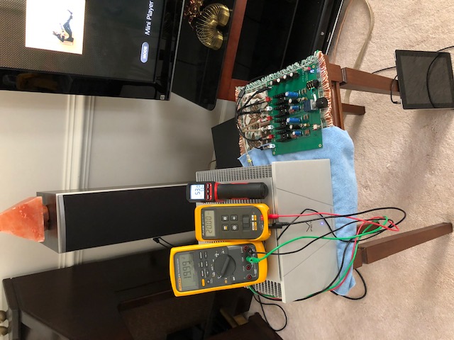

Got my amp up and running. Sweet, Im pretty happy with it. Set it up to +20VDC and ran it for 15 mins or so. The LH side VFET is getting about 5 deg C warmer than the RH side one, as its more tucked behind an internal heatsink fin I suspect.
Still, the VFETs arent getting any hotter than 42 deg C and 38(ish) deg C respectively for the LH and RH sides. Im measuring with a laser thermometer.
Sounds great. I was even able to install Super Through speaker caps (after this pic was taken) and the SMPS still ran fine. I'd just like to roll the input cap now.

Sad you didn't measure / adjust bias before.
Whereas the PS voltage is unlikely to have changed in a significant way by this filter, the voltage bias does a lot to the sound. Reading your findings (temperature, sound signature etc.), some of it is likely to be due to the 17V vs 20V voltage bias. EDIT: I said likely, not affirming anything of course.
Not saying the filter isn't good or else, just raising this point and again thanks for all this
