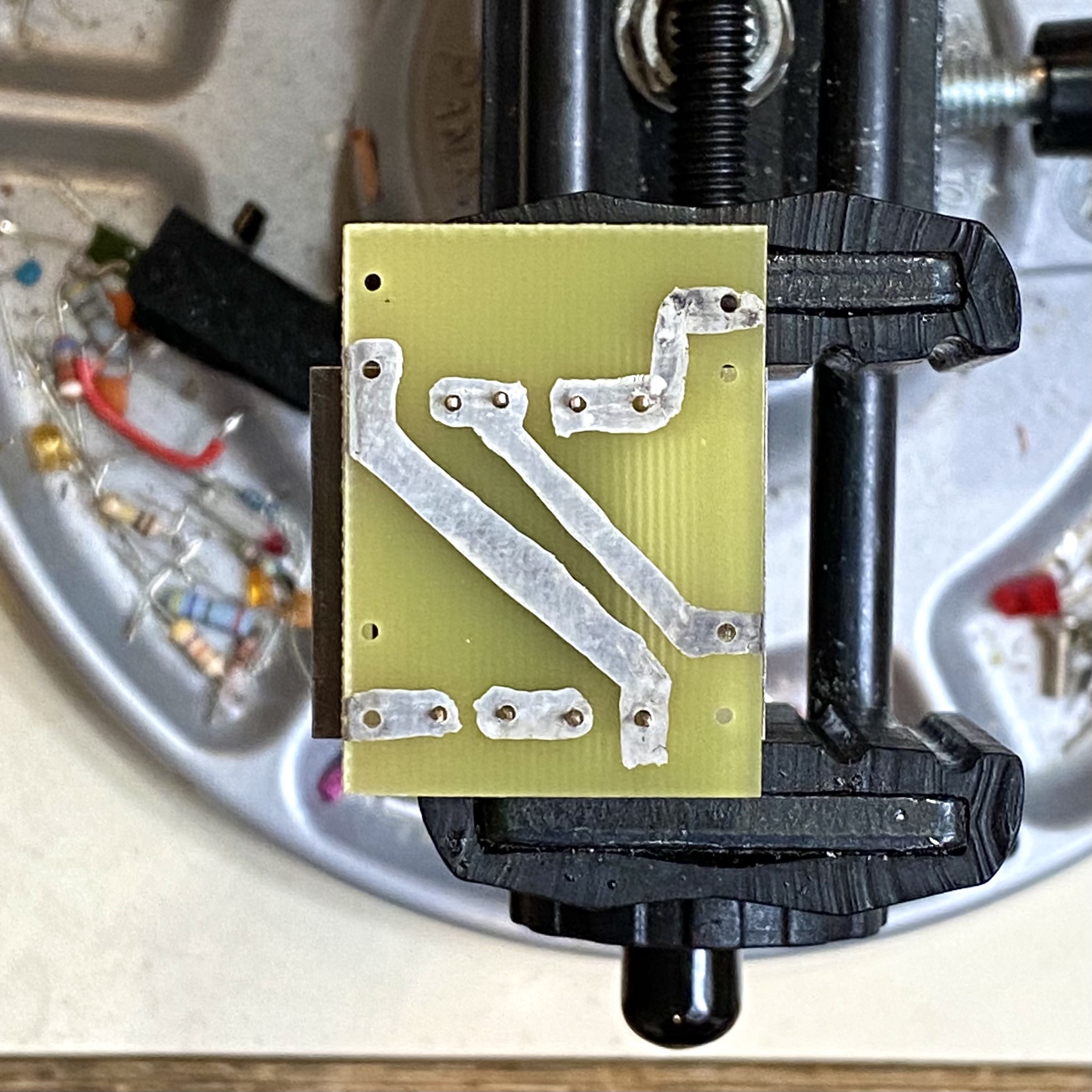

Bulwark mezzanine
This is very much still work in progress..
My plan is to connect two primary coils of the Jensen 123-FLPCH in parallel and two secondary coils in series to get a 1:2 amplification factor. The remaining gain will come from the Bulwark circuit with appropriate values for the feedback resistors. I will be looking for an overall gain of about 17 dB.
This is obviously some pretty old school hand drawn artwork. The traces are much wider than necessary to allow for the imprecise nature of etching the copper in a Ferric Chloride solution. The boards were soaked in a Liquid Tin treatment to prevent oxidation.

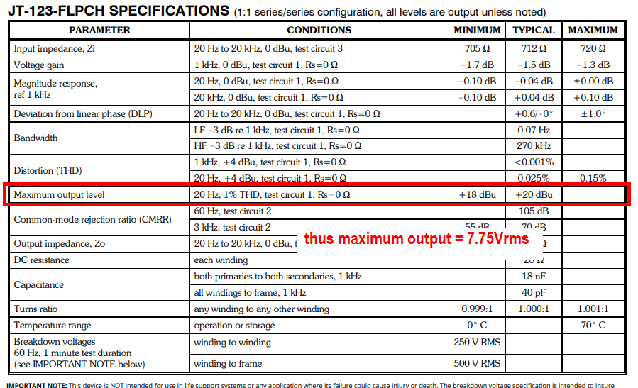

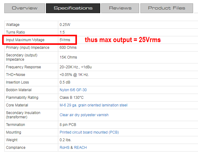

I wonder whether the Jensen (image 1 below) will survive and function correctly, if you operate it outside of its Maximum specifications (??) The VFET output stage modules begin to clip when the Front End board provides a signal level around 15Vrms. So the Edcor transformer (image 2) is well within its max spec.
_
The Jensen transformer may well be operating at a higher output level than its nominal specifications. I suspect they are rated fairly conservatively. The ears will be needed to determine if this sounds Ok or not.

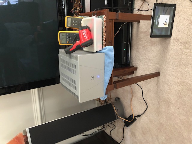

Life with my Sony Vfet P chanel #059
I know I have been dragging my feet, but I finally moved my amp into the house and hooked it up to my inexpensive Polk RTi-8 2-way speakers. I had to use a 2 tube headphone amp that I built a few years ago from a kit from Oatley Electronics in Australia. IT WORKS and sounds awfully good to my 72 year old old ears. I can now let it cook for a while and get the bias voltage adjusted precisely to 20 volts.
I am really surprised at the ability of this amp to drive my inefficient speakers and fill my cathedral-ceilinged living room with all the volume I could ever want.
Now I have to complete the ACP+ preamp that I started last month -- I also have ordered the parts for a pair of Elsinores -- Can't wait!!
Thanks Nelson for all that you do for us members. What a great amp!!
