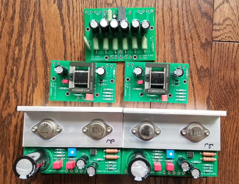

Well, since the new VFET pt 2 filter board is not available separately, I recommend simply adding the extra capacitance onto the VFET pt 1 OS boards. The caps can be 1000 uF or 1500 uF, 50V. Connect them between V+ and G.
Try it. That will get you the main benefit of the new filter board, and more easily.
