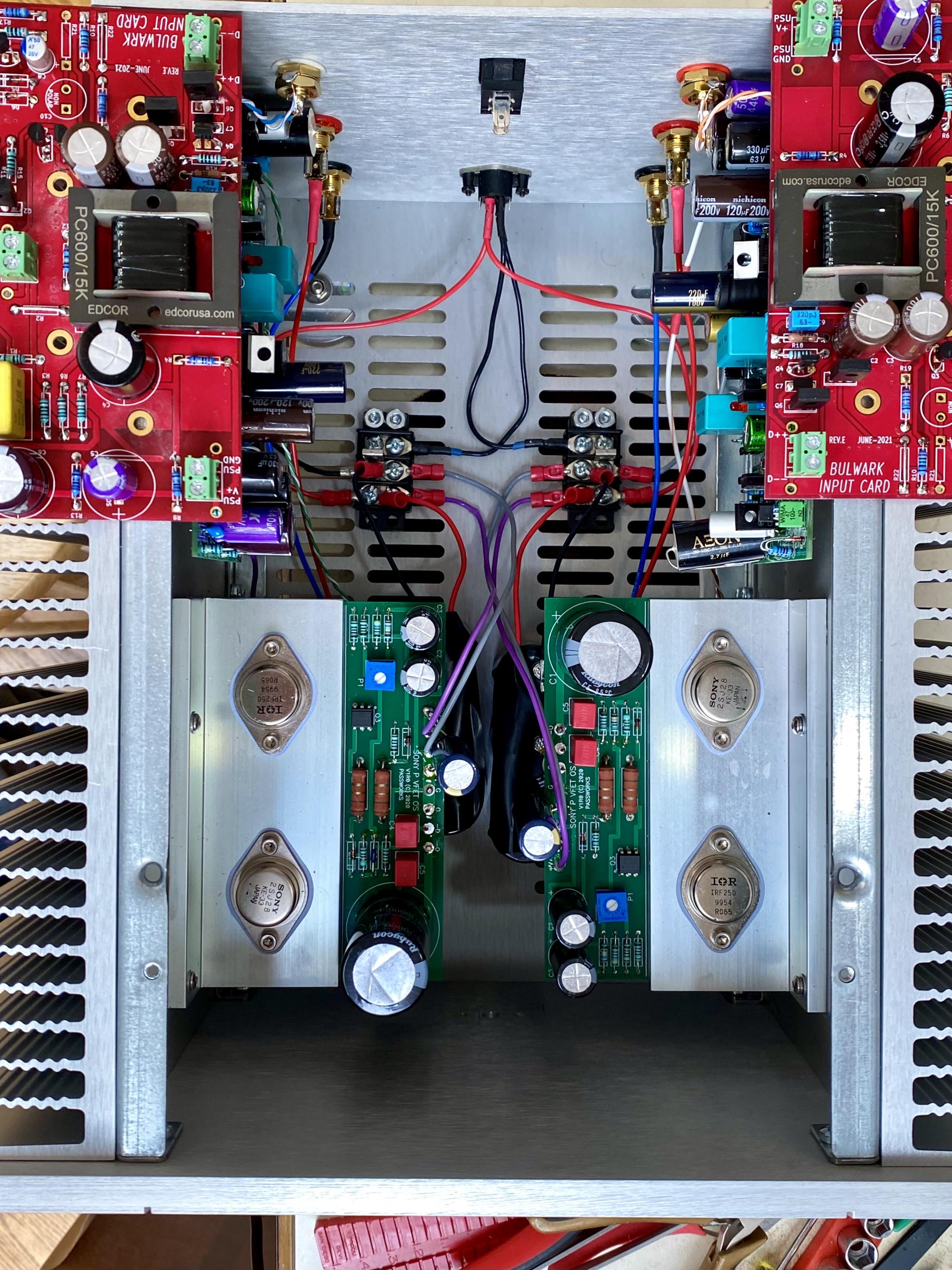

The new Bulwark FE boards are coming along quite nicely. I used a 1.0 uF Polycarbonate cap at C1 and a pair of 100 uF Elna Silmic caps at C2 and C3. These tend to need a run-in period and reward the listener for their patience. I am also using film caps at C7 and C9, as my experience with the Dreadnought boards was that ceramics just don’t sound good.
These were considerably easier to build compared to the Dreadnought boards, and are also easier to visually inspect once built. I think this amp likes having some iron in the signal path, or maybe that’s just me.
After making a gain adjustment to the Bulwark boards, I've found what I consider to be a sweet spot. I was shooting for +3dB of gain instead of unity, so I set R22 to 2.2k, R21 to 4.75k and C10 to 47uF (Nichicon ES, 50V). Beyond simply increasing the gain, this adjustment seems to open up the clarity of the FE stage. More details are noticeable, without the overall tonal balance sounding too bright. This change has also added crispness to percussion instruments, which is something I appreciate. It seems that the Edcor responds well to a hotter input signal
As I have been listening over the last few days, the dual Elna Silmic caps on the output have broken in, along with the film input cap. The overall effect is still very smooth, but with more detail. The clarity of this FE is such that I'm tempted to do some capacitor 'rolling' between the input and output coupling caps, but I will control myself until I'm completely out of other ideas to try. After all, I have another pair of bare Bulwark PCBs waiting to test other ideas and an alternate signal transformer.
As the easier of the two alternate front ends I've built so far, the Bulwark boards are my recommendation for those who want to try something different with their VFET lottery amps. These boards should work well with both P-type and N-type output stages. Remember that the N-type does not require the FE to invert the signal, and wire accordingly.

......It seems that the Edcor responds well to a hotter input signal........
well, without searching back for exact schematic, considering that if Edcor is there, it is still connected in same way as in Papa's origin FE ......... if I presume that you're listening on same SPL ......... Edcor is still getting same signal, whatever gain is of preceding stage
As the Edcor is wired the same way as in the original FE, a simple 1:5 gain element, you are correct. I am still at a loss to understand how reconfiguring the preceding silicon gain stage for an extra 3dB gives the level of improvement that it does. It is more than just a little louder / less rotation of the volume knob..

The Bulwark FE continues to deliver wonderful music. It strikes an excellent balance between smoothness and detail, with an airy upper end that reveals much that lies in the recording. So much so, that one may wonder if it is the same CD.
As I was installing the extra resistors and capacitor to boost the gain, I had a small value film cap in mind to bypass R22 if necessary. At this point it doesn't seem necessary. Some recordings are just a little bright as they were produced. Others are not. I've listened to more CDs over the last couple days, and the Bulwark cards remain revealing, yet fairly so. I think the pair of 100 uF Elna Silmic caps at C2 and C3 is a good choice. They did take a while to settle in. I used the Toshiba TTA004B in place of the KSA1220AY in all locations, so I can confirm that they work well in this application.
I wondered about this myself. My conclusion is that the Edcor itself is as fast as it can be, and the rest of the circuit may be adjusted to improve the apparent speed of the front end. Both the Dreadnought and Bulwark cards needed some adjustments to let them better "get out of the way" to allow the output stage to sound as it was fully capable. I have written about the changes I made along the way, so they are scattered over several posts going back a few weeks. The Dreadnought circuit needed a little more help, and the Bulwark was fairly easy....

Guess what? Of the two, the Bulwark now has a slight edge in detail and clarity over the Dreadnought. This was somewhat surprising, as the Dreadnought initially sounded like the faster of the two after the first set of adjustments.
On the original article about the VFET, Papa Nelson pointed out that the FE introduces some resonant ringing. The output stage alone is a much cleaner square wave.

NP changed the component values of the Edcor secondary termination network, at least three times between July 2020 and April 2021. I know this because I tracked and implemented each of those changes in the early prototypes of the Front End cards called Scourge and Bulwark.
What this means is: it's perfectly OK to tinker with the Edcor termination network. Nelson did, so can you. The network isn't carved in stone, it's a work in progress. Maybe the next improvement will come from the club of VFET amp builders, which would be really cool.

I have been waiting to see if anyone else had built and listened to a pair of Bulwark FE cards. So far I haven't seen any other mention of them. There has only been one other builder that briefly mentioned the Dreadnought cards on one of the other threads. I don't recall there being much of a description or listening impressions for those. I would be happy to see other builders trying these and other variations of the front end.
Both the Bulwark and the original NP front end use the same secondary termination network that Edcor recommends for their transformer. I haven't experimented with these values, as that would require hooking up a proper signal generator as well as my scope to examine the square wave response. I usually enjoy listening tests more than looking at scope traces, but sometimes the scope tells us things we won't discover in other ways.
As my last few posts in this forum have indicated, the circuits themselves, including some of the capacitors, have played a greater role in the sound of the Dreadnought and Bulwark front ends than I expected. And the differences that I have been hearing are unlikely to be the things that will show up on simple scope traces. Music is a far more complex test signal than most ever use when looking at results on test equipment.
