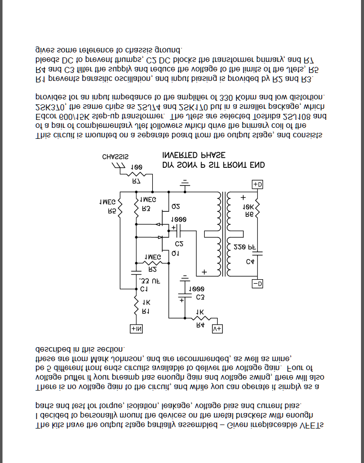

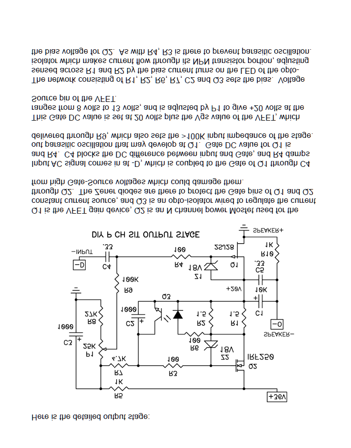

Hi, jonboylaw. Yes. As soon as I win either another board lottery, or NP and the store release the boards for 2SK60 (or SKJ18), I will be using the 4650 chassis for the build. The small 1 amp 20V SMPS powers the preamp fine and sounds great, no discernible noise. I have a small voltage booster attached to it, and that so far also powers the 100v phono stage. It needs shielding, however, it hums, and I am figuring that out now. So far aluminum foil shields it.
I will include pix as I go along. I will have a second 36v (??) SMPS that will fit internally for the amp stages.
The second SMPS should fit fine inside the chassis @75w/channel for the 10 (??) watts class A or so per channel.
This is only my second DIY after the Korg preamp, so it is a learning process as proceeding.
