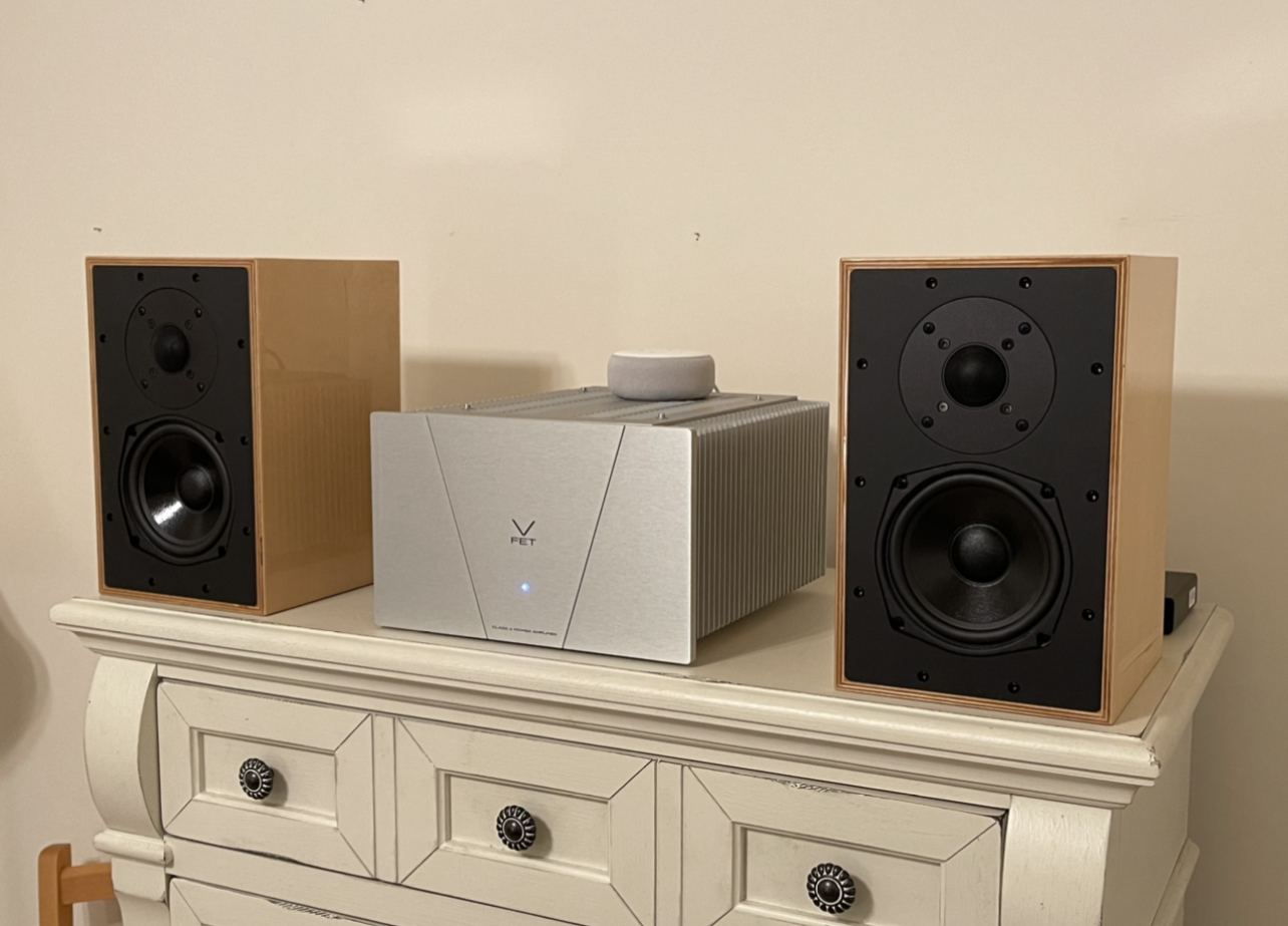

My VFET just got a new pair of speakers today. They pair really well with my homage to the LS3/5A in high gloss natural birch finish. Great bedroom amp/speaker setup.
Thanks to alazira for sharing listening impressions. Capacitor rolling can be a delicate subject, and it can be rewarding as well as entertaining.
