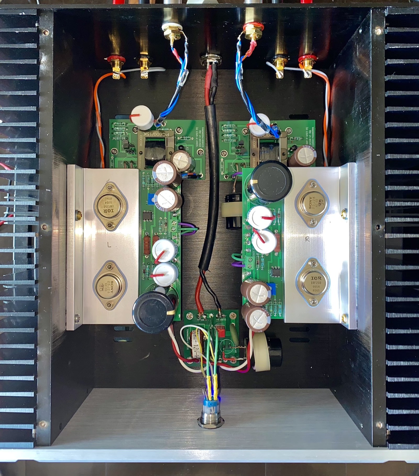

I have just finished my p channel amp. Special thanks to Papa, Jason, 6L6, and all the other who worked so hard to make this special project possible. The sound is incredible as all the others have talked about. I was away from home most of last year until recently. I did not buy the chassis from DIY shop as I sourced my own chassis. The next step is to do fine tuning and adding mods that has been discussed on this thread to tailor the sound. A linear PS is already in the plan.

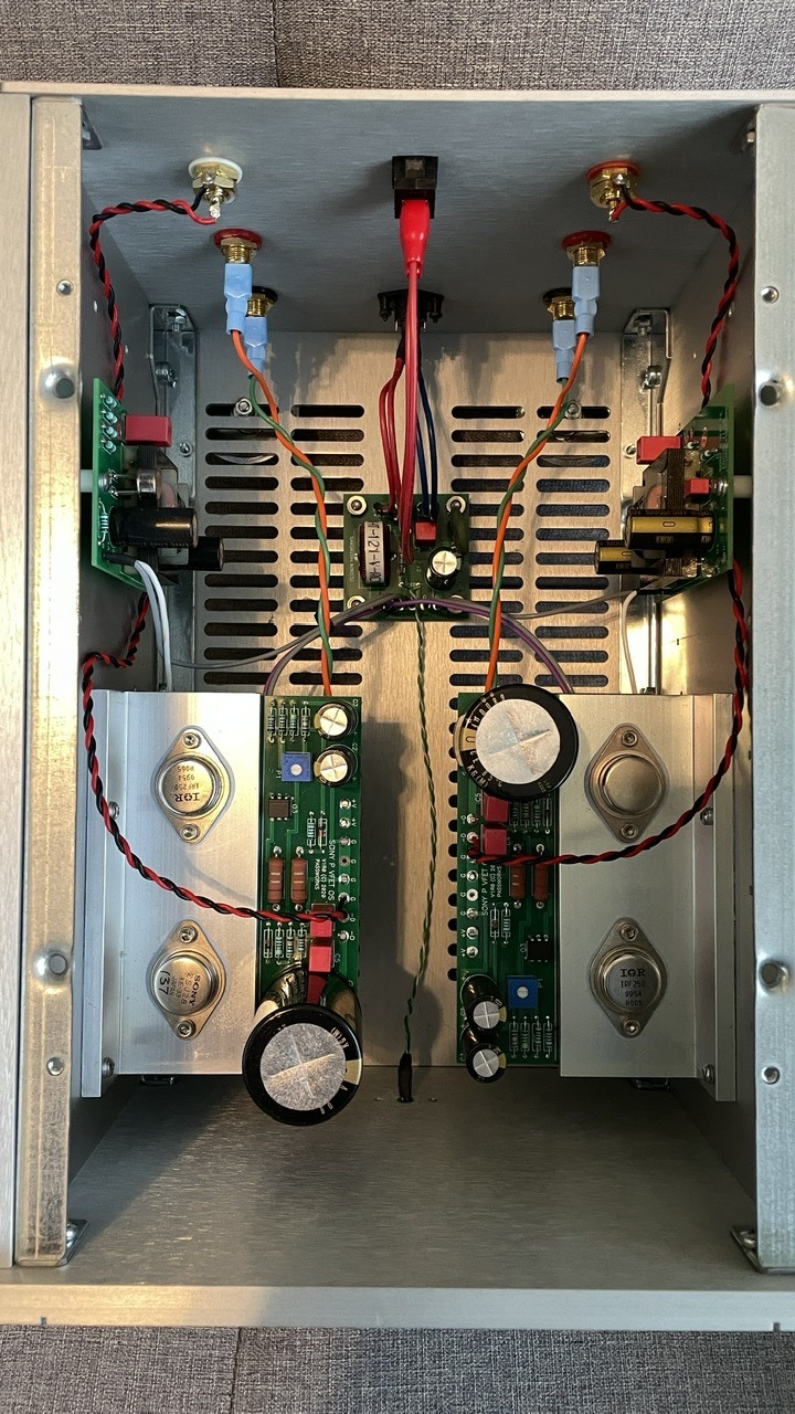

I am currently listening to a simplified version of the Marauder FE in my rebuilt M2x. Basically an OPA551 as a unity gain buffer driving the Edcor in its 1:5 autoformer configuration. It’s clean, fast and quite detailed. Prior to that I had the Mtn View cards, which are precursors to the Scourge FE.
If you want to hear what the VFET output stage sounds like as naked as possible, I recommend the Marauder FE.
The Dreadnought FE is a more complex build, and one that I modified more to get the sound the way I liked. Also interesting, as it is a transconductance amplifier, which has a subtly different sound. Well rounded and still detailed.

Yesterday I took out the vanilla FE's because I want to try out the Edcor transformers in my SissySit. I have a Wayne line stage as preamp and together with the DAC they provide enough swing, so I listened to the amp without FE (N channel). I am giving it another go today but I was positively surprised🙂
Provided your combination of source and preamp have enough gain and you have sufficiently efficient speakerd, is this the most naked way to listen to the VFET OS?

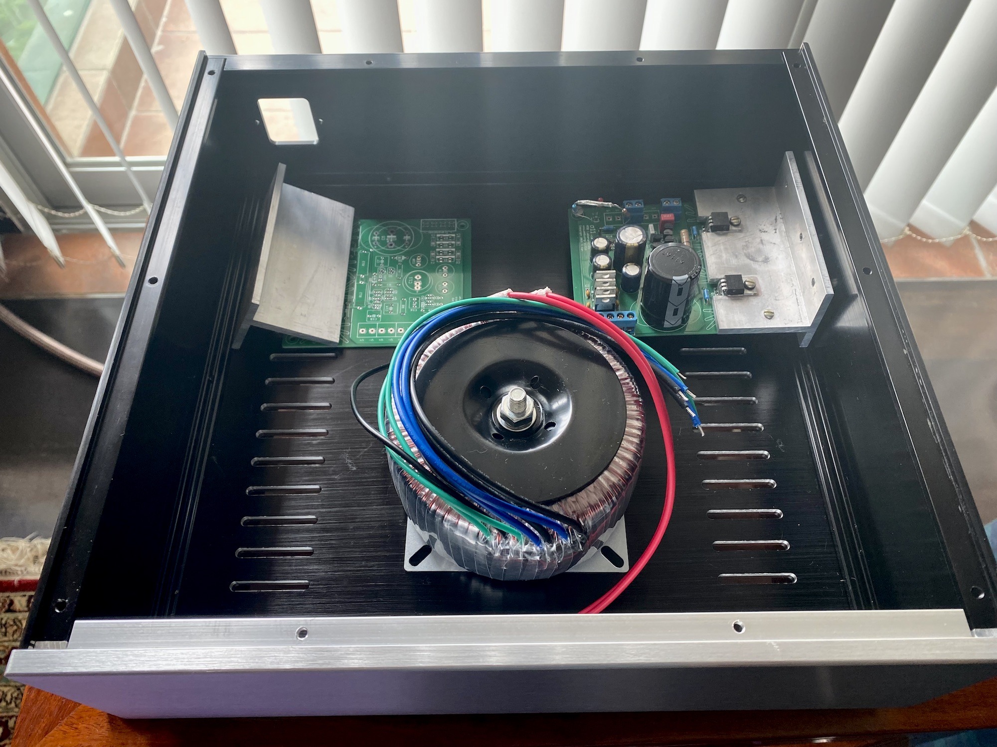

I set up my linear powersupply and put the trafo secondaries in parallel. While having around 39VDC unloaded, once connected, I did get some voltage drop.
I assume that 34VDC would be too low for this amplifier?

While 34V is not a show stopper, it is not optimal either. You may want to consider a different choice for the filter network in your power supply.
CRC, CLC ?
What do you have now, and what can you do differently?
CRC, CLC ?
Thanks Tungsten. I am thinking this trafo is a bit on the small side all round. I might park this linear PS idea for the time being.

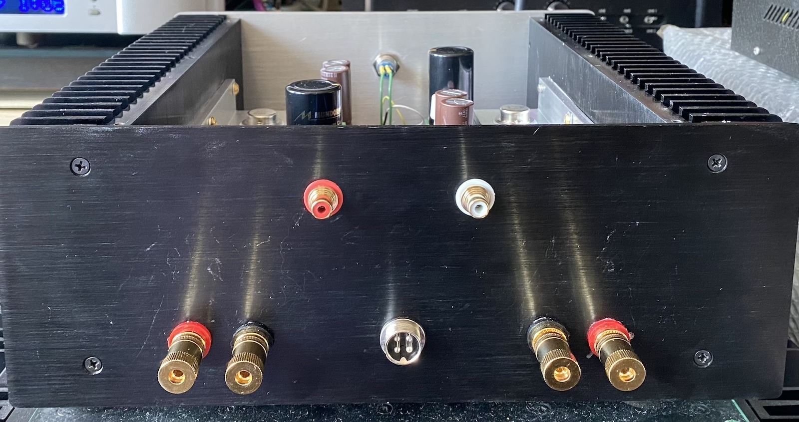

I am going to embark on the LPS, a dual mono setup.I have just finished my p channel amp. Special thanks to Papa, Jason, 6L6, and all the other who worked so hard to make this special project possible. The sound is incredible as all the others have talked about. I was away from home most of last year until recently. I did not buy the chassis from DIY shop as I sourced my own chassis. The next step is to do fine tuning and adding mods that has been discussed on this thread to tailor the sound. A linear PS is already in the plan.
The LPS is in operation. I would to report that the result is extremely positive. My observation is that it would take the amp from a very good one to an outstanding one. The key improvements are in the sound stage and instrument image rendering. The sound stage is deeper, and layering of an orchestra more apparent. There is more air around each instruments and the image of them are more 3D. The overall image is less dark, meaning more transparent. Micro-dynamic is also improved.
I highly recommend those who want to extract the best performance out of this beautiful amp to put the effort in to build a LPS, preferably dual mono setup.
