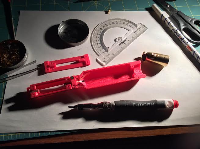

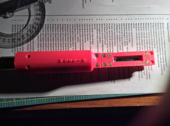

How long etch in NaOH? I've built ribbon mic and need less than 5 microns.
With 2 x 10 minutes at room temperature in 0.1N NaOH it was 5.6µm, with 2 x 12 minutes 4.6µm. The etching was done in two steps to be able to use clean solution for the second and to clean the ribbon between etching steps. With 3 x 10minutes you should end up with 2-3µm.

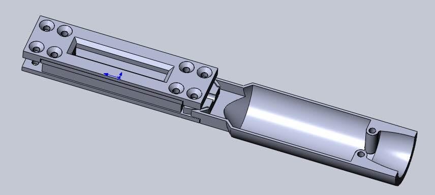

Is that 3D printed? Looks very well designed! I am also thinking about buying some 3d printer as it seems like a great tool for small ribbon horn making.

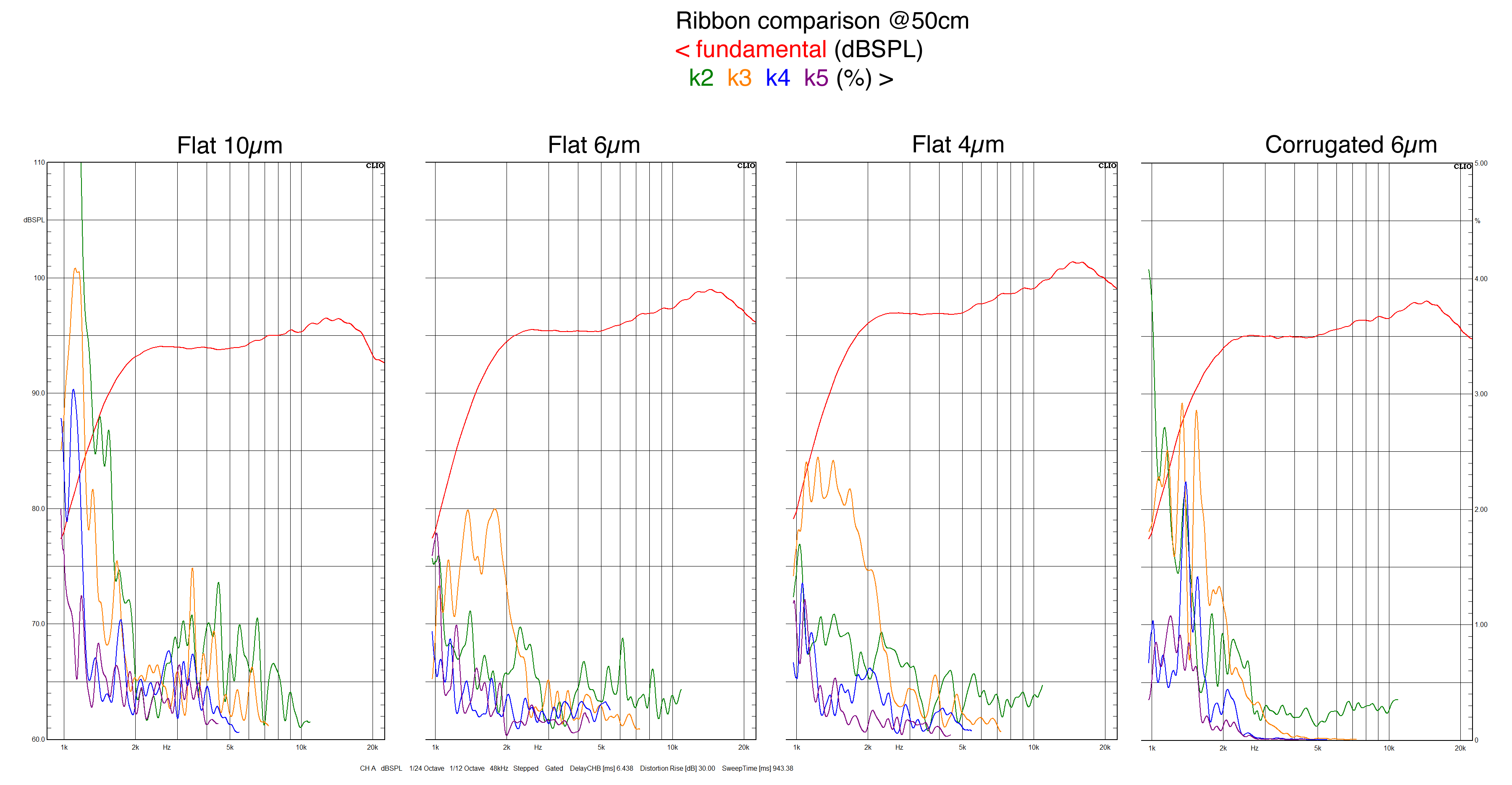

Digging through the measurement archive I compiled this comparison showing the harmonics for three flat ribbons and a corrugated ribbon:
Some dipole correction and high pass filtering was applied, same setting for all measurements.
The harmonics are in percent, 5% full scale. Despite the differences the overall response is about the same for all ribbons. As expected the level increased for thinner ribbons. The level for 6µm corrugated ribbon is a bit below the 6µm flat ribbon, probably because of the extra mass (length).
Compared to the 10µm flat ribbon the 6µm and 4µm flat ribbons have significantly less distortion, especially around 3-4kHz. Although 0.5% 2nd and 3rd harmonic above 2.5kHz might seem acceptable, the level of the higher harmonics is not.
At first glance the corrugated ribbon looks worse but that is only the range below 2.5kHz, above 2.5kHz the corrugated ribbon seriously outperforms the flat ribbons. The higher harmonics are more than an order of magnitude lower for the corrugated ribbon. The distortion peaks below 2kHz are related to the ribbon resonance due to the corrugation, reducing them is a matter of finding the right combination of corrugation and ribbon tension.

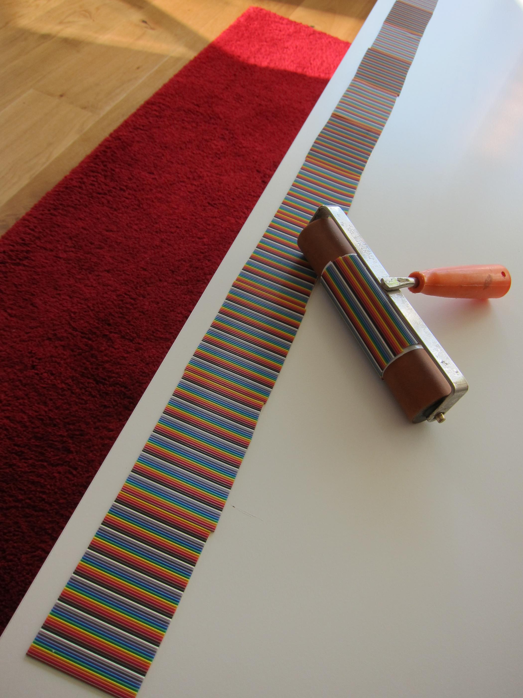

Gerrit, I tested your Corrugator, big difference! Thanks!
I also tried the old Apogee trick with a ribbon return current conductor close to
the ribbon, distortion went down a few dB, mostly below 2 kHz...
Great to hear that it works! :)
It could be that the ribbon is now more sensitive to draft, definitely a point of concern with large ribbons.
