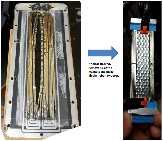

I also found a pic of the ribbon structure used for these measurements, which was made from magnets pulled from a burned up Neo8, stacked and glued to a thin plywood base. The corrugation pattern on the ribbon was one that worked well at reducing distortion and response anomalies.

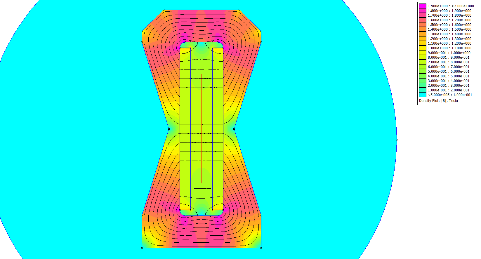

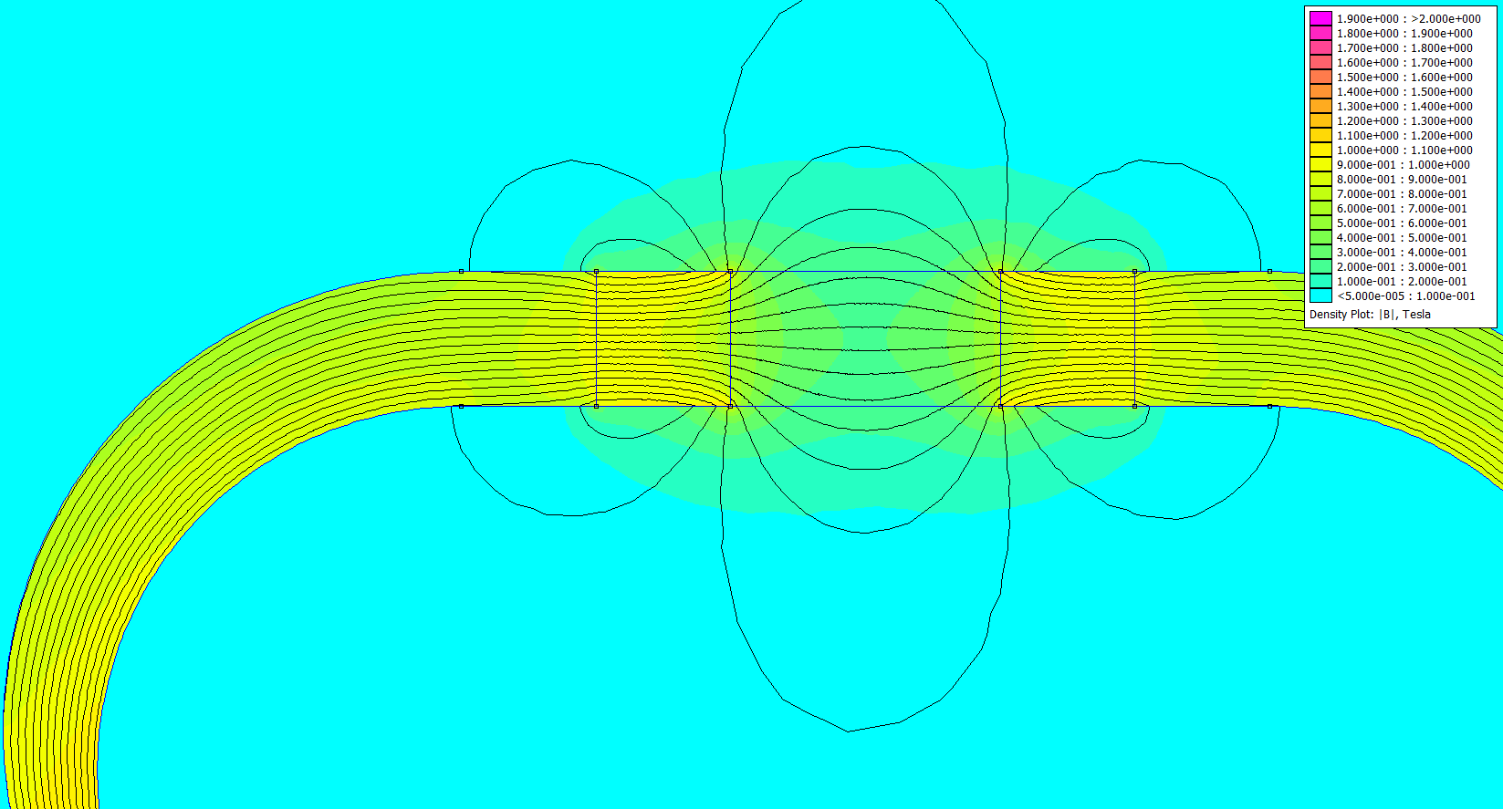

FEMM is a 2D simulation tool!
The flux lines crossing the gap are NOT correct as the depth dimension is not taken into account. A separate top view simulation shows what going on:
This is not the same model but a crude way to simulate the top view while still closing the magnetic circuit so that the flux at the edge of the gap is about the same as in the previous simulation. It is this variation of the flux density that cause flexing of the ribbon which has to be prevented by corrugating the ribbon. Reduce the variation and you can use thinner foil and/or less corrugation.

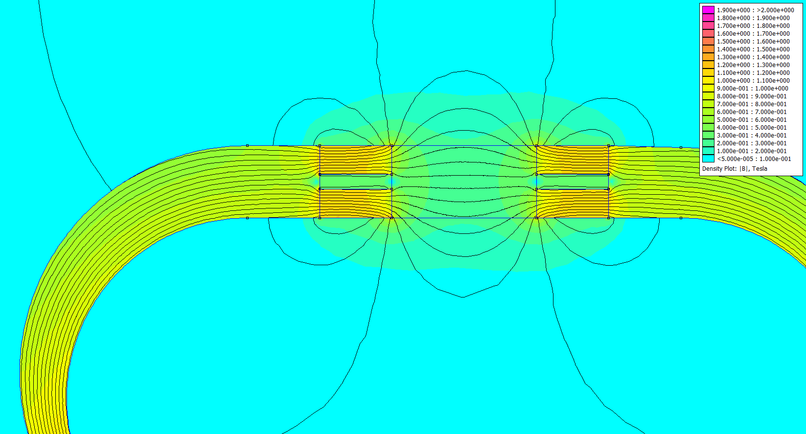

The top view for the double magnet construction:

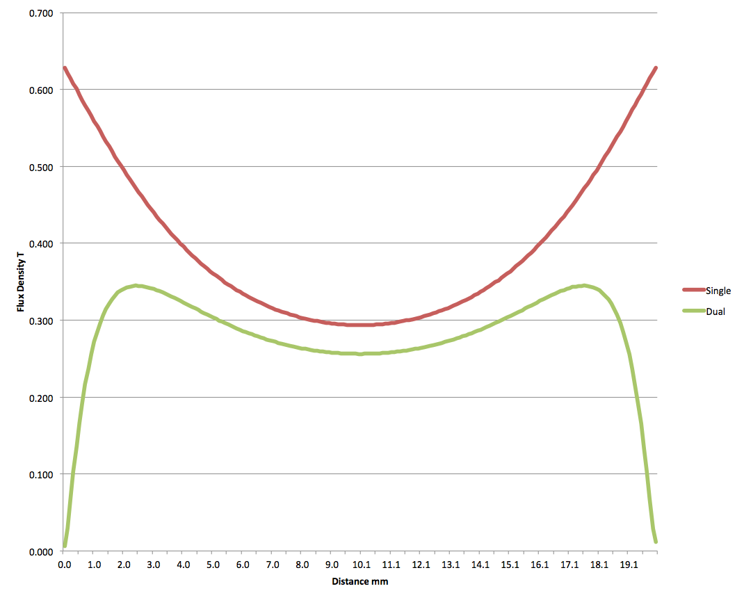

The flux lines are much more parallel in this case. Here's a detailed comparison of the flux density across the gap:
This for a 2mm gap between the magnets, the flux density variation is even less than with the 1mm gap in de minimal ribbon.
I use 15cm magnets for a 10cm gap length to keep the flux density constant (more or less) lengthwise.

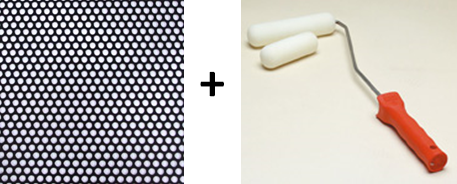

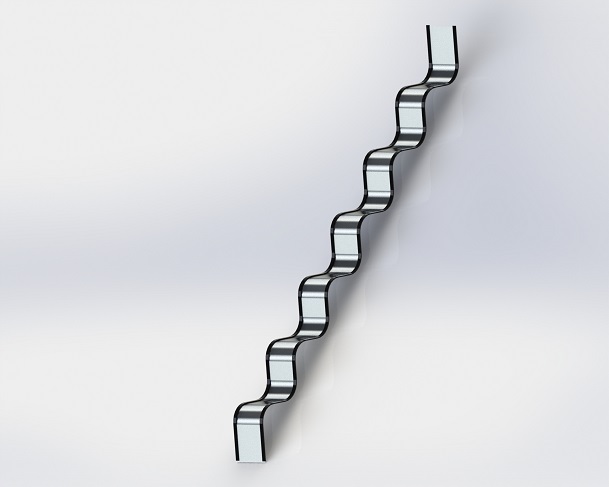

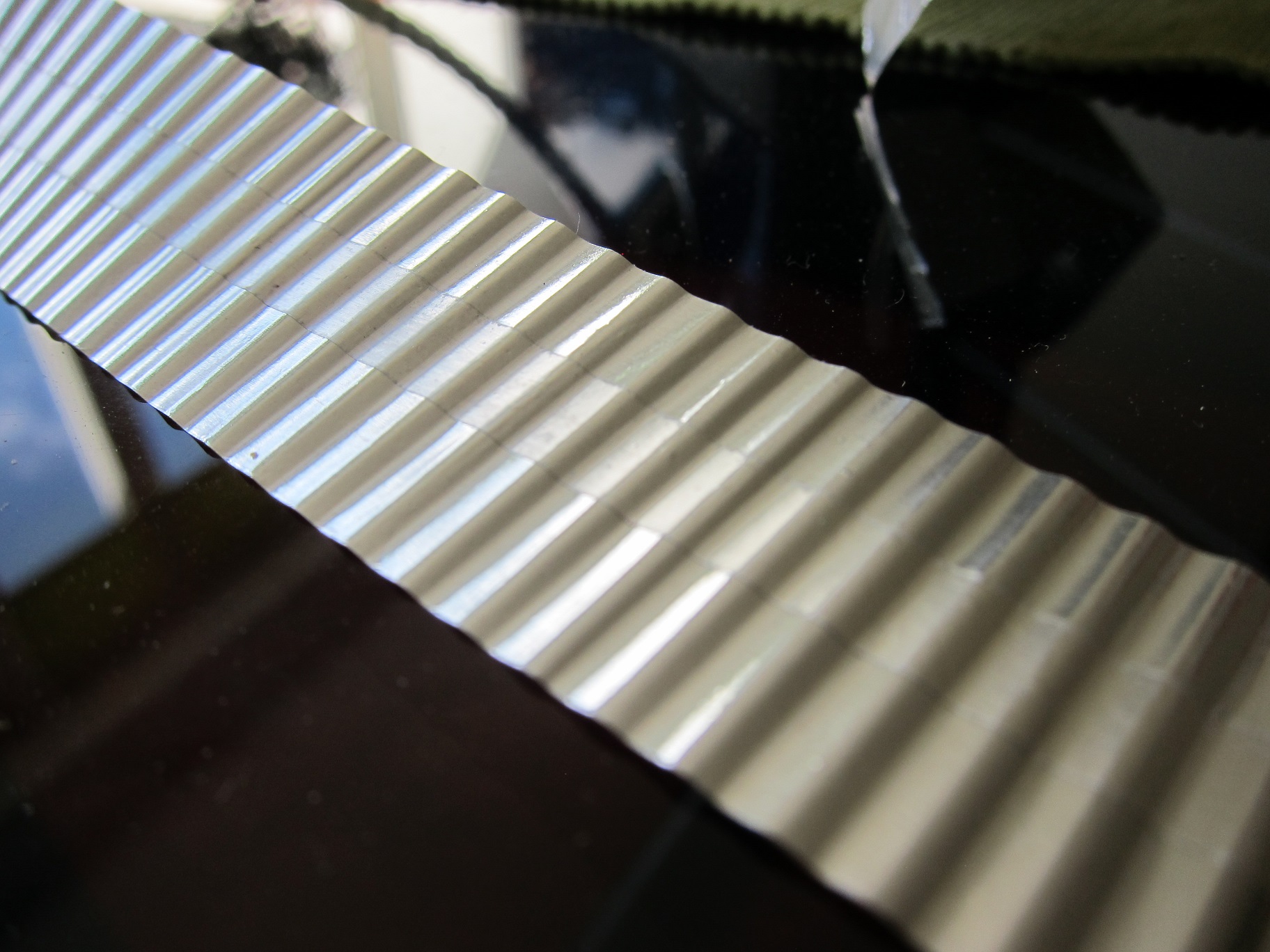

Very interesting pattern and results. How was the pattern made?
The foil was place on top of some perforated sheet metal and then rolled over with a small paint roller made of dense foam. I tested the stiffening ability of the pattern by gently waving/wiggling the ribbon around in the air from one end and listening to the metallic rustling noises it makes. I kept rolling with more pressure to deepen the pattern until the test produced silence.
… Can you tell us how hard is to work with such thin foil?
I found it extremely difficult. It took several tries to get a 2µm foil mounted without tearing it. Adding a pattern to it was out of the question. I should have mentioned that the ribbon pattern shown in the image was on 11µm foil.

I must correct myself, your pattern reminds me more of the Pioneer PT-R9 ribbon tweeter. http://img.fmhifi.com/old/sp/201309/1378508341144520586.jpg 😉

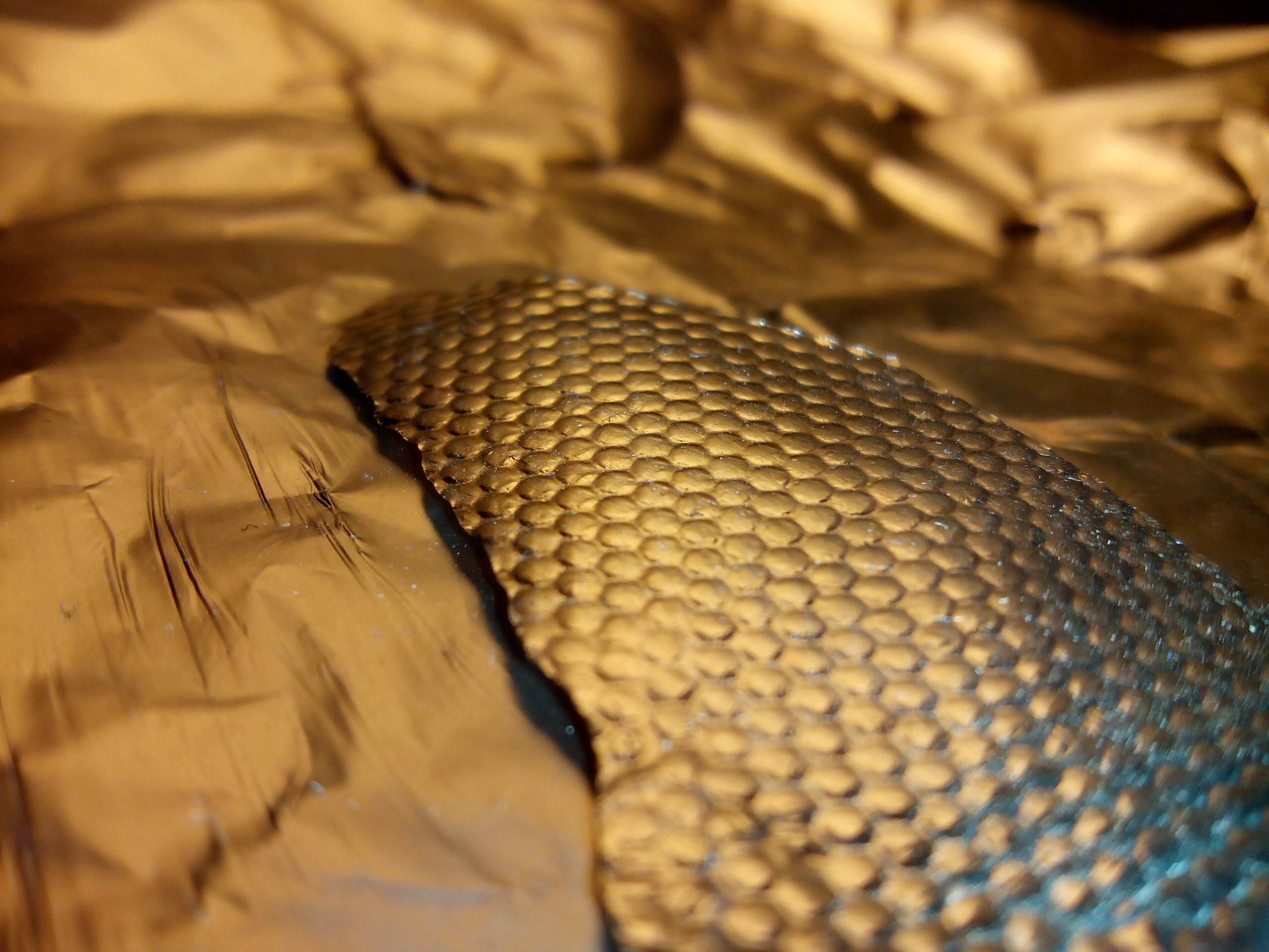

I tried some embossing patterns today, and found some perforated aluminium mesh that was painted and had smooth holes. IMG_20150915_214759.jpg Basically, it's the same pattern as Bolserst kindly posted few posts before, and it's done on thick kitchen foil. Tried ones with irregular patterns, very small corrugation, small bumps further apart, but the one on the picture seems most rigid. Need to make ribbon and at least hear how it sounds.
